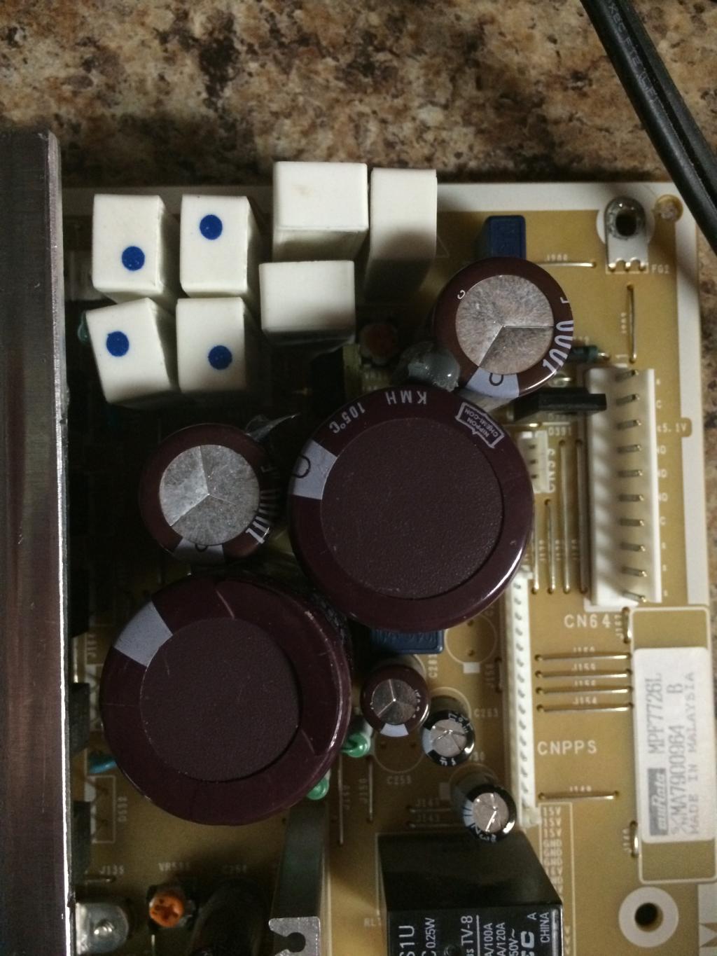

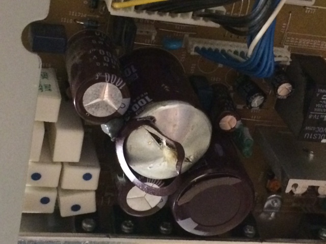

    Hello All. I have a Hitachi plasma that is blowing capacitors. I have a picture of the capacitors attached. This is a new capacitor that I just installed. I replaced the y buffers and that allowed the tv to turn on and stay on. After the tv is on for a few minutes, the screen starts to fade and then boom!! Any ideas?
    Re: Hitachi P50V701 blowing capacitors
    Voltage is too high, or wrong polarity?
      The new capacitors have negative black written on them. What does that mean? All the other labeling is identical to the original capacitors
        Also, I'm afraid to test the board while the tv is on. That capacitor literally exploded. Is there a way to minimize the risk?
          It is polarized capacitor (positive leg and negative leg) so you have to make sure negative leg of the cap goes into the hole of the circuit board is for negative, positive leg goes to the positive hole on the board.
          Remove the cap and show us good clear picture of where the cap goes to, there should be big white band close to one of the two holes on the board for the cap.
          is this the first time you do the cap replacement?

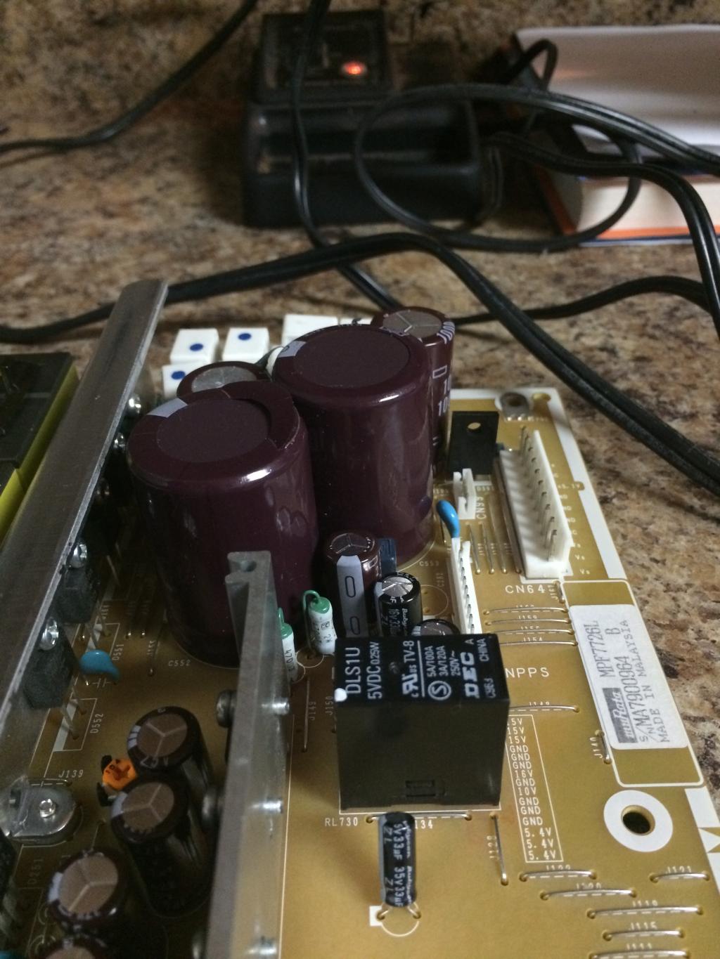

                              I've been studying the circuitry of the psu and the capacitor that keeps blowing appears to be directly downstream from an identical capacitor that is not blowing. Does this mean that the problem is downstream from the blown capacitor? Possibly on another board? I'm lost at this point.

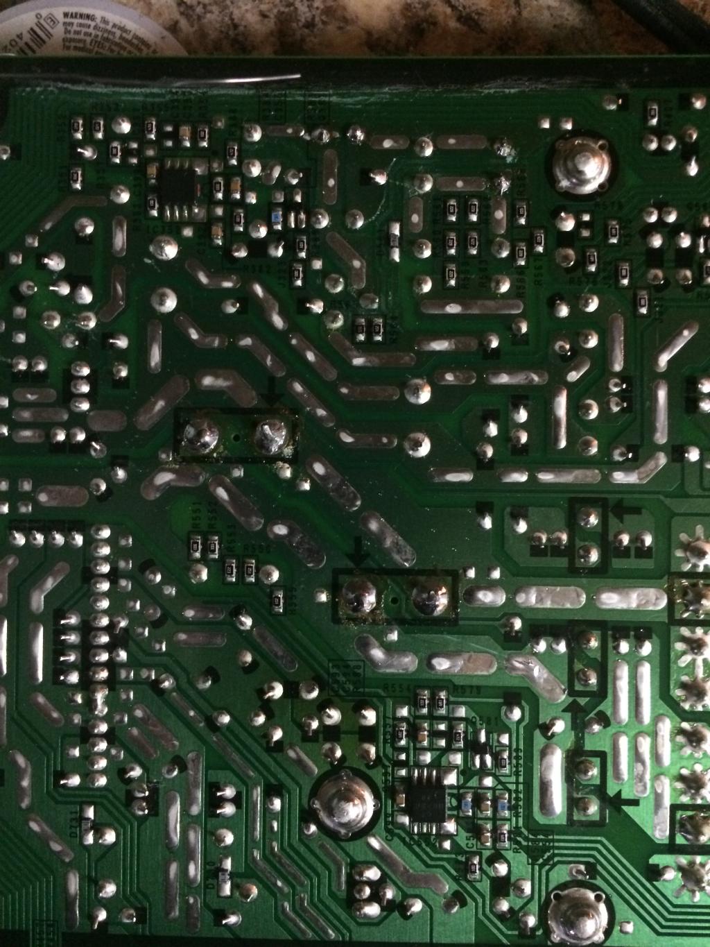

                                WE really need good clear pictures - have you checked for solder bridges that might touch when heated and have you clipped the capacitor leads close to the board - make sure it is not shorting on anything. Are the caps from a reputable source- where?
                                  Here are some pictures of the psu.
