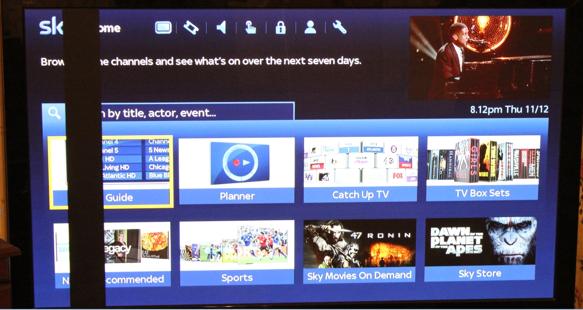

    Just wanted some help or advice if possible.
    I have a 50 inch Panasonic plasma model TX-P50G30B which has had a few hours viewing in the evening, age around 2.5 years.
    We were watching it on Friday when a 3 inch black vertical line appeared roughly about 2-3 inches from the left side of the screen.
    Is this repairable or scrap??
    Thanks for and help given.
    Regards,
    Sam

    Re: 50 inch Panasonic plasma vertical Black line
    It could be a few things. Worst case scenario is the address buffer ic on the panel went bad. But could also be a bad connection on the clamp connector where that ribbon enters the panel on that particular area. Also could be a bad address board on that side. Located across the bottom of the screen.
    First question is there still a warranty on the tv?
    If you open it up be careful there is alot of dangerous voltages in there. if you are going to attempt to find the cable associated with that spot always make sure that the TV is unplugged when you do any touching of anything in there especially those there's voltage running through so don't try to mess with it With the tv plugged in

      Thanks for your fast reply, No it has no warranty but I don't really expect it to fail after a few months either after paying over a grand for it.
      I was hoping it might be a simple plug worked loose after reading through some of the threads.

          Are there NO other pixels lit up in the bar, it is completely black?

            Update. there is all different colours speckles going down the inside of the black line.
            Just checked.
              I had a 85u like this and it ended up being a bad panel, reseat/clean the ribbon cable and connector on the buffer board and see if anything changes.
              Also see what happens when you unplug the affected ribbon and turn the panel on. One thing I have noticed with Panasonic is if the panel is like this and when you unplug the bad cable it will not change, but if you unplug and turn on a panel that is fine the line will show an array of rainbow sparkles.
              Make sure to reseat the cables good and firm before powering on the unit!

                Ugh... Sorry, but that's bad news. Most likely, it means the panel has failed. More specifically, the chips bonded to the bottom of it. Essentially, new TV time, unless you can somehow find a new panel... and they aren't normally cheap.
