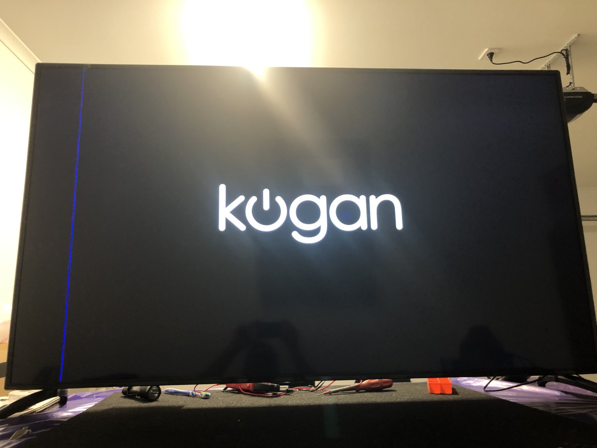

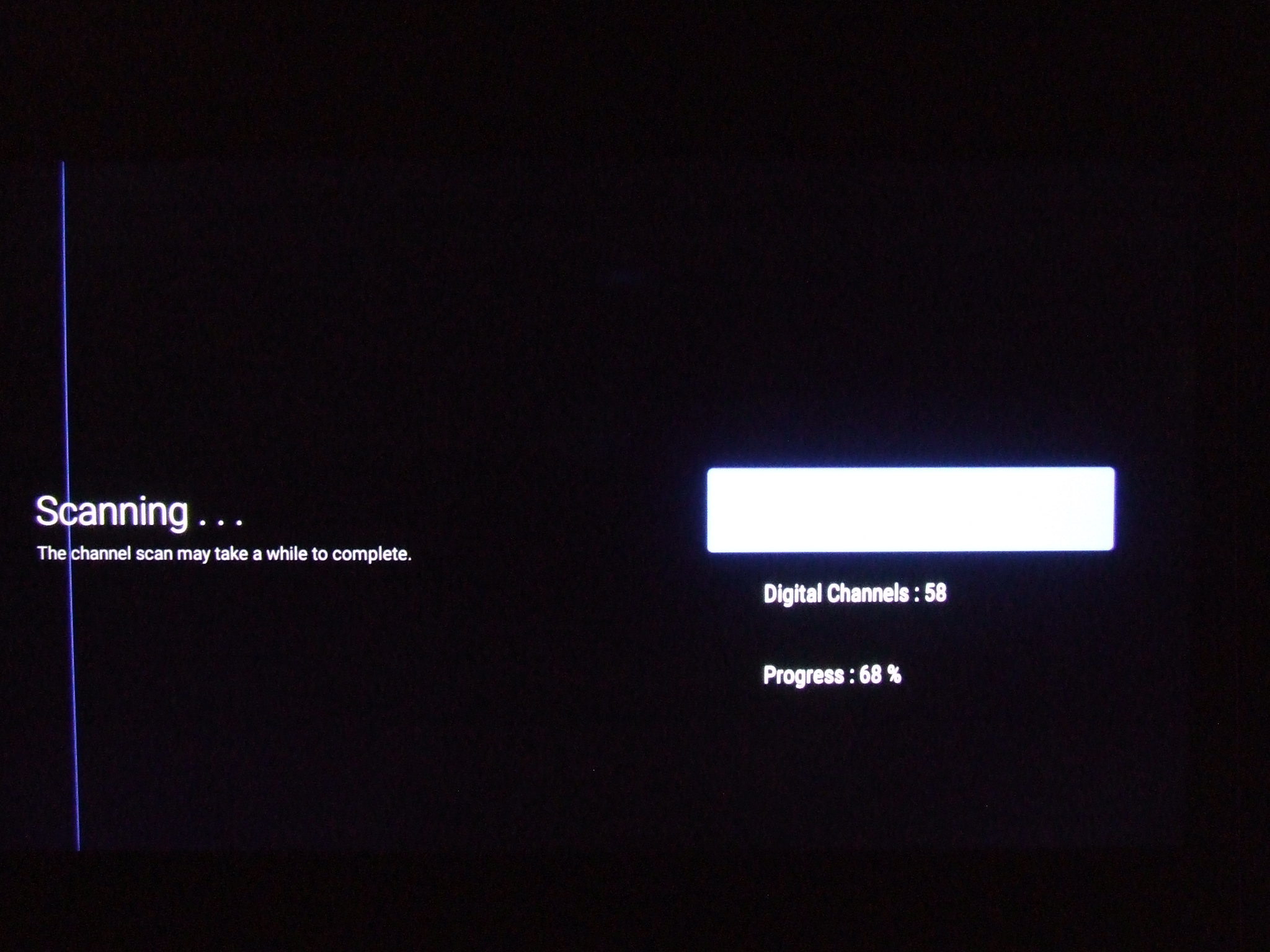

    Hi all.

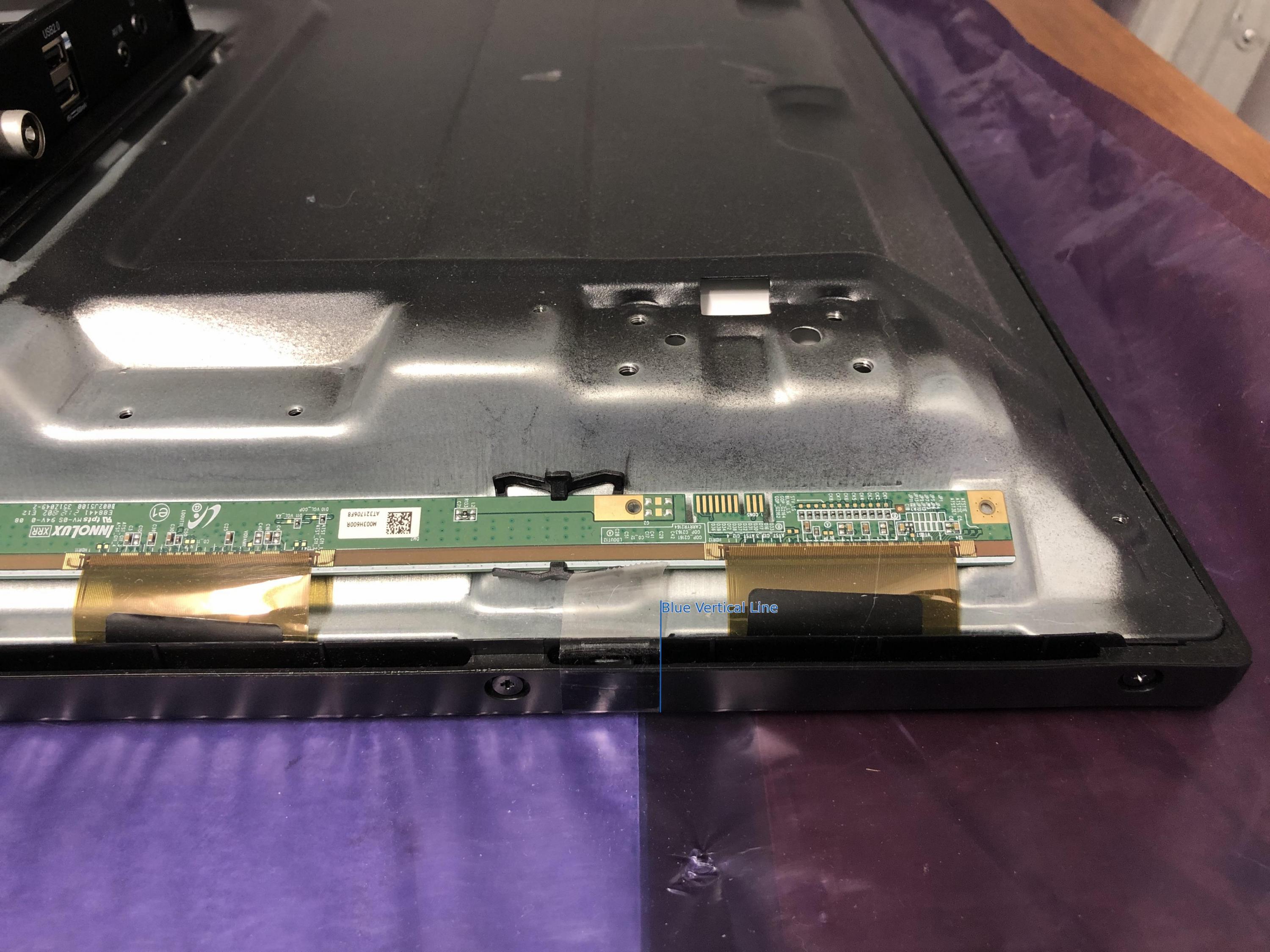

    I have a Kogan 65' LCD Panel with a thin blue vertical line (top to bottom) on left hand side of panel.
    The line just happens to coincide with the end of COF and start of the next COF (attached).
    The line is permanent no matter what I've tried. I've tried pressure testing the panel (top to bottom) and all over, I didn't notice any difference with the line, either temporary or semi-permanent.

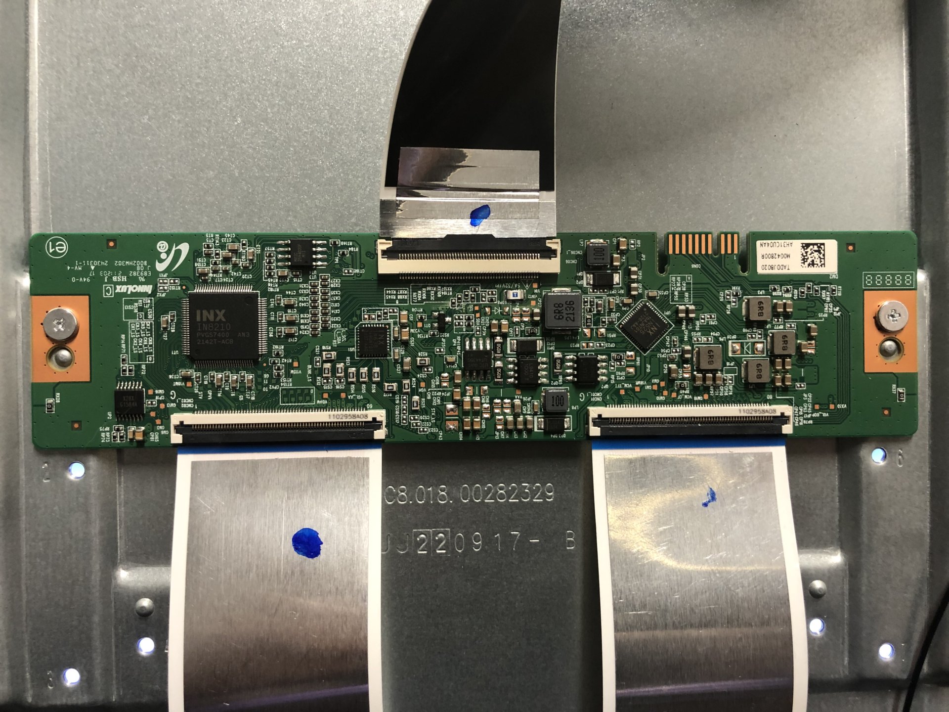

    Also tried unplugging all flex cables, cleaned with isopropyl then re-inserting to no avail - line remains.
    Hoping to fix / repair this issue as the panel seems decent and shame to throw away.

    Re: Kogan - KALED65XU9220STB - Blue Vertical Line
    The problem is in the panel itself, such a defect cannot be corrected.
      Many thanks Lotas.
      I was kinda hoping to not throw it away, seems a shame, but what I can do is scrap for parts.
      Cheers for the quick response.
