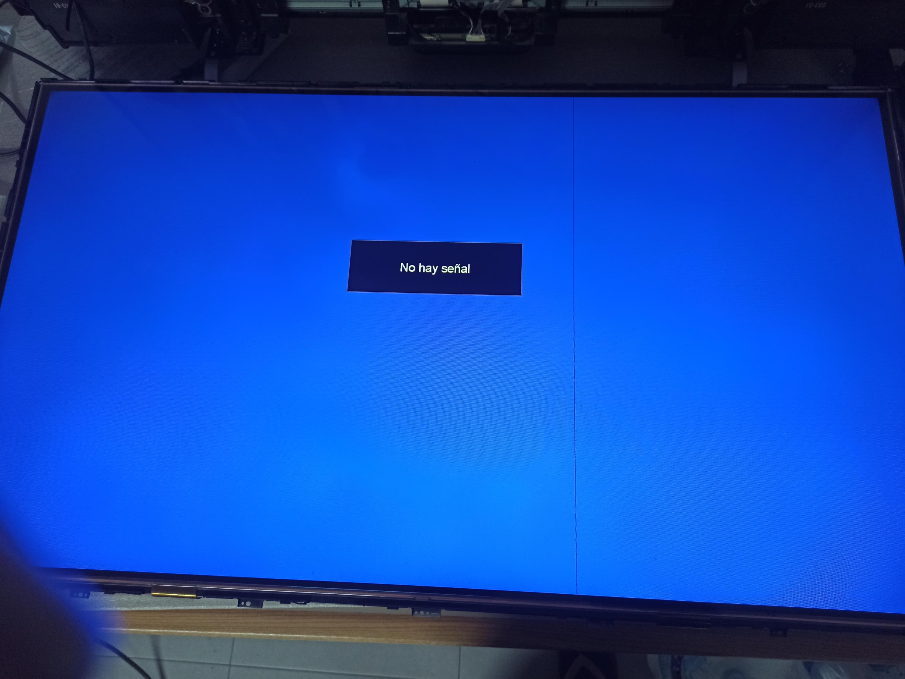

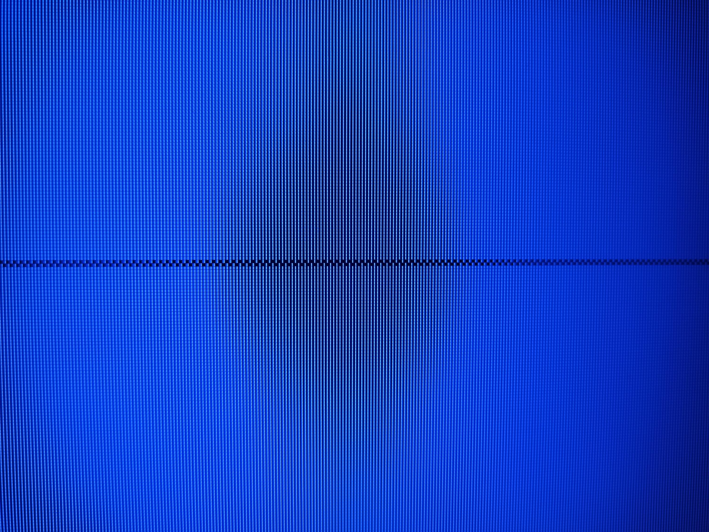

    good evening!!! I have this tv with a line that occupies 1 or 2 pixels in width. it has a solution? Can you do a test to find out if it's a panel or something else? Having the tcon integrated into the panel makes everything difficult. I have pushed on the flex attached to the panel, on both sides and there are no changes. I don't know what else I can do... the integrated ones that go on the flex get hot, but without burning yourself if you put your finger on it. to see if someone can help me. I attached a detail photo of the line. Thanks in advance

    Static vertical lines are bad panels. Google Sony tcon training manual.

      check the little mlc caps on the panel driver boards for shorts or very low ohms, might not be the problem but easy enough to check.
          checked and without short circuit

            ok, I understand that it is a panel failure that cannot be solved
