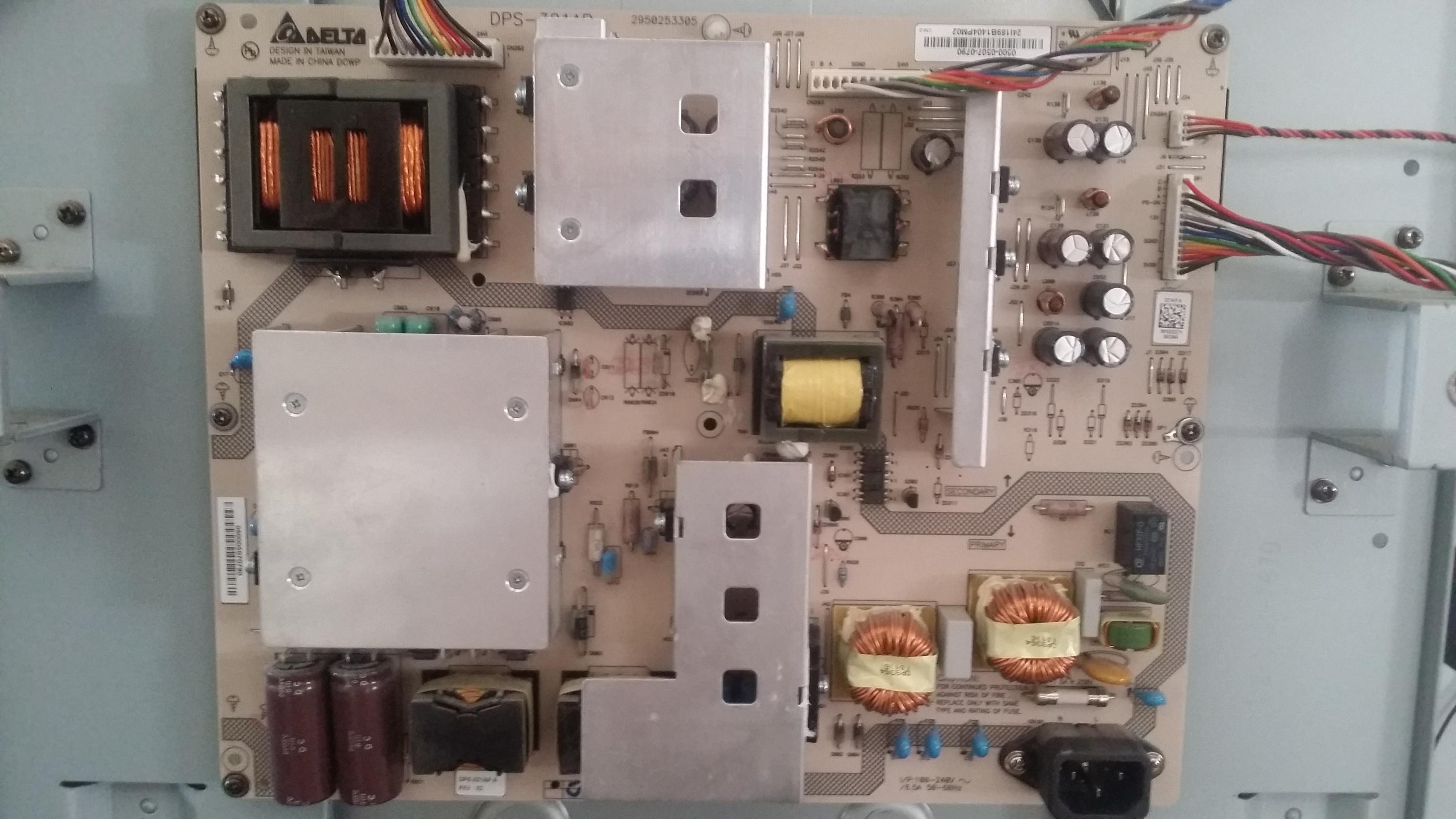

    E552VL 0500-0507-0790 Clicking.
    Ok First off I have the same TV in this previous thread.
    https://www.badcaps.net/forum/showth...ghlight=E552VL
    But here is My Difference. When I got the TV upon powering the cord it would light the Vizio emblem amber push the power button and it would let out a Fast Buzz Pulse from Relay L802. Then CLICK the set Powers off.
    I Did the board by board disconnect. to No Avail.
    But here is the weird thing After poking around the PS board a Bit I put pressure to the back of the relay and the Ticking Subsided and the set powered on! worked for a while! LIGHT BULB! Bad Solder! So I did some solder tune up on the relay leads and anything else that Jumped out at me! Bingo she fired right up! So with hopes of giving this fine unit to a family member I put a Blu-ray in repeat and let the TV go. I thought I was in the clear. NOPE I came home tonight to the TV still working but the L802 relay is Buzzing like mad.
    after one by one disconnecting the leads same story it clicks slow then fast them powers off. with the main board disconnected I Jumper the 5V to PS ON pin the L802 relay starts to let out a steady TICK TICK TICK and nothing else powers up. the Tick is less frequency that the Buzz it has when the back light lights up.
    Am I safe to assume the PS just needs to be replaced or do any of you have an idea what I need to test or replace on the PS? Is this common of a bad component that I just cant see Caps look fine and No Hot spots on the board.
    When it was working The picture was clear as a Bell everything looked good sound was perfect.
    Thanks In advance. again the pics in the other thread are identical to my tv. I can post close ups if anyone would like.

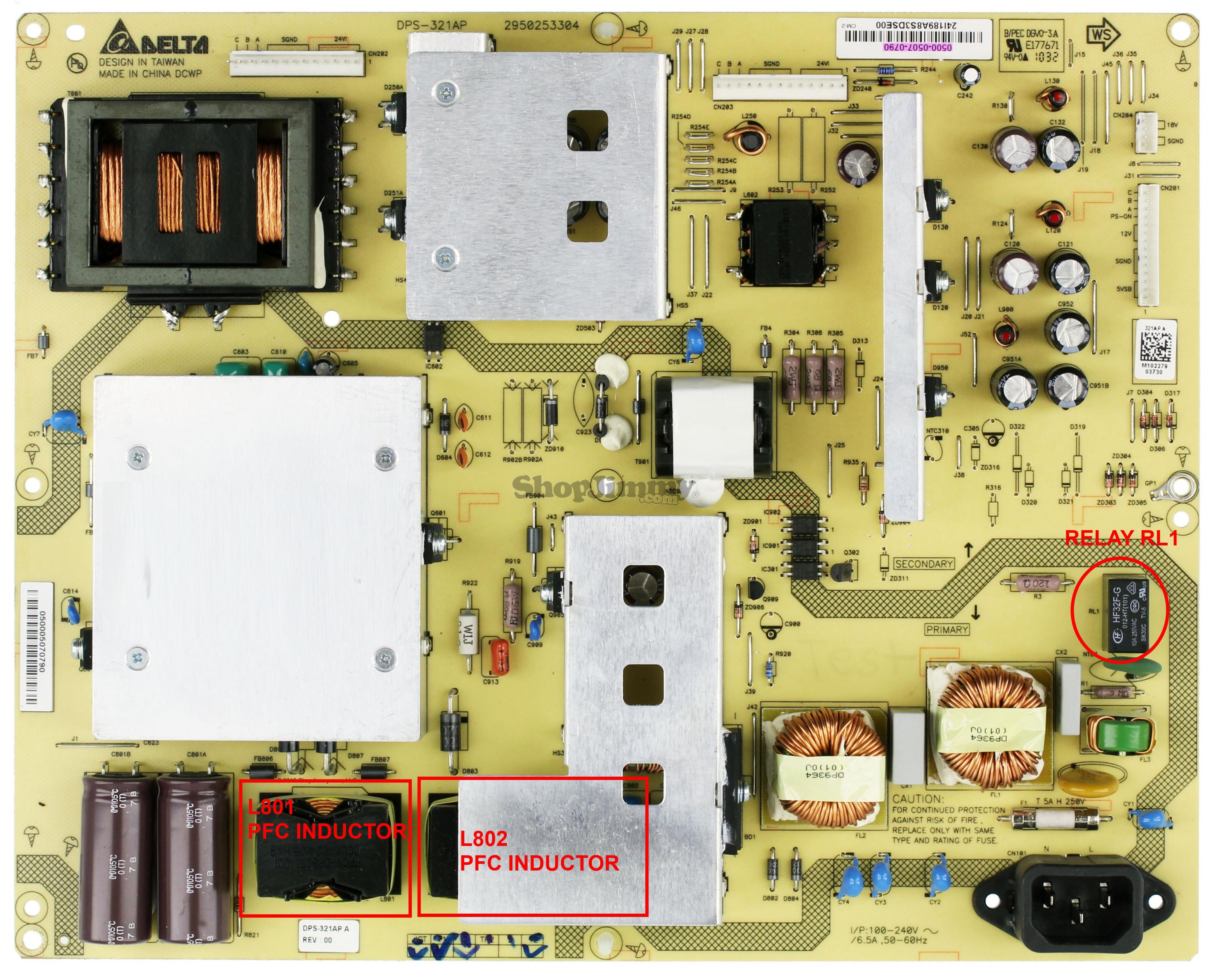

    Did you locate a P.S. schematic? Got a good pic of board that clearly shows the part#?
      Re: E552VL 0500-0507-0790 Clicking.
      'L802' L = INDUCTOR, not relay, so please show us the pictures of YOUR boards.
      L802 is PFC INDUCTOR, same for L801.
      RL1 is the relay on the power supply board.
      Picture provided by shopjimmy.

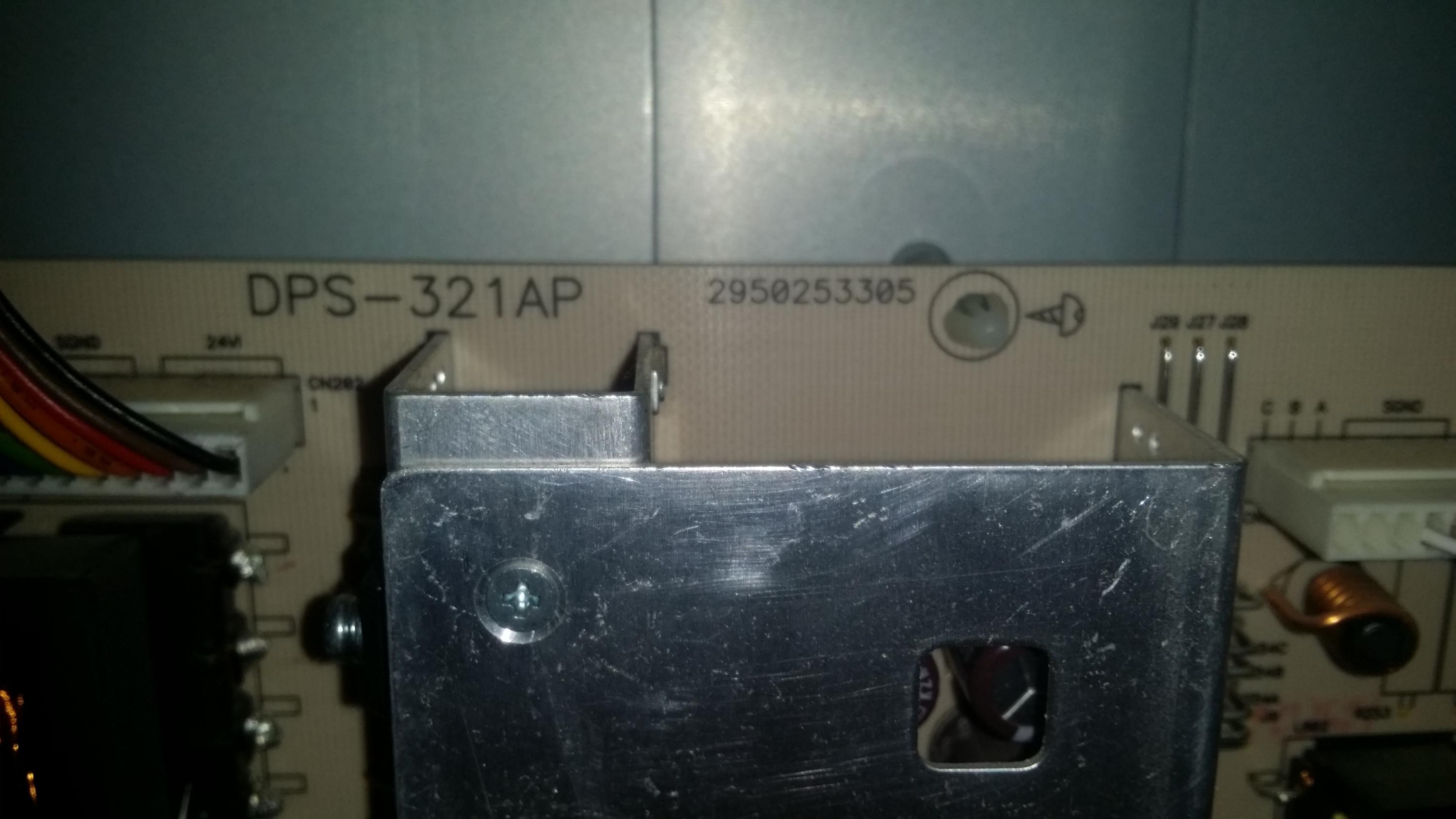

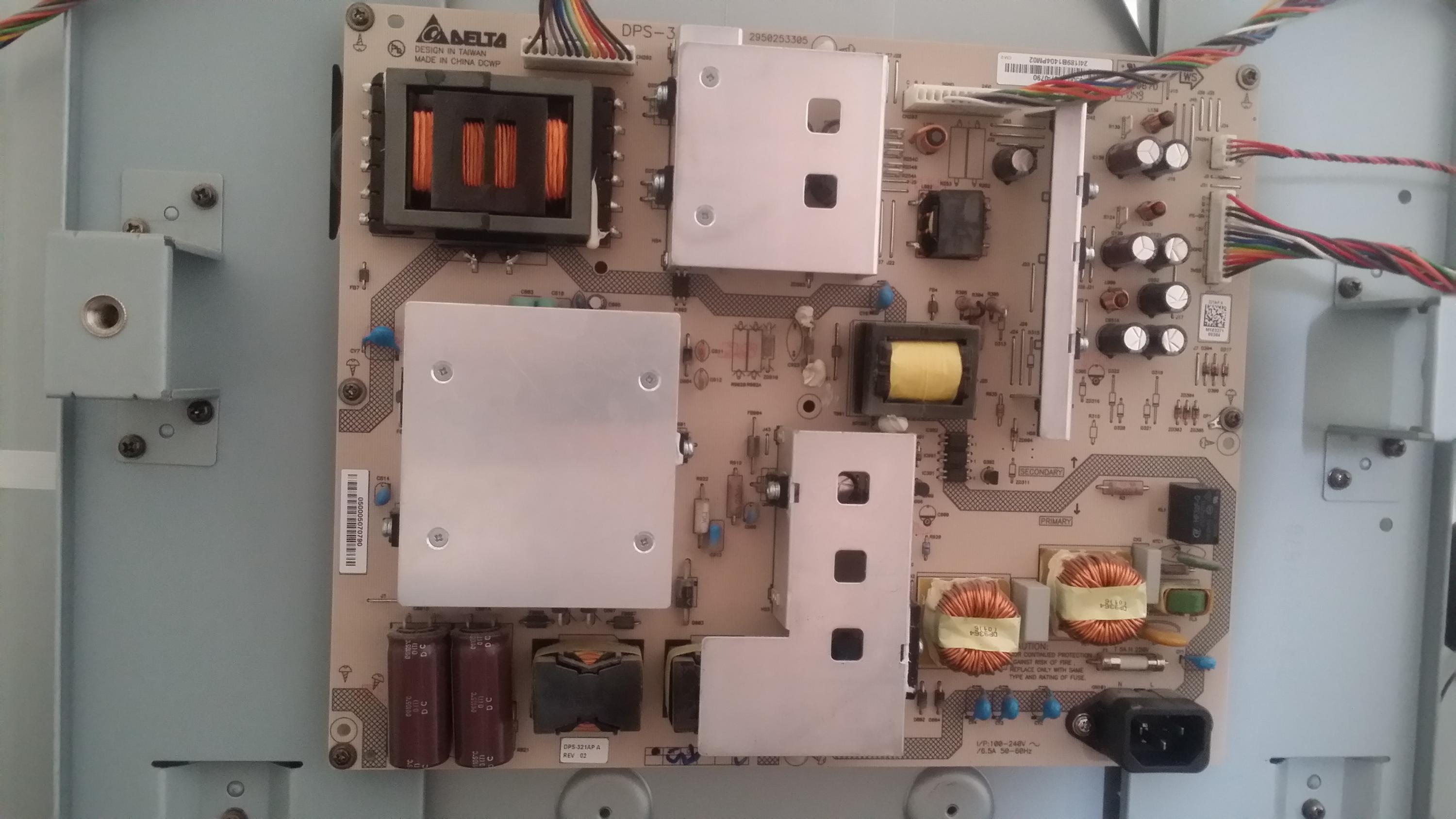

          Having Issues getting good pics Will these work? And no where would I locate a Schematic?

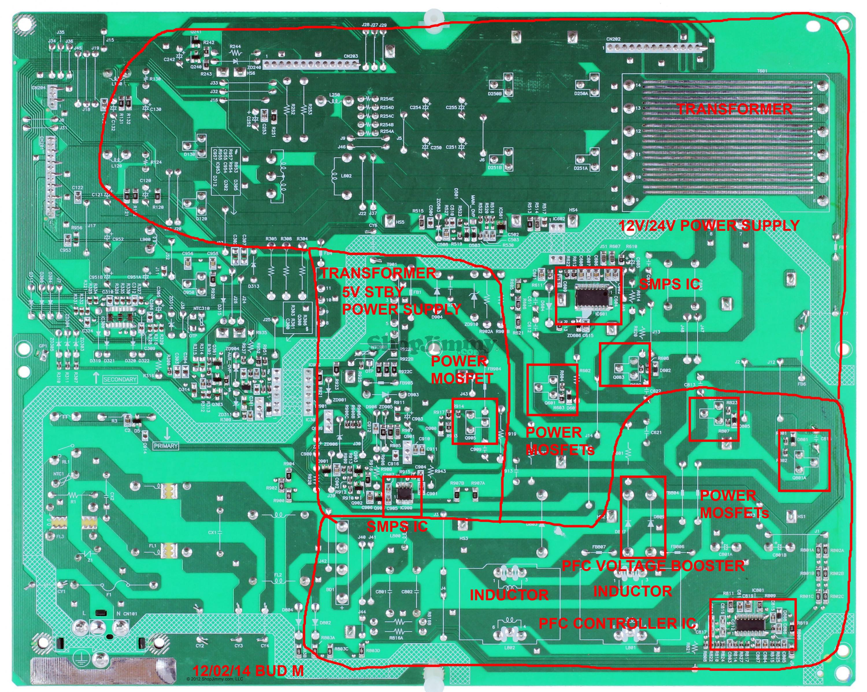

              Power supply board is made by DELTA, so DELTA will not allow VIZIO to publish the SCH for the board.
              What you can do is to look up the spec sheet of the ICs which will tell you what they are and how to use them, then you just trace out the connections.
              The board has Standby power supply: IC900, Q905.
              PFC Voltage Booster: IC801, Q801A, Q801B, D803, D807, D809.
              12V/24V Power supply: IC601, Q601, Q603.

                    Clicking and humming form PFC Inductor is not normal.
                    Is the PS_ON signal from the main board steady? The RL1 relay should click on.
                    When you jump 5VSTBY to PS_ON, the PFC Voltage booster will kick on which then you should see the DC Voltage on the main filter cap to jump up from 160VDC to >360VDC, at the same time the 12V/24V will also be turned on.
                    You will not see any backlights until you jump the 5VSTBY to the BL_ON pin (I do not remember which one of the 'A', 'B', or 'C' pin is the BL_ON pin), so do not worry about the backlights right now.
                    You may be better off with new board.
