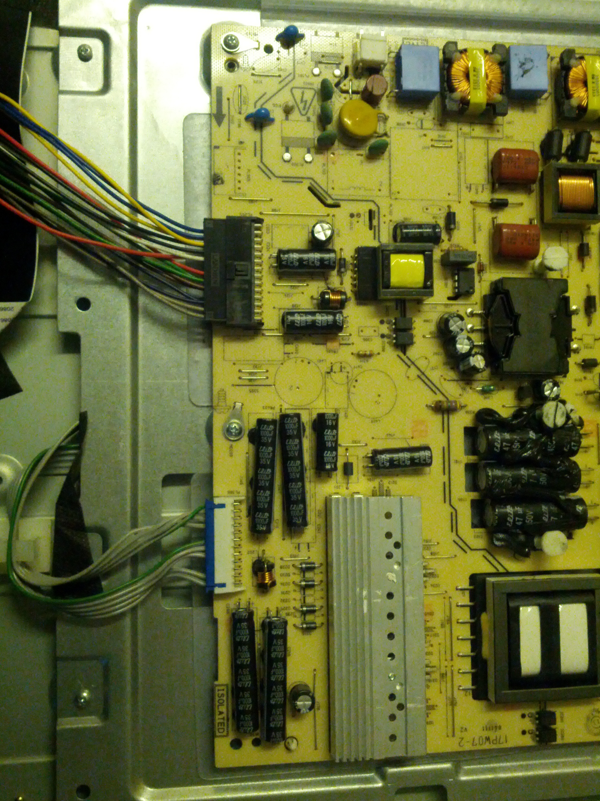

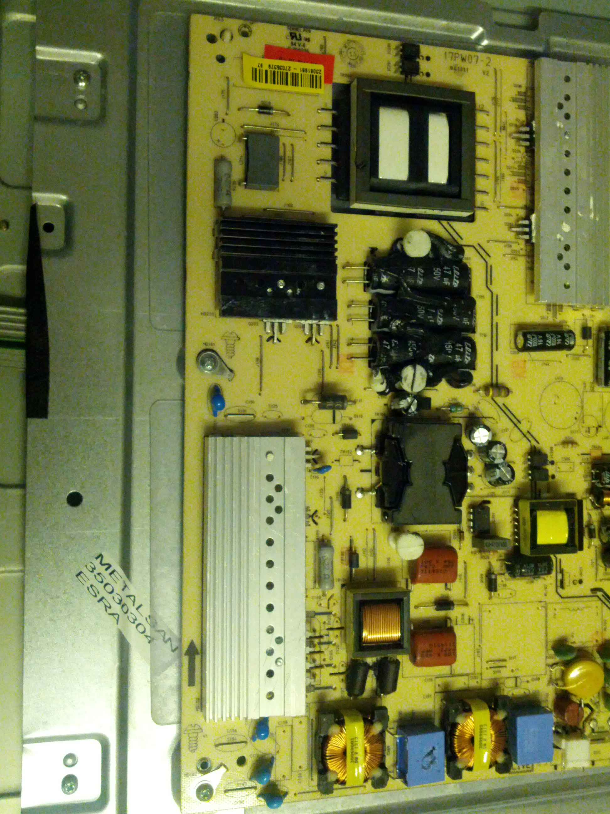

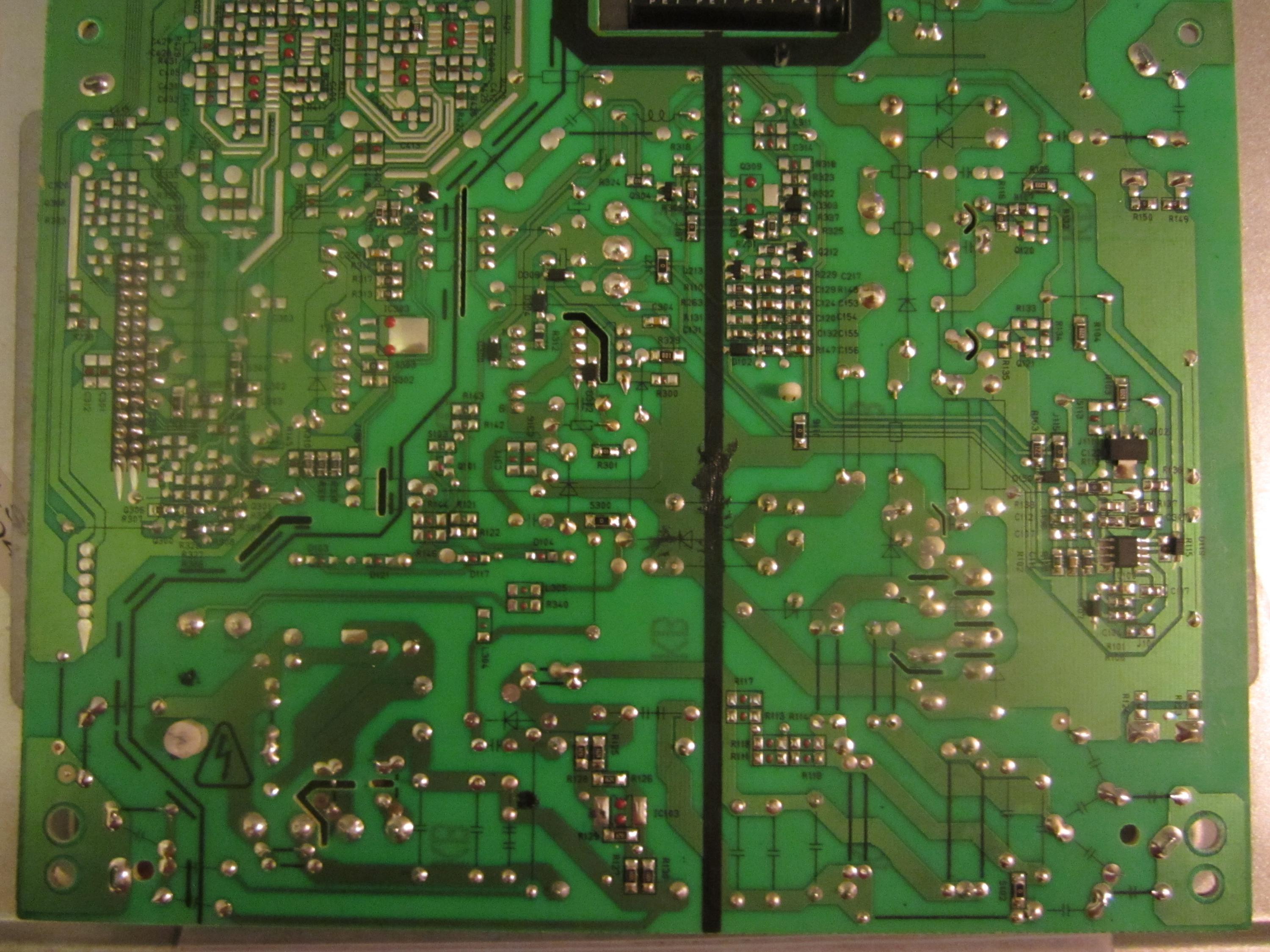

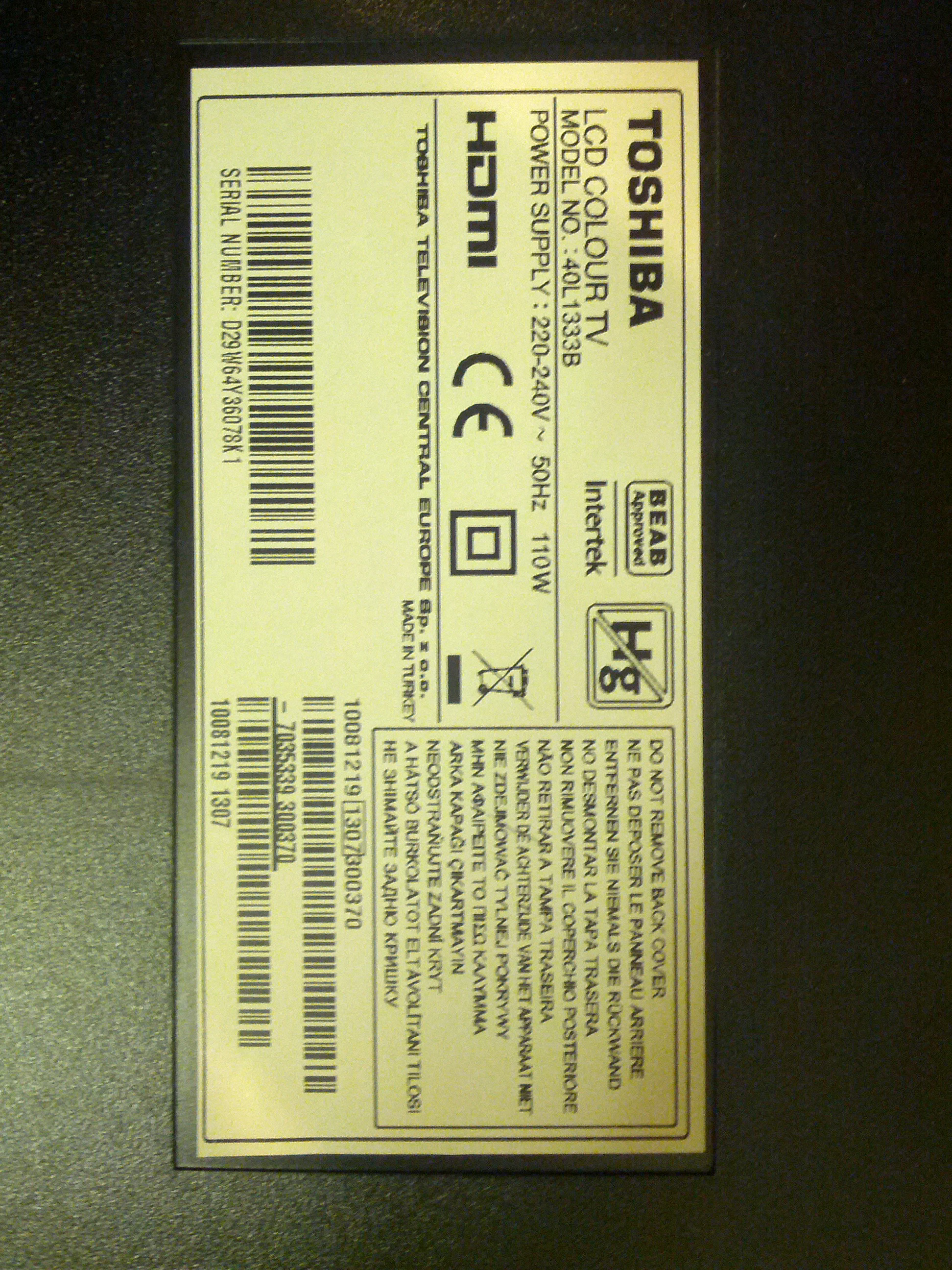

    Hey guys. This is my first post, so please be gentle! My Toshiba 40L1333b LED TV has sound but no picture. I used a flashlight in the dark and the picture is barely visible. It's about 1 year old.
    Re: Toshiba LED TV 40L1333b sound no picture
    Can we get good clear and focused pictures of both sides of the power supply board?

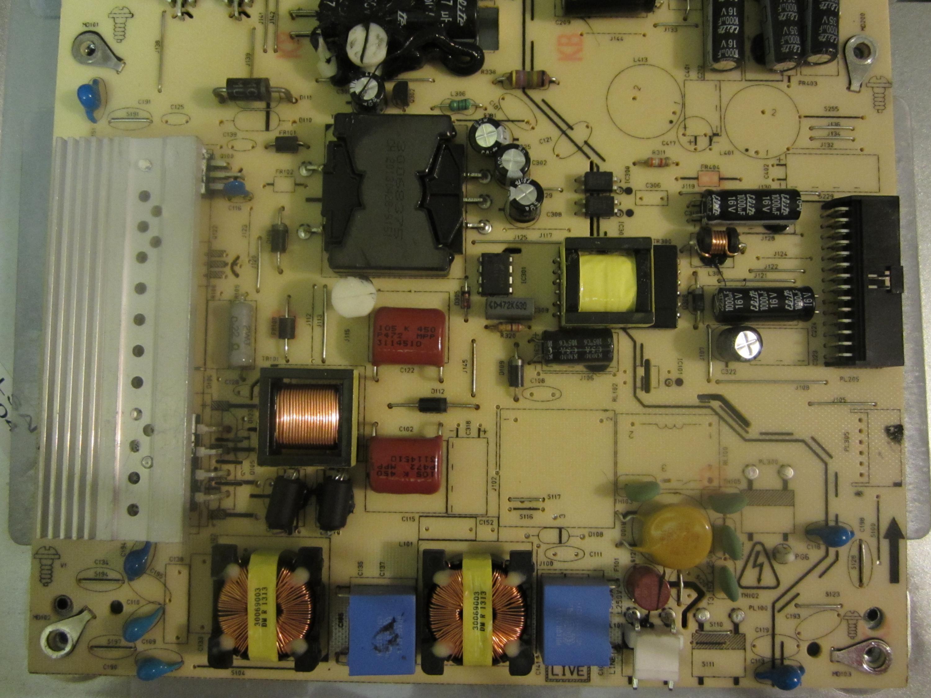

      Sorry about the delay. Thanks for your help.

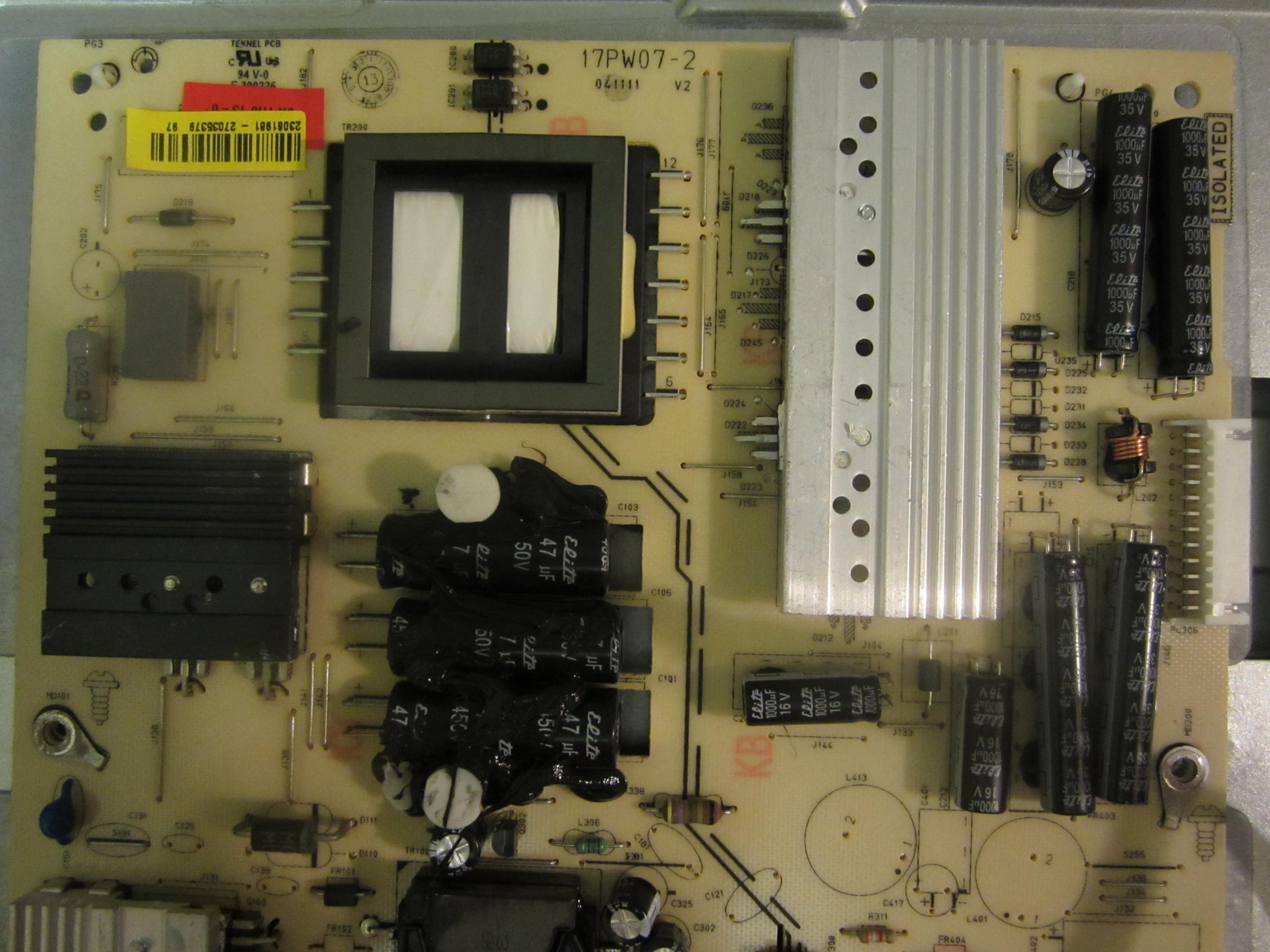

        Please provide the focused straight shot of both sides of the board, I need to be able to trace the connection and clearly see the components and traces, thanks!
          Vestel design set, not made by Toshiba. What's the part # on the power board? (17PW... or 17IPS... usually)
            Nevermind, just saw it, 17PW07-2.
              Pictures are not clear enough however I can make out 17PW07-2

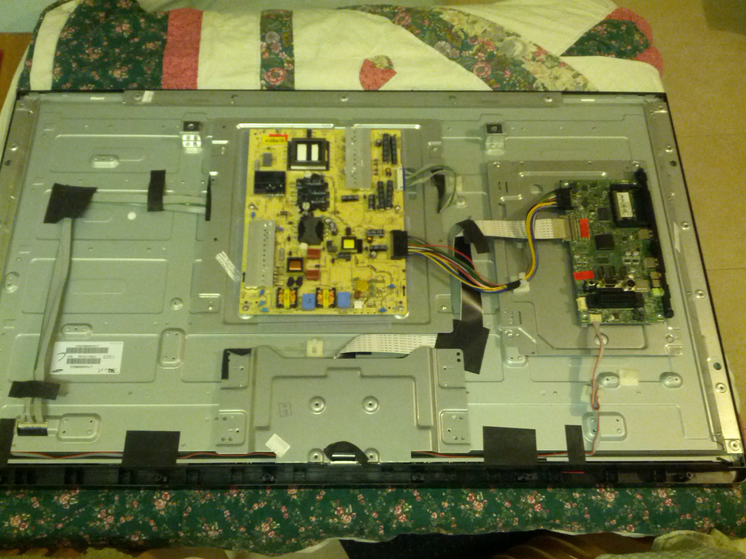

                  So lads. I've never opened up a TV before so schematics and the like is pretty much double Dutch to me! In layman terms what's the problem and can it be fixed?
                    Do you have a digital multimeter available to do some tests?
                      Perhaps you need to do some reading? There are more and more threads re led
                      tvs with no back light - weak point seems to be the led strings either burnt out
                      or a wire trapped and eventually shorting however it may not be a quick fix.
                      Try and learn some of the names of components on the board.
                      Pictures really are not clear enough- for trouble shooting they need to be clear enough for us to read the board part numbers
                      Here is a recent post - not yet solved.
                      https://www.badcaps.net/forum/showthread.php?t=41983
                      When Budm asked for both sides he meant front and back.

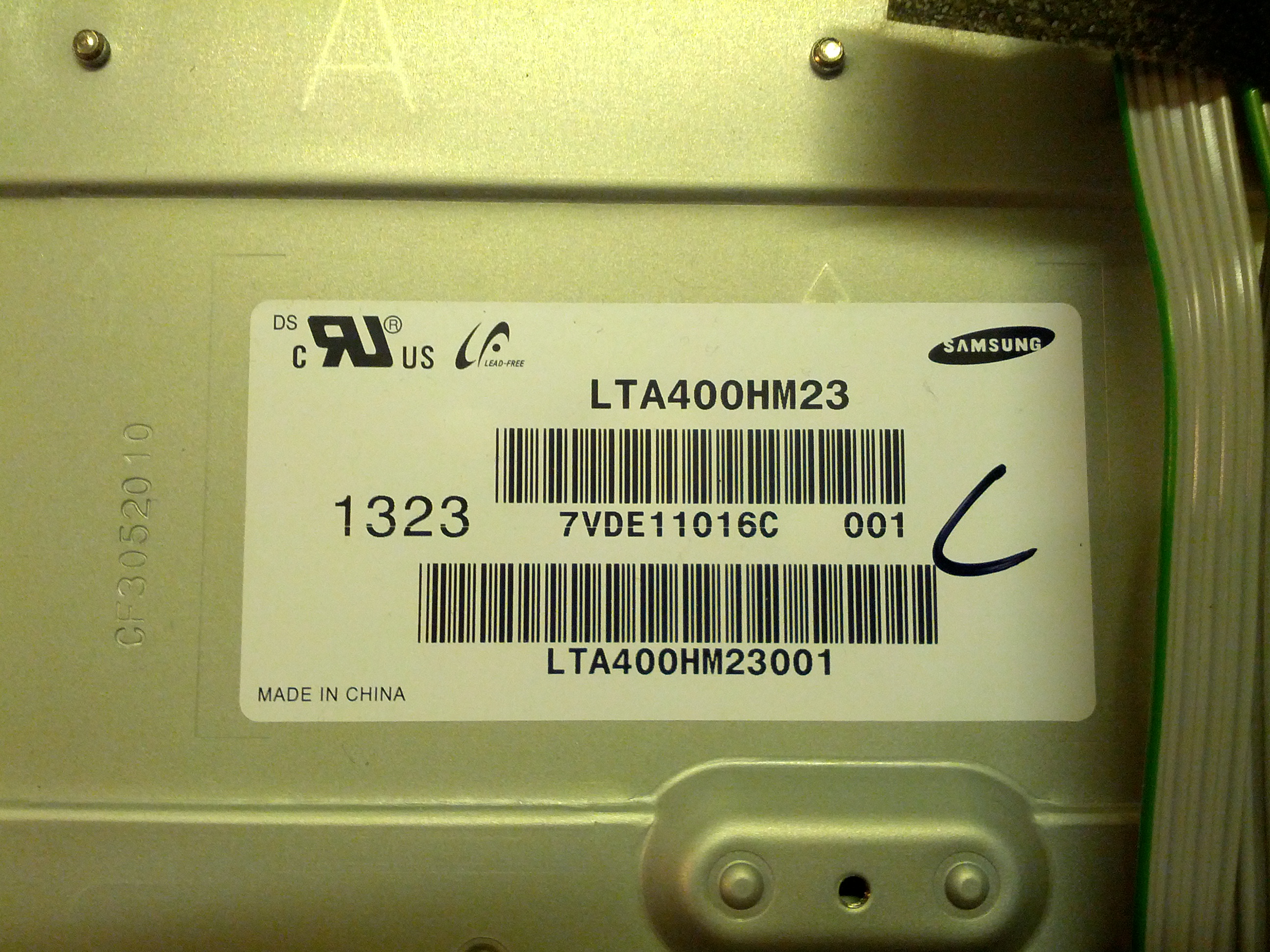

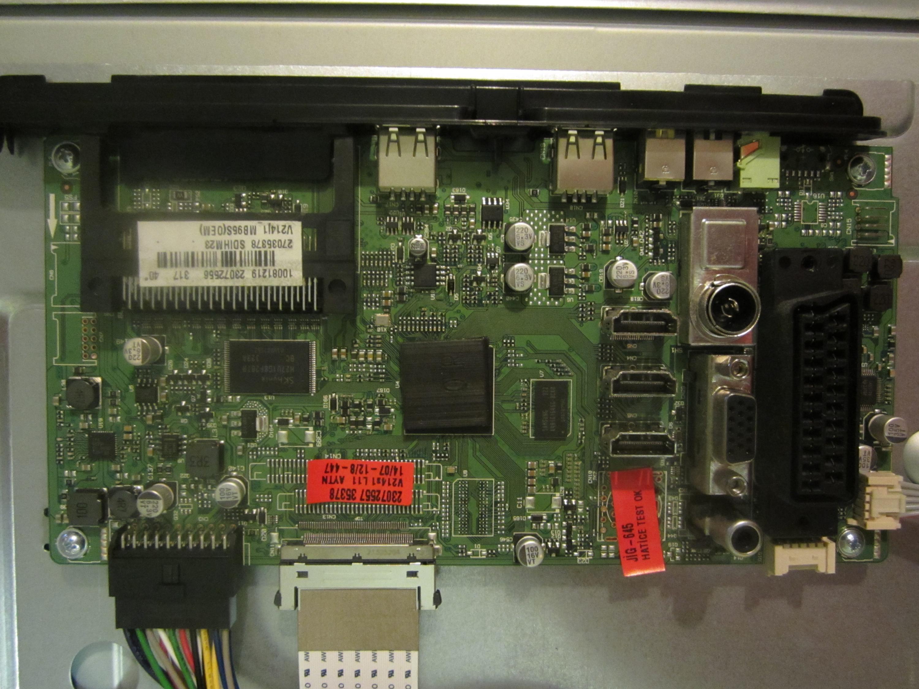

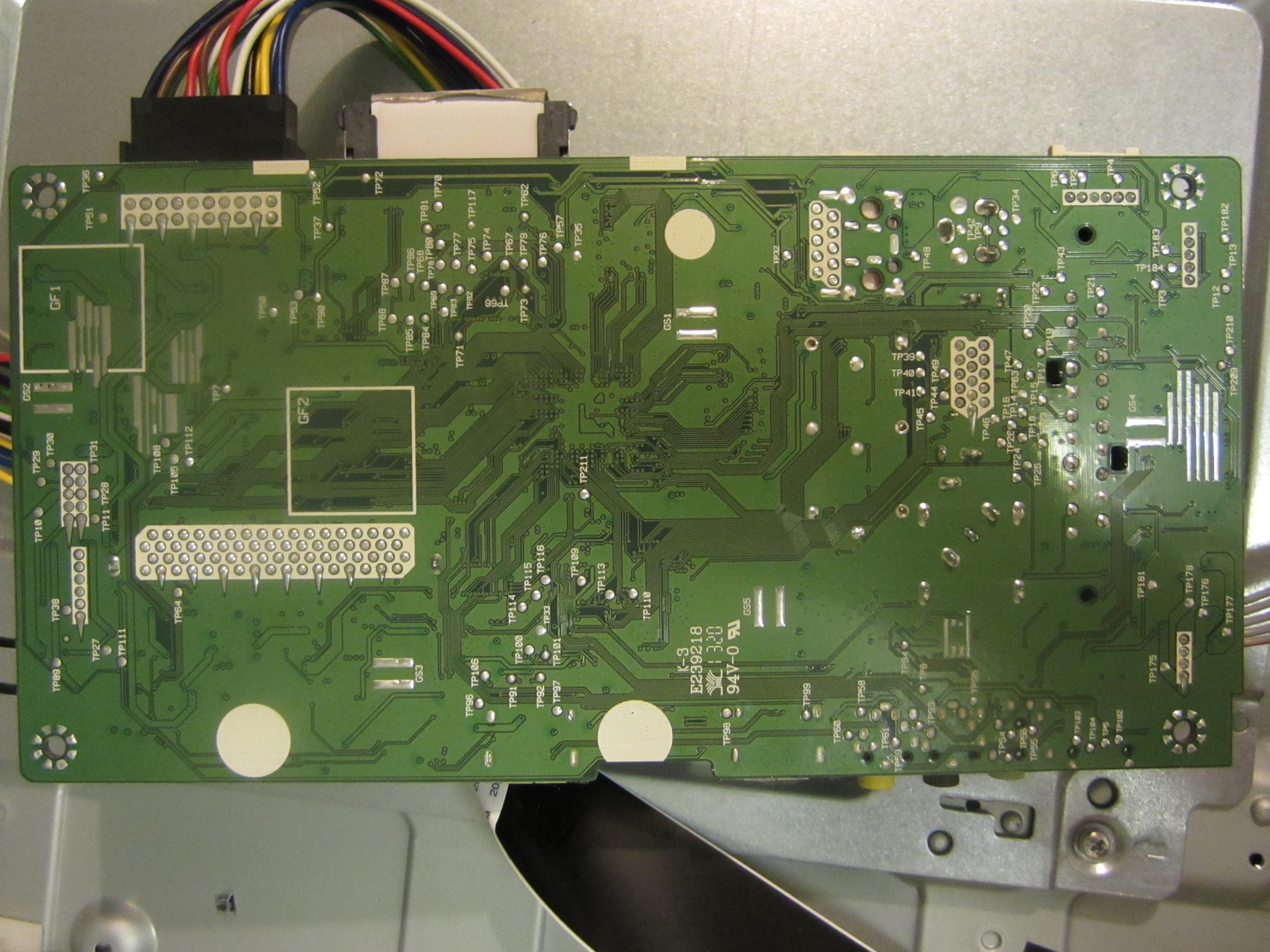

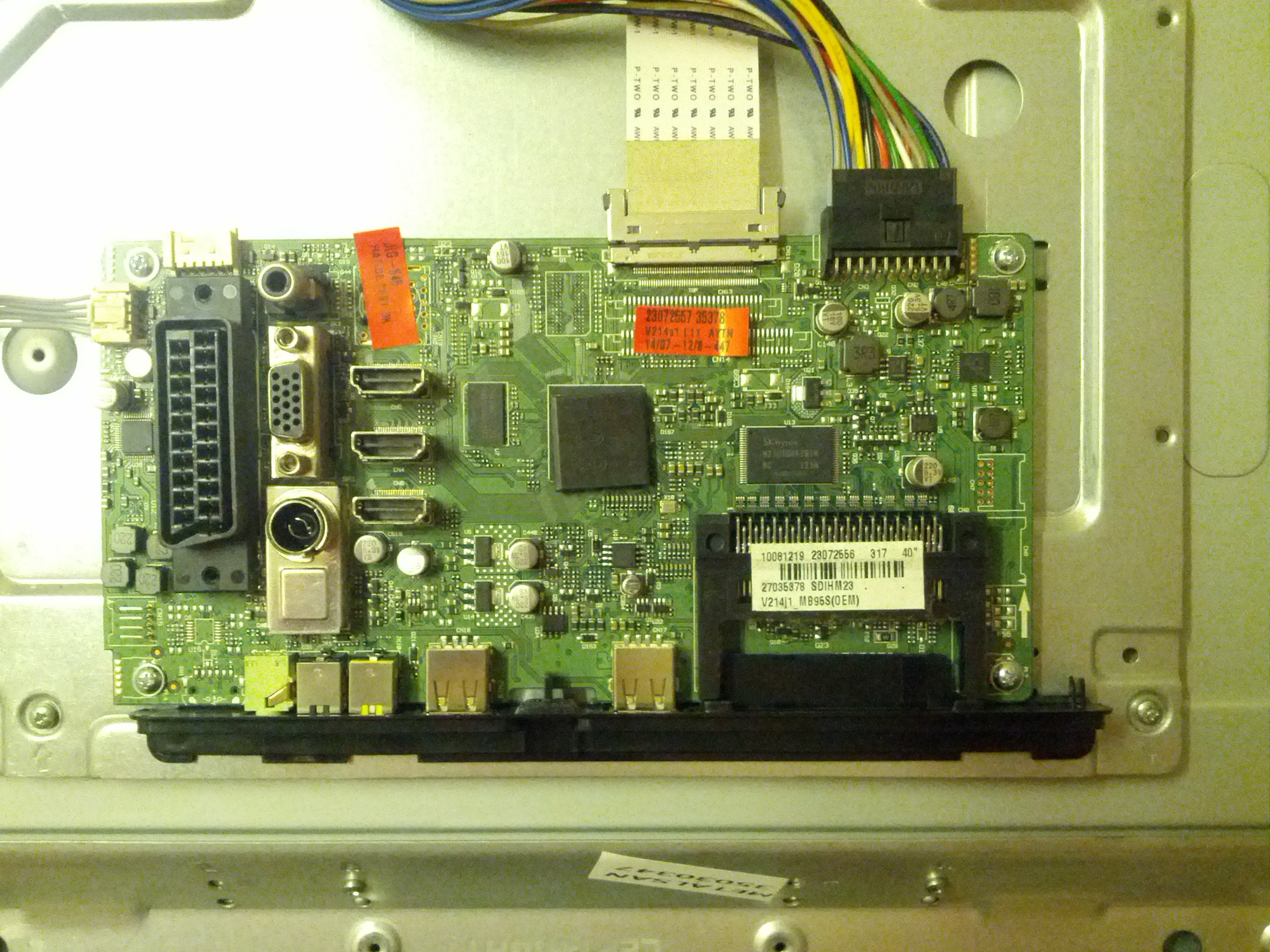

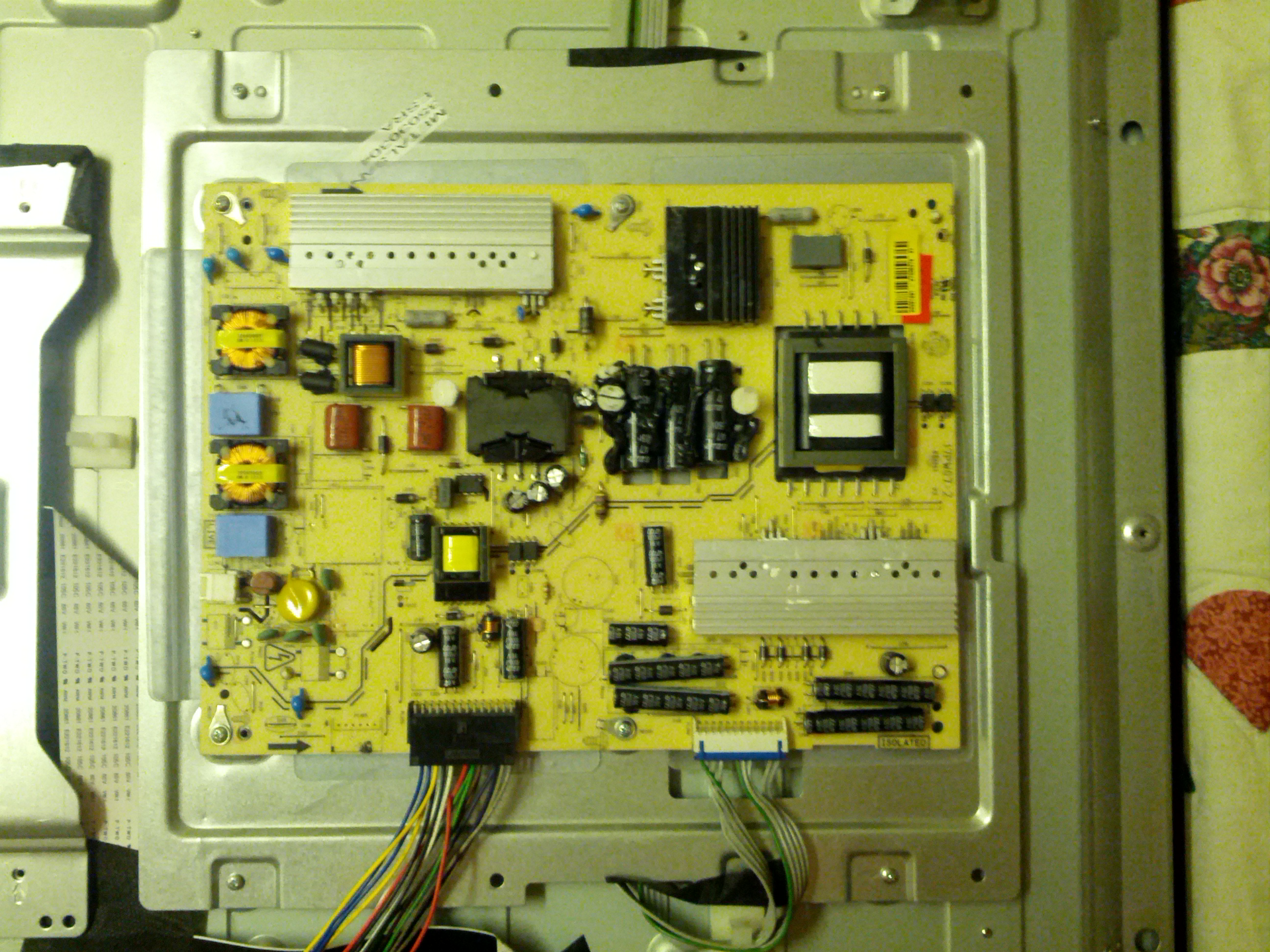

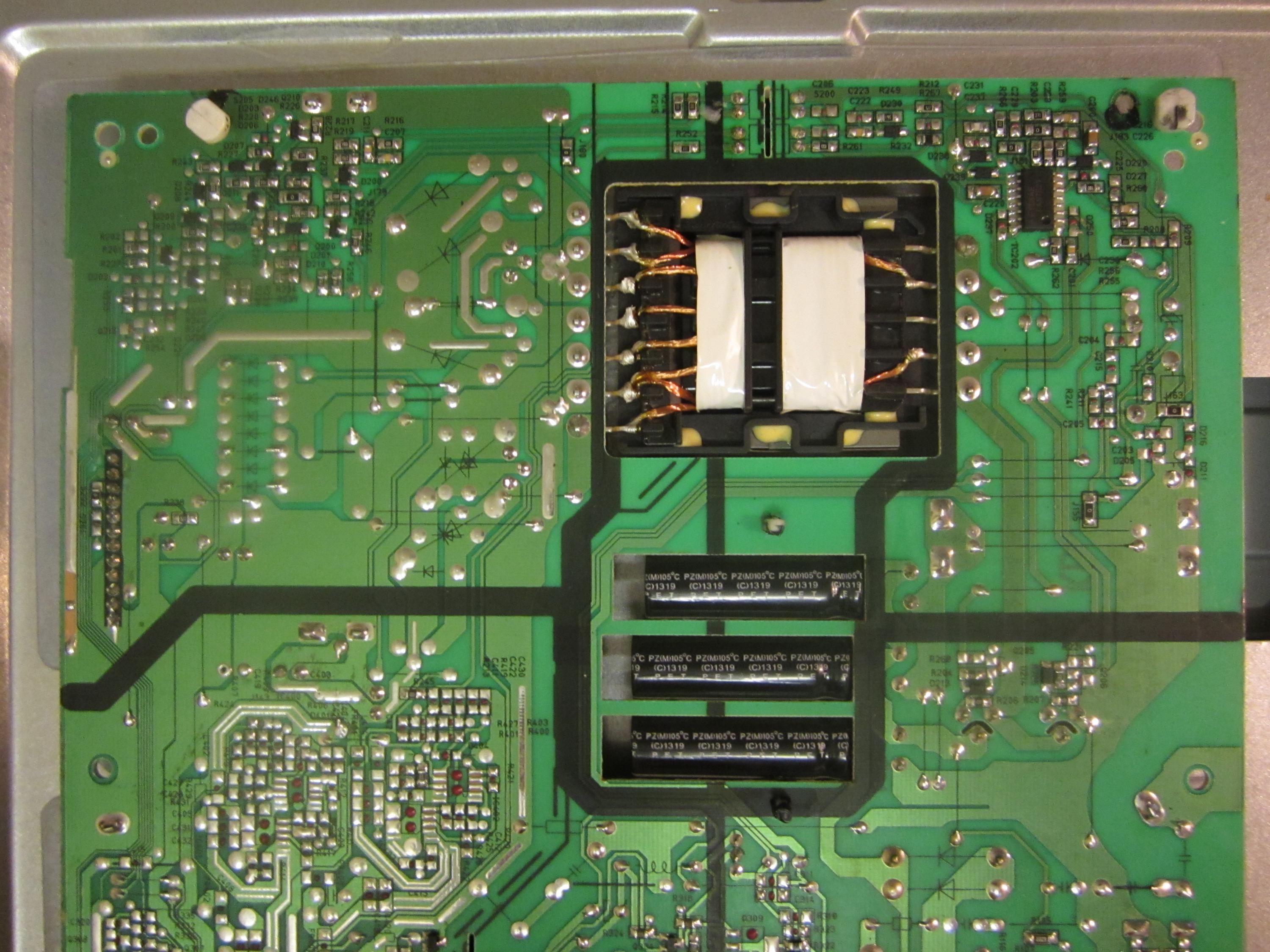

                        I hope these help. Yes I do have a multimeter.
                                Originally posted by Rickig
                                Did anyone ever get to the bottom of this tosh?
                                Hello please read this thread and watch the video:
                                https://www.badcaps.net/forum/showthread.php?t=52928
                                Common issue with these Panels is the little connector blocks that link the Led strings break down and fail so you need to bridge them over with solid wire and then test the Leds.
