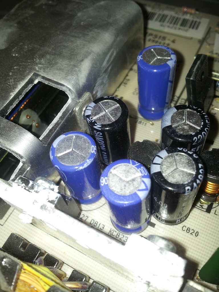

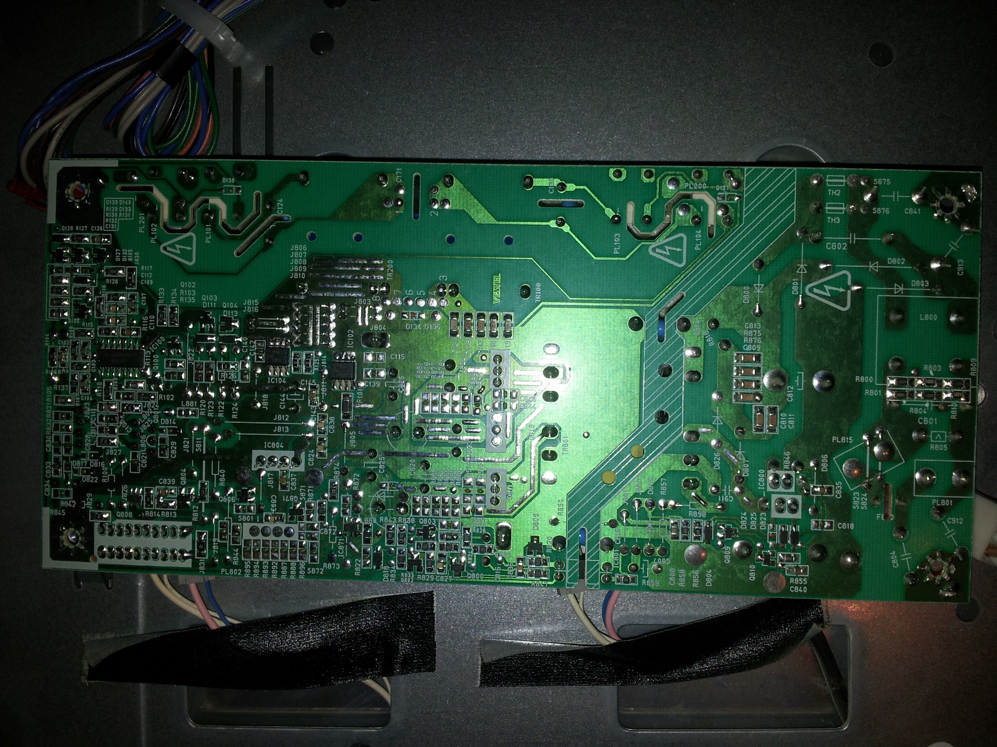

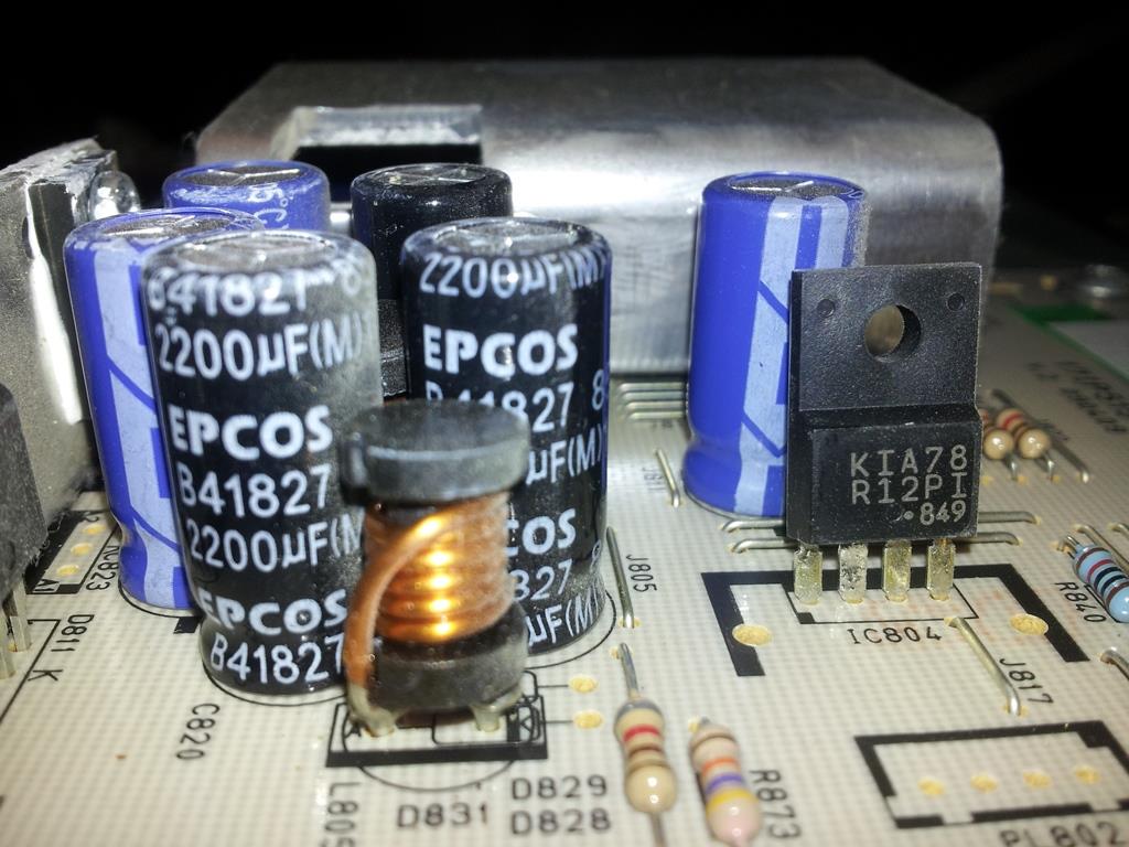

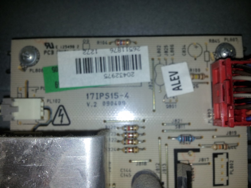

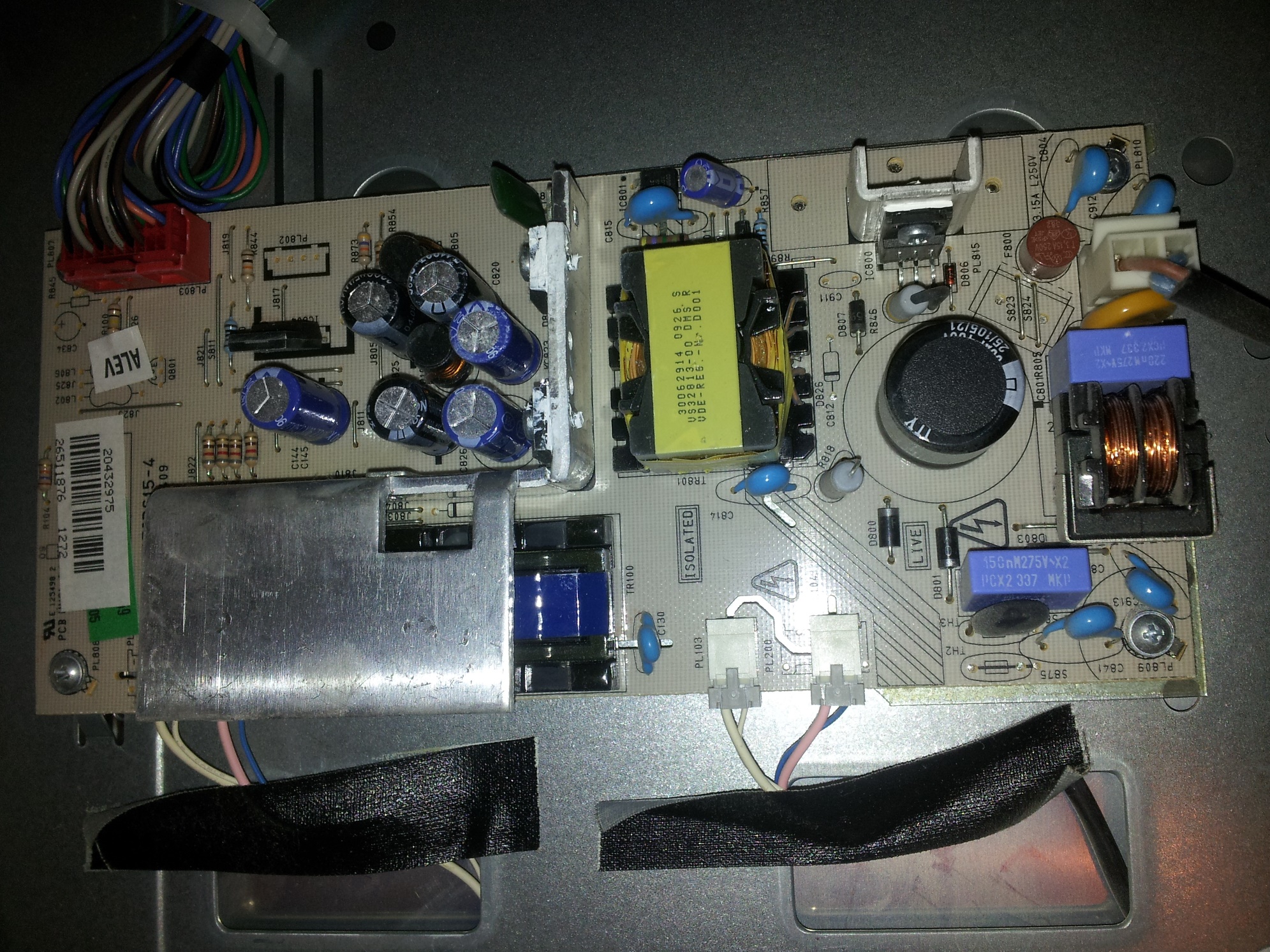

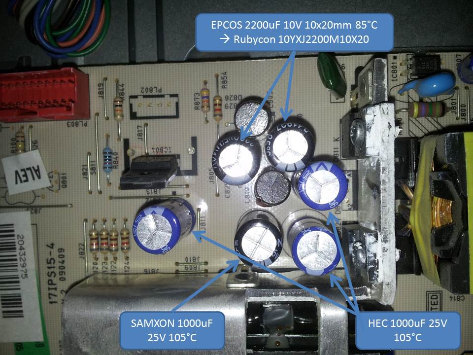

    In the best tradition of tinkering I've pulled it apart and there are two boards. The PSU/Inverter board and mainboard.
    PSU board is marked as 171PS15-4 V2 080409 - it's clean with no scorch or leakage marks - as is the mainboard. Anyhow, I have looked at the good/bad caps list and through the TV repairs threads and looking at the make of caps on the PSU board (and the age of the TV) I figured this is probably a good place to start as while none are damaged or bulging (and none appear to be open/short circuit) only one (Samxon) appears on the good list. Two if you count the Chang Primary(?) as well.
    The others are HEC apart from two EPCOS rated at 85C perhaps due to size? The EPCOS and have a lower resistance (800K not 2-3 M ohms) if that has any bearing.
    If recapping is a good starting point, I'm thinking it would be best to recap the board with 105C caps all over (why would you leave 85C caps above the heatsink anyway?!)
    So if I'm correct and recapping is a good starting place, I'd appreciate your views on these as a selection
    EPCOS B41827 2200uF 10v

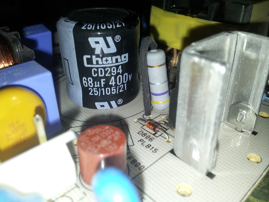

    Chang CD295 68uF 400V 25/105/21
    Replace with
    Nichicon LGJ2G680MELZ20 - 68uF 400V (620mA ripple)

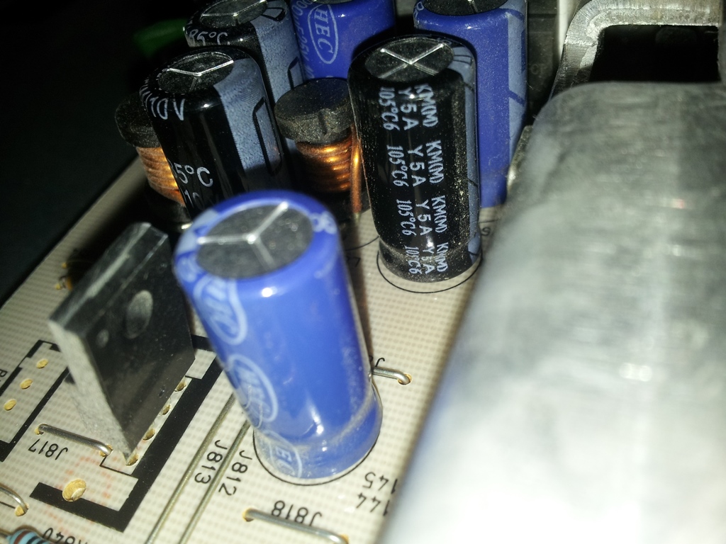

    Note: The existing caps (in the group shot) are all 10mm dia and two are really tight - I'm hoping I can squeeze one in as a 12.5mm without getting too 'creative' as I'm also limited for height - there is about 6-7mm to the case with the present 20mm caps. Any issues from the longer leads if it needs to be 'pursuaded'?

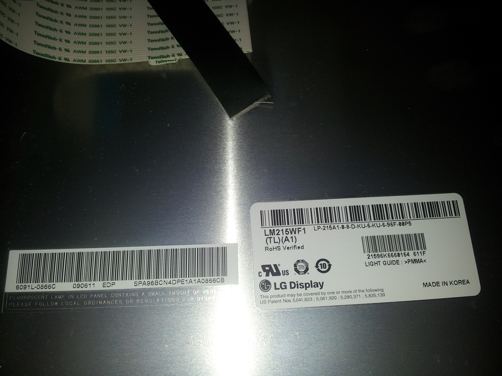

          Stripped down some more and the tubes are within the panel, not visible, and its made by LG.
          Is it worth stripping down further - will I be able to get new tubes?

            Re: TV Recap - Bush (Alba) LCD2280f1080P
            Hmm, it's a bit more modern than the Samsung 22" panel I was thinking of. Also LG usually use EEFL which is more reliable than CCFL so maybe it's ok in that regard. Hard to be sure.

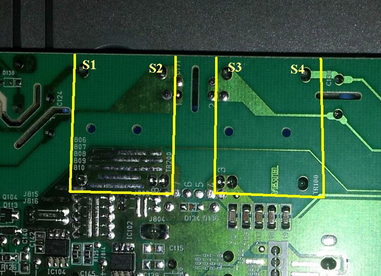

              Yes - I wasnt sure about the power led going out perhaps RJARRRPCGP will come back and tell us what he recalled?
              In the meantime to get it out of the way you can test the secondary windings on the inverter transformers. Not seen this board but think they may be as marked.
              Power off -Meter on ohms 2000 - test S1 to S2 and S3 to S4
                  Both test the same - 840 ohms... hopefully more good news?

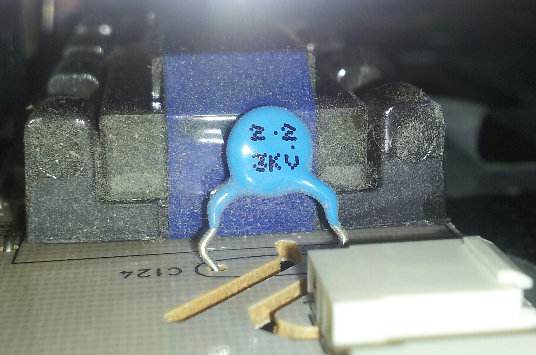

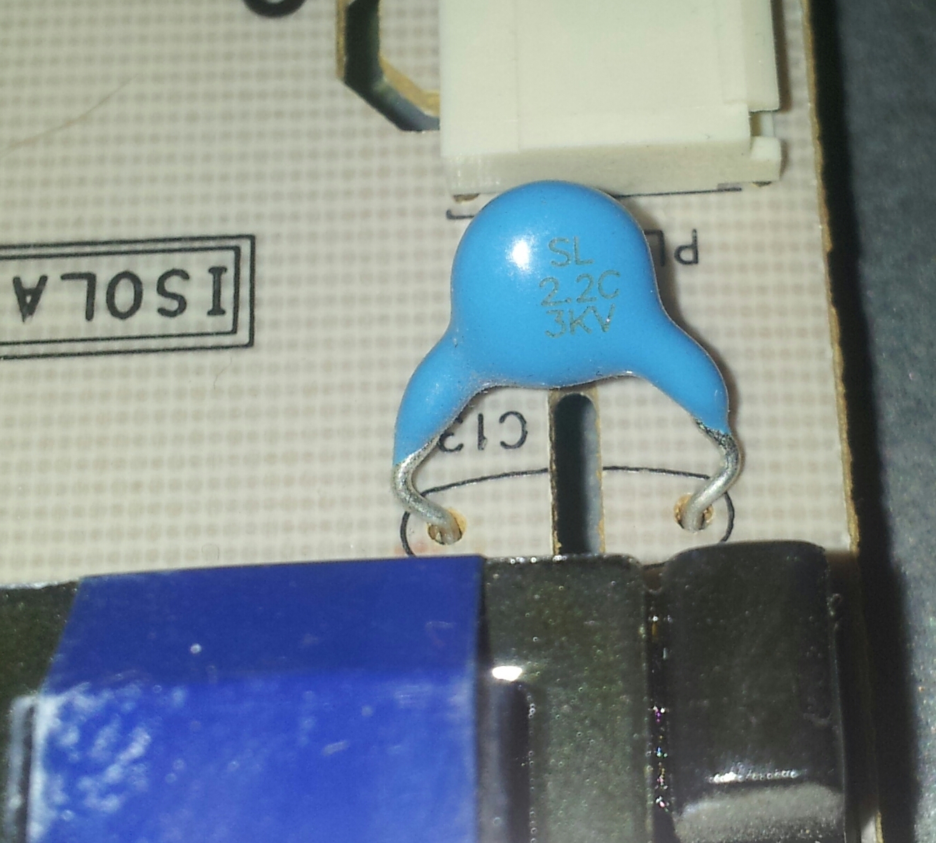

                  on 171PS15-4 check C171 if fitted and C124 &130 high voltage ceramic capacitors
                  if you can not test them replace them know to give this fault
                  different set can have different values post pictures of them so we can id them
                  Looks like C171 not fitted
                  C124 and C130 are SL 2.2C 3Kv
                  Last edited by nigeH; 11-12-2014, 06:47 AM. Reason: oops... removed inline images (as suggested)

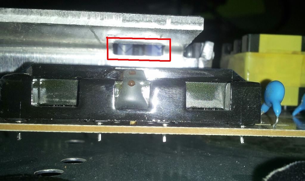

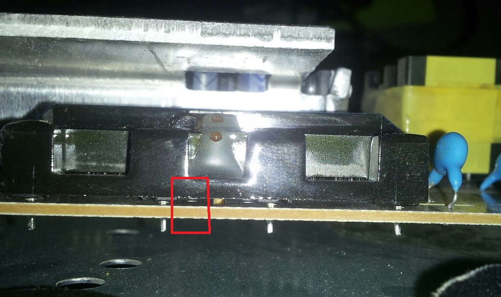

                    C171 is on the other side of the board likely just under the heatsink? (it pairs with C130)

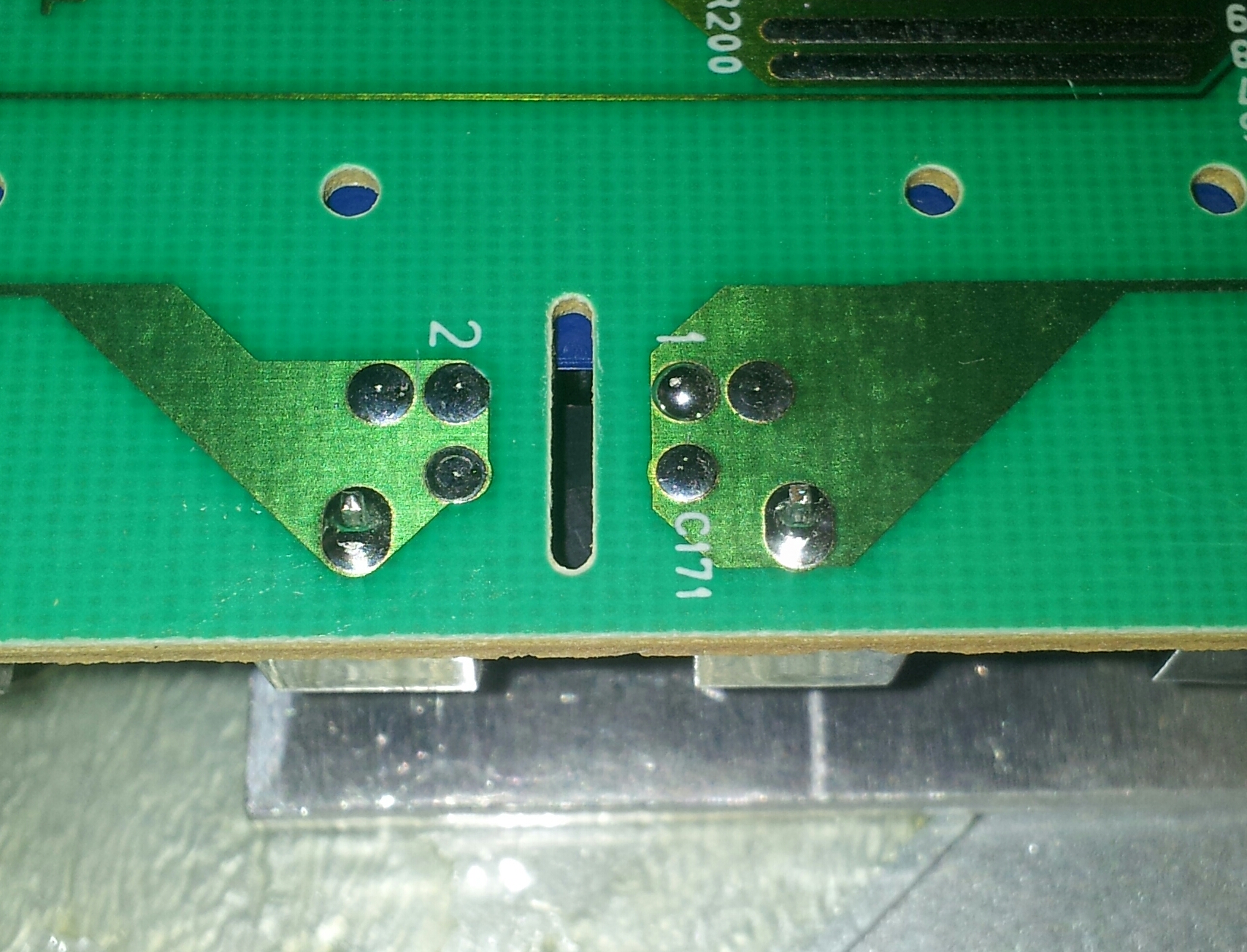

                      No cap that I can see... unless it's under the grey blob? (one blob with two brown 'buttons' appear each side in the middle)
                      Side and top shots of C171 location

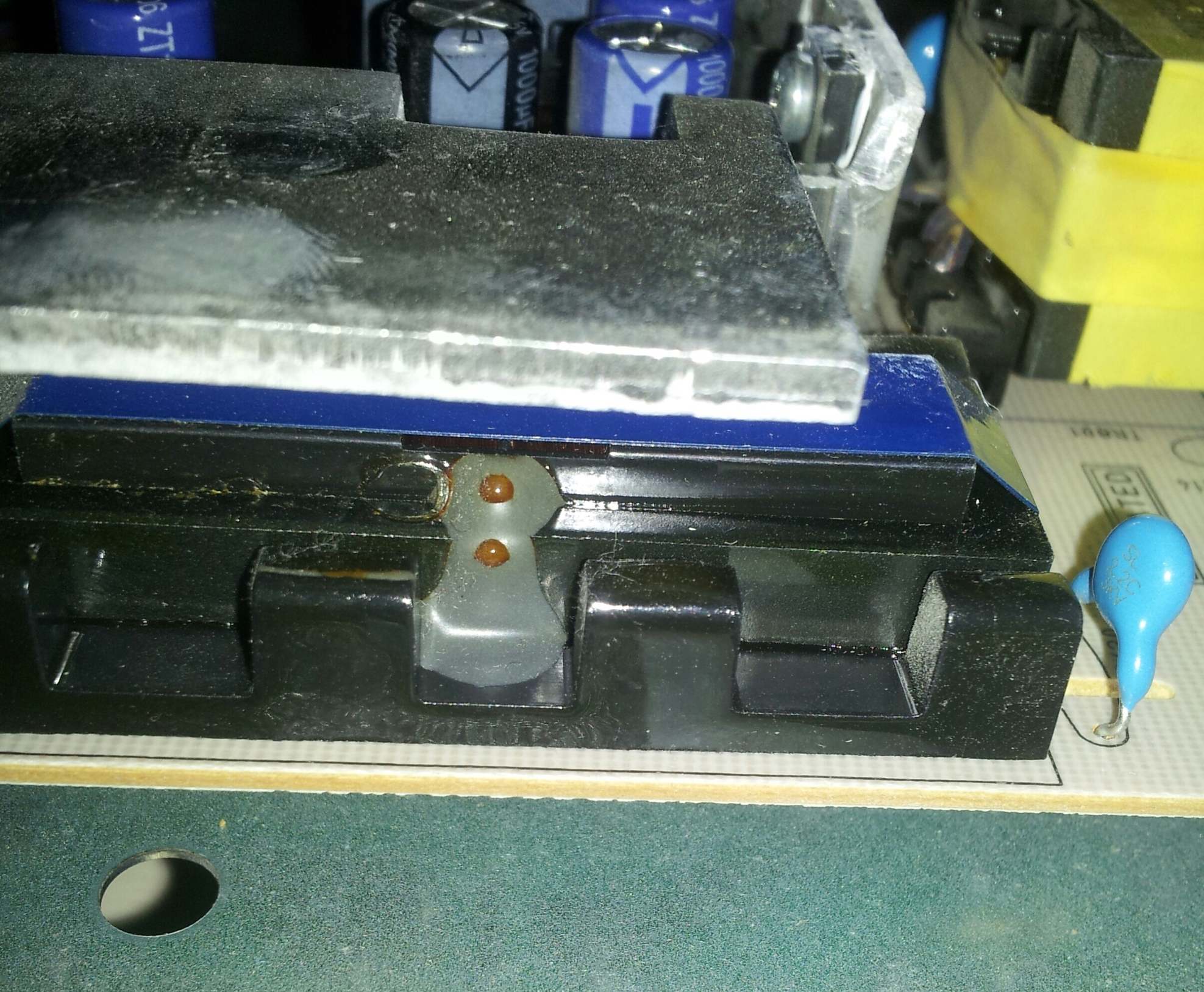

                        We were mislead a bit C171 is not a ceramic you can see the top of it.
                        You can understand why it would fail cooked in an oven!!.
                          Sorry that's my bad photography - it's a gap in the heatsink showing the top of the electrolytics.
                          The gap under the transformer where C171 is marked is in red here - all I can see are the pads. I think!
                          Would C171 be surface mount on the other side (lots of stuff is on that side)?

                            Well I think your picture are really good - I see now that cap I marked is the one behind the heatsink looking out through the hole. I find it hard to believe there is a C171 but
                            on the otherhand it does look like there is a wire in the solder joints on the back of the board where it would be. At the moment I dont think getting the heatsink off to look is a priority. Re do the solder joints and see what that brings.

                              Broken out iron and desoldering pump... removed the two caps C124 and C130. Both test open circuit on the DVM and don't respond on a jerry rigged RC tester like a good 2.2nF (or other various test sizes I used) - I think they are dead.
                              Now a little help needed to find a match please I've not found the original part but can anyone confirm it's a 2.2nF? Don't think there's much doubt about the 3Kv rating
                              Found these - is either suitable or one better than the other in this application?
                                Are you sure the blue ballast cap is 2.2nF? That will be 220pF which way too high of the capacitance for the ballast cap.
                                https://www.badcaps.net/forum/attach...3&d=1415795064
                                That is 2.2pF 3KV ballast cap, the capacitance is so low that your meter cannot read it, when these cap goes bad they will have leakage resistance and turns light brown due to heat.

                                  @Budm I am having difficulty finding 2.2pF 3Kv caps for what I would call a reasonable price. 5pF 3Kv are available here: http://www.ebay.co.uk/itm/5pf-3kv-HI...item19da5411b5
                                  Could he use those instead?
                                  If he used 2 of each in series would that be better - 2.5pF or is that too messy.
                                    You must use the right capacitance but two in series should be ok.
                                      Thanks budm - no not at all sure!
                                      Dug a little deeper in the datasheet and see mention of 3000M resistance (explains the OL meter reading) and fire retardant coating!
                                      Caps still blue - is it worth changing to eliminate - if I can find one?
