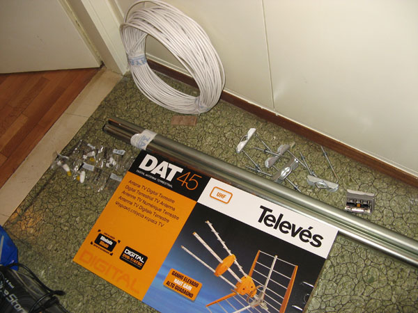

    I am gonna put a new tv antenna . Maybe i will get a digital box also later.

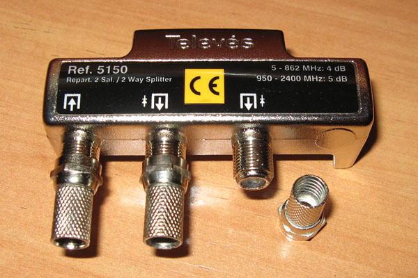

    I want to make it for two tvs and they gave me this splitter . I am not very familiar with this stuff and ask your assistance. Is this really what i want or do i need something better?
    basically i am looking to have a very good signal in the end cos this stuff wasnt cheap.

    DAT 45 best in the business. Splitter too. Only worry should be if it's "too good" as it were you'll have to increase the cable length to improve the reception perhaps.

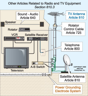

                            Do you intend to ground the antenna? Not that my sat dish is grounded, but here in DE it should be grounded by separate outdoor cable (if no lightning protection is installed) and put on the potential equalization panel with at least 6mm solid coper wire.
                            no i didnt ground any antenna but i try to always make sure it is not the highest. in this case the antenna will actually be on the balcony with line of sight to the transmitters. the 2m aluminium pipe mast will be clamped to the railings. i do this tomorrow. the problem is the roof is not flat and i dont like to be up there, also i cant make fine adjustments up there that way which is necessary for this type of antenna. if it sucks i will go on the roof.
                            the other pipe mast is for the office AIS antenna. i will do that next week. i might hijack someone elses mast and clamp it on. see how that goes

                              • Paul S
                                • Sep 2006
                                • 326
                                Re: TV Antenna setup
                                You should always ground any external antenna.
                                The mast or tripod should be grounded, as well as any cable before it enters the building. Here is an example of a coaxial ground block:
                                Radio Shack Grounding Block
                                You need to pound a copper ground rod into the ground. 4 feet is too short, 6 feet is better. Attach all grounds to this rod.
                                My brother is a electrical contractor and a short wave radio operator, he told me all of this.

                                  Oh shit, I've had an antenna mast on my roof for years and it's not grounded at all. I totally forgot to install the grounding cable. I might as well call it a lightning rod
                                  Right now my antenna is 300 ohms, but has a balun on it to make it a 75 ohm coax. Problem is, the balun is likely no longer water tight, and I'm using cheap RG-59 cable.
                                  I want to get a bigger antenna soon so I can receive HD over the air, but I basically need a whole new system since the rotator is dead also.

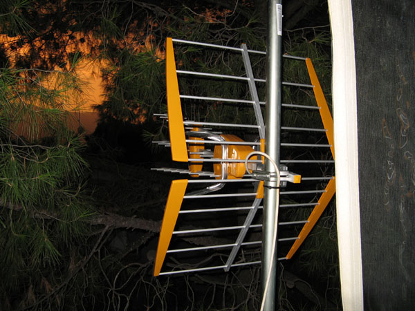

                                    Originally posted by Fizzycapola
                                    DAT 45 best in the business..
                                    now i agree. this is a superb antenna, easily the best i have installed.

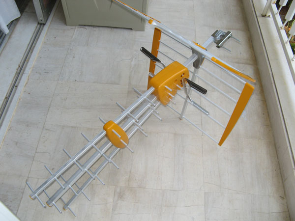

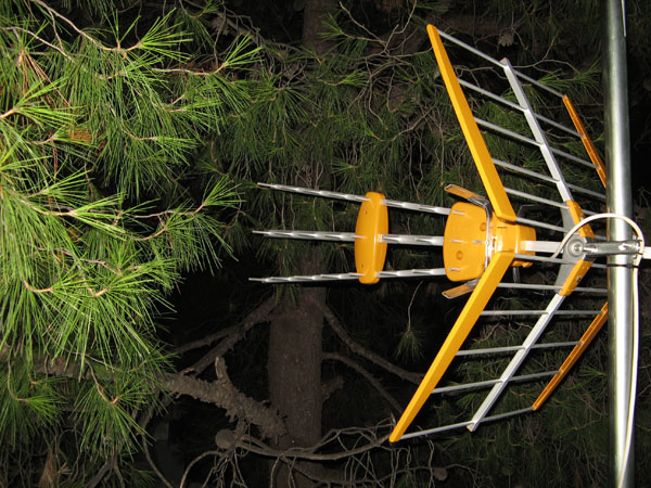

                                      the pictures make it look a bit fucked up, like there is waaaay more tree in the way, anyway there is gonna be a little trimming next weekend. Its not really necessary though, picture is excellent.
                                      looking down the antenna at the transmitters.
                                      the kit actually includes a wrench which is pretty cool of them. what it did not include was one screw on cable connector though.....i used one from the splitter which is not installed yet. ran out of time for this weekend.
                                      The only other complaint i have is that it is quite difficult to access the cable connector on the antenna once that unit is clipped in. Like of course i forgot to tape up the connector so it was a little pain to get it off. The whole unit is not unclipping once it is clipped in.
