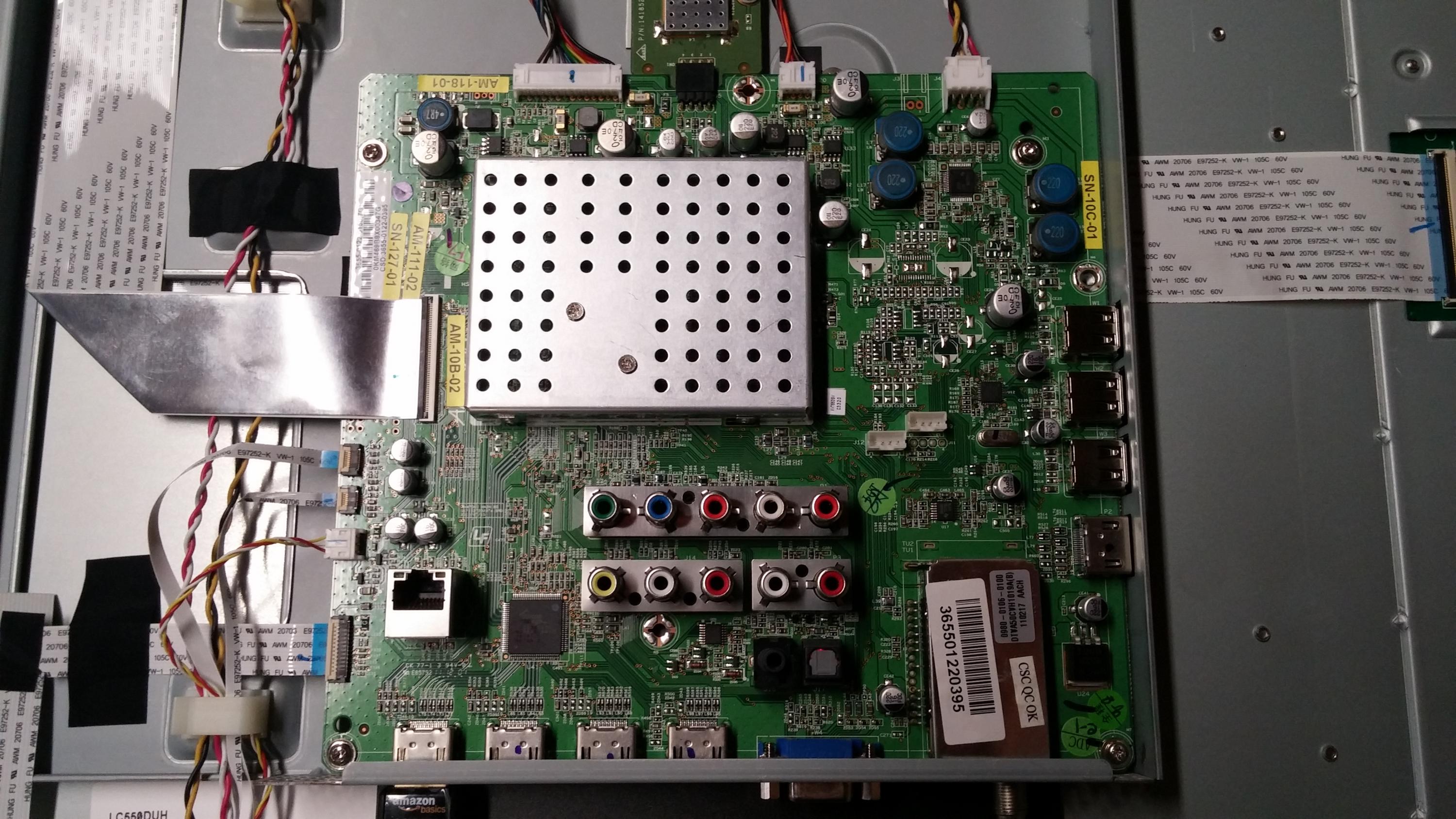

    I am working on a Vizio XVT553SV 55" LED tv and not sure what else to check.
    When I received the set it would power on with backlight and sound but would not display any picture.
    Voltages to the mainboard:
    Fuse
    F1-12.14 vdc
    F3-5.07 vdc
    F8-18.34 vdc
    Tcon:
    TF1-12.03 vdc
    F4-5.12 vdc
    After reading many posts about these and mainboard issues that they have I purchased a replacement mainboard from a "refurbished tv broke in transit" on ebay.
    After swapping the mainboard out I have the exact same symptoms as above.
    Does this possibly sound like a bad Tcon or panel? or another defective mainboard.
    Any help would be great on anything else to check.
    Thanks in advance,
    Ryan

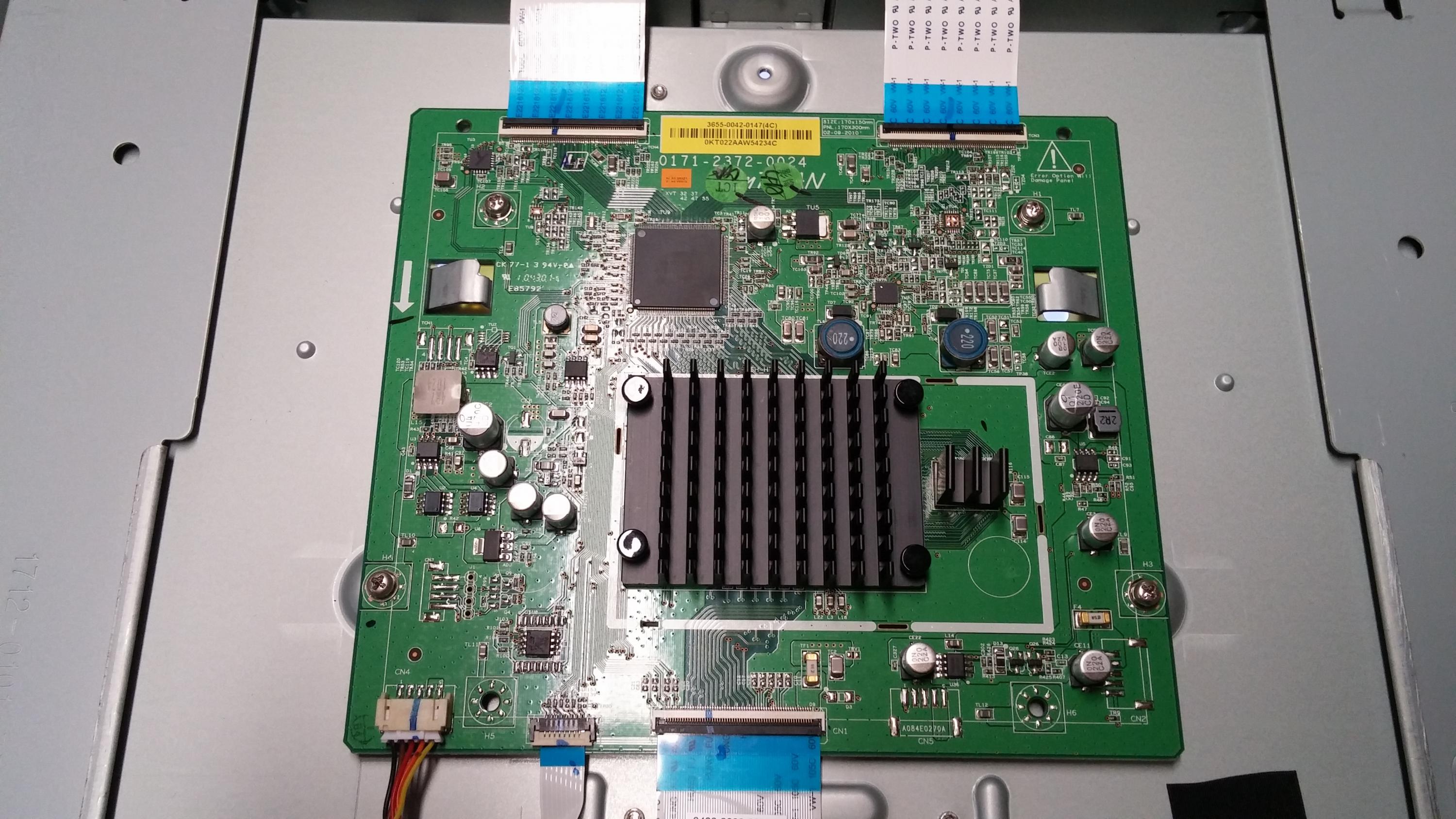

    I can't say for sure but it could be a bad T-Con board, I suggest checking all connectors/cables at the T-con board to ensure the ribbon cables are fully seated.

      Re: Vizio XVT553SV Powers on and has sound but no picture
      Thanks for the reply MisterD.
      I reseated the ribbons and connectors with no change.
      I had the set on for a couple of hours (with no change to the picture) and noticed the large black heatsink was cool to the touch (room temperature) I would have assumed it would be a little warm?
      The heatsink is held on with 4 spring loaded clips so I decided to take it off and have a peek underneath.
      It appears that the gpu underneath is simmilar to a laptop gpu. I have had a few laptops that have had the gpu fail from the lead free solder joints breaking under the gpu.
      I am thinking of trying a reflow (heatgun) and see if anything changes.
      Any thoughts before I try?
        Did you successfully reflowed a gpu from a laptop before? That chip looks alot like the Ati chips in laptops but i don't know if its soldered the same way.
          I have been able to get a couple laptops working with a reflow but have only lasted a couple moths before failing again. A full reball of the gpu is recommended.
          But if this would at least show me that it would work I would know that everything else is good before ordering a replacement Tcon.
              After looking at the T-con a little closer I noticed one side of the gpu was pulled up and the board was a little warped in that area. I decided to not even try a reflow and just ordered a replacement board.

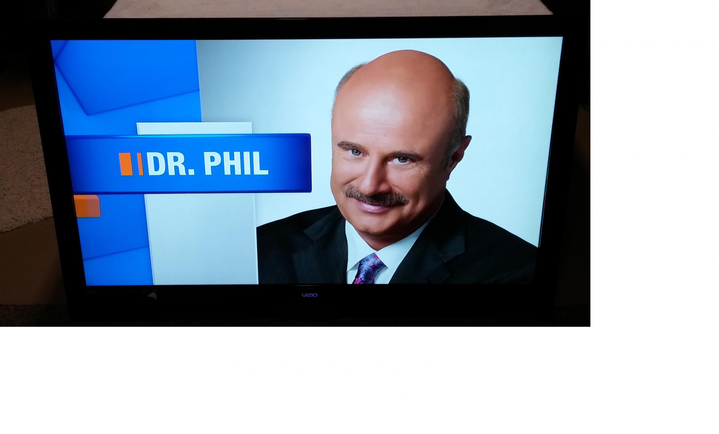

                Wanted to update this.
                I received the replacement T-con and the TV works perfect now.
                Thanks for everyone's help.
                      Originally posted by ringking97
                      thanks for the info but What is a T-CON board??
                      Timing Control board.
                      The board on the top middle of the LCD panel, it is connected between the LCD panel and the main board.
