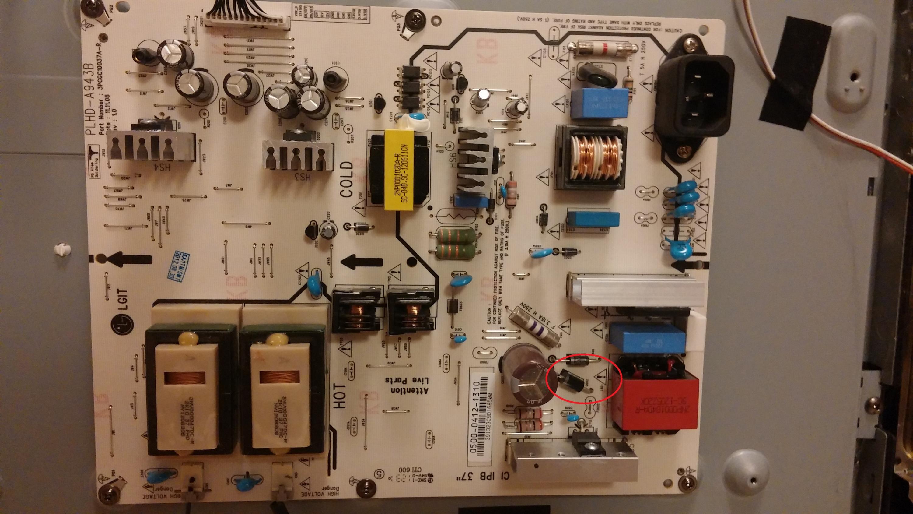

    I was working on this TV and found the problem after replacing the EEPROM.
    Symptoms were would turn on and display dim vizio symbol on the screen. The vizio label would change from amber to white and it would stay running. No display after the initial one on the screen went dark. No menu, sound or picture. Found shorted diode on power supply location D602. Part was labled
    MUR460ax.

      I am curious as to where D602 is in which part of the power supply board.
      • tibimakai
        • Jan 2012
        • 3680
        Re: Vizio E371VL Fixed!
        On mine, it was the upper left diode in a 45 degree position, next to that red transformer(?).
        https://www.badcaps.net/forum/attach...3&d=1383452706

              Can you show us the pictures of where this D602 is? I would think if the power supply has shorted diode the power supply will be in the shutdown protection mode.

                  If I look at the correct board, the D602 is in the PFC Voltage booster section.

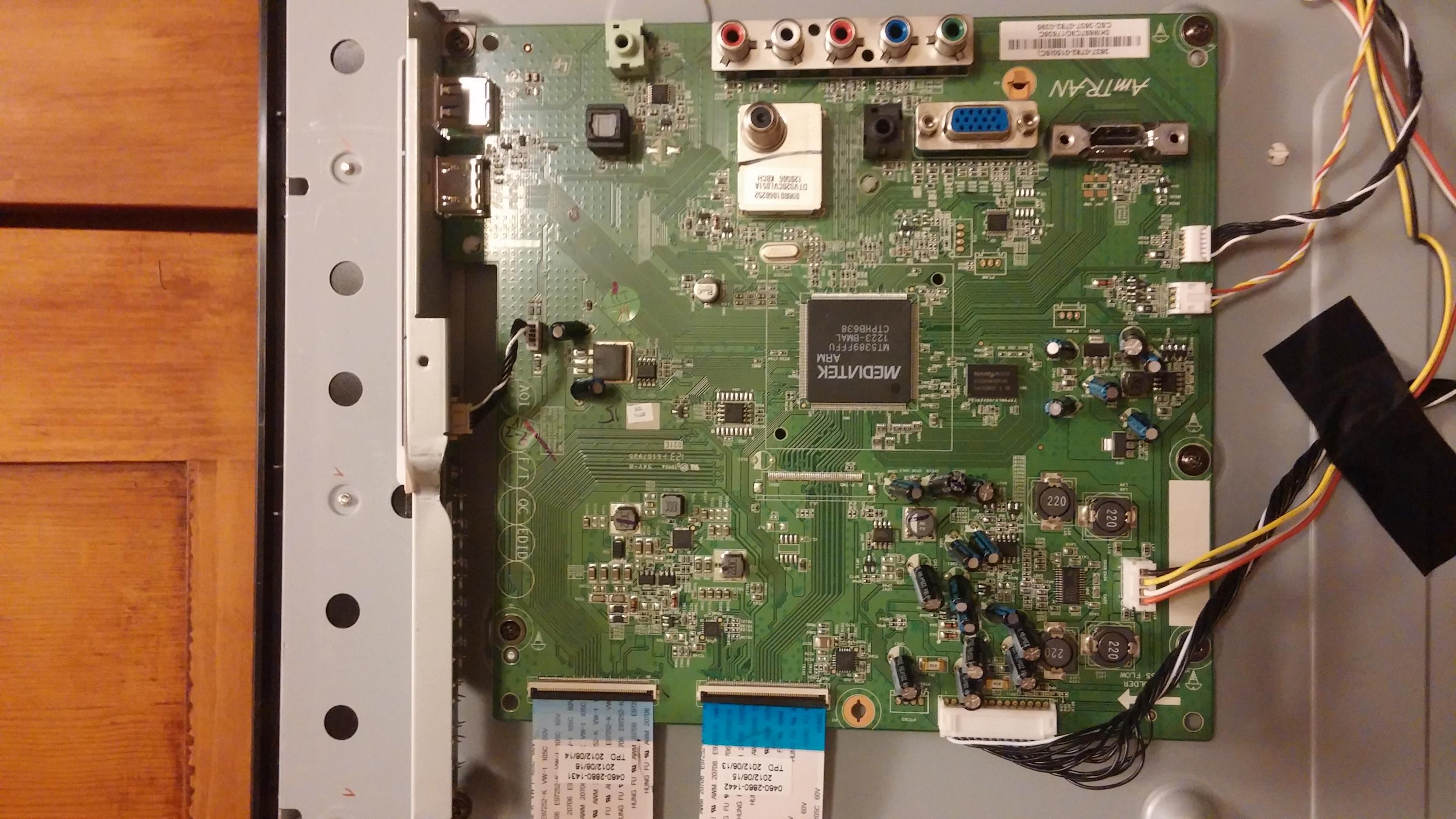

                                      From the look of it, the two ON/OFF pins, one of them has to be for the PS-ON for turning on the rest of the power supply and it is working (the one with 3.3VDC) otherwise you will not have that PFC Boosted Voltage on the main cap, the other ON/OFF (0.3VDC) is probably for the BL-ON for turning on the backlights and it is not working because it is <1VDC.
                                      So the main board is the problem at this point.
                                      There are fuses and Voltage regulator ICs on the main board that you should check.
