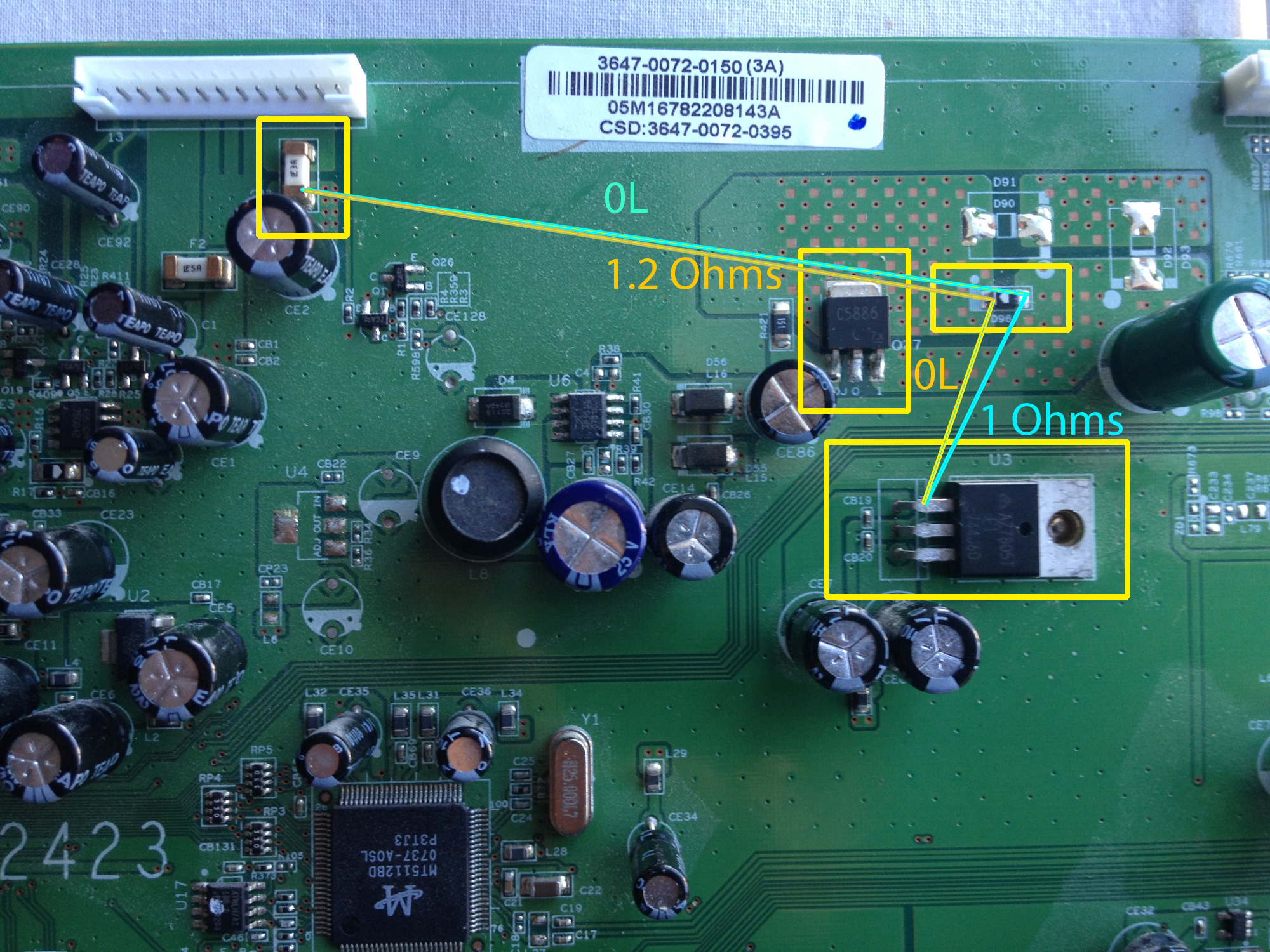

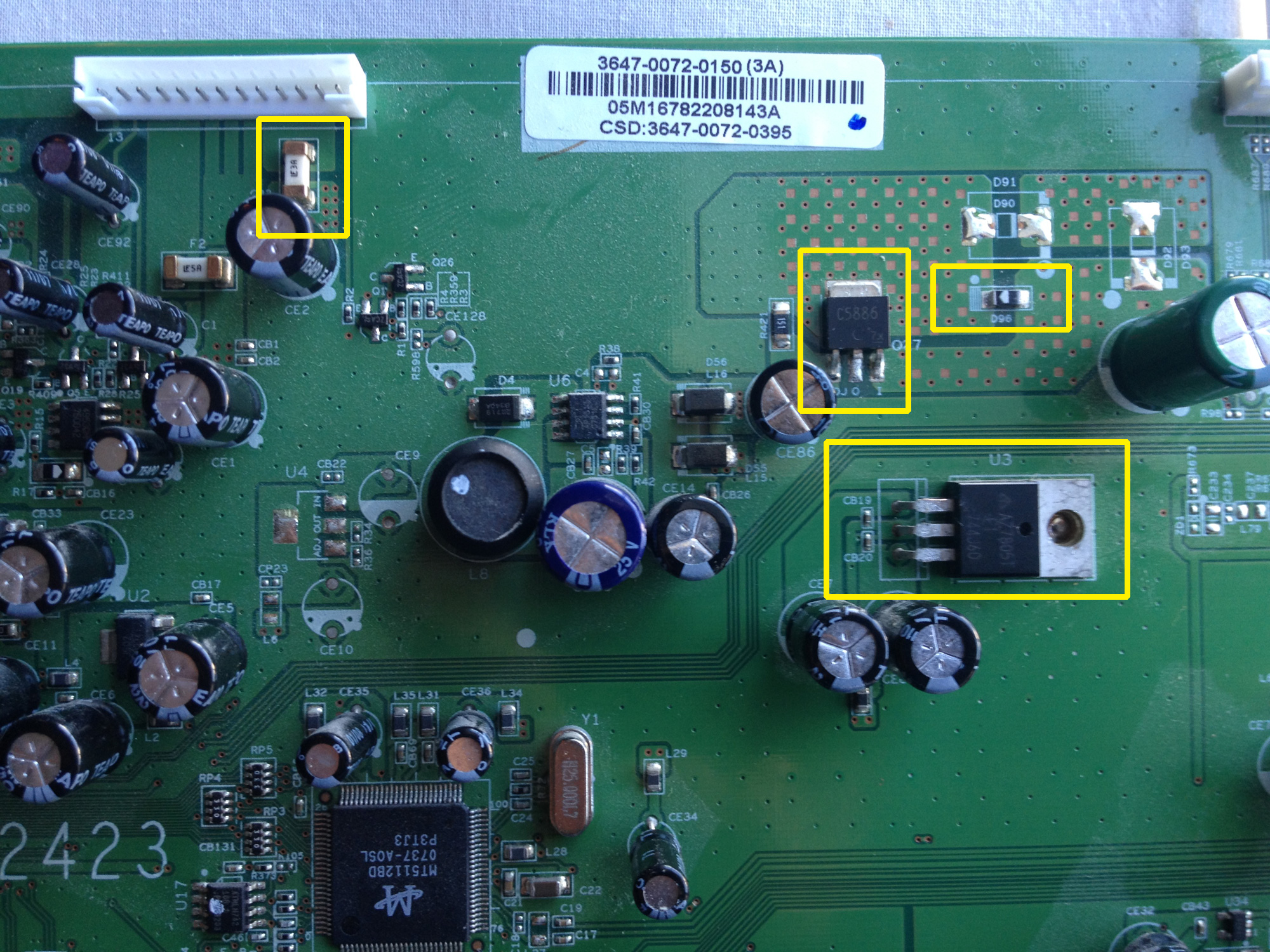

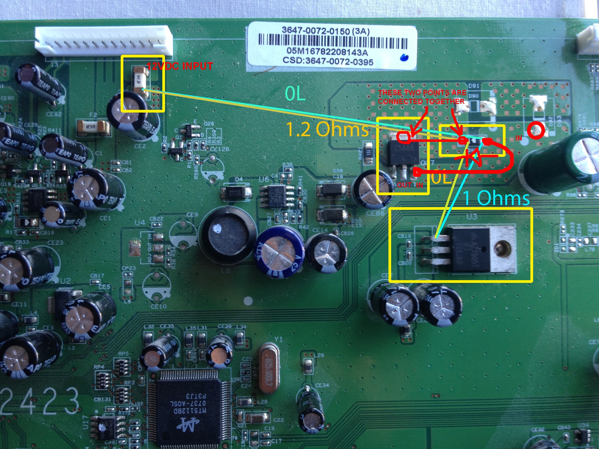

    I am brand new to reading circuits bud. I don't know how to read it.
    I've attached an image to see if you can help me decipher it.
      Re: VIZIO VO47L FHDTV10A - Voltage Regulator Input
      So does the resistance show <1 Ohms when measure between the input pin of U3 to either end of the DIODE?
      Same for the resistance reading for the fuse for 12V and either end of the diode?
        See Image.
        Thanks budm
          At this point I am not so sure what Q27 is, it may be transistor or regulator. The resistance readings do not look right since the O (Out) pin is the same as the bib tab pin on top which is also connected to the Cathode of the Diode, the resistance between the Cathode and fuse is 1.2 Ohms, that cannot be right sine the center pin is the output pin, then it cannot be connected to the 12V fuse.

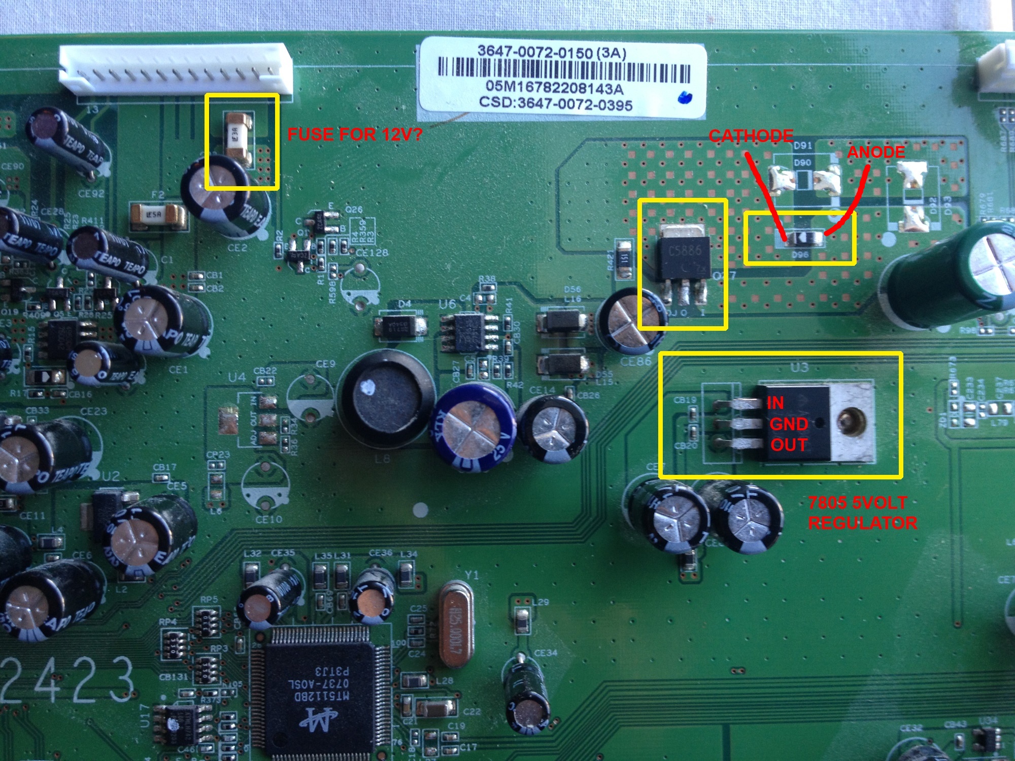

            Q27 is a transistor according to norcal in this video.
            http://www.youtube.com/watch?v=jR2UZhoDC2c
            I am just going to order another board. I have spent enough time on it. Once I install the new board, I am still going to see if I can repair this one. It would be a good learning tool.
            The TV is working and the only issue is that there is only audio @ the optical output. The TV speakers do not function (just buzzing), nor does the RCA audio out. So I will just use the optical for now. I'm guessing this is because I am only receiving 1.02V out of that regulator. The picture looks almost perfect. Im sure with the correct voltage, I will improve a little more.
            One of the main reasons I'm throwing in the towel is I cannot desolder the 7805. That tab wont budge at all. No matter how much heat I throw at it. I do not want to burn the board while I wait on a new one to become available.
            Thanks again, bud! I sure appreciate your time and advice. I have learned a lot and hope to learn more in the future.

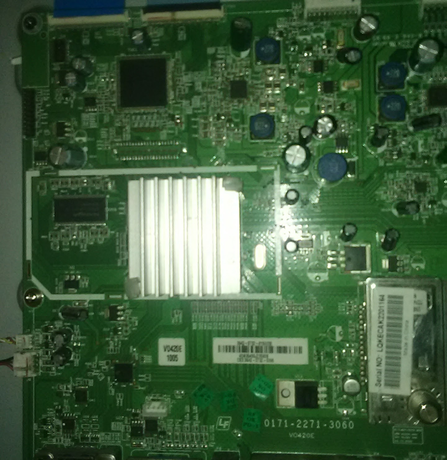

                              My apologies for not posting a photo. Mine is at U11 and the tab seems to be secured by a heat sink compound, Here is the photo :
                              https://www.badcaps.net/forum/attach...1&d=1513820880

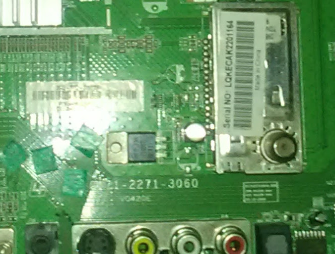

                                Here's another photo of the U11 on a Vizio 0420e, it's right above the 0171-2271-3060 number:
                                https://www.badcaps.net/forum/attach...1&d=1513821250
                                  #36
                                  The tab is just soldered to the copper plane.
                                  I would check the Voltages on all 3 pins first.
                                  What are the number as printed on the body?
