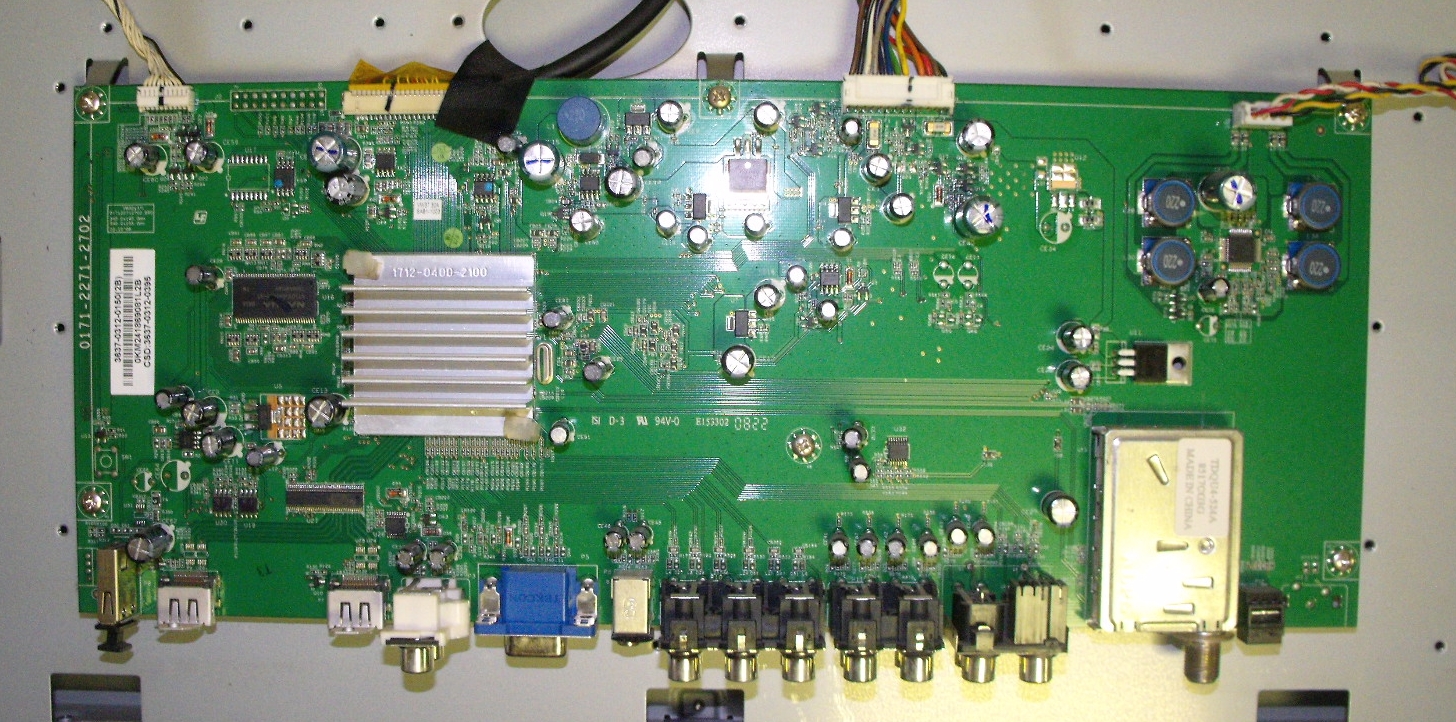

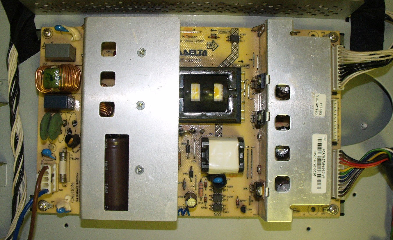

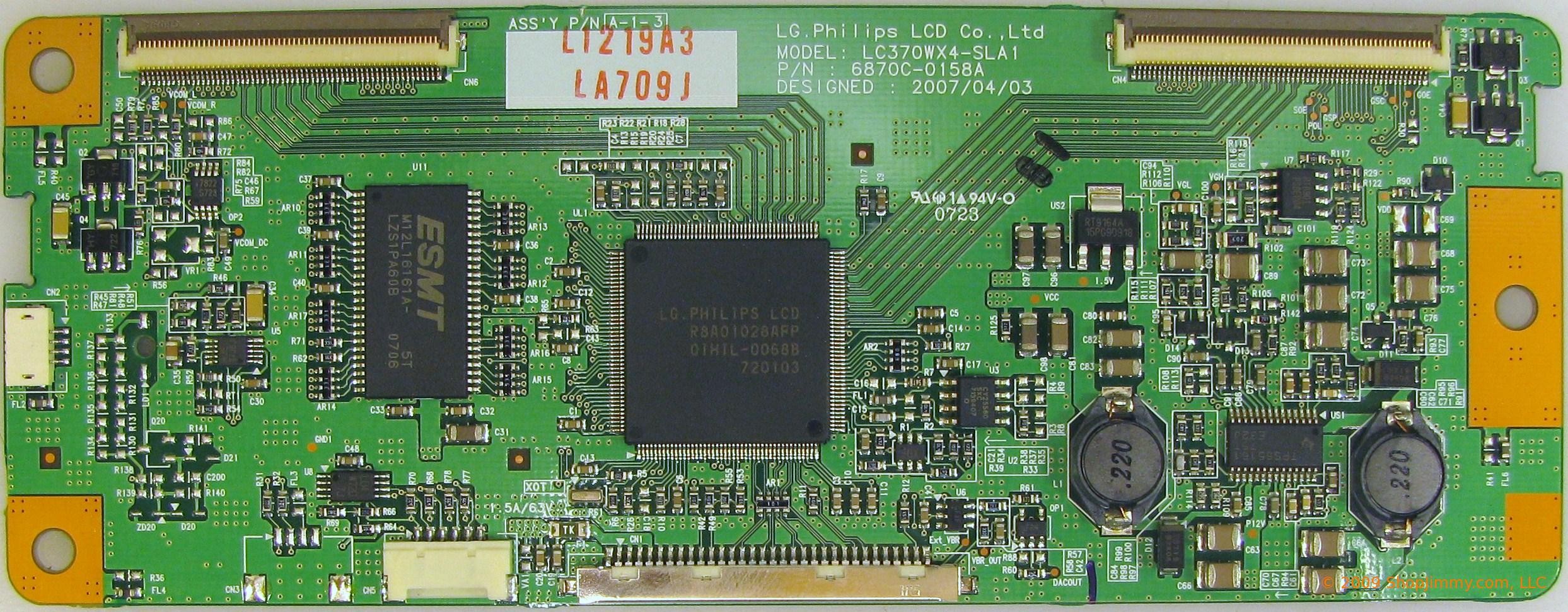

Vizio VW37L on any input after about 5 minutes or so the picture will go out. I still have sound and a backlight just no picture and can not see the menu during this time either. Sometimes if I wait a while it might come back for a bit but then will go out again. I'm thinking in the main board or Tcon any ideas??
Vizio VW37L no picture after 5 min
Re: Vizio VW37L no picture after 5 min
Monitor the DC Voltage on the SMD fuse (check Voltage on both ends of the fuse) of the T-CON board to see if that goes away when the pictures disappear.Never stop learning
http://www.badcaps.net/forum/showthread.php?t=24809 -
The fuse F1 (1.5A/63V) is to the left of the connector with 'TK' printing on top.Never stop learning
http://www.badcaps.net/forum/showthread.php?t=24809Comment
Try reseating the cables, tight up all the board mounting screws since the ground connections are made through the board mounting screws.Never stop learning
Check the voltage on that 1.5V regulator IC US2.Never stop learning
