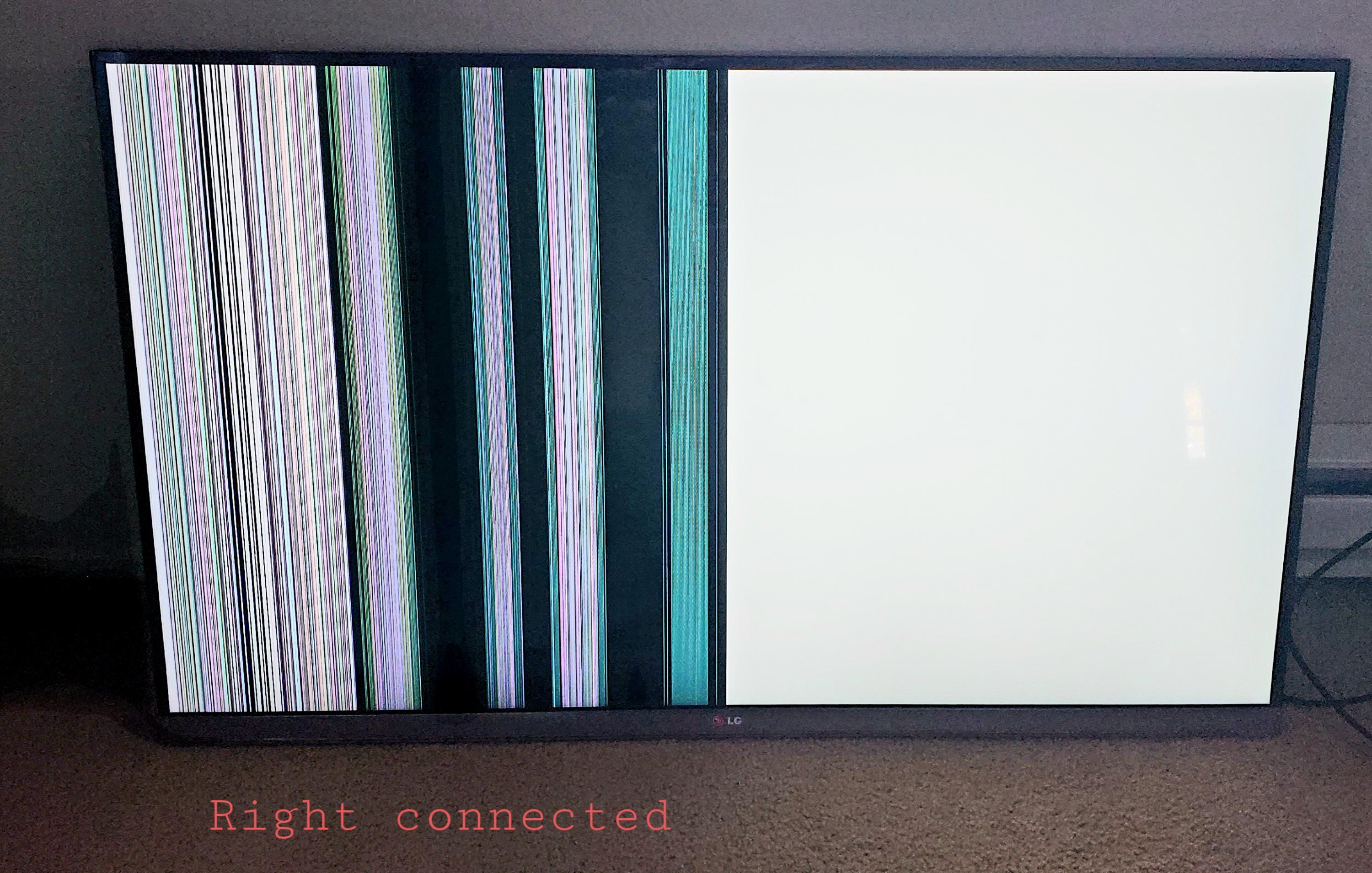

        Re: LG 47 LM8600 - No Video
        Thanks Nick and Diah for replying on this. I did the test by removing ribbons from t-con to panel and looks like issue is with panel as I could see half white however no picture. Please find the attached photos. Let me know if this can be repaired or this set is done with its life.

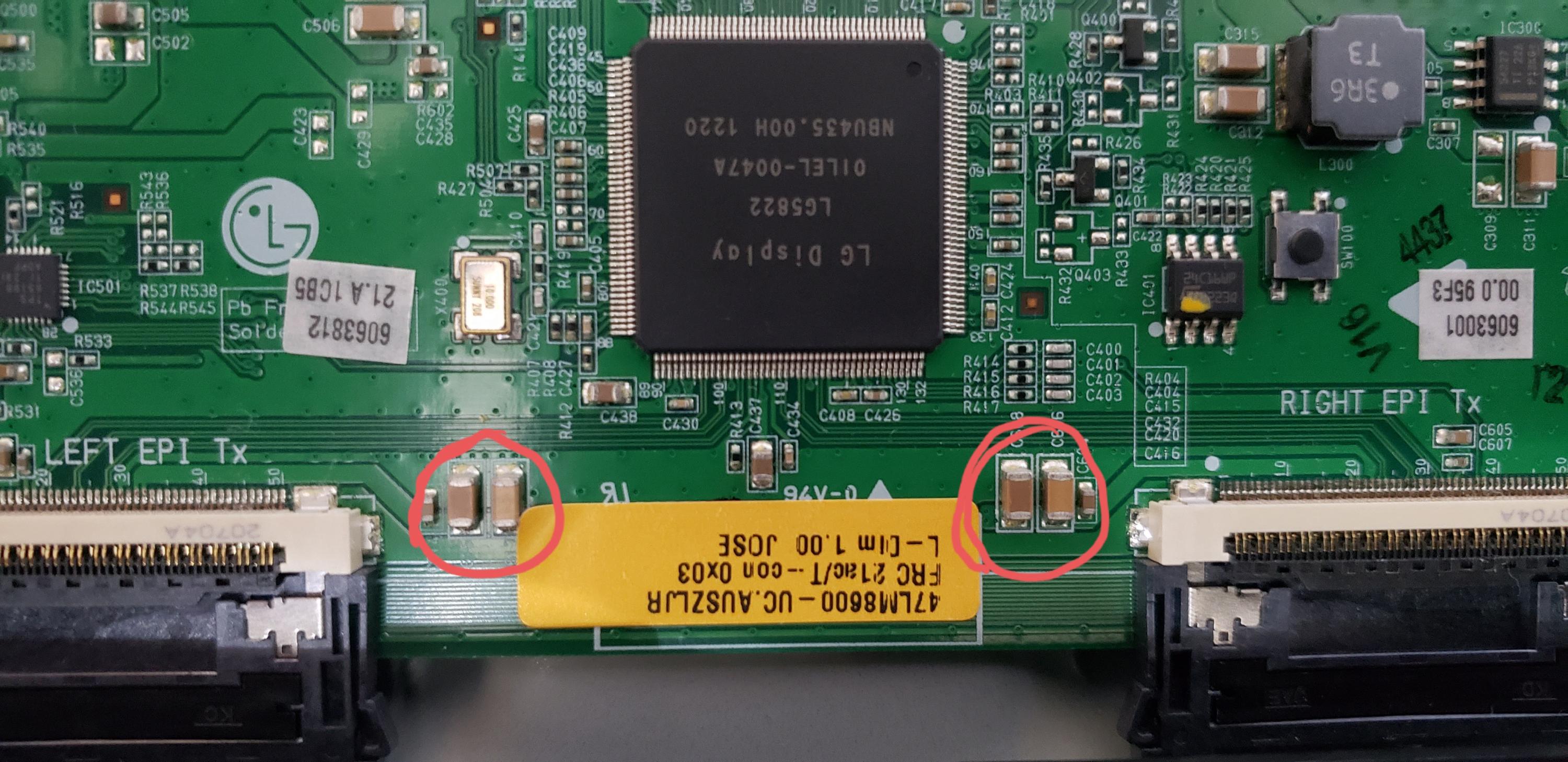

                  • anupkg1985
                    • Sep 2020
                    • 180
                    All the caps marked in red area are showing shorted, could be one or more are bad among them.
                      i dont think they are shorted..
                              okay thanks,
                              my judgment:
                              A- yours measurement at this post not correct
                              B- yours Panel OKAY. the line you saw after disconnecting right side ribbon cable are related to signal share at the panel self as it is 3D panel ( we understand how signal shared by side by side for example )
                              C: the SMD caps you mentioned are not shorted because they are related not direct to T-CON Normal operation.. ( they related to UART section for out source signal )
