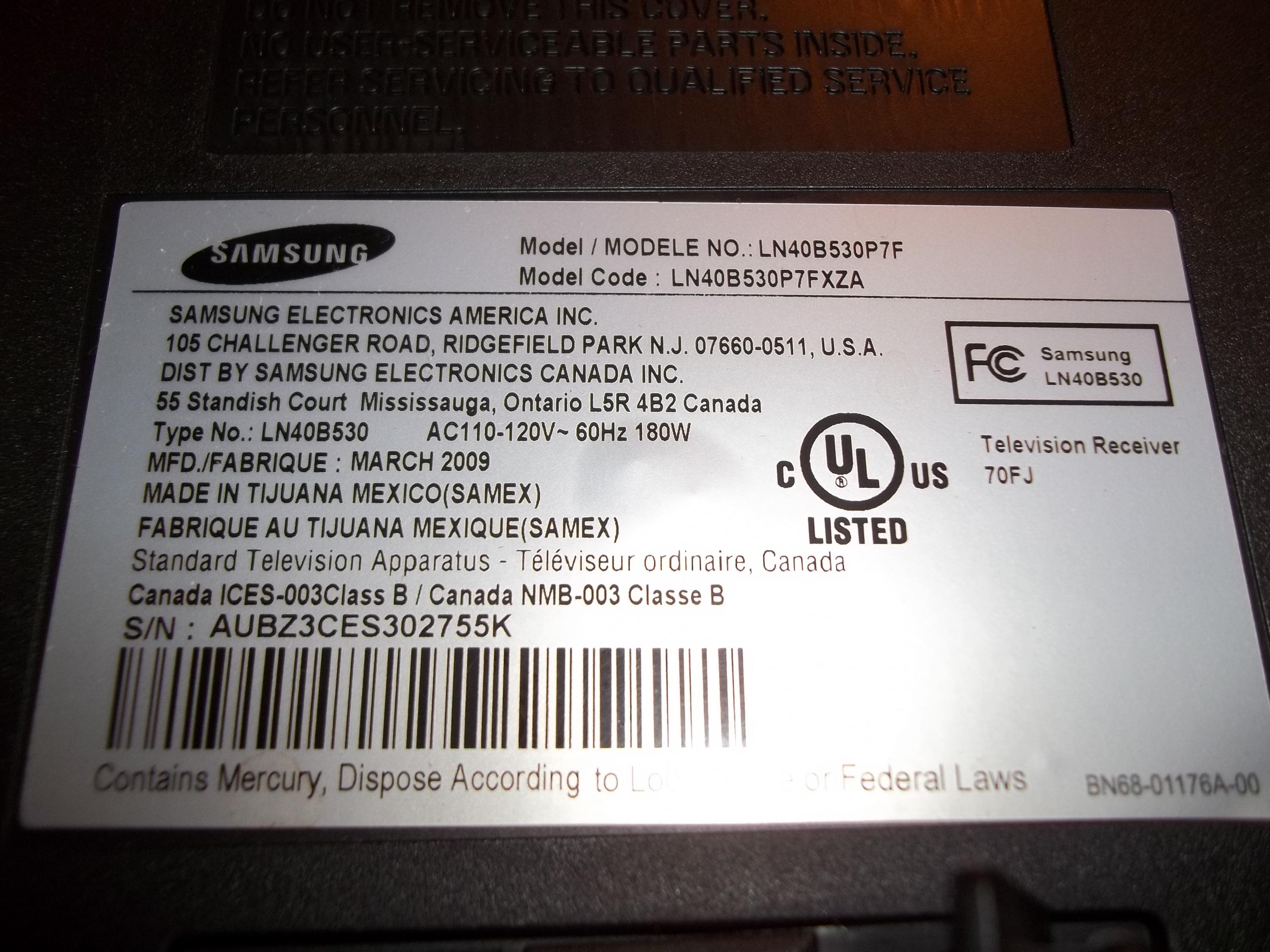

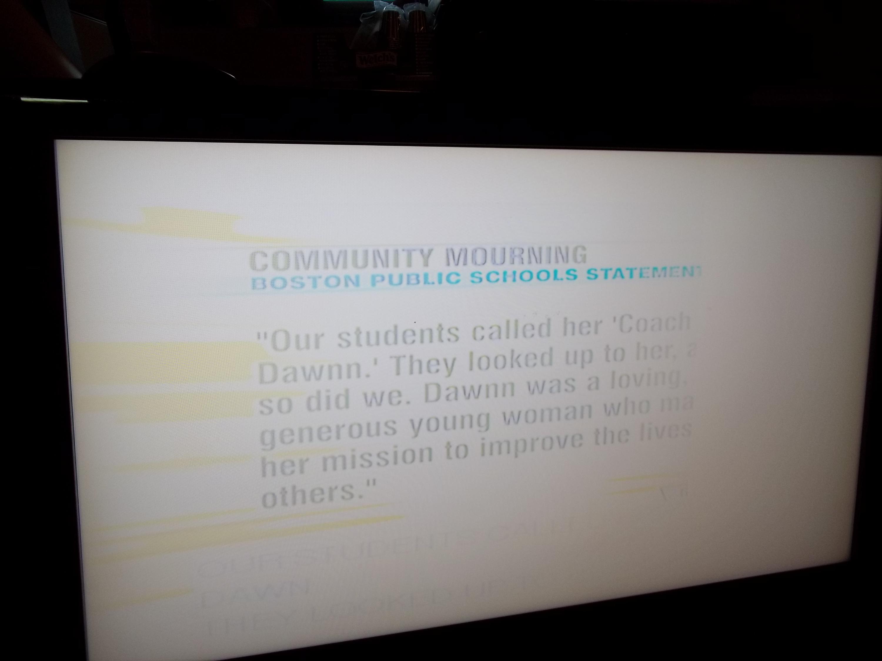

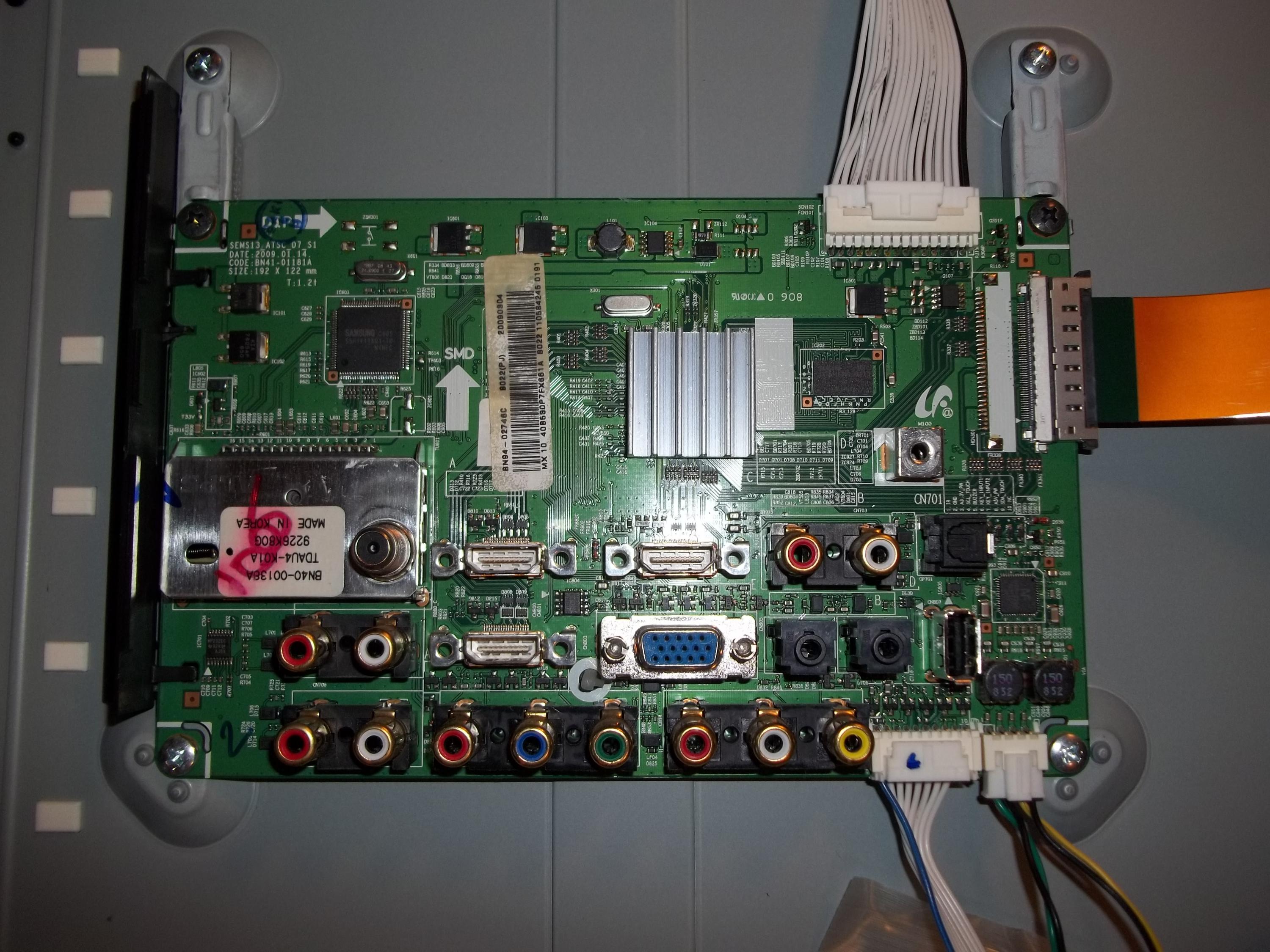

    Samsung Model LN40B530P7F White Screen, washed out pic
    I got this from someone who worked on it for a while then gave up about a year ago. He told me He got it to work for about 10 minutes then it reverted to the washed out white screen.

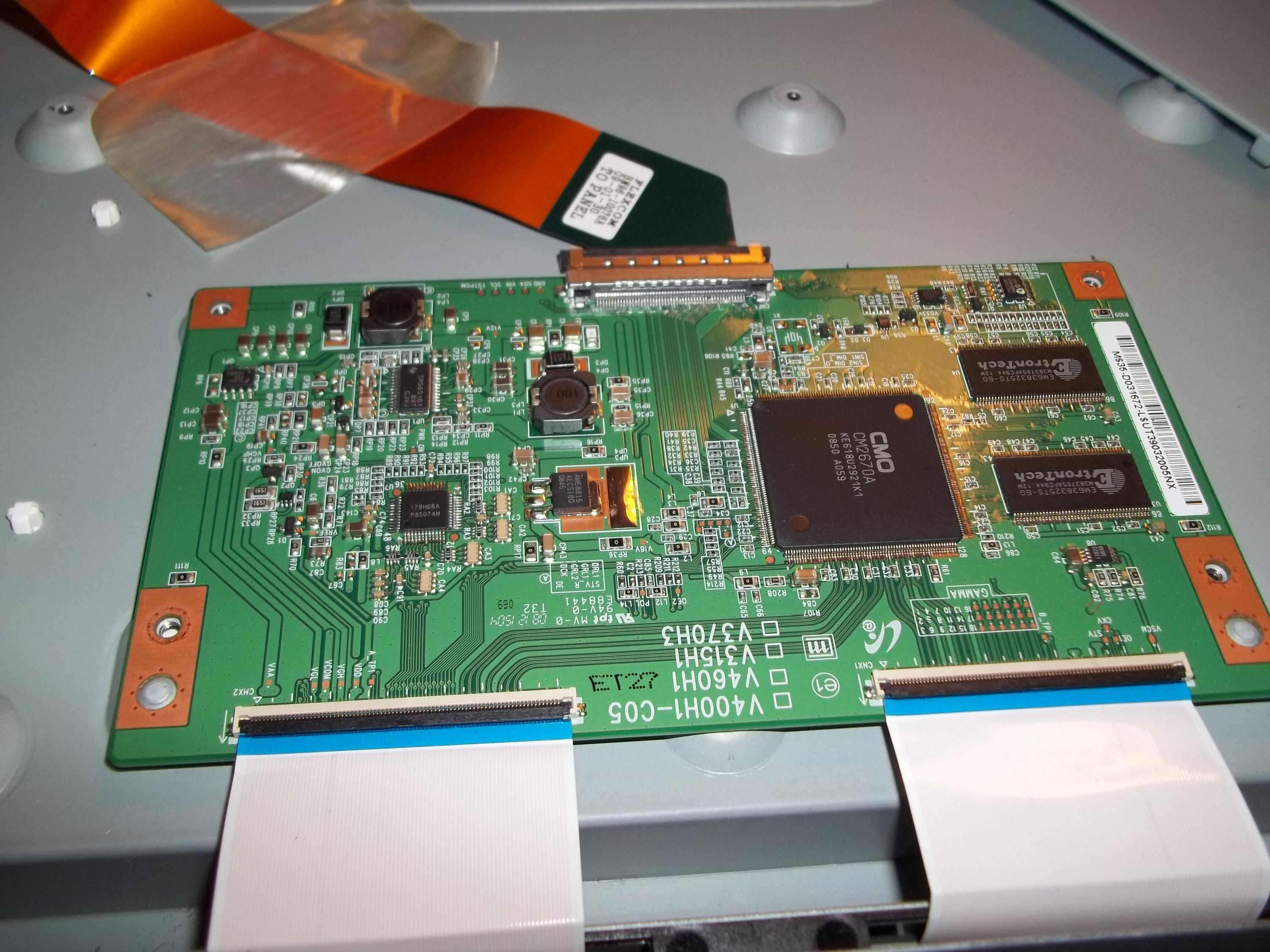

    Any idea where to start on this? I'm thinking TCON PCB measure the voltages to it, etc. Any help and guidance is appreciated.
    Posting a bunch of pics. Actually the image of the screen looks better in the pic than in reality.
    If any more info is needed, let me know.

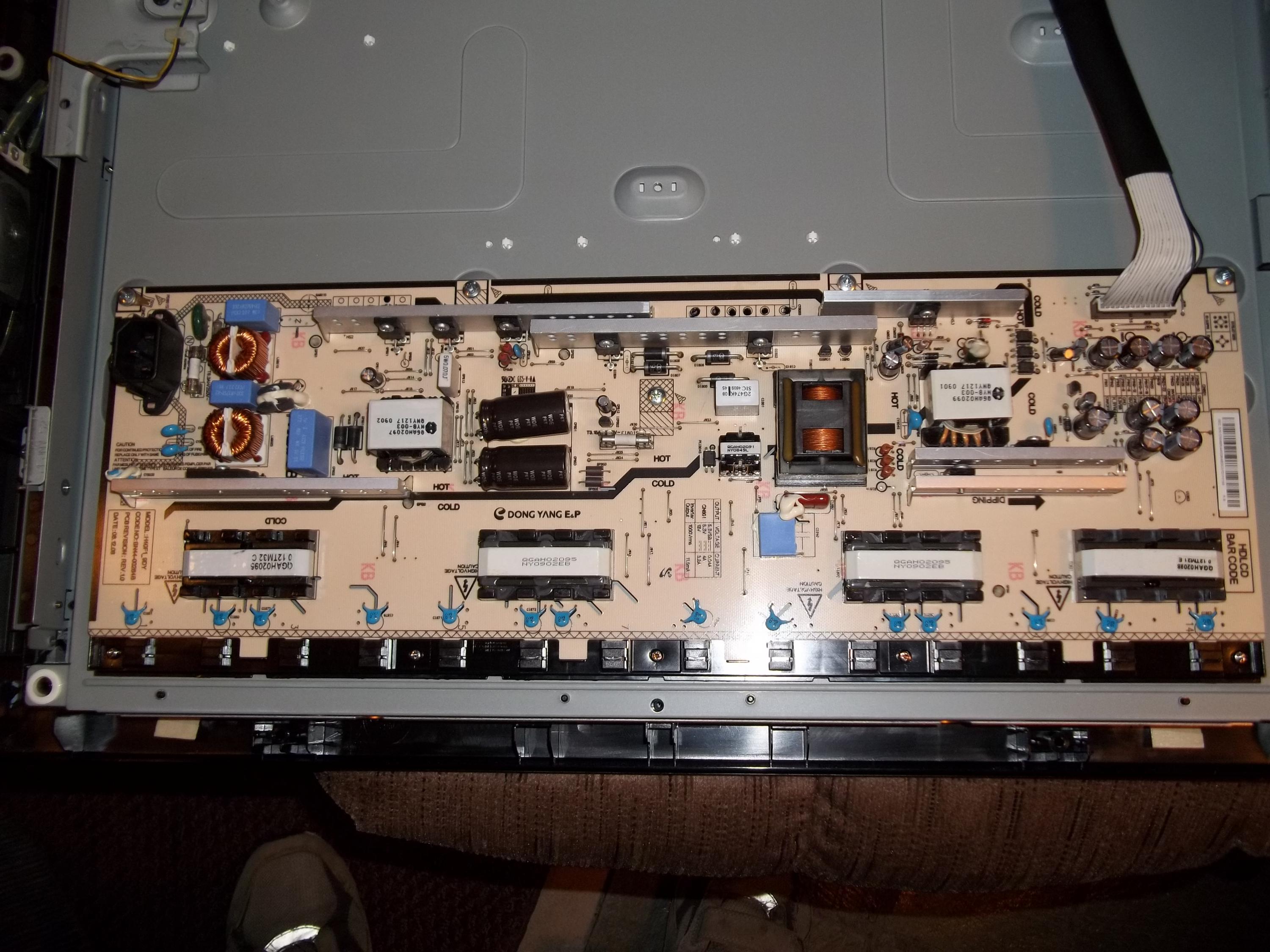

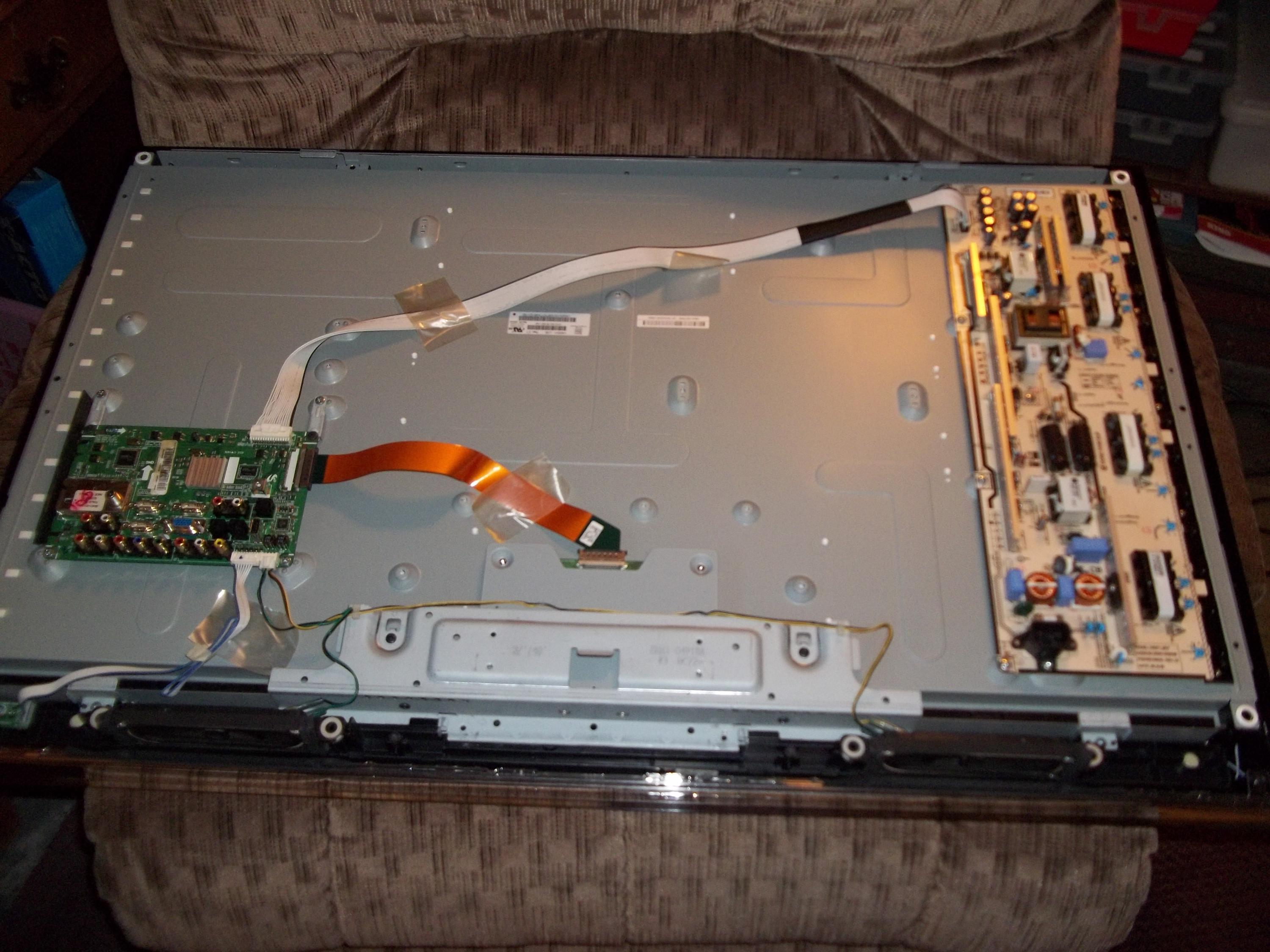

    Re: Samsung Model LN40B530P7F White Screen, washed out pic
    More Pics
    BTW, is there a Service Manual available for this set as well as schematics.
    A link would be helpful.
      Service manual can be found here

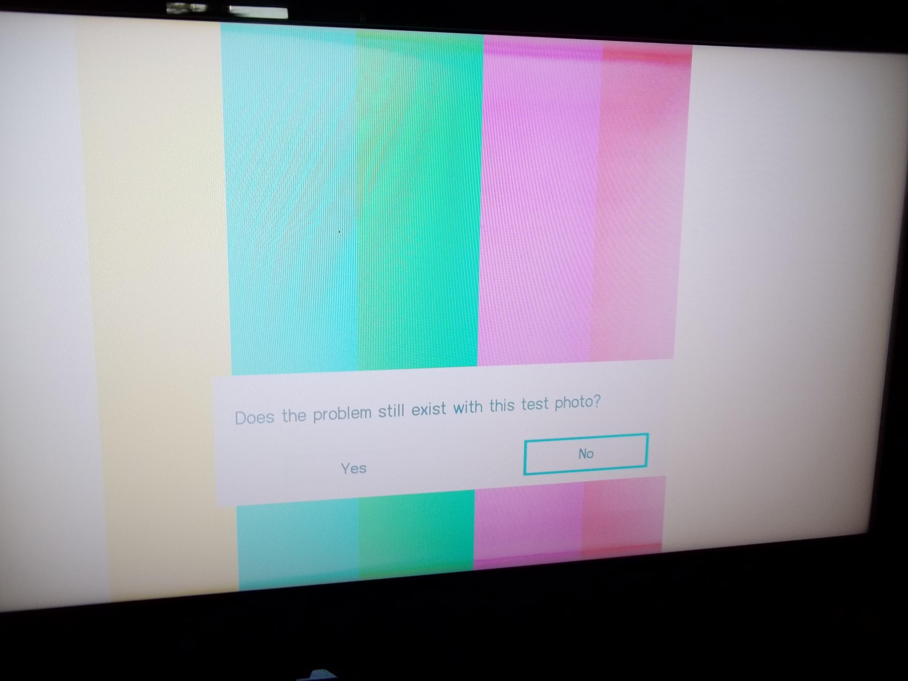

      Looks like it could be the as15 chip on the tcon, but the red and blue lines could be indicative of panel failure, not sure if that is supposed to be a test photo
          Yes that is the test photo produced by the TV. Not sure what you mean by red and blue lines.
            Take the DC voltage reading at the GAMMA Voltage test points pad 1~18 on the T-CON board and report those reading, chassis as the GND ref for the meter.
                Replacing the T-con will fix the issue in most cases but to confirm, if you report the GAMMA voltages, then we can tell you if there is a problem with them and therefore if replacing the T-con will fix it.
                    Yes and tell us what each point measures - for example:
                    Gamma 1 - 0.01V
                    Gamma 2 - 0.38V
                    Gamma 18 - 15.82V
                    etc.
