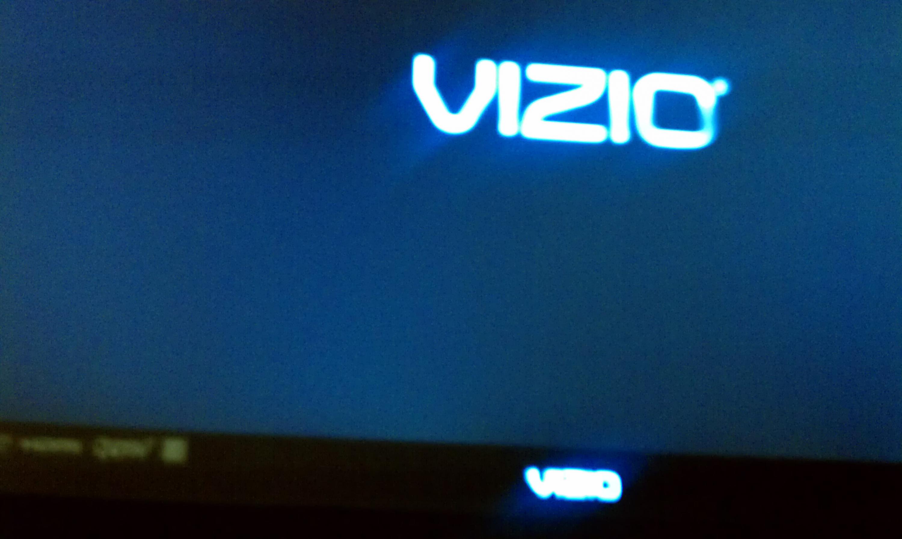

    got a Vizio E321VL today from the E-waste recycler for 10 bux to play around with/ hopefully repair and sell to buy some better tools.
    when plugged in, the vizio LED light glows orange.
    when press power, it turns white
    the backlights come on
    the screen displays the VIZIO logo for a second or 2
    then the vizio logo goes away and its just a blank, backlit, black unresponsive screen.
    pressing menu or any button for that matter does nothing.
    only way to turn it off is unplugging it.

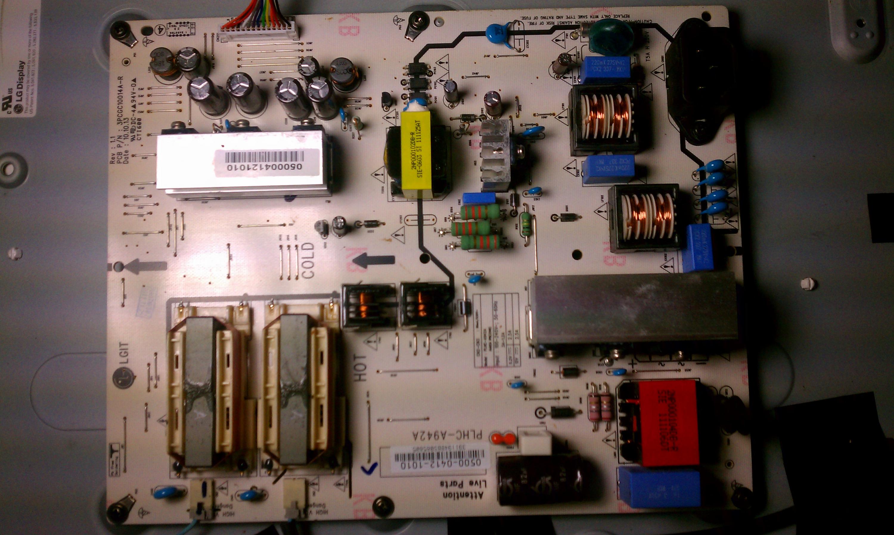

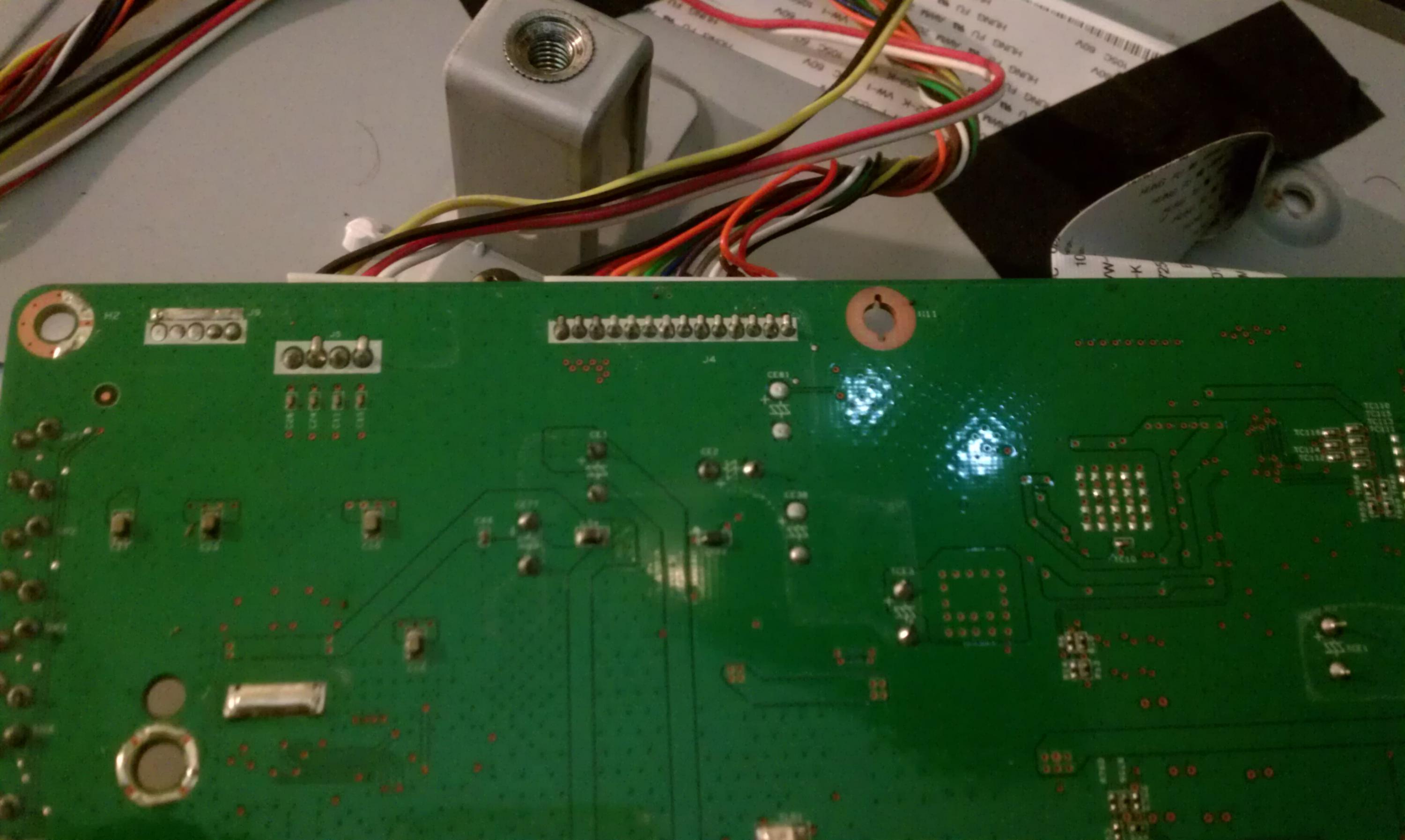

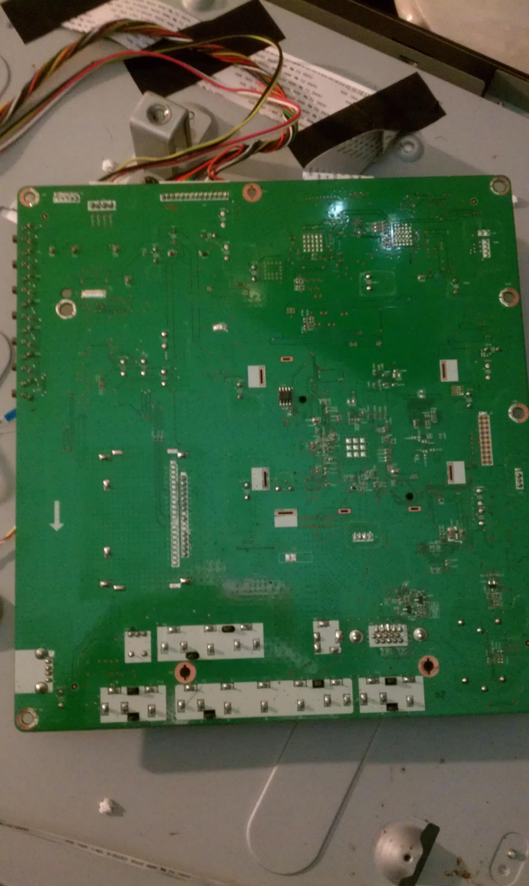

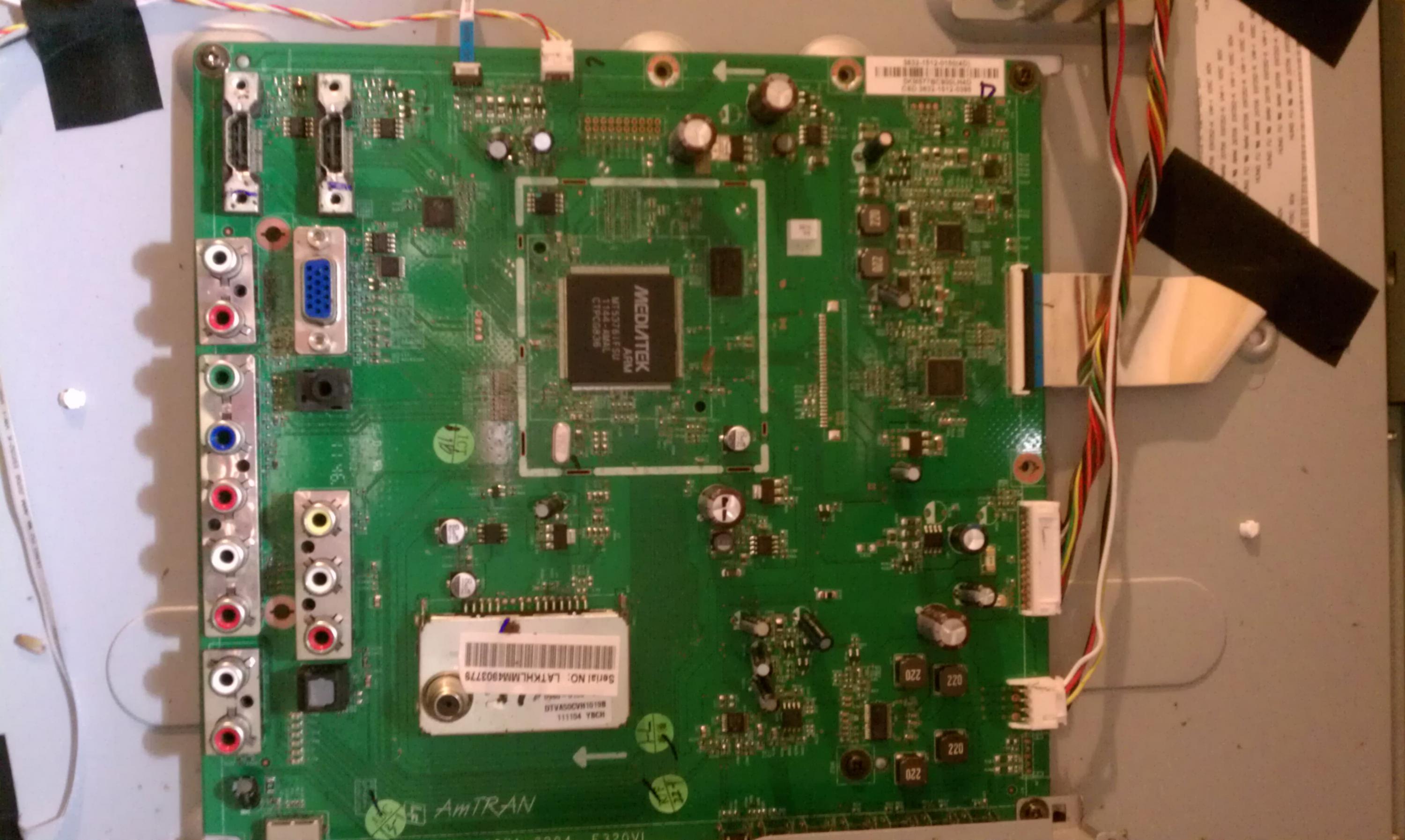

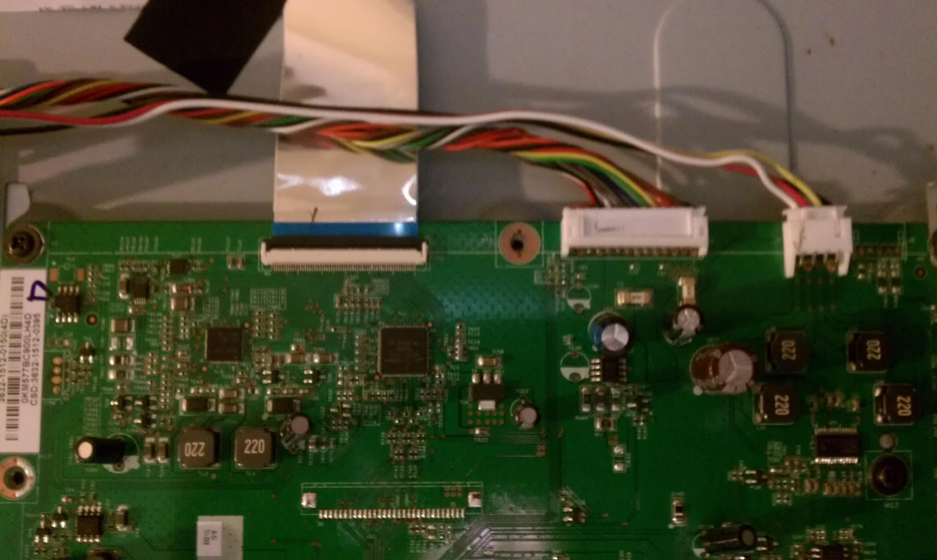

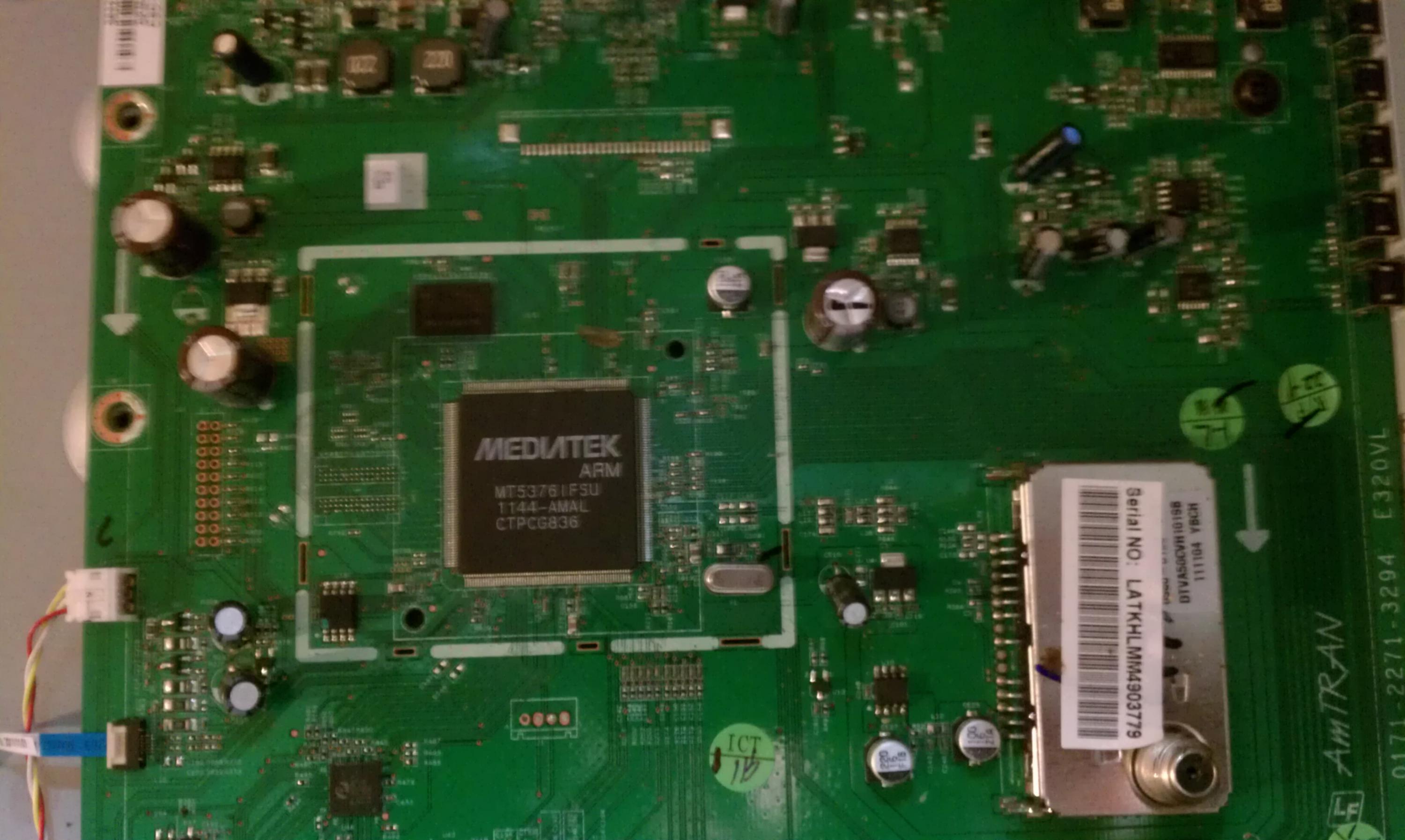

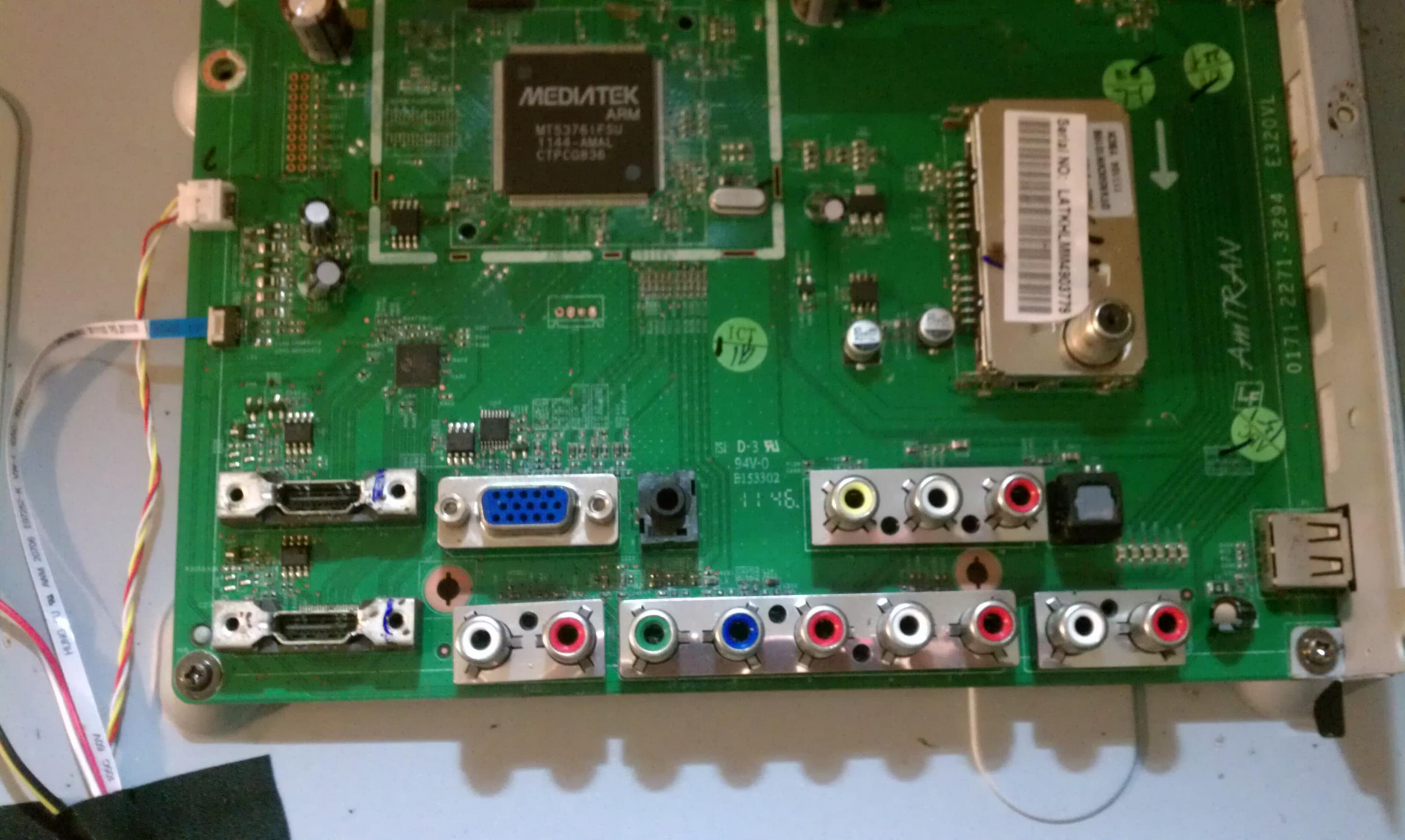

    ok heres pictures of the boards. i guess the TCON is built into the motherboard on this one.
    http://www.ebay.com/itm/Repair-Kit-F...item338caabced
    this eeprom chip might be the problem but the symptoms he lists are different than mine. the vizio logo doesnt stay on the screen when it freezes...

                          haha success! guess the rom dump adeventure will have to be saved for later. thanks to reading this thread: https://www.badcaps.net/forum/showth...t=20864&page=9
                          where the guy eventually fixed it by replacing/repairing the ribbon cable that went to the IR board, i decided to have a look at mine.
                          when i removed it i noticed the IR board was all rusted and corroded. i removed the board entirely, and now the TV starts up just fine.
                          crazy! how could the IR board halt the whole thing???
                          *victory dance*
                          that was too easy i like the hard ones where it takes weeks and i really learn something
                          LOL
                          edit: i guess i did learn something: CHECK THE IR BOARD!!!

                            I went back and looked at my E321VL. I disconnected the ribbon cable going to the IR board and the tv booted up correctly.
                            I took out the board and found that the ribbon cable wasn't seated correctly in the connector. In other words it was at an angle instead of straight in - I removed and reseated the cable.
                            I'm happy to say that the tv is working including the remote!
                            Thanks again to everyone that contributed in solving the issue.
