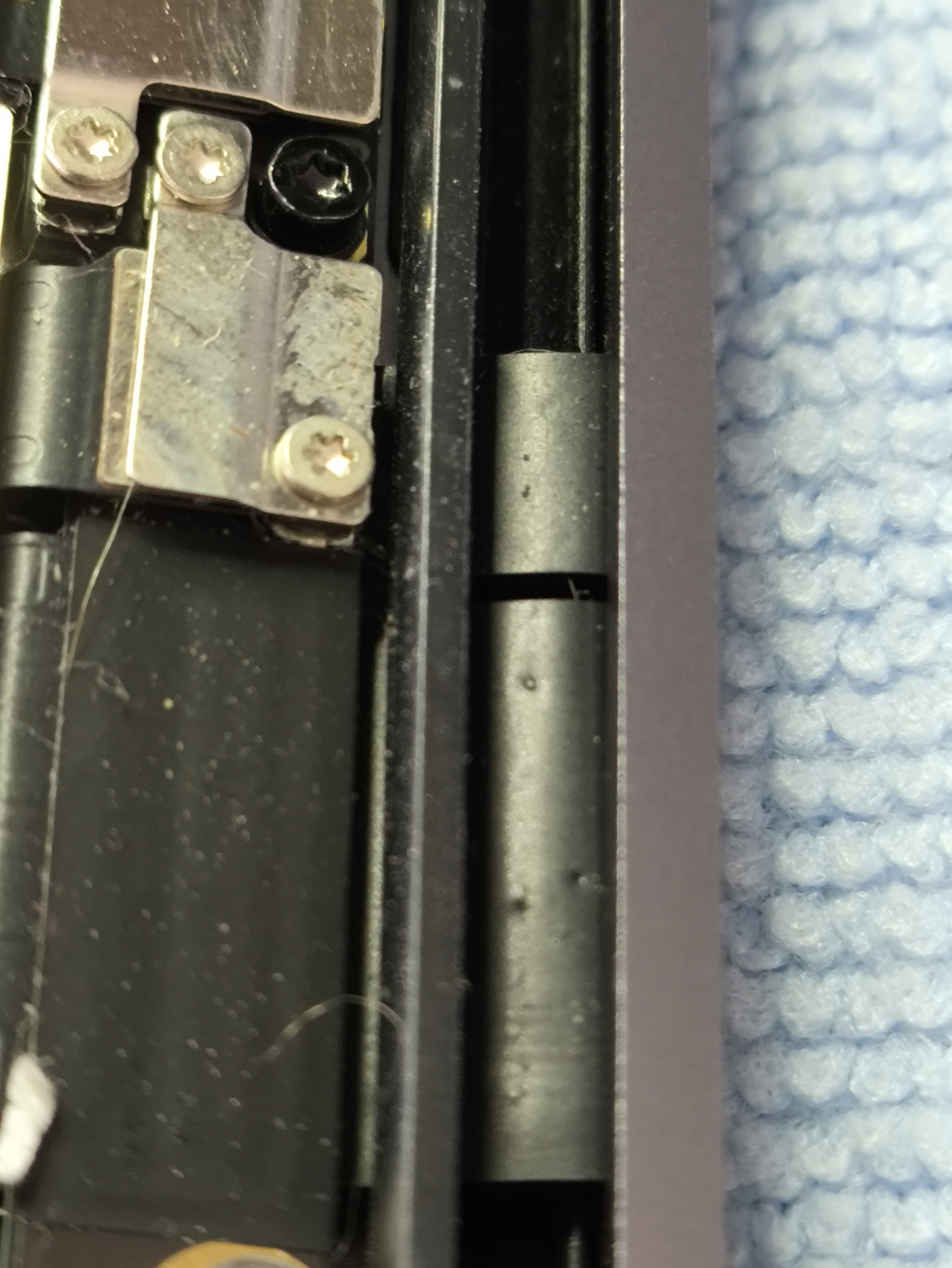

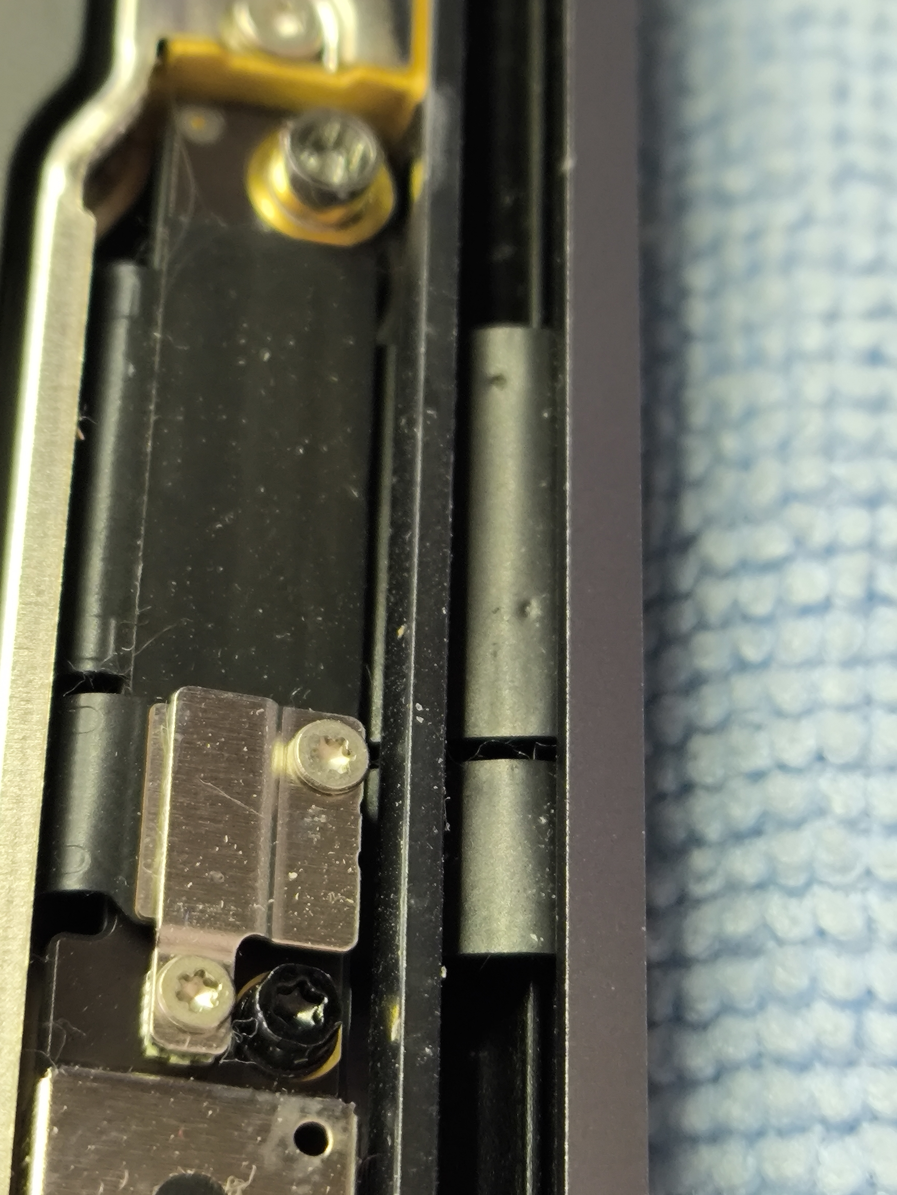

                    Attached are some photos of a screen I replaced off an A2337 recently. You can see quite clearly the defects in the flex cable caused by grit getting in that opening. I usually see it with kids school machines, or people who are just outright filthy. The flex cables can be replaced if you are a complete masochist. In this case I used an aftermarket display, but told the customer that any damage to these cables is their responsibility.
                    Have you tried Safe boot per chance when booting into MAC OS? Also confirm Touchbar and Trackpad are working correctly (they both have lid open signal going to them). Seen some weird stuff when either of those aren't working properly.
