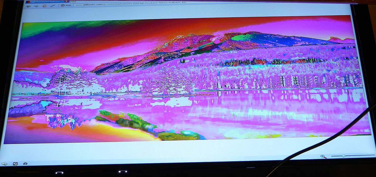

    I obtained this TV with the info that the owner's little daughter has been supposedly painting the TV with milk It's an LG 32LW570S.
    I have been reported there was something with the ribbon cables but I have not found any residue or problem at any conenctor or cable, they are all clean, maybe cleaned by the owner, not sure. I can clean them with alcohol but don't think this is the right path. Anyway, the TV shows this
    instead of
    It seems to me as usuall voltage-buffer problem? This is the Tcon (not my image)
    There seem to be two chips, both SMD so the milk could have been sucked between the solder balls as the tiny space there behaves like capilary. They are TPS65194 and BUF08630.

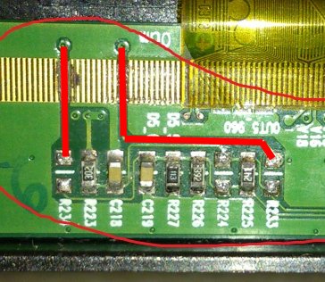

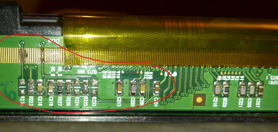

            This is the part where the milk was
            SMD components seem fine. The dark spots on the golden joints were probably burned or oxidized or something. The paths were opened, I have tried to connect them like this but there was no change. They do not seem to be connected anywhere beyond the SMD joints (= dead end) so probably does not matter if they are opened.
            One thing though, if I disconnect the ribbons, some voltages dissapear from the test pads. Seem to me some signals go through one ribbon to one display PCB, than through the LCD to second PCB and back to the other ribbon. So there still may be some problem in between, but well, everything seems fine, if the display itself is bad internally, I won't know before the gamma chip is replaced anyway so I will just go for it.

              id leave it as it is,that picture looks amazing!!

                orly Well the customers thinks otherwise…

                  You know what worries me, the first 6 to 7 contacts of the ribbon cable on the left, they look to be tarnished, get some contact cleaner and spray a little in that area and then press on it while the Tv is on, see if it makes a difference.

                    I've tried pressing the contacts as very first thing, even before I noticed this area. Tried all of the flexes, there was no change at all no matter what I did with them…
                    I have checked once again just to be sure, that was probably just something on the top of the ribbon, not under that - as I have been cleaning it, I can see nothing out of the ordinary now.

                                I have worked on a LG which had missing voltages, in two or three places and by replacing the IC on the T-con and one more time getting another T-Con board, did not fix the problem(did not have picture at all). Then I have checked the LCD panel itself, and I have found partially lifted ribbon, on the panel PCB.
                                I think, that those first 6-7 tracks from the ribbon cable, are actually lifted.
                                Somewhere I have read, that with some kind of T tip solder iron, which has some Teflon coating or similar material, can be heated up and it should glue back to the PCB.
                                Anybody knows anything about this procedure?
