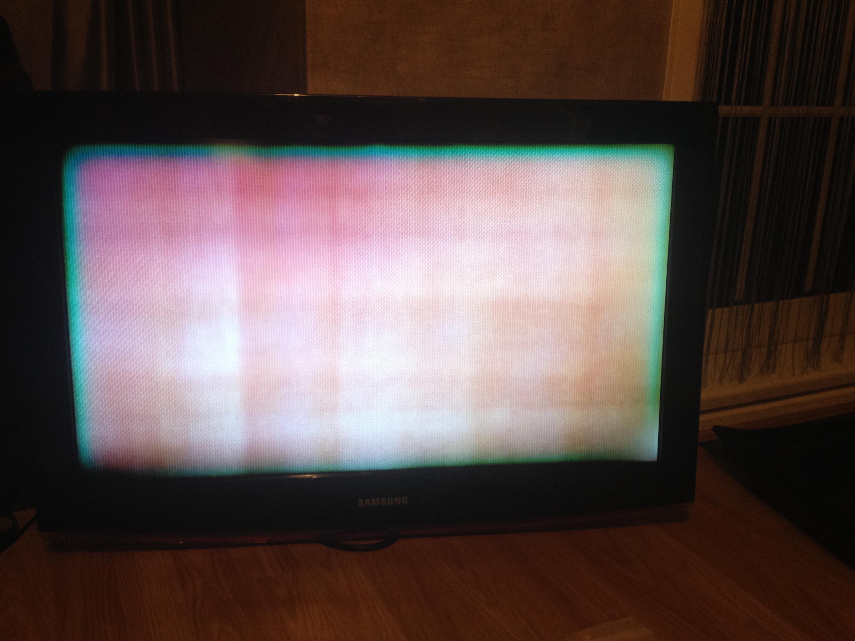

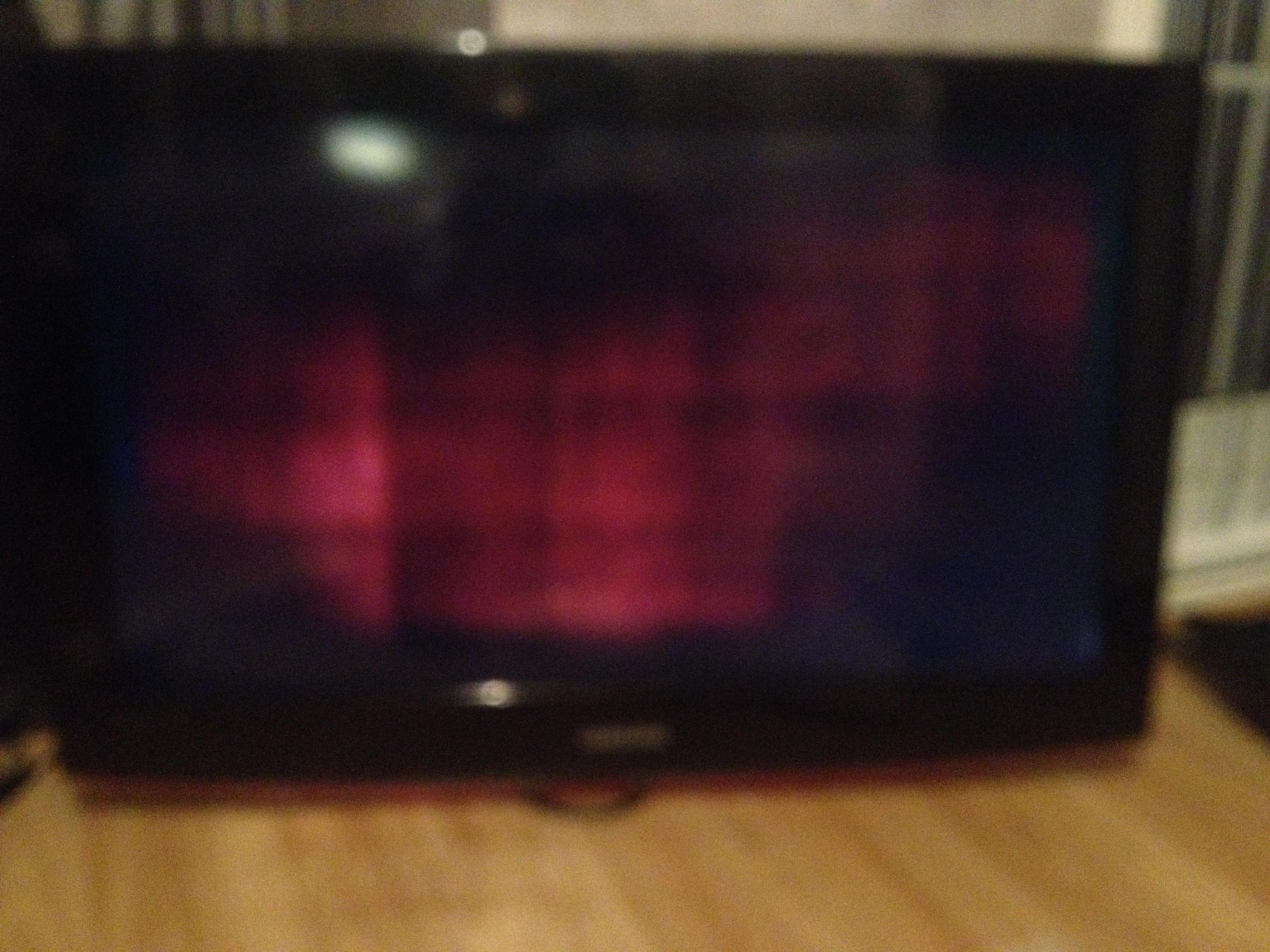

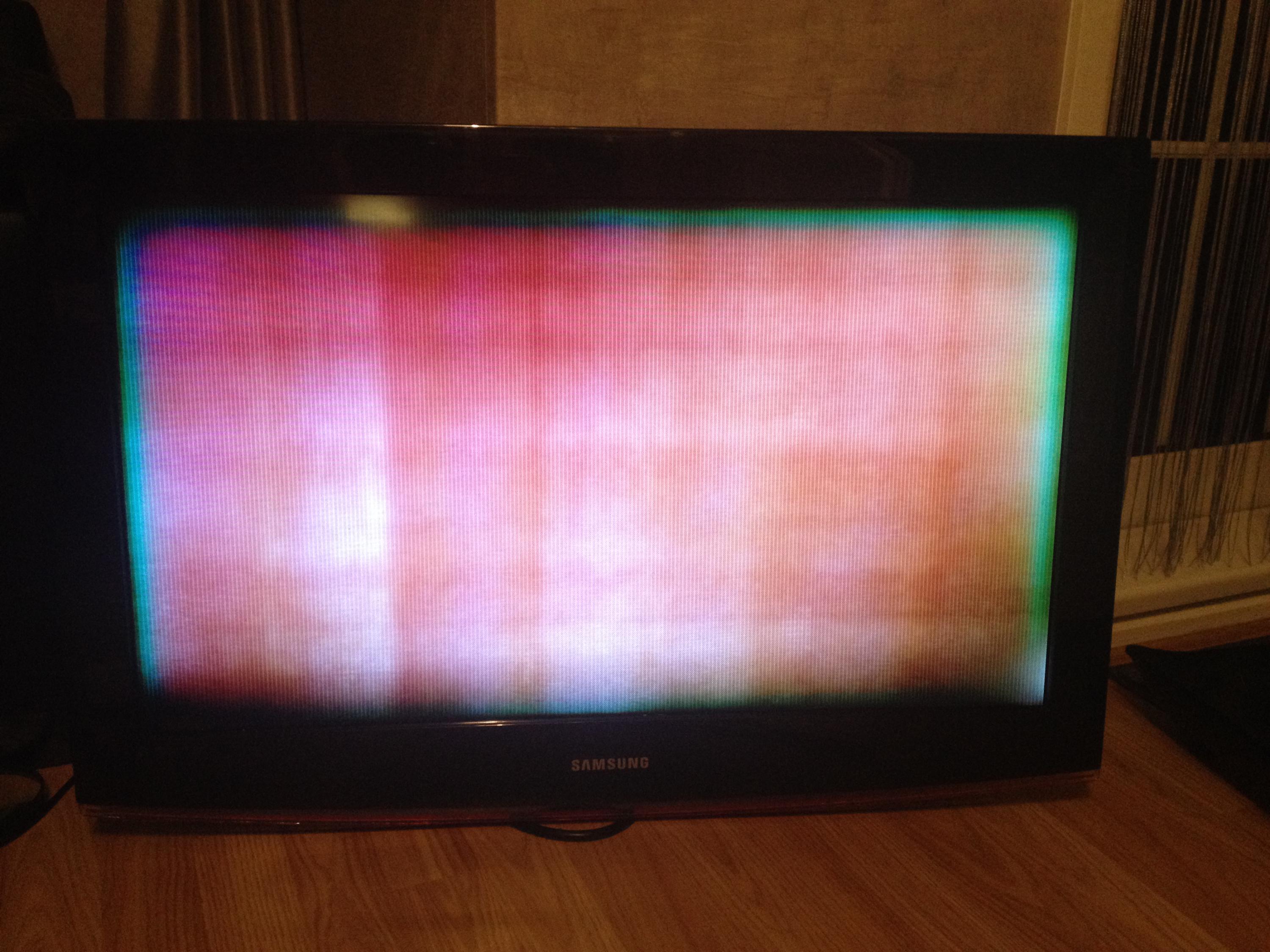

    any ideas on this problem guys,
    don't get any image on screen, just gets brighter untill almost white.

    Bad panel or tcon or cable
      Re: samsung 32 inch lcd
      I would say bad panel or T-CON, more likely to be panel due to bad TFT driver ICS. Try having one ribbon between the T-CON and the LCD panel connected one at a time to see what you will get.

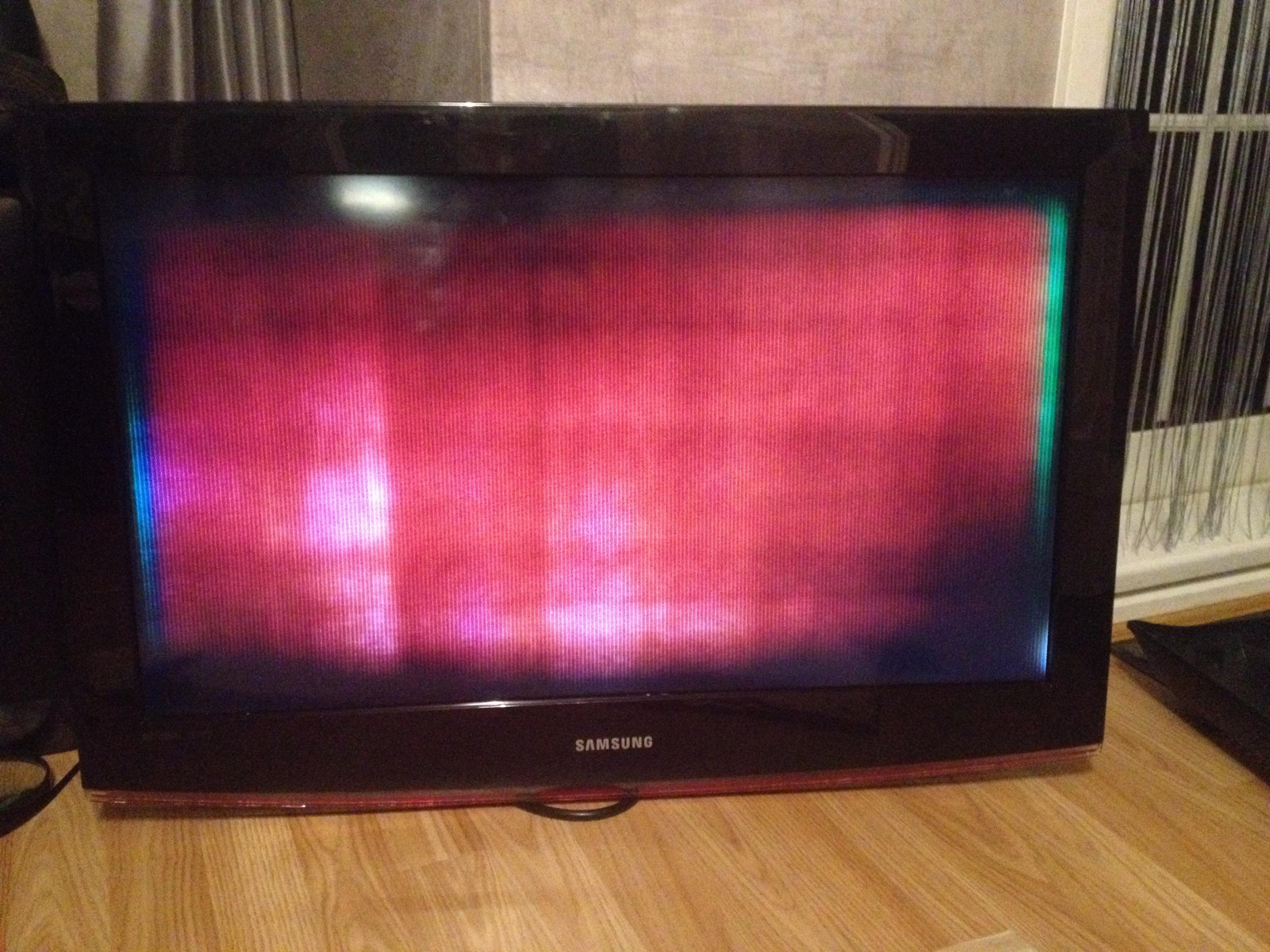

        finaly got to strip this tv down, it samsung Le32B450C4W.
        found the problem, it is the ribbon cable between the T-con and screen, looks like liquid damage,
        so i cleaned it all up and and found the ribbon cable was burnt, and contacts missing, also burnt hole in it.
        i found a T- con on ebay for £3, but cant find the cable for it,
        any ideas fellas

            no not that one fella,
            i need the short one from T-con to screen,

              that is part of the panel. you will either need to buy a new panel or fix that connector which isn't very likely. some people have attempted it but not sure on the success rate. buying a new panel isn't an option in my opinion cause a new tv is cheaper than a new panel.

                no fella, it's a 2 inch ribbon cable that connects the screen board to the T-con,
                it's not what your thinking of,
                i think you are talking about the screen tabs.
