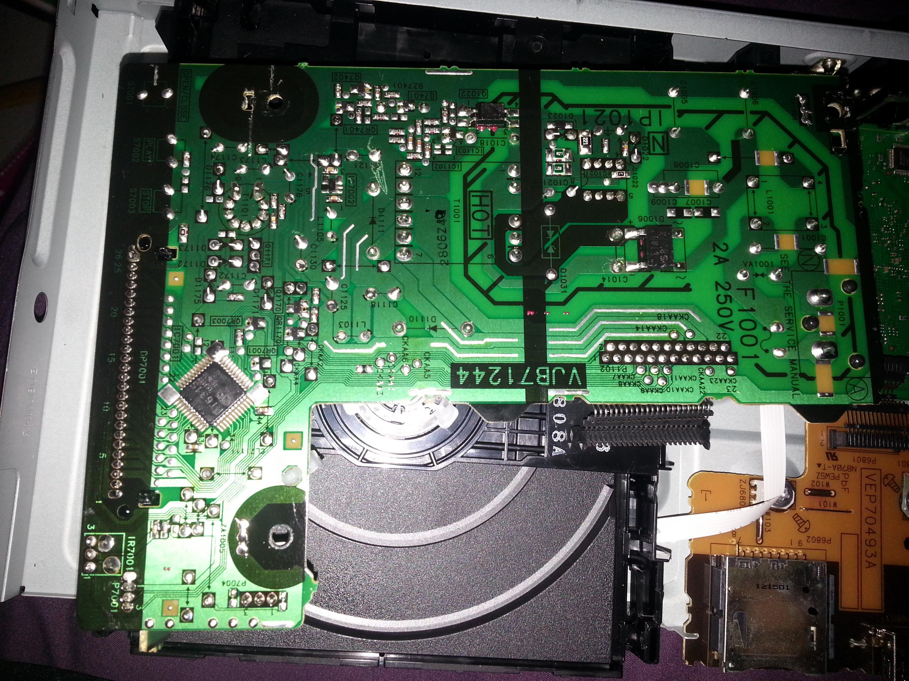

    Hey guys. New here but looking to help as much as i can aswell.
    Recently was given a Panasonic DMP-BDT220 Bluray player. Does not power on whatsoever. When i plug the unit in, i can hear an eletronic whine coming from the power supply unit. I opened up the player, and looked at the fuse and all the caps, and they all seem to be intact (I dont have a meter or any knowledge for testing caps). By intact i mean no obvious buldging or exploding caps. Pretty lost with this, but id love to get it working. I can provide high-res images of the power board if needed. Thanks for anyone who can offer any wisdom or knowledge on this situation

        Well, you do not need to test the capacitors yet, first step is to see if the power supply is working. How about a picture of the power board, and are there any labels for various voltages?

          Re: Panasonic DMP-BDT220 Wont power
          Ill take some pictures when I get home. I already have the power board removed.
                              Heres the pictures sorry for the delay
                                Might be the light but pin7 of T1001 seems like a bad solder
                                  gave it a look, doesnt look like a bad solder. must have been the flash. any ideas? >_<
                                    Q1171 looks like it has bad soldering too, and some components nearby. Also C1081 next to the optoisolator, and D1110
                                    It seems that P1102 is the main output connector. You can measure the voltages there and see if they come up right. The service manual should show which pins are which rails and what the voltages are supposed to be.
