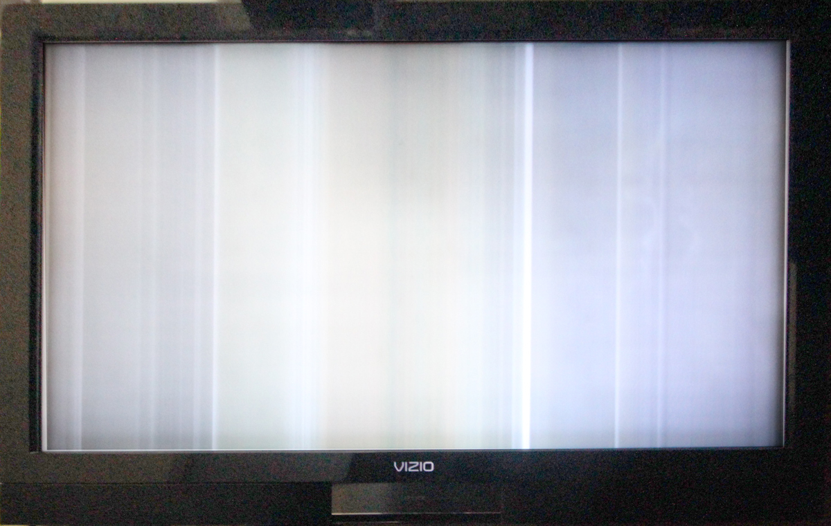

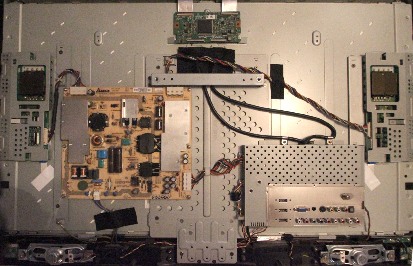

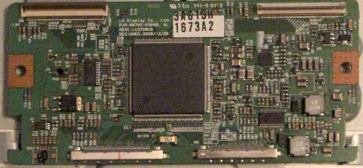

    Vizio SV370XVT - white screen with streaks
    Getting white streaks and lines - sound and channels work fine with remote, but no picture. Most probable thing the T-con?
  • selldoor
    Slow Learner
    • Dec 2010
    • 7870
    Re: Vizio SV370XVT - white screen with streaks
    yes- check the fuse on the tcon then when connected voltage with respect to ground. Also if you havent already clean the flat cables and reseat.
      I'm going to put a bet on this being a bad panel. Non repairable unfortunately.
        Try having one ribbon cables between the LCD panel and the T-CON board connected one at a time to see what you get.

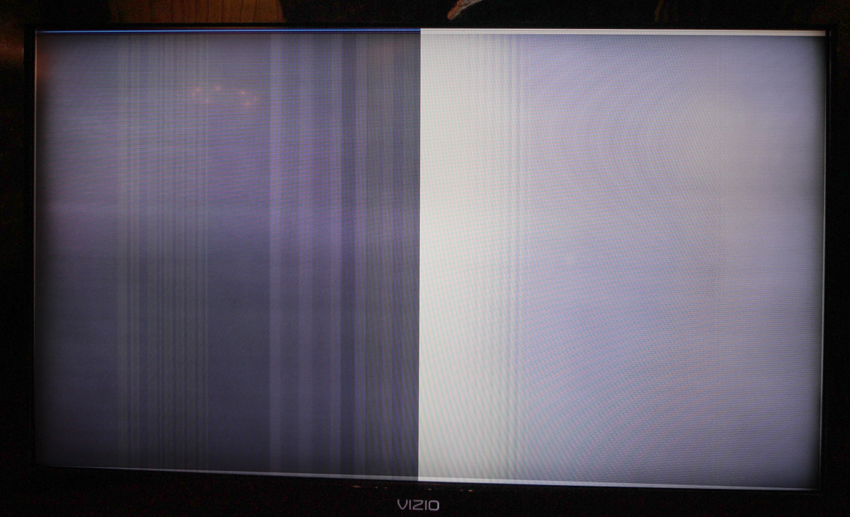

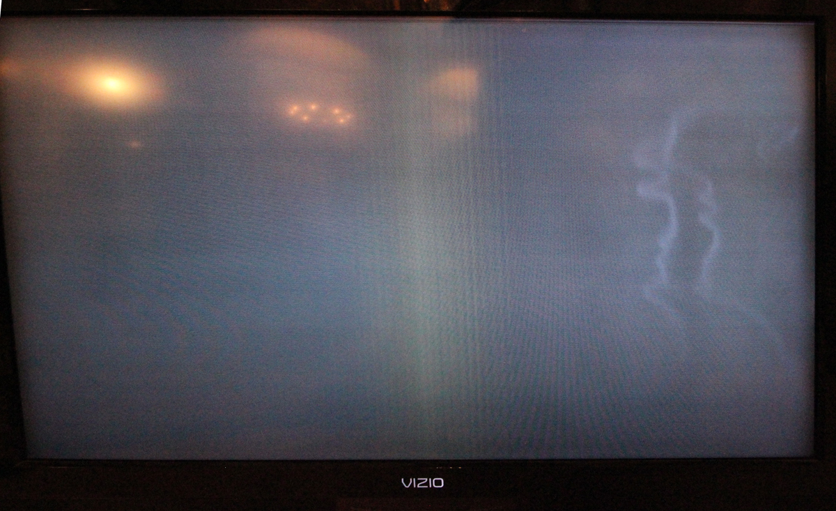

          First photo is with right ribbon connector removed (looking at back panel).
          Second photo is with entire T-con board removed - I noted the formation on the right side that looked like spilled liquid - would this indicate a bad display or would new boards correct?
          • Shinju
            • Mar 2014
            • 1239
            Can try and do a tab bond fix and see if it will last a little longer. Do you have freezing spray? Does the panel do anything if you flex it back and forth?
