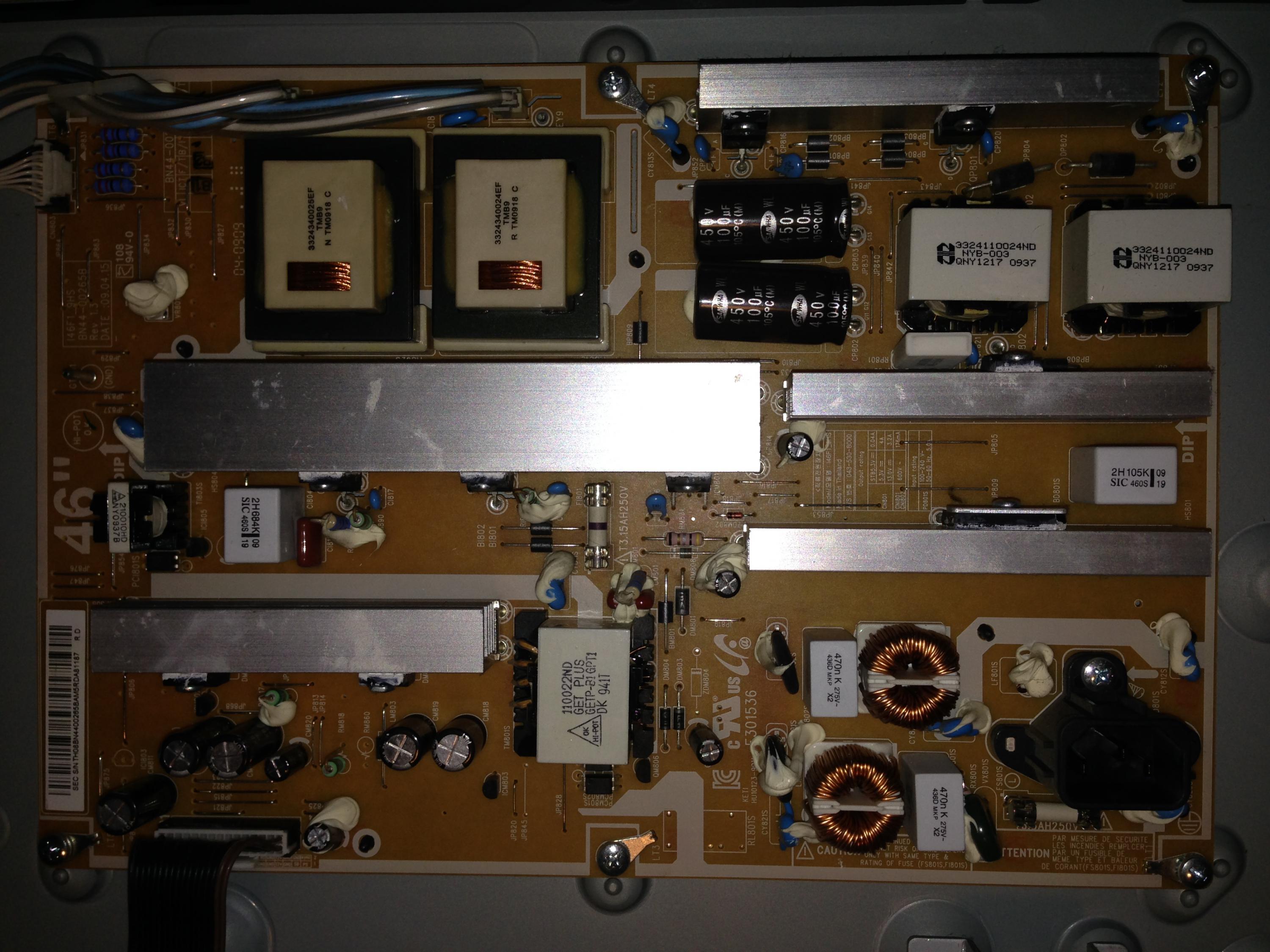

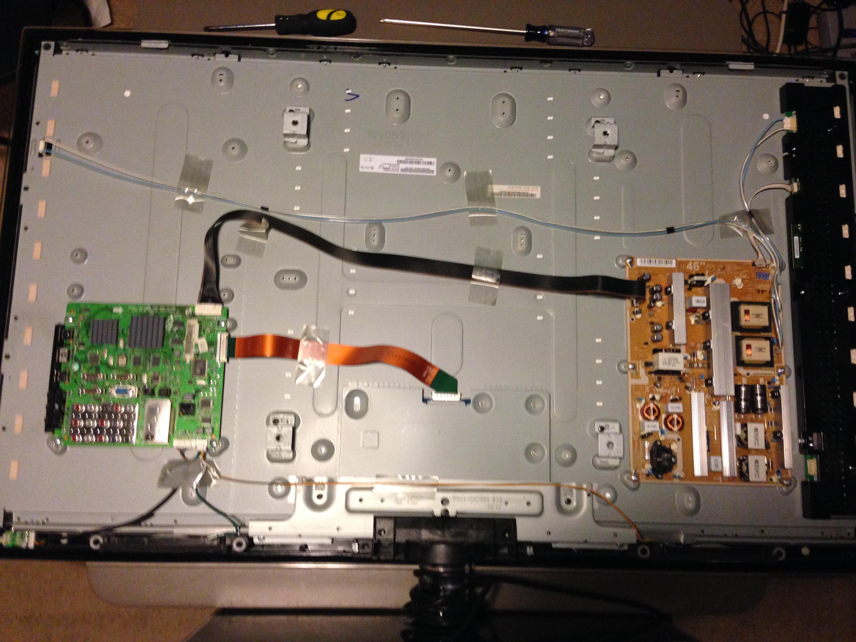

    This unit will not power up, when pressing the power button on the remote/unit the LED blinks until I unplug it.
    If I pull the connector to the mainboard from the PS the CCFL lamps come on when I plug the unit in.
    The suffix FUZA doesn't pull up a lot of information so I am not sure were to look next.
    The power supply pn is BN44-00265B
    Photos attached.

    If you disconnected the cable between the power supply and the main board, then we know at least that the inverter circuit is OK, now you need to check the standby voltage pin with and without the main board connected to see if the standby voltage will maintain the output voltage, if it does, then try disconnecting the cable between the T-CON and the main board to see if you can turn on the TV and have backlights.
      Re: Samsung LN46B640R3FUZA blinking power light.
      I did pull the cable from mainboard to t-con and panel would not come on.

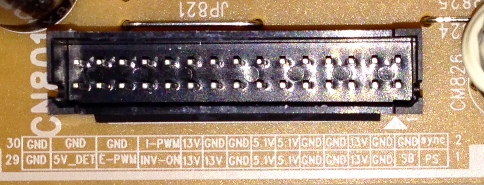

      I will test standby voltage.
        Pin connector.
        Seems to be getting 5.1 at the SB pin with mainboard disconnected.

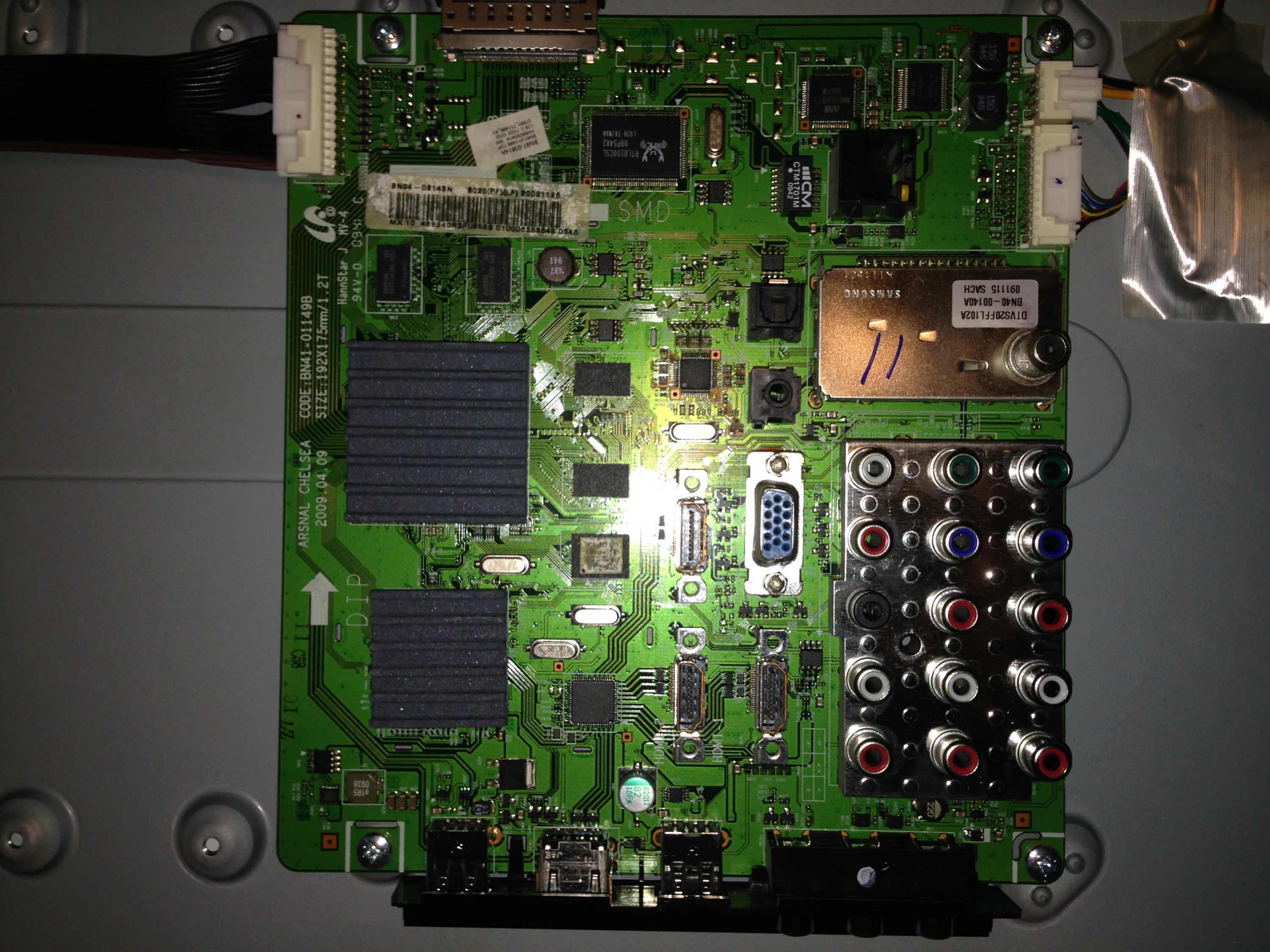

          Going to go with a bad mainboard for this one too. I farmed another "working" power supply and it's doing the same thing, blinking when Everything is connected, back lights come on when mainboard is disconnected.
          I did notice the eathernet port yellow light flashing once every 5-6 seconds.
          Tons of mainboard variants for this unit.
          If anyone state side has a working MB they want to sell let me know!

            So I got a replacement mainboard and the panel fired right up. My question is how do I find the proper panel type to switch it in the service menu?
            The mainboard was out of a LN37B650 and is set for a 37", I looked a service and training manuals but couldn't find panel type selection for this unit. The auto panel type is failing even after a firmware upgrade.
            The picture is fine, fits on the screen but in dynamic, standard and natural the picture is super bright and kind of washed out like a bad as-15g chip starting to go. When in movie mode the picture looks amazing, deep blacks no issues at all.
