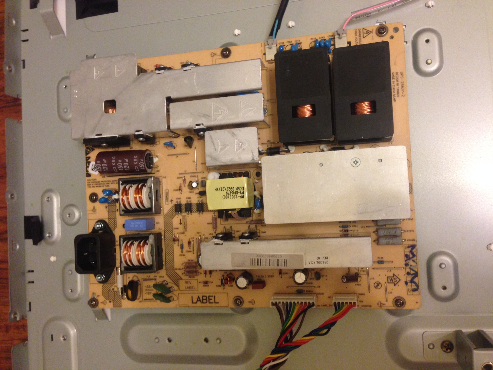

    Picked up 42 inch Vizio LCD from friend. At first when plugged in to power it will show orange vizio logo then when power on button pushed it change to white but black screen. Ordered power inverter combo board from Shop Jimmy. Got it pretty quick and this time the screen comes on, I have welcome Vizio logo on the screen then brightens will dim and it will go black again. It does it every time tv is turned on. I read on this website that bad bulb will cause it, strip it down all the way to backlight, 18 bulbs. Powered on all bulbs come on and appears 3 bulbs will stay brighter others will dim and again all die. Should I consider those bright bulb are problem or there is other test I can perform.

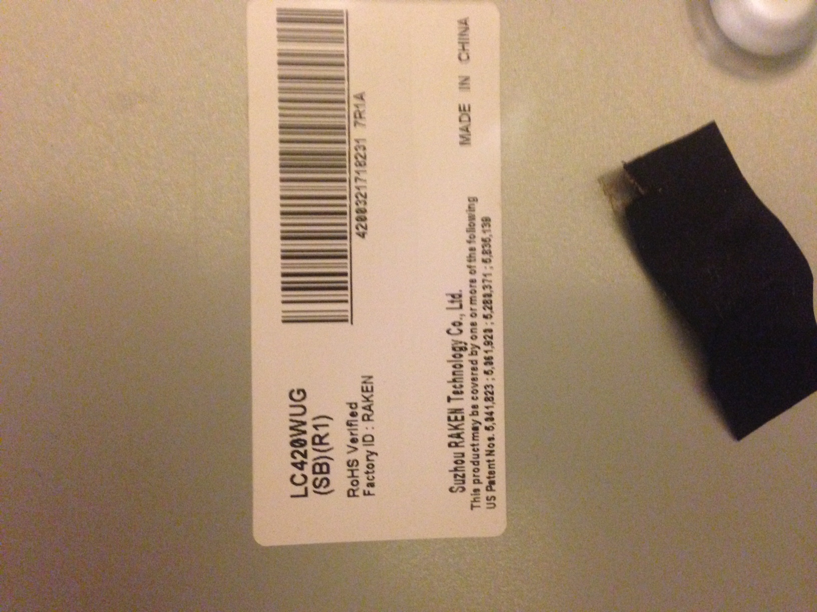

          Can we see good clear pictures of the board and the lamp assembly, also the LCD panel model number so we can look up the spec to see how all the lamps are connected and what type of lamps they are?

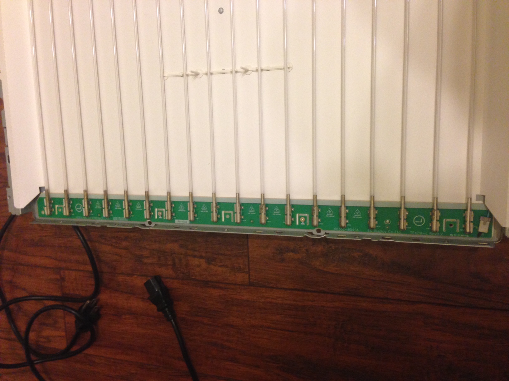

            I am having problems with pictures, maybe website problem. I will try again later. The board is combo power and inverter, bulbs are 3mm X 950mm. The panel is LC420WUG. I am powering backlight only with LCD panel removed, so maybe it should shut off after few seconds since T-con is not present. But all bulbs comes on.

              Re: Vizio V0420E
              Pictures are attached

                It should stay on without T-con board. So all the lamps light up evenly before shutting down since you indicate that 3 are lit up brightly? These lamps looks to be EEFL type and they are connected in parallel without having ballast caps per lamp like CCLF type.
                http://www.beyondinfinite.com/lg-philips/lc420wug-sca1/
                Those lamps are socketed, did you carefully try to reseat them?

                  Re: Vizio V0420E
                  I reseated all of them. After reseating it appears that all bright up evenly and shot down faster.

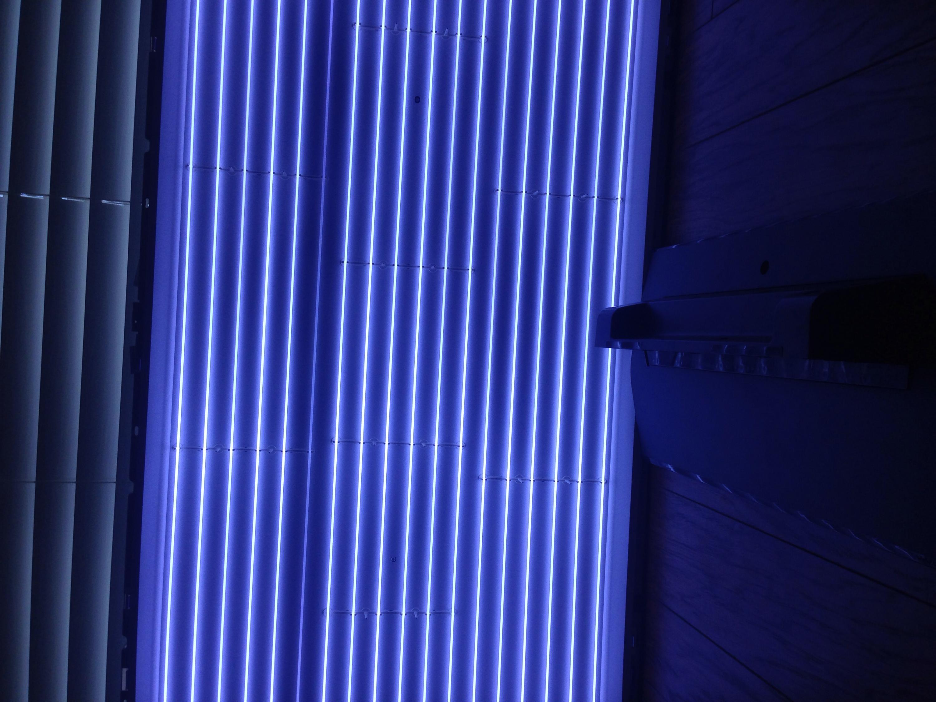

                        Re: Vizio V0420E
                        Got it somehow to stay longer and took a picture. It appears that bulb #6 from the top is dim.
                          • 31182
                          Re: Vizio V0420E
                          interesting,
                          they are different colours.
                          i realise this is probably down to the camera sensor being more sensitive than the eye, but it shows they are either unevenly made, or pretty worn!

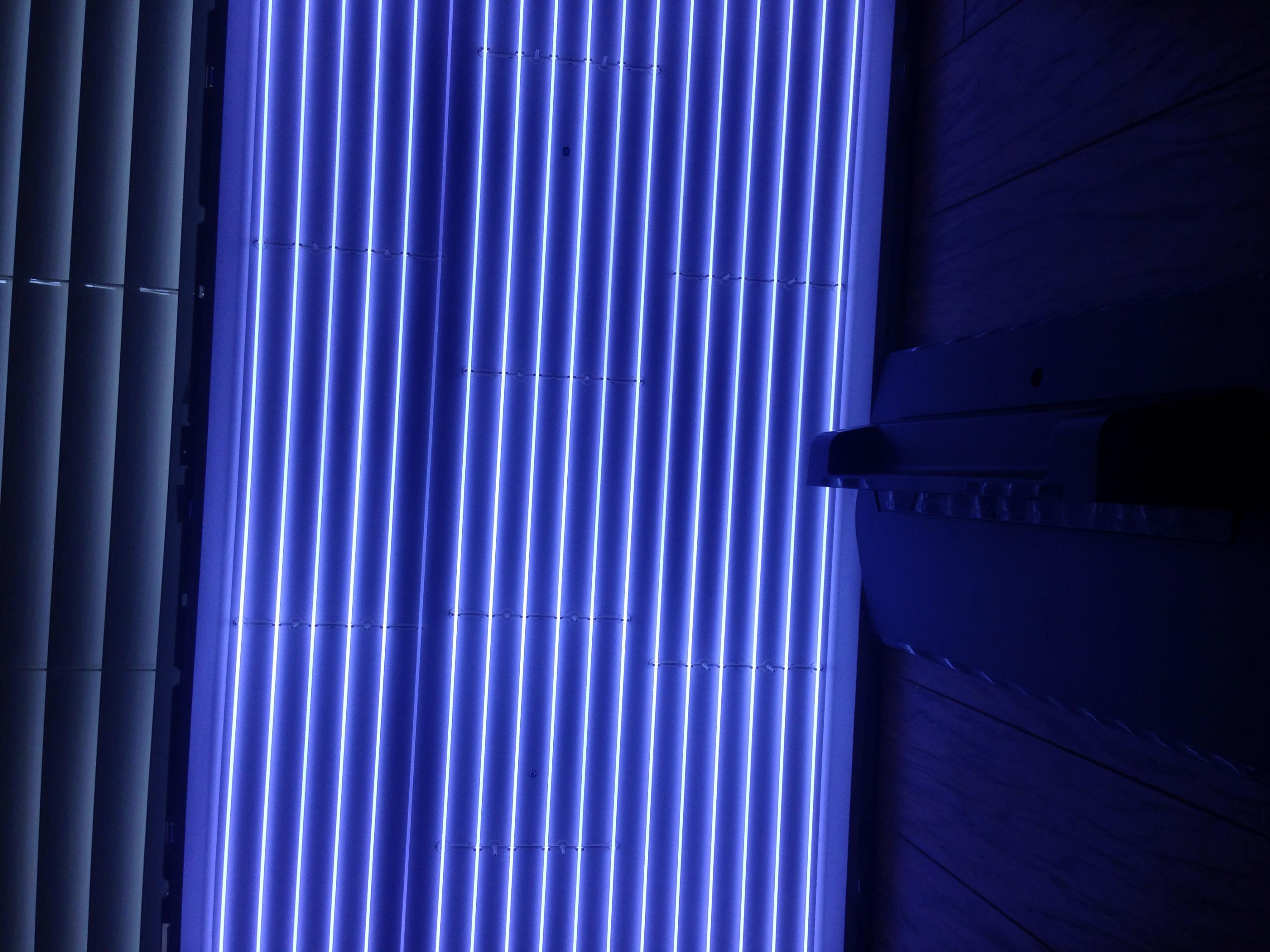

                              Re: Vizio V0420E
                              STJ it was just camera, second picture may be better.

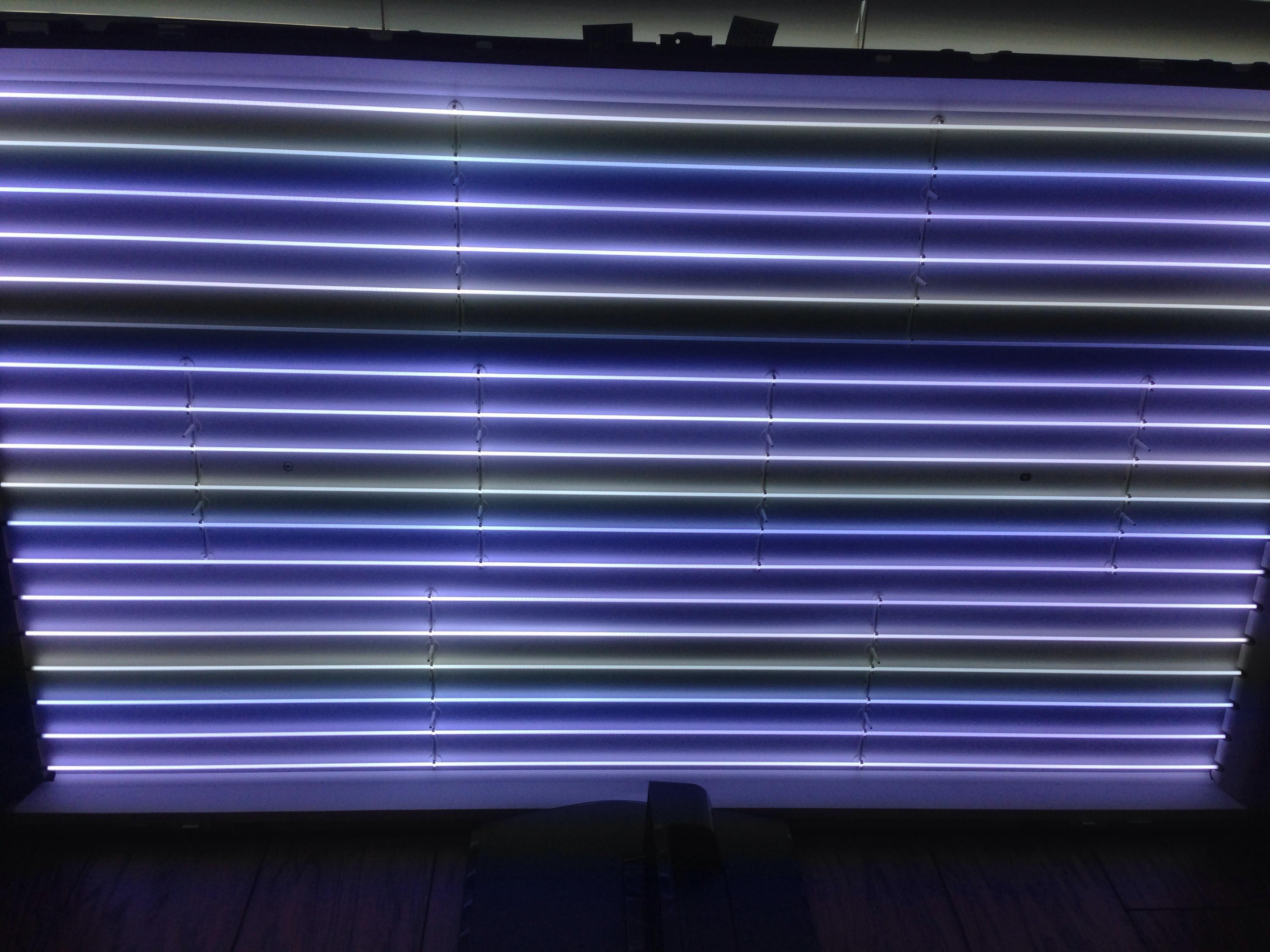

                                Re: Vizio V0420E
                                Maybe this picture is better

                                    No.
                                    Can you swap the #6 lamp with other lamp to see if the problem follows?

                                      Re: Vizio V0420E
                                      I swapped the bulb 6 and 1 and it was shutting down very fast. Then I completely removed bad bulb and the backlight stayed on, never shut off. So I definitely know which bulb is bad, now the question is where can I buy it in USA.
