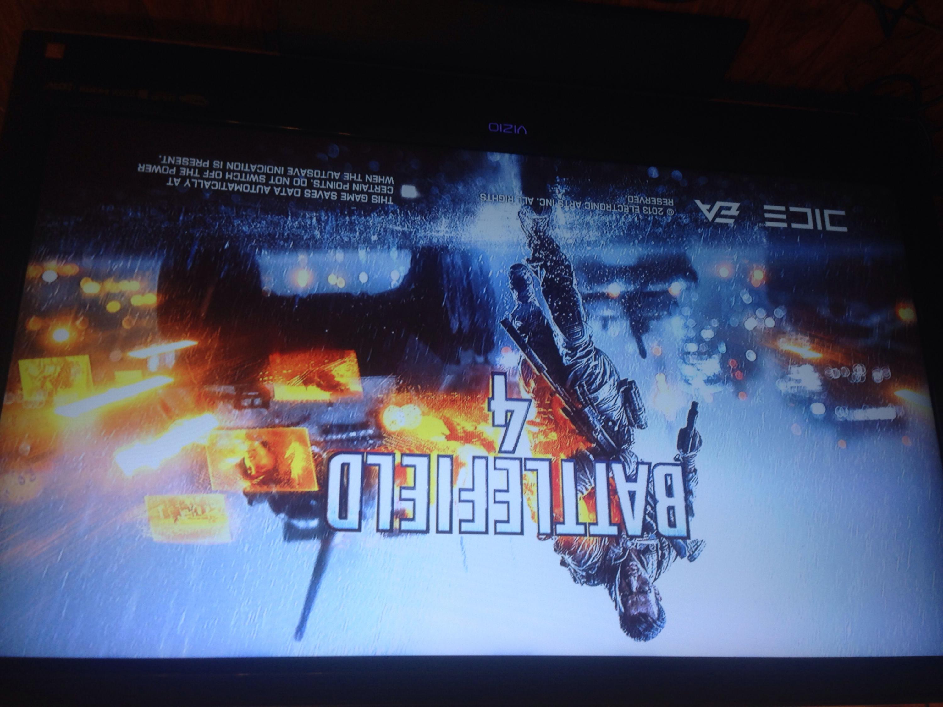

Vizio V0420E
    Re: Vizio V0420E
    These are used but they are from a Vizio 42"
    http://www.ernestos-electronics.com/...3-4mm-x-960mm/
      Re: Vizio V0420E
      Thanks, mine are 950mm long. I will have to measure if I have space to extend 5mm on each side. Went to bunch tv repair places in Dallas, but no one has it or wants to sell, either used or new. They said they don't perform this service on backlight, they replace entire backlight assembly.
        Re: Vizio V0420E
        Got new bulb, same problem. If I remove any single bulb other 17 stay on. If I have all 18 plugged in it shuts off.
          Re: Vizio V0420E
          Got another power inverter board from Shop Jimmy and it's working great now. Put the LCD screen and all frames around it. Only problem is that HDM1 is not working but HDMI 2,3 composite and AV works great.
          Thank you all for your help.
