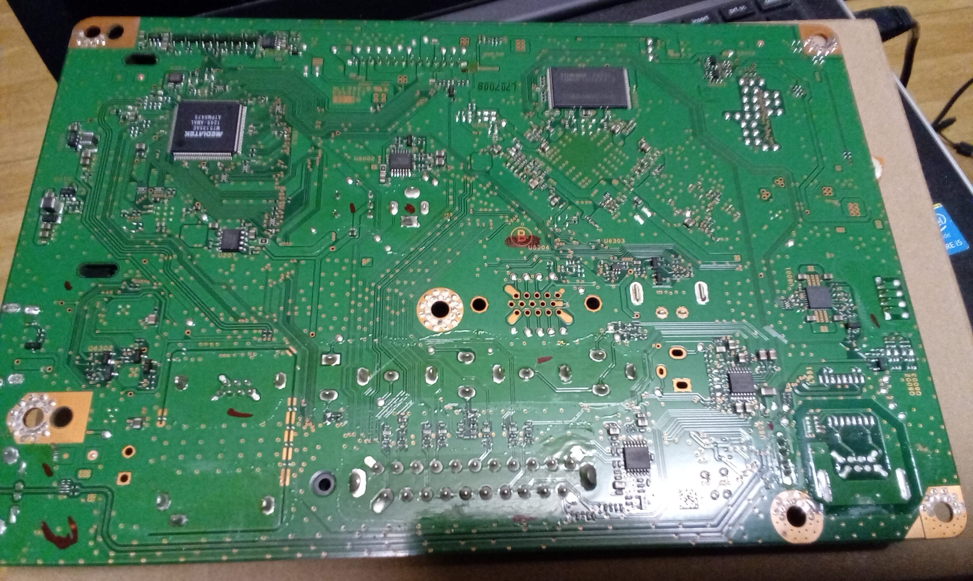

    then remove the SoC from circuit, will be first step to know where was the short.
    • nomoresonys
      • Jan 2013
      • 12271
      • U.S.
      #42
      Oh shit my bad, I didn't look close at the chip, it's not bga so no reflow like Diah said. If the caps near a chip read short on the board but ok off the board then a lot of times it's that chip that's bad.

        [QUOTE=nomoresonys;n3625460]Oh shit my bad, I didn't look close at the chip, it's not bga so no reflow like Diah said. If the caps near a chip read short on the board but ok off the board then a lot of times it's that chip that's bad.[/
        well I'll do as Diah has suggested but I have to buy a replacement Chip it's not worth fixing this Tv want to try something and learn

                      Doesn’t mean anything with these Mediatek IC’s. If you search older threads here, you find tons of mainboards with this Mediatek IC that failed just like that.
                      it is not Shure that Mediatek IC is the fault because i found some shorted caps on the other side of the board so it is not clear yet

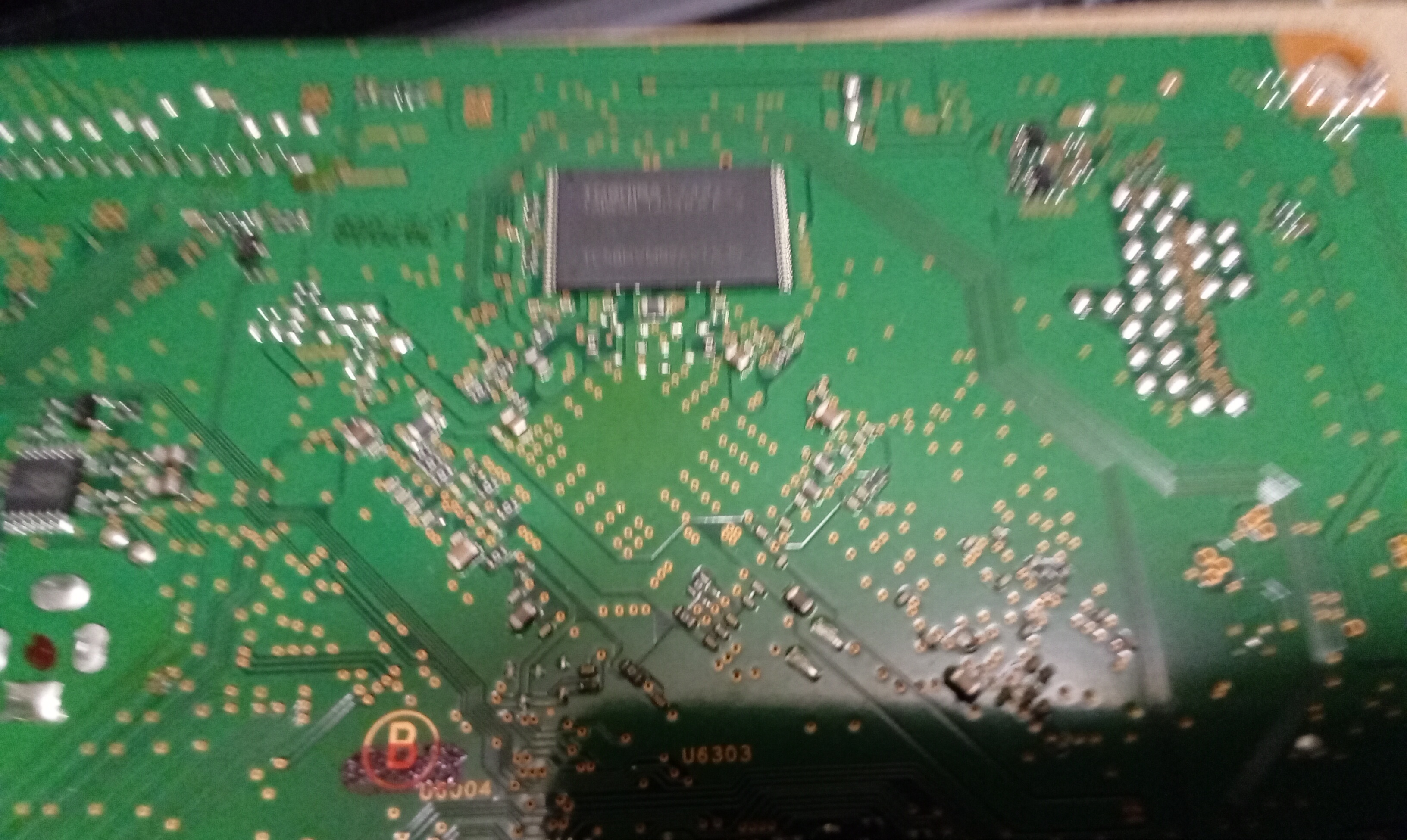

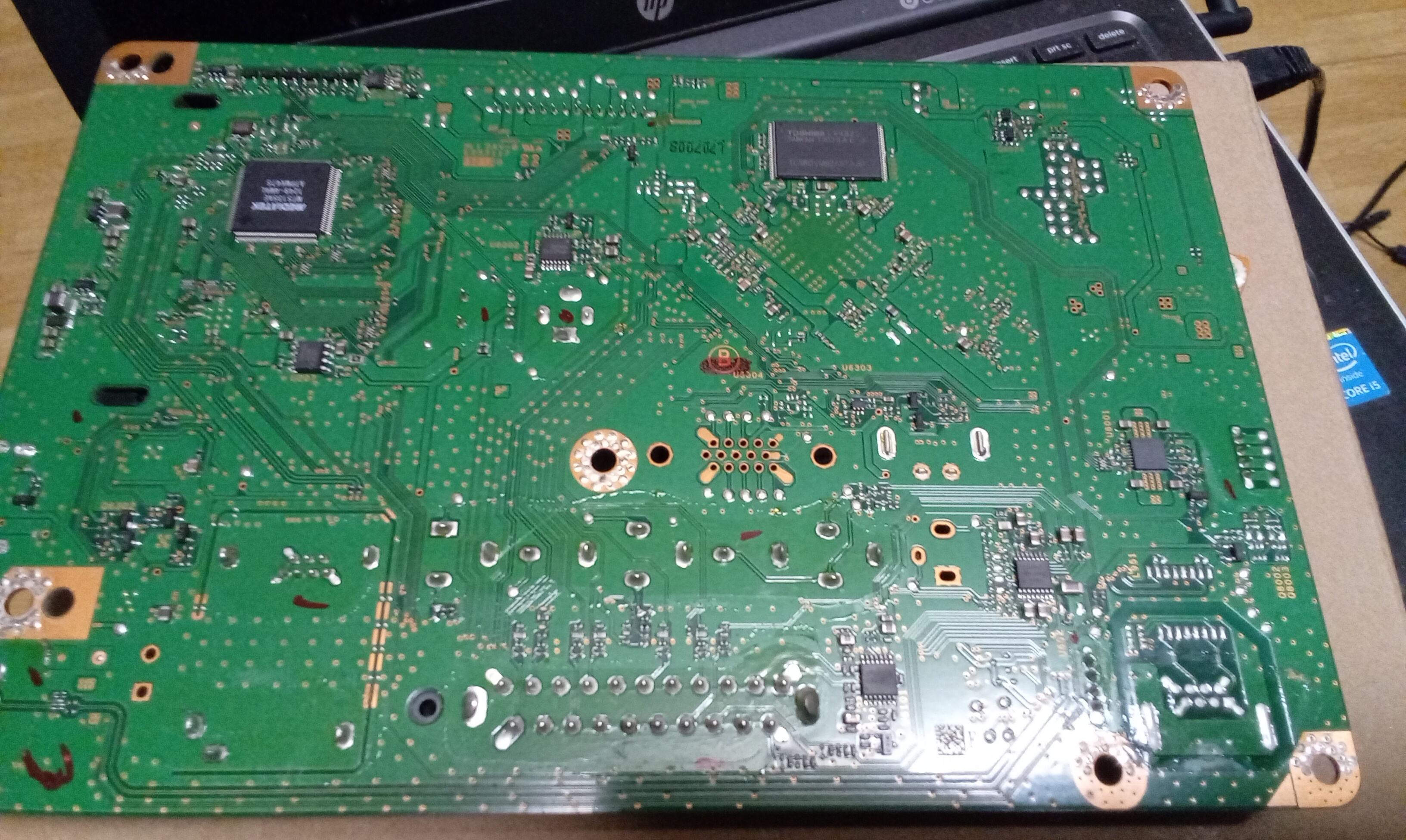

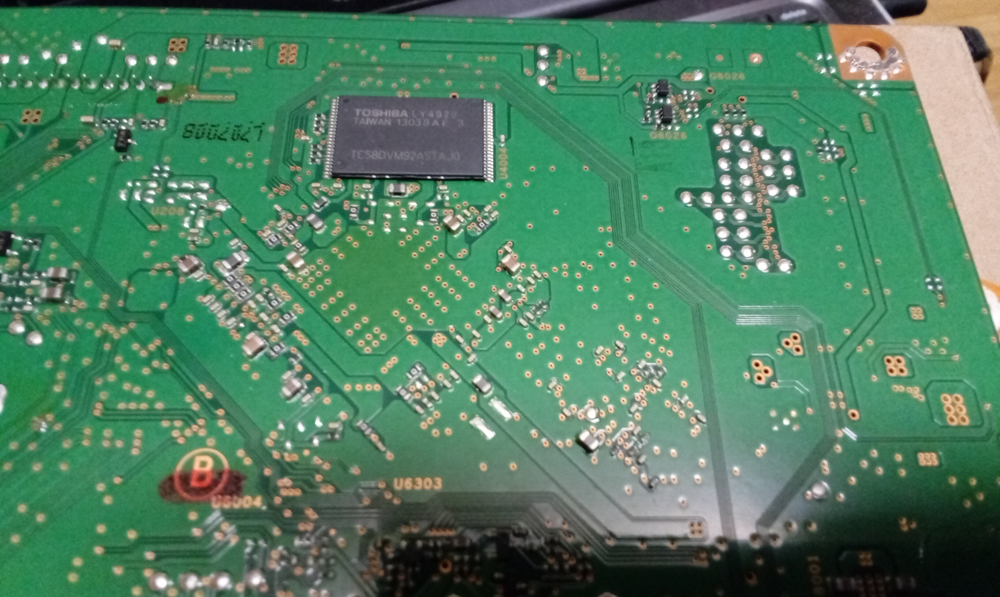

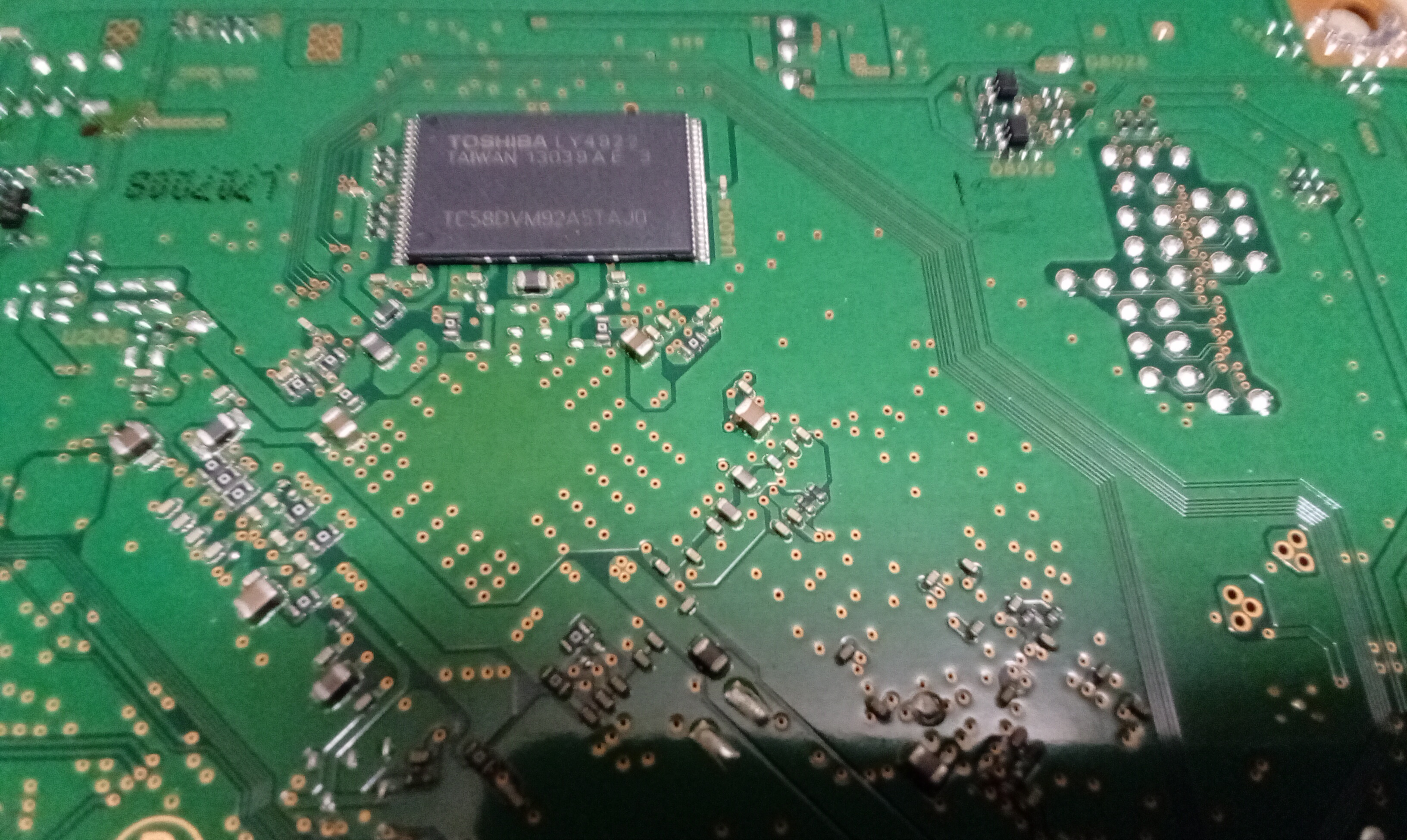

                        Can you post a good picture of those shorted caps?
                          here some they are 1each side of that big chip and under it 4 big ones and 2 otr 3 small ones all are short
                            That is not a good sign if the caps underneath the Mediatek are shorted.
