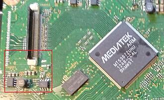

      look at this
      • bohaboha
        • Nov 2012
        • 1017
        • sweden

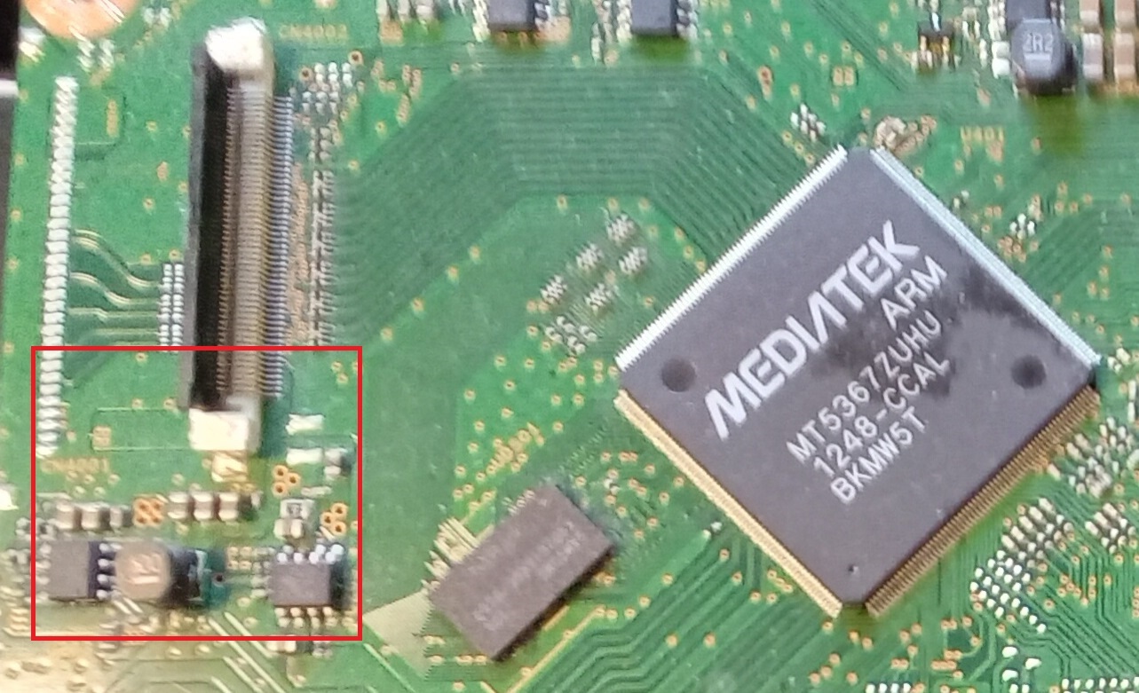

        Hi again i took away one of those 3 capacitor but the short still there. even the one near SoC and nothing happened i will go on and take away the choke and se what it gives but it is possible as Diah said the culprit is the SoC MT5367
        • CapLeaker
          Leaking Member
          • Dec 2014
          • 8325
          The problem IS the Mediatek IC. Kinda surprised it held up that long. They were a lot of problems with these Mediatek IC’s back then.

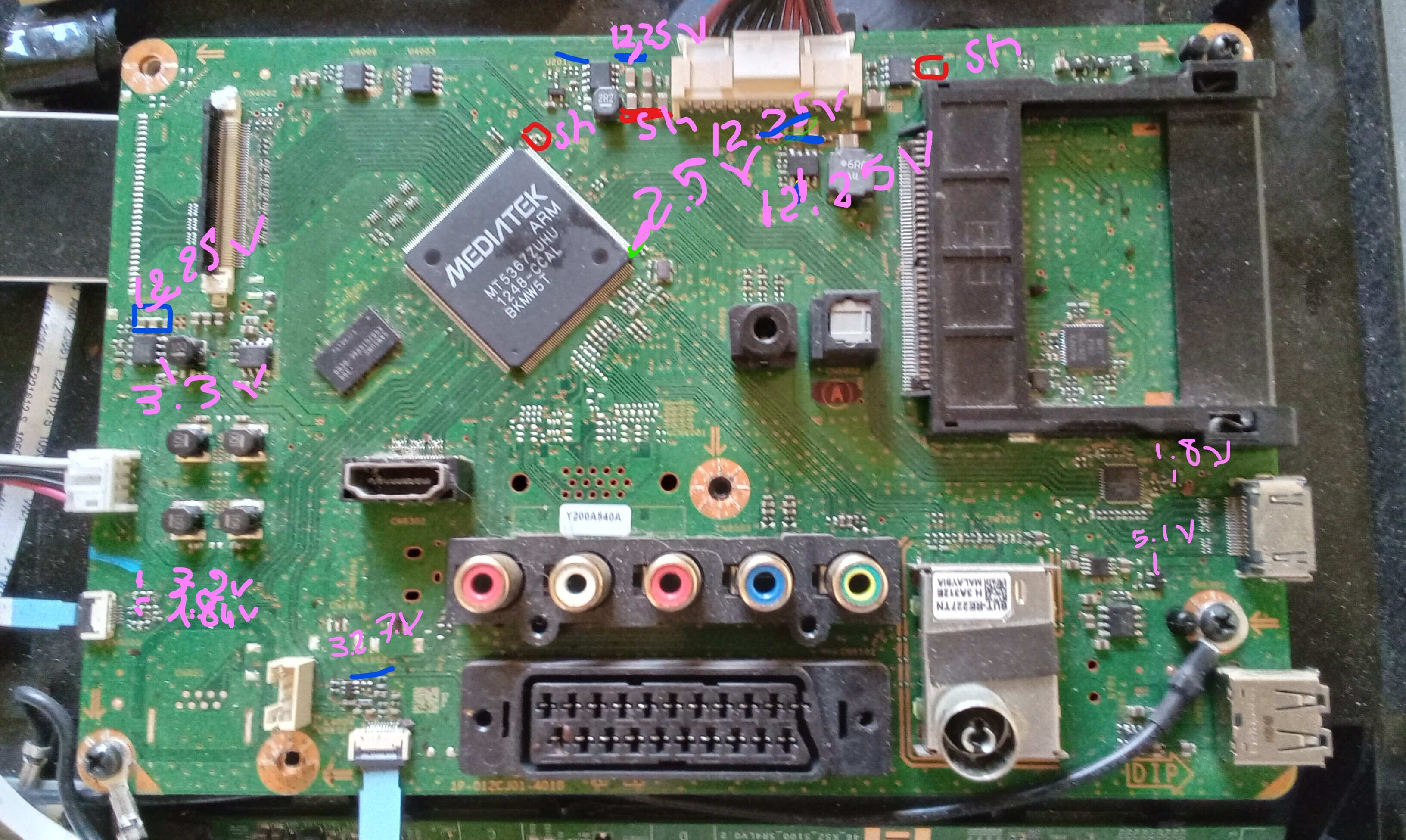

              you said you don't have 12V on Panel fuse... so check this area where you could find this 12V
                thank you Diah please look at post 22
                • Diah
                  • Feb 2013
                  • 6435
                  then why you wrote no 12v on panel t-con fuse? at time u have it on lvds socket !

                      #30
                      because there is no voltage at the fuse and at all the panel Bond both parts i do not find any voltage att all and i do not find any voltage at that socket on your picture just on the capacitor under it there is 12.25V

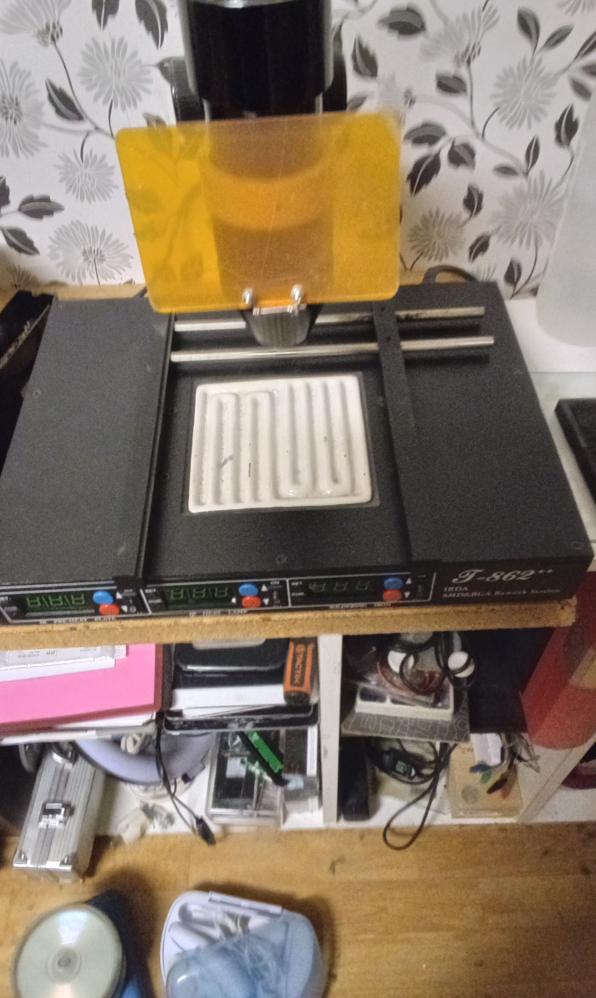

                        Just carefully reflow the mediatek, won't hurt it as long as you don't overdo the heat but too little heat will have no effect. Then try it, might get lucky. Check youtube, plenty of good diy reflow tips there, remember that not all of the youtubers do it right so probably have to wade thru some.
                        i have this IRDA SMD And BGA Rework Station T-862++ i am thinking to use to just reflow the chip maybe 220 degres C max use on this one is 350" C i think
                          From heating mediatek, you will not have a short circuit on the motherboard.
                            Then you think it is worth a tray with my tool ? or better to use hot Gun and a good preheating 220" to 230" C

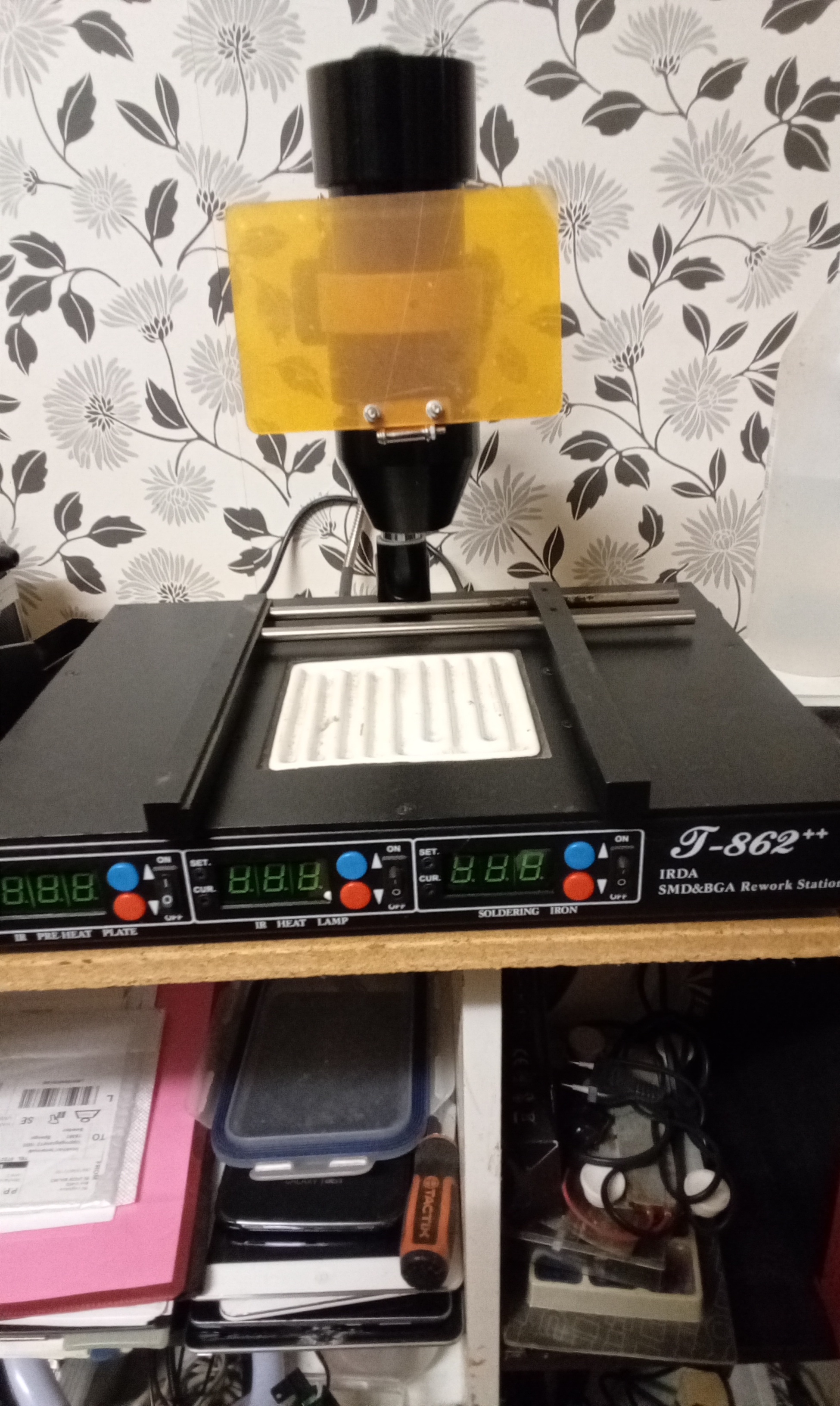

                              #34
                              What do you want to do with the Mediatek chip, replace it with a new one, are you sure that it is short-circuiting or do you just want to warm it up and think that the short circuit will disappear.
                              • Diah
                                • Feb 2013
                                • 6435
                                #35
                                this MT SoC cant be refllow or heated ,
