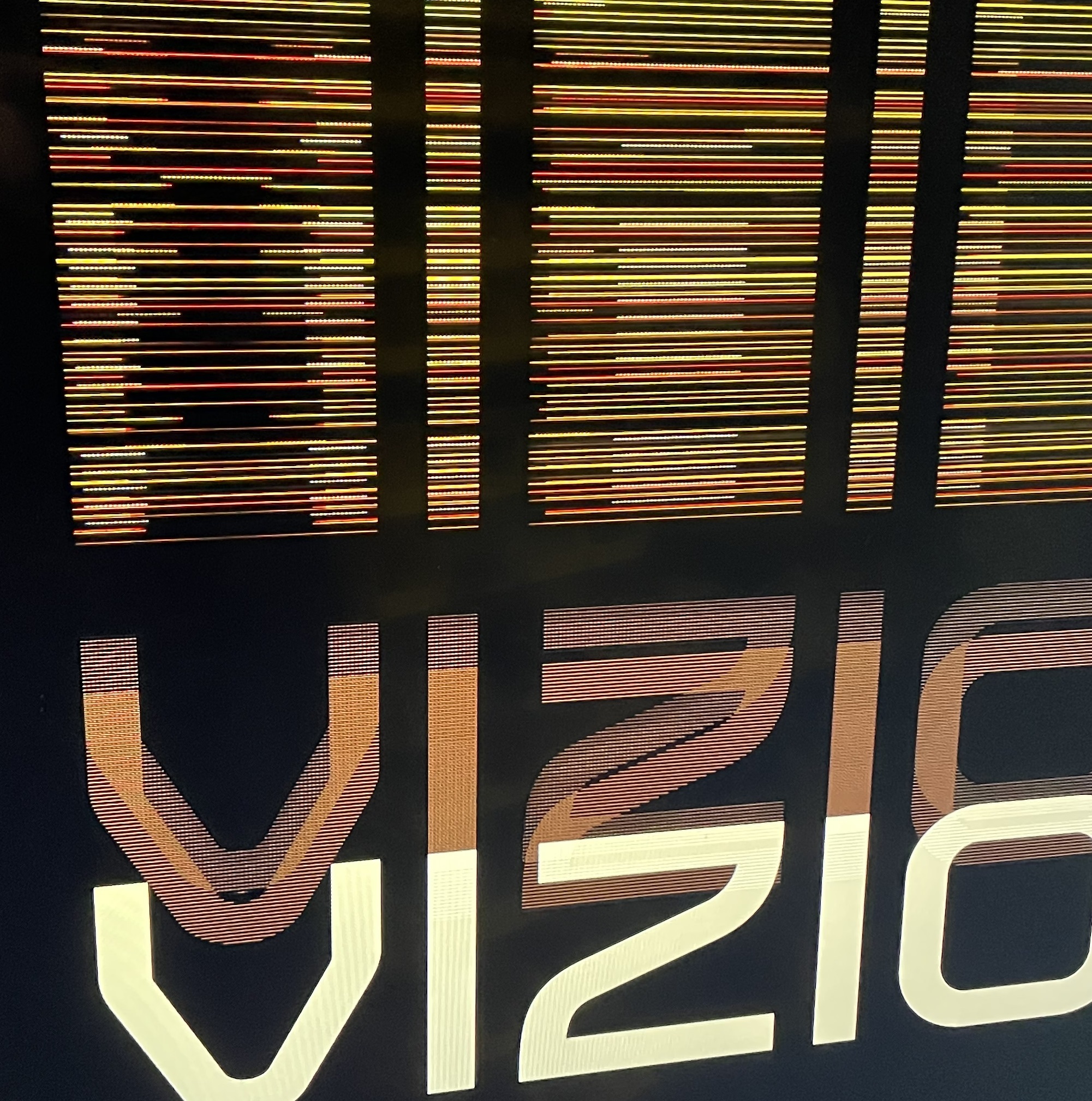

    I'm working on a Vizio Model V555-H1 that displays a cascading series of horizontal lines when first powering on. These lines appear to be in the shape of the Vizio Logo and descend until reaching the logo before resetting to the top and continuing their descent. I have reseated my TCON board and dusted connections but still have this fault displaying. I'm familiar with vertical lines but this one is a new one for me. My research into this problem hasn't yielded results as keyword searches point back to vertical line problems.
    Anyone have any recommendations? I stand ready to remove diodes on the buffer board.

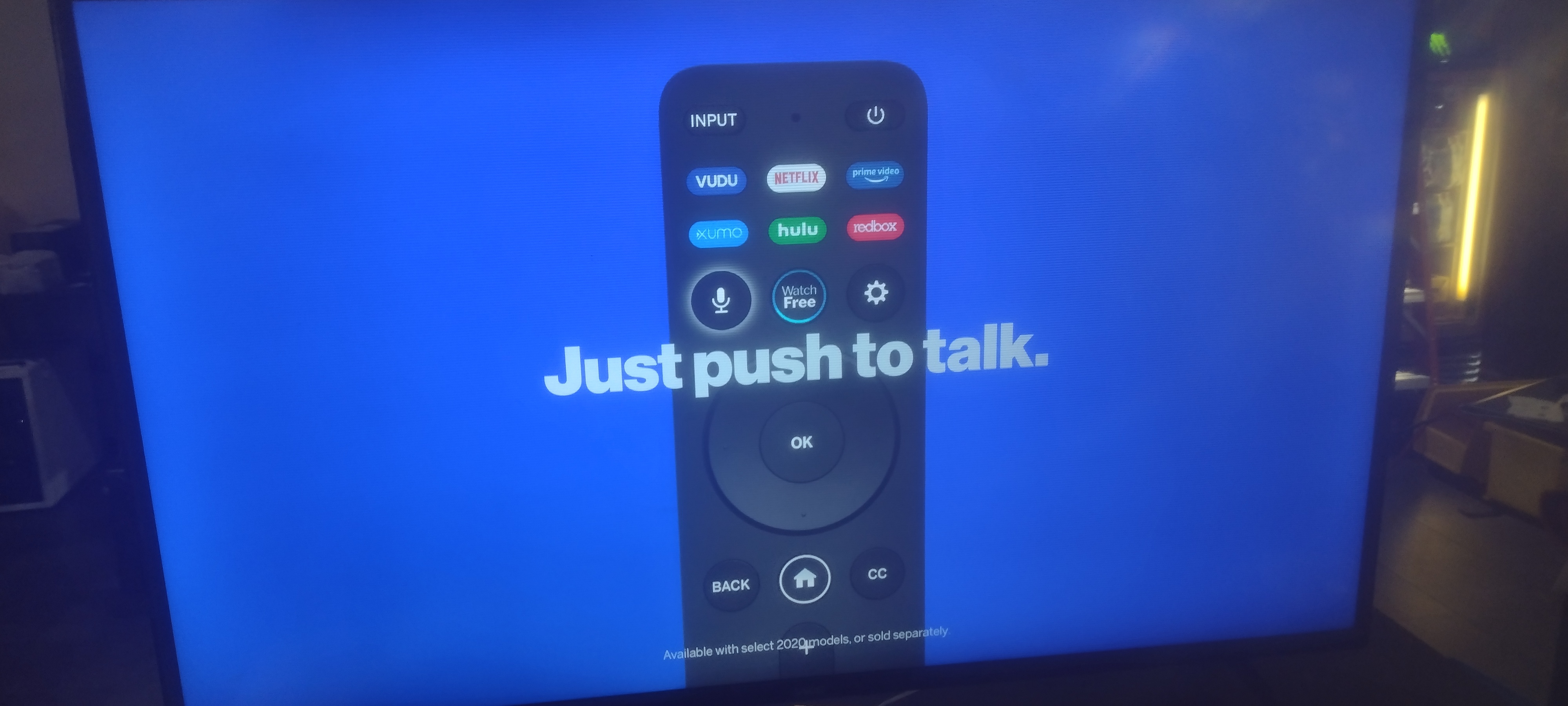

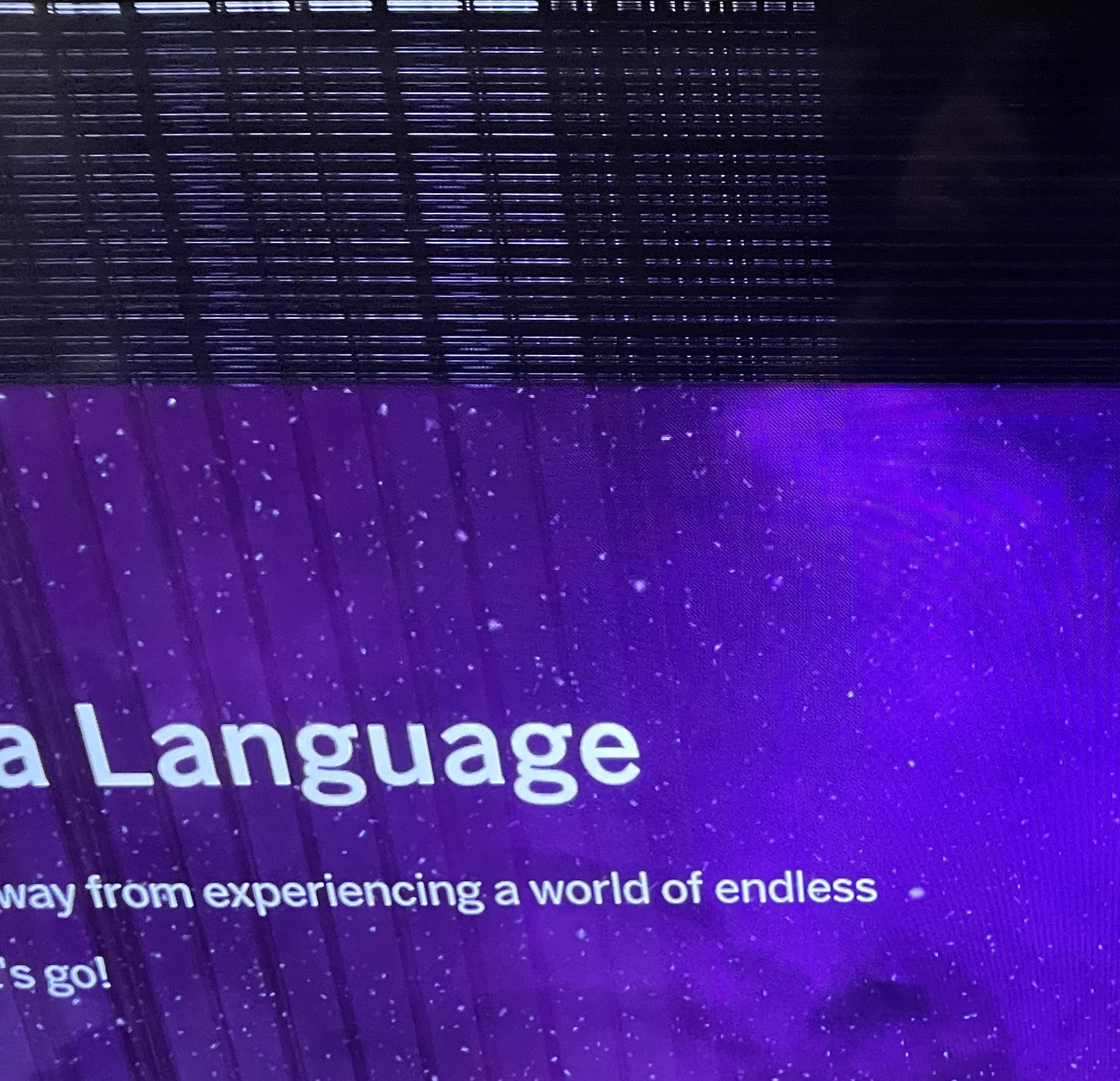

    Once the display reaches the home/landing page it switches to this:

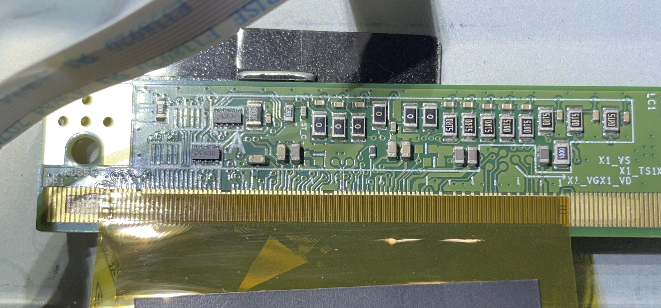

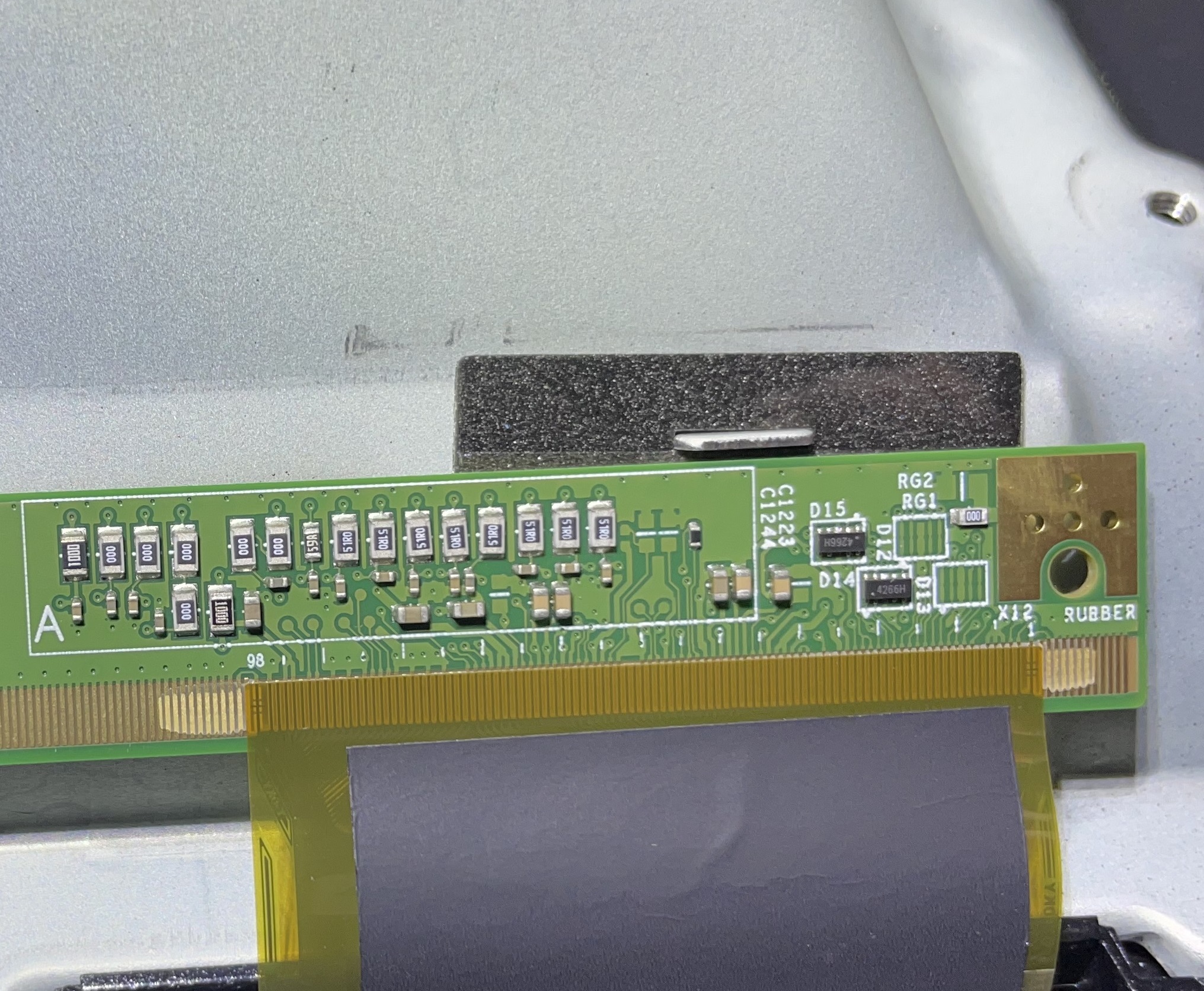

      Here is a view of each side of the buffer board at the bottom of the display.
      Left:
      Right:

        Disconnect the strips from the T-con and check the resistance of each diode assembly relative to ground (each diode assembly has 4 pins, the middle 3 pin is GND)

            It is better to measure resistance on large limits (200kOhm, 2MOm). Disconnect the left bar from T-CON and turn on the TV, see how the image will be on one half, then do the same with the right side...
            • Garret Matt.
              • Apr 2025
              • 22
              Disconnecting the left bar from the T-CON allowed the opposite side of the screen to display correctly.
              Disconnecting the right bar from the T-CON resulted in the same cascading screen image.

                • lotas
                  • Jan 2016
                  • 4888
                  • Russia
                  So there is a problem on the left side, try to mask it on the CKV line...

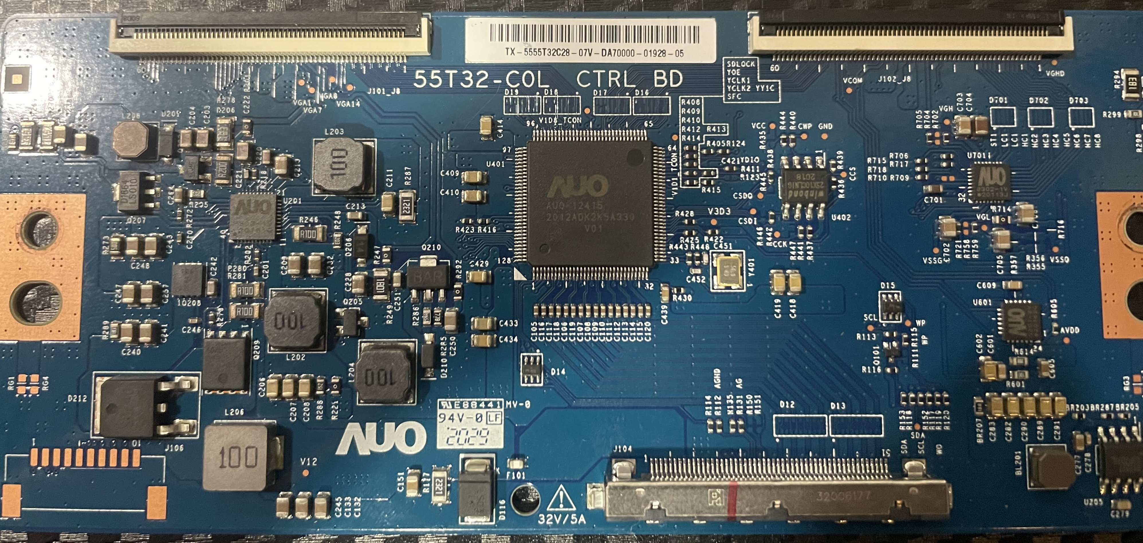

                    Having trouble identifying the CKV Line without a data sheet for the IC. My search yielded no results. Is the CKY marked differently on this T-CON Board?
                    • lotas
                      • Jan 2016
                      • 4888
                      • Russia
                      They are in this area, pick up block these pins from the sore side, for the best effect...

                          we do have here dual Channel Timing T-CON., one channel defect, could be Quartz or PMC, or also MB Data issue ... best way disconnect the LVDS, if yours BL remain On. fed the TCON F101 with 12V VCC and let it start RGB Test.for period of time., this will reset the T-CON SPI / gamma/ PMC
                          • Garret Matt.
                            • Apr 2025
                            • 22
                            Do you suppose replacing the TCON F101 would provide the same results? I do have a donor board and i'm much more confident swapping ICs than injecting voltage.
                            Here are my results after trying 'Iotas' suggested fix. It was in fact a signal timing issue. Effectively this Television has been saved from E-waste so I'm satisfied with this conclusion. There are vague lines when the device first powers on but it's hardly noticeable with a full picture at a comfortable viewing distance.

                              Well, that's great, as I said, the problem is on the left side in the panel itself and here it is not a two-channel T-CON clock signal, but a regular one and is divided into each half of the panel.
