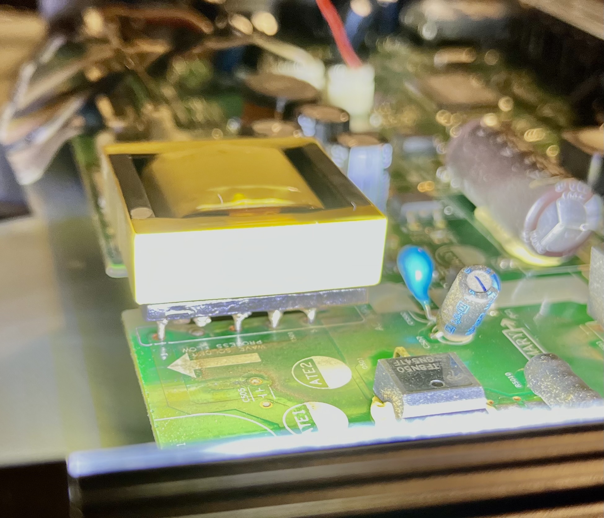

      Click image for larger version  Name:	IMG_6103.jpg Views:	0 Size:	3.29 MB ID:	3167486 So I noticed a buzzing noise coming from the yellow part in the pic. What is this and is it the cause of the lines? This model has the main and power board together and no tcon.

        Transformer, check the solder joints on that and the rest of the solder joints on the board, can search images for bad/cracked/cold solder joints if needed.
          Edit:
          Ok i will look closely. This TV only has this one board so is the buzzing the cause of the lines?
          Solder seems to have worked its way where the second pin in attached pic is disconnected. How in the world do i solder that?

            That one is suppose to be like that.

              I don't really see any bad solder on the board so i was wondering what i can check next? The board is the tcon/ps/main all in one.

                And you took the board out and checked all the solder joints? examples of bad joints: https://www.google.com/search?client...h=599&dpr=1.09
