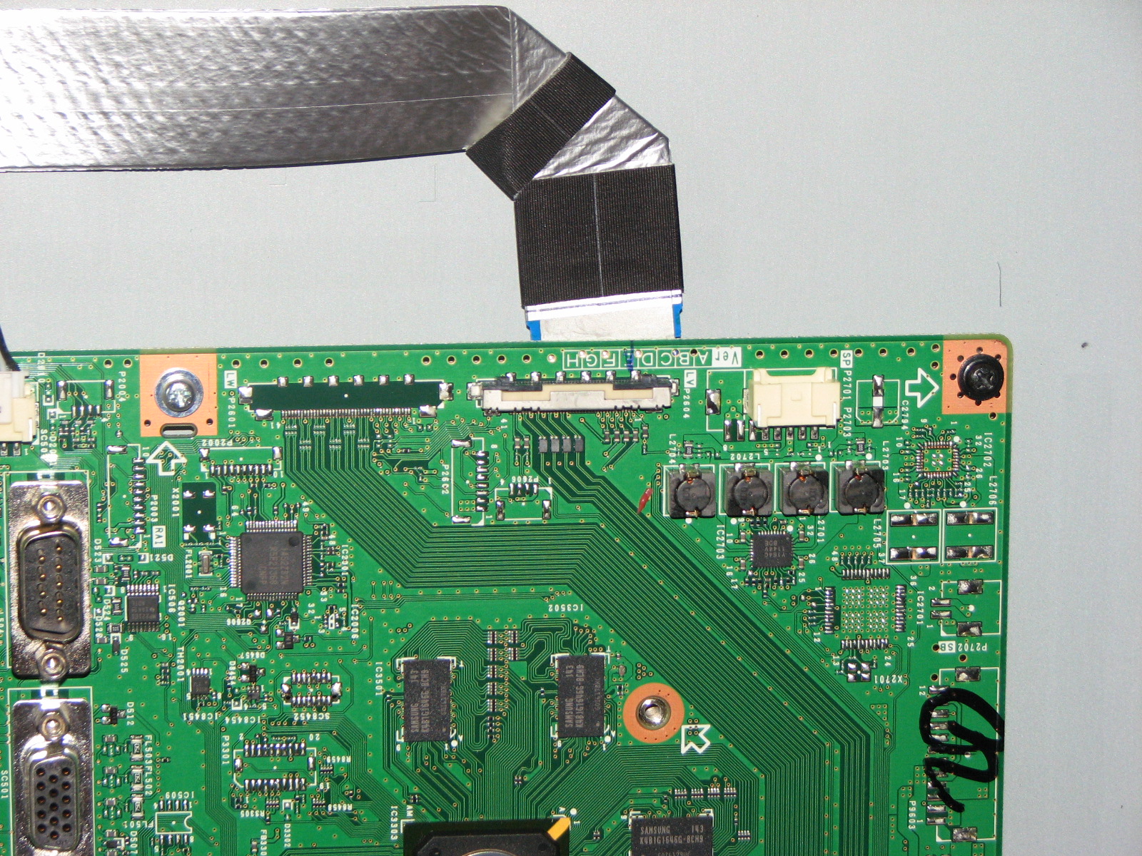

    I have a Sharp LC-60LE640U and cannot seem to figure out the proper way to open and close the connector for this particular cable. Would someone know the proper way of installing this cable?

      Oh. I am sorry. Here is the picture I meant to upload.

        Hi. Any suggestions on how to open and close this connector?
          Re: Sharp T-Con LVDS Cable Connector - How to open
          How about a picture of the other side of the board...
            The cable is sitting disconnected it plus right into that connector. There is nothing on the underside of the board.
              Hmm, can I see the point of view of the slot for the cable to go in? It looks like the brown section needed to be push up (slide) on both ends by a very small amount.

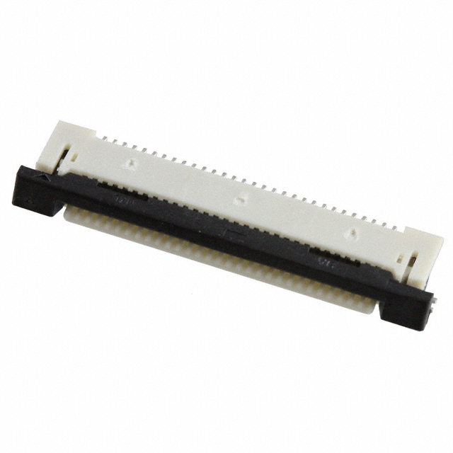

                If it has a slot like in the picture I attached, then the black part should slide out about 1/16 of an inch, then you slide in the flat cable and then slide the black clip back in.
                If your slot is on the bottom like my picture, the the pins on the ribbon will point down towards the board.
                If the slot is on the top side, then the pins would face up away from the board

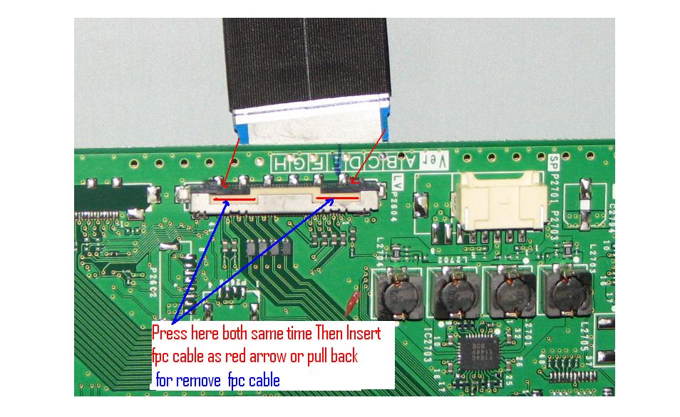

                  This may help you?

                    anmol,
                    Thanks for the help! That was the answer.
