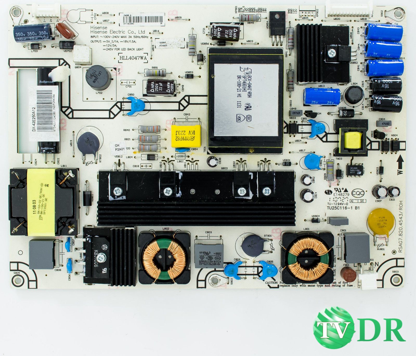

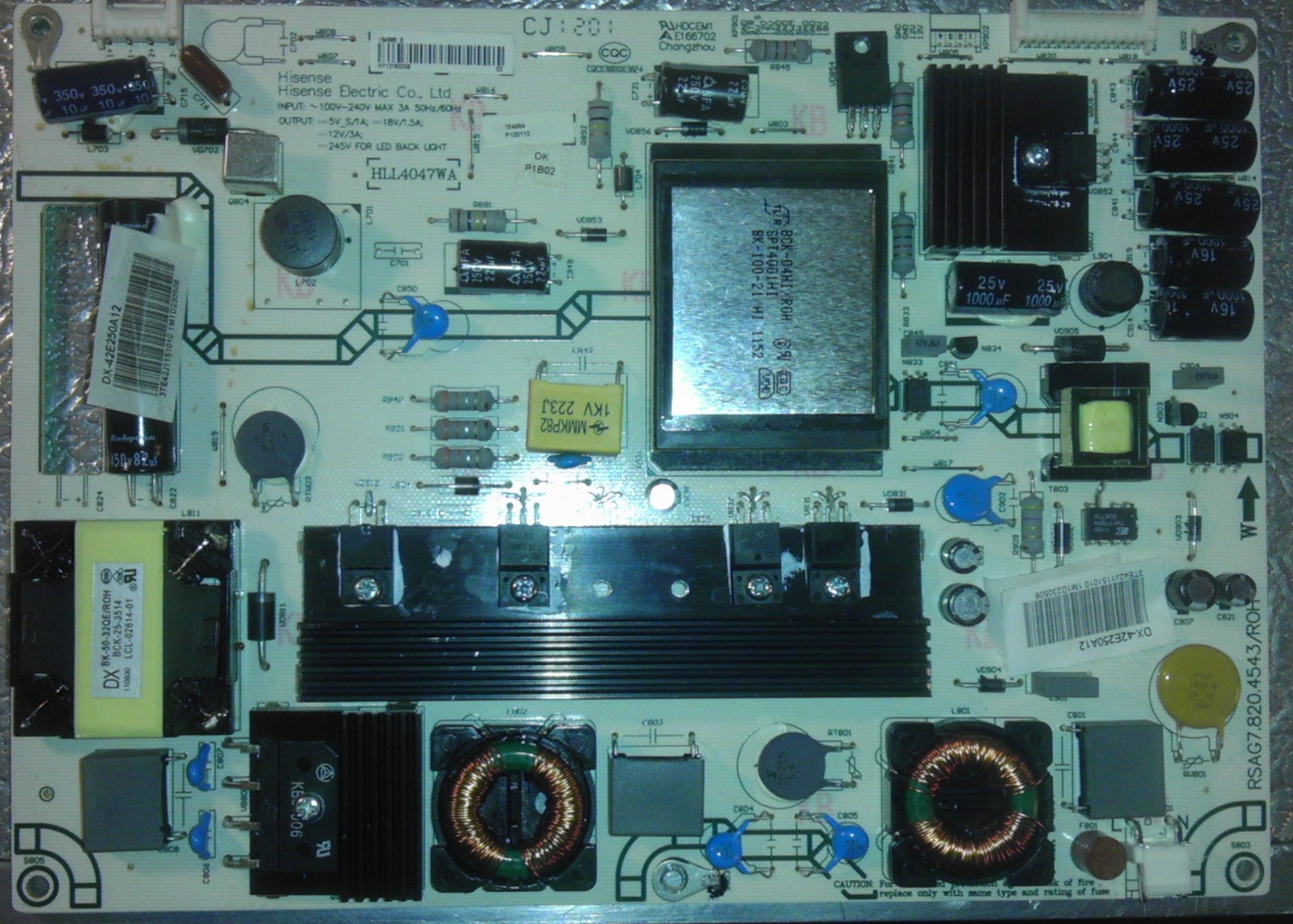

    Recently our Dynex DX-42E250A12 42" LCD TV stopped responding. When we shut it off, we could not turn it on. The standby LED remained lit, but there was no response to the "on" button. I have a smattering of electronics experience, and I've replaced things like fuses and caps on circuit boards before, so I took it apart to see if I could find a problem. The TV is easy to disassemble. There are only three boards inside. The power supply board is the only one that has non-solid caps on it. I could not find any that were bulged, and the fuse tested good. Connections all looked tight, and I could see no evidence of cold solder joints, no hot spots, etc. I put the board back on and plugged the TV in, switched it on. It came on, but I heard a faint cheeping, and after a few seconds, one of the caps on the power board started smoking, and exploded. I did nothing to the board, there were no shorts, etc. I'm wondering what might have caused this? A bad voltage regulator? The cap that blew was the largest one, on the far left in the picture, a Rubycon 82uF 450V capacitor. I've found a new board for it, but I'm hoping the fault here is confined to the power board, and not something else.

      Best I can do for pictures.
        Re: Exploding cap on Dynex power board...?
        You said the cap exploded, did it leak any liquid? I cannot tell from looking at your board to see the damage on the cap. That is the main filter cap. Did the main AC fuse also blow?

          It sprayed liquid all over and gave off a huge cloud of smoke. You can faintly see some residue above and around it. The main fuse (lower right, round red object) is NOT blown.
          Here is a closeup.

            It's possible it just failed by itself due to a manufacturing defect or such. If it went open-circuit I think that would explain the fuse being OK. Then the PSU wouldn't work because there would effectively be no filter capacitor to keep the mains voltage up.
            Or perhaps some failure in the PFC circuit caused it to be over-volted? Budm, do you know if this is possible?

                I'd say it is a problem with the PFC, keep in mind, that is a rubycon capacitor that blew. Never seen a high voltage rubycon capacitor go bad before. Doesn't mean it is impossible though!

                  i would replace and hook up a meter when firing it up.
                  there should be around 400vdc across it.
                  be ready to pull the plug fast if it overshoots!

                    Yes, it is possible that the PFC lost its regulation.

                        Power Factor Correction
                        I actually had a power board recently which was "eating" 450V caps. Two blew up. (Old one & replacement.)
                        I checked it the bus voltage. It was 360V normally (a little low.) Just before the second cap popped my meter went over-range (that means >660V...)

                          Not to be walk on this thread, but your board looks exactly the same as mine. I have the same problem with mine. I'm sure that the problem is in the PFC circuit. See link below:
