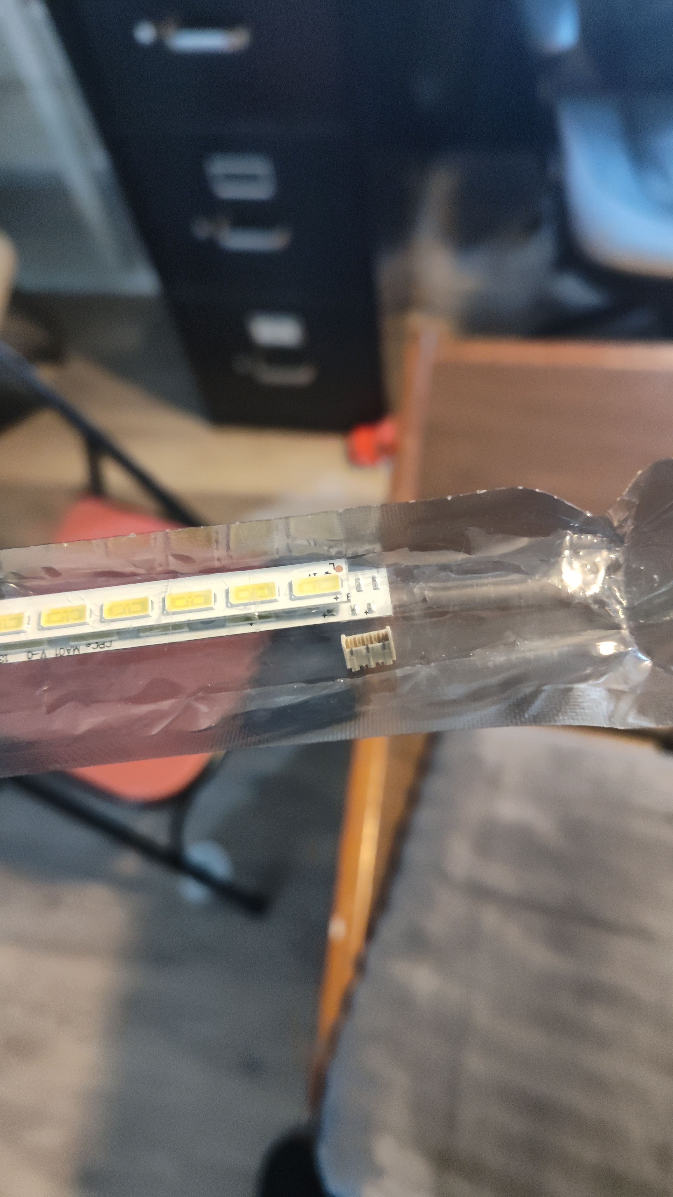

                      Okay guys sorry for the wait...
                      The seller I bought the first set of strips from tried to send me replacements but they got lost during shipping.
                      I got a refund and bought another pair, but one of the plugins came disconnected from the LED strip during packaging I assume. Click image for larger version
                      I really don't want to go through another waiting period of sending these back and getting new ones replaced and I don't want to spend money on anymore.
                      Couldn't I just solder it back on ? If so, what kind of soldering gun kit could I buy from Amazon to do it with ?

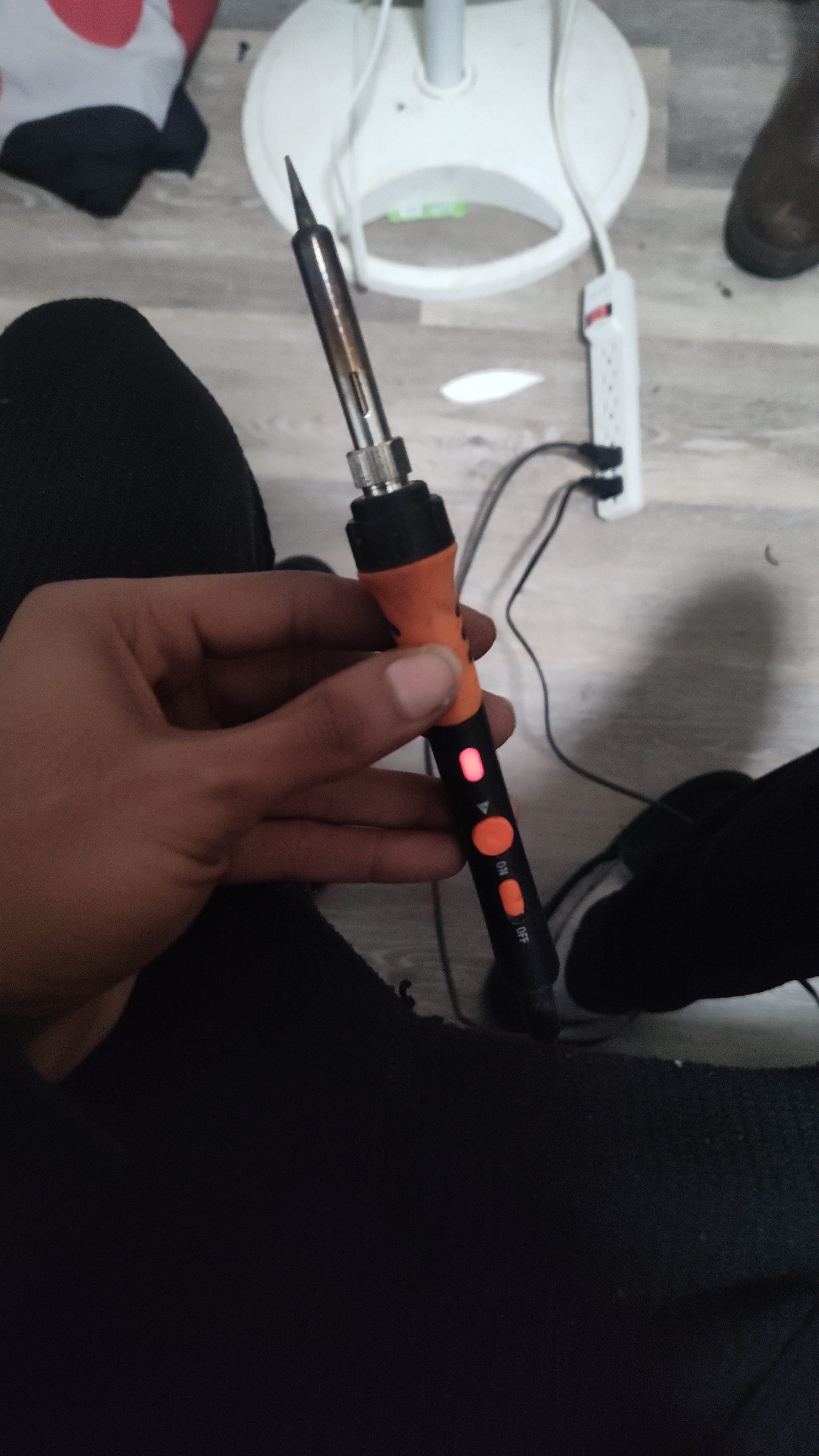

                        Ok, I have a solder gun but I need solder wire. Click image for larger version
                        Is there a specific size of wire I need ?
                        Will I need flux ?

                          #72
                          Yes of course flux. And small electronic solder wire. Small size as it's a tiny pad. This doesn't look like it's going to be easy.. since there is 5 pads and honestly I would of sent them back. If your are new to solder the chances of this pulling through is going to be very small.

                            #73
                            This connector still needs to be soldered correctly; if it is turned 180* degrees, the backlight will not work.

                              #74
                              I got a refund and bought another pair, but one of the plugins came disconnected from the LED strip during packaging I assume. Click image for larger version  Name:	IMG_20241231_101738482.jpg Views:	19 Size:	2.63 MB ID:	3538720
                              Orientation shouldn't be a problem if you compare it to the original strip you took out. As for soldering it back on it looks entirely plastic so I don't think it CAN be. What is more likely is that it is glued on. I would plug the wire into the connector like it's supposed to be and then try to carefully push the connector onto the pins of the strip if you can line them up properly. If it slips back on flush, leave it in place and connect the probes of your LED tester to the WIRES coming out of the back of the plug. If it lights up the strip then you'll know it's on correctly and makes good contact. At that point you can super glue/hot glue the connector in place.
                              Edit: your picture doesn't really represent the situation clearly, so perhaps I'm not seeing it correctly. If those are in fact solder pads then soldering it would be quite tricky. Perhaps gluing it in place will make enough contact. You really should take this up with the seller tho. I've bought two different sets of edge lighting with these style connectors and neither one came damaged or pulled off. I'll bet it was the same seller under a different name. The Chinese sellers are good for that.
