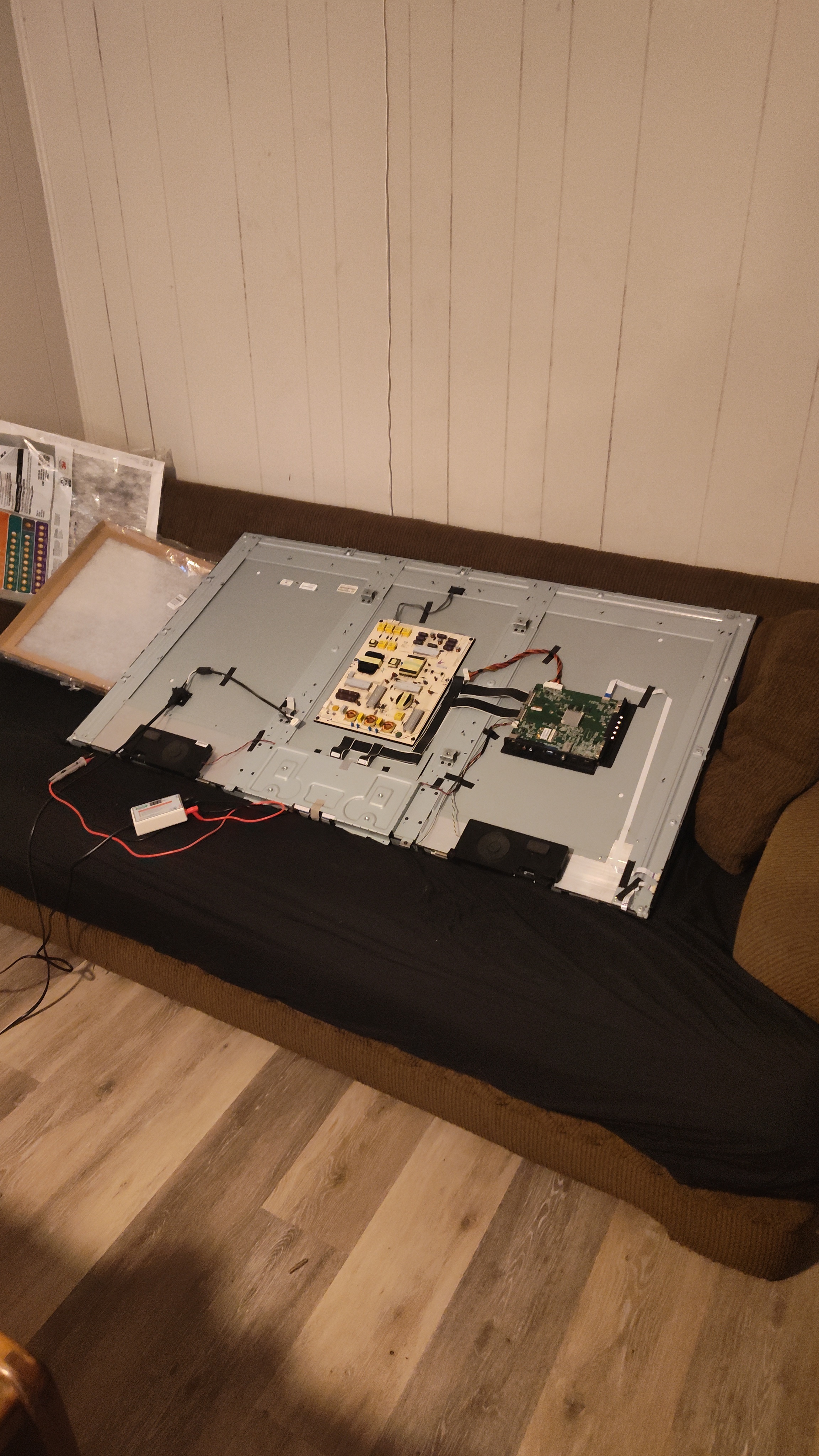

        #43
        Originally posted by EazyBone
        You flip the connector over put a piece of tape on it so it doesn't move and probr the small connection. It's not about the PSU plugged in, it's about you supplying power to the PSU when you shouldn't through the tester itself. Anyway, glad you got a breakdown video for this
        Understood. I'm learning here, I didn't want to lean on the TV to get to the LED connector.
        The TV is propped up on my office couch, making it hard to get to the connectors without having to lean on the TV. Click image for larger version

          #44
          It would be better if the screen was laying flat on the couch and not leaning factually. Make sure you don't put the screen down on something dirty. If you do it'll pickup hair and dust and when you put it back on all that will be seen behind the screen. Lay and equivalent clean size of cardboard to lay the screen down on right when you are about change it out.

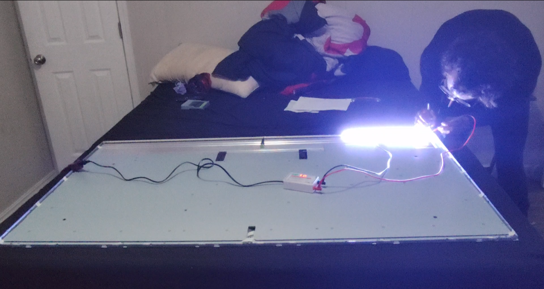

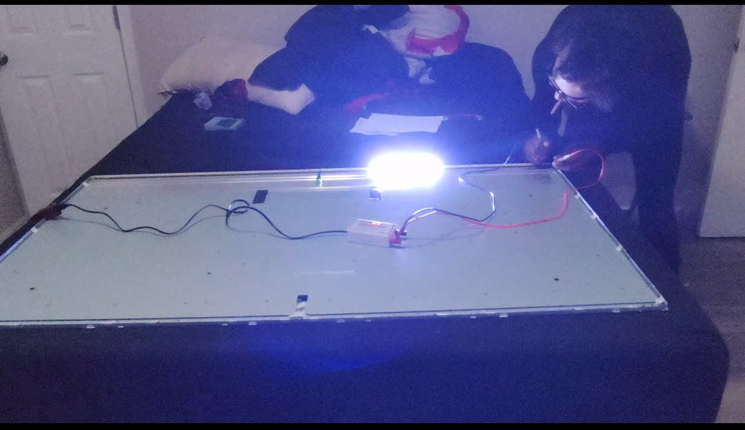

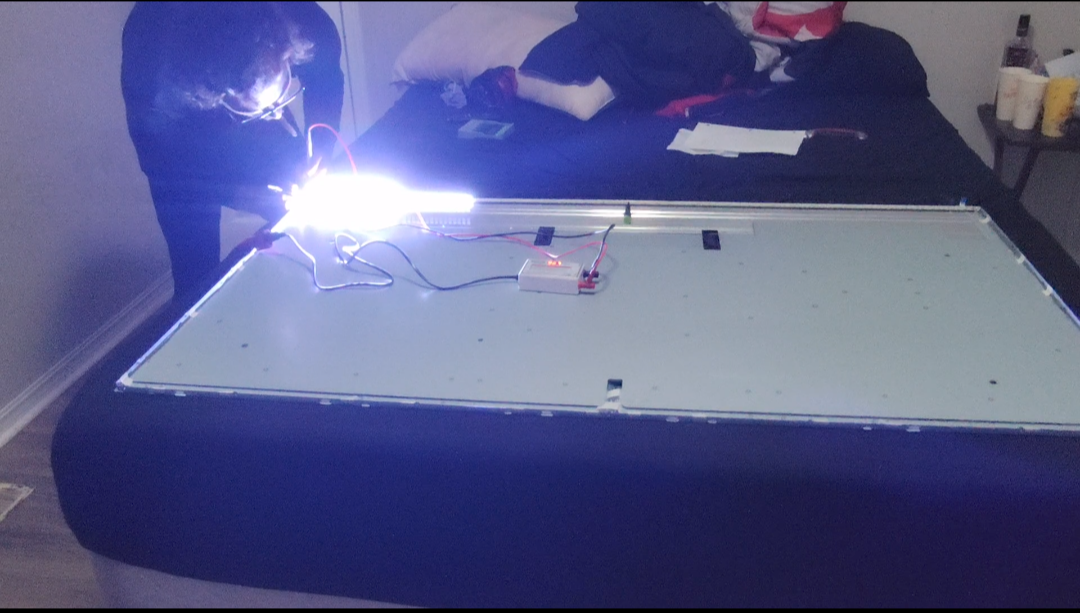

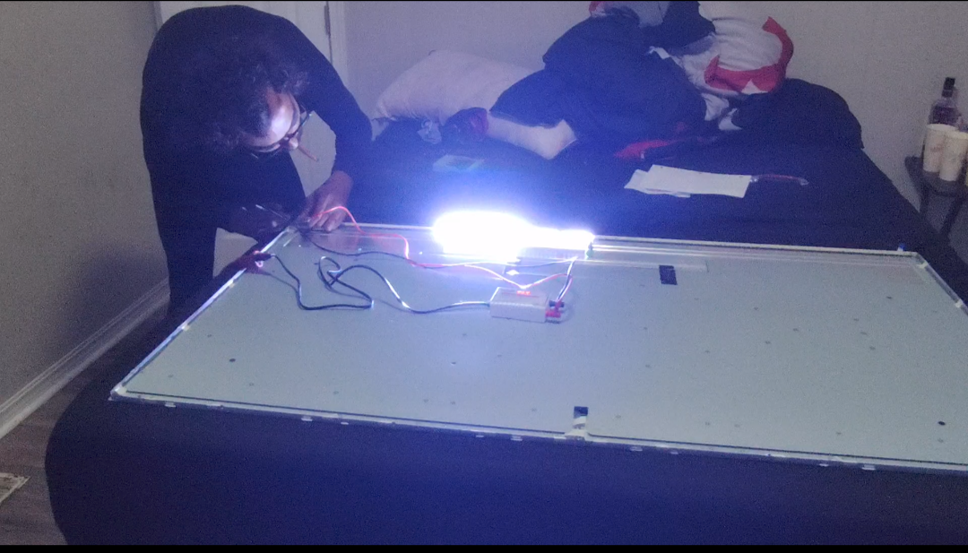

                #47
                New LED strips scheduled for delivery tomorrow. I managed to tear down the TV and test and remove the two LED strips in it. Some work, some are dim and some don't work at all...

                The problem I'm having is definitely being caused by the bad LED strips.

                  #48
                  I didn't realize this was an edge lit tv. Because of this you're going to need to be extra diligent when putting the thick plastic diffuser back in place. It has to sit PERFECTLY in order to evenly distribute the light, otherwise you'll have very bright areas and dark areas. Make sure light is spread evenly before placing the panel back in, and also after. You don't need the panel connected, just in place. Plug the main board into the power supply and plug the power cord in. If it doesn't turn on by itself, press the power button and it should turn on even with the panel disconnected.
                  I just replaced edge lights on an LG a month ago and found that every tiny LED has its own little soft light diffuser gently placed over it. I actually knocked several of them off while trying to get the plastic sheet back in place. Needless to say those tiny things are necessary and change the color of the light from blue to white. It was very challenging getting them back on the LEDs but I did manage and the end result was satisfying. My recommendation, if yours has them too (they look like tiny rubber rectangles), DON'T knock them off.

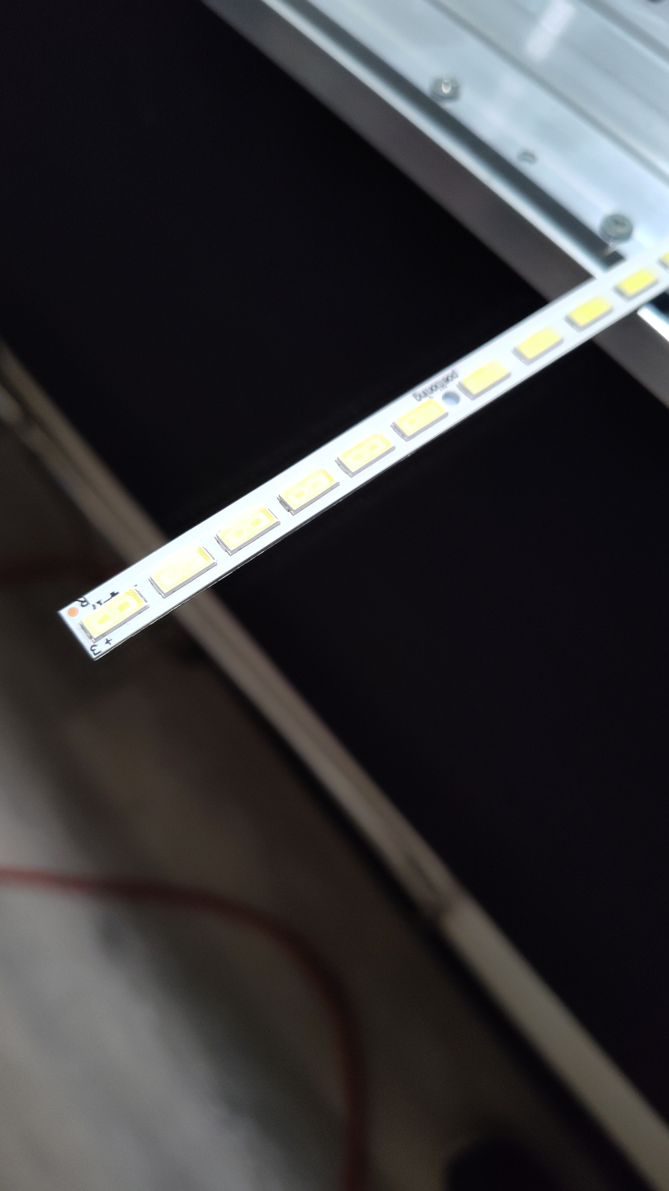

                    #49

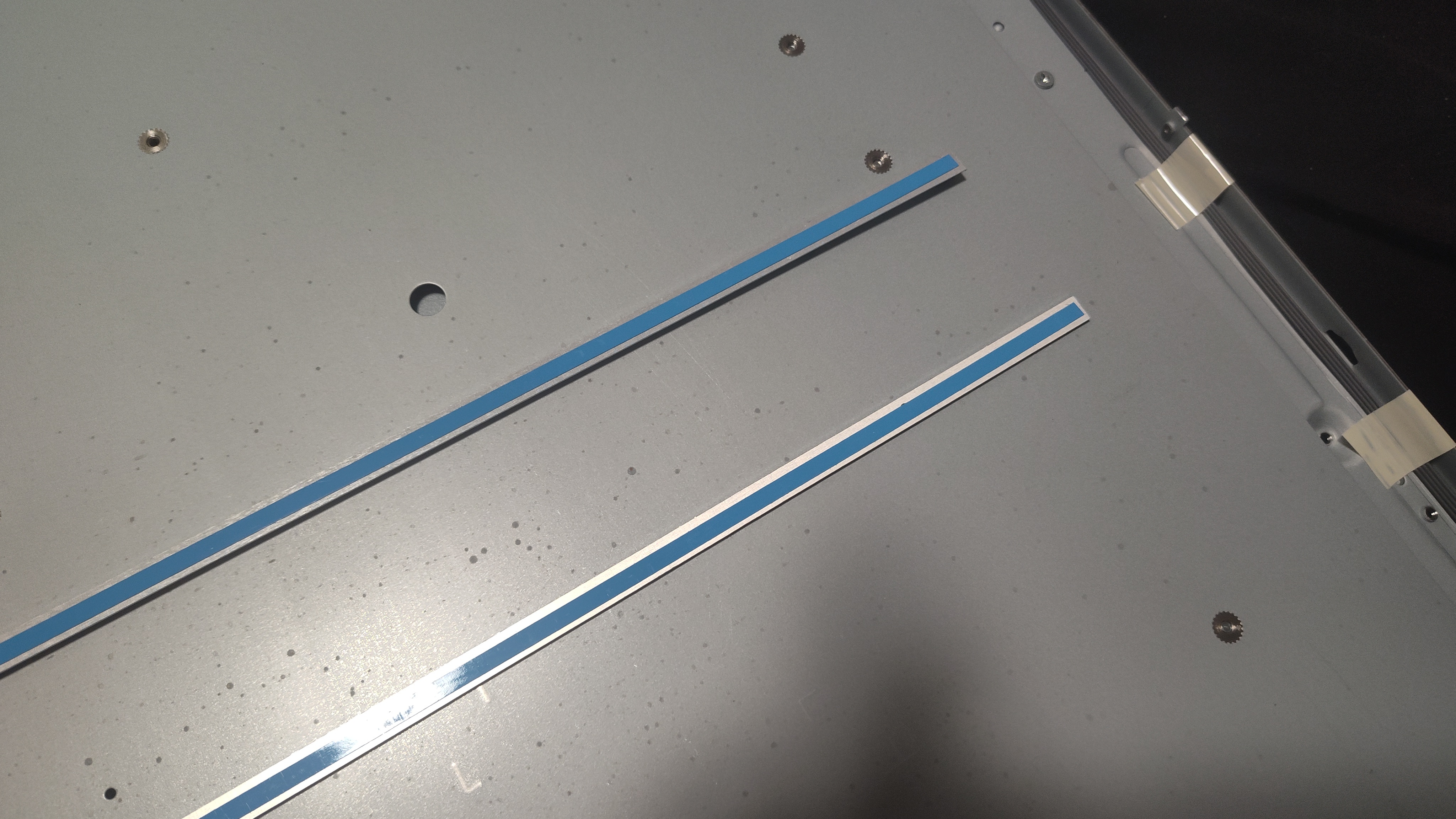

                    The new LED strips came in today.
                    Here's what the bulb looks like and they seem to have tape or adhesive on them as well.
ID:	3521616 Click image for larger version
                      • Nov 2024
                      • 54
                      #50
                      Rebuild begins.
                        • Nov 2024
                        • 54
                        #51
                        OK I have everything put back together.
                        Before putting the back cover on, I wanted to plug it up and turn it on to see the new LED strips light up with them connected to the power board.
                        At first I forgot to reconnect the ribbon cables at the t-con board that connect to the main board, but the lights powered on when I powered on the TV and stayed on for about 5-10 seconds then shut off.
                        I reconnected the ribbon cables to the t-con board thinking that was the problem, but that wasn't it either.
                        I haven't been able to get the LEDs to power on again after that.
                        I still put everything back together, then flipped the TV other and used a flashlight on the panel and could see the display. Seen it well enough to navigate the settings menu, factory reset it, and set it back up for home use. But no power from the LEDs...
                        Back to the troubleshooting board...what should I be testing from here and how do I go about doing it ?
                        • EazyBone
                          • Jun 2023
                          • 1356
                          • United states
                          #52
                          Start from the beginning. Use led testers on the disconnected clip again and measure all the voltages
