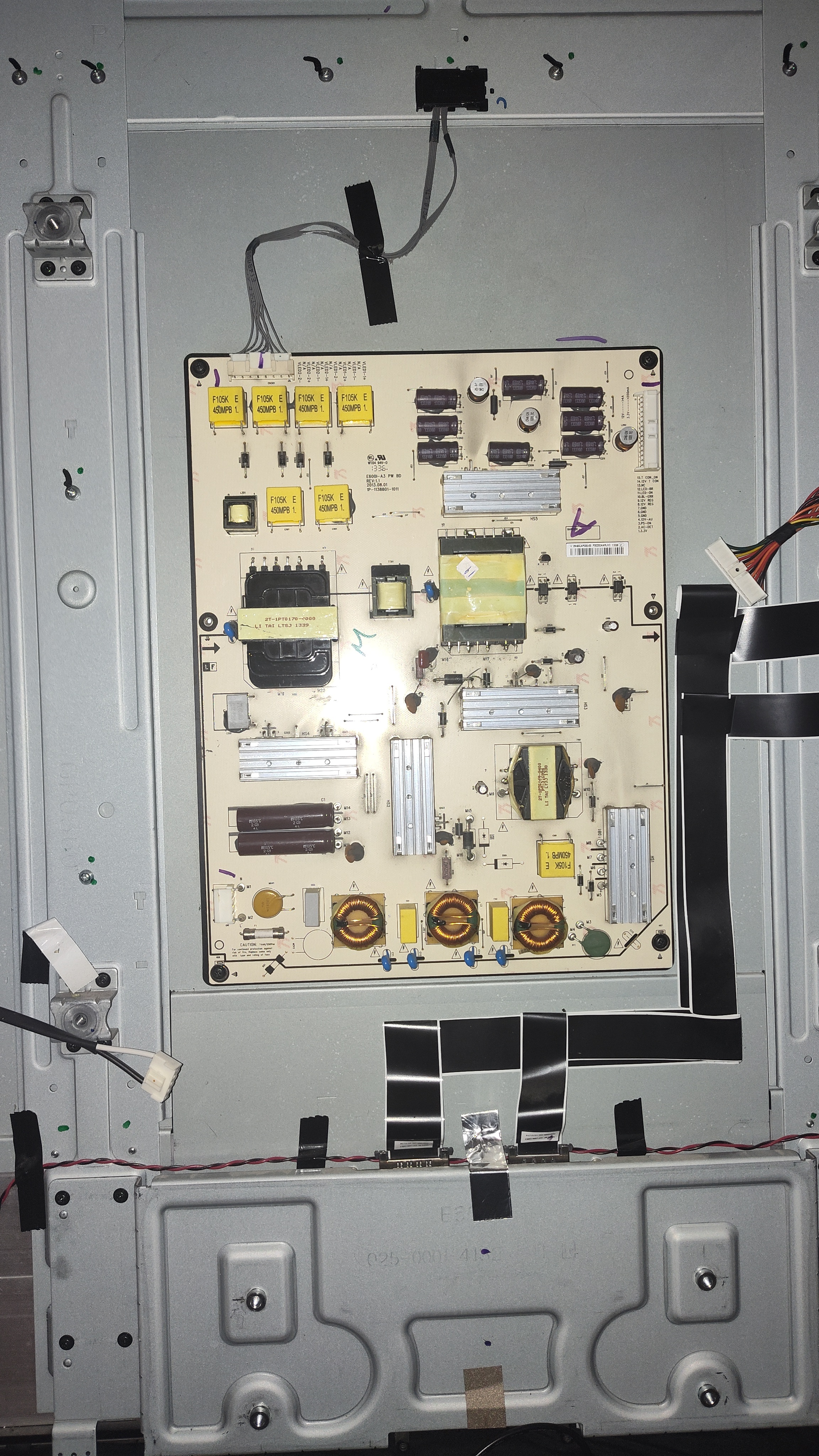

                            Here are the LED strip test results, LED connecter connected to the replacement Power Board, and TV plugged into the wall...
                            VLED1 1+ and 1- : 96.4
                            VLED1 2+ and 2- : 96.4
                            VLED2 1+ and 1- : 129
                            VLED2 2+ and 2- : 93.2
                            The 129 didn't light up, but the LED strips from the other test points did light up.
                            • EazyBone
                              • Jun 2023
                              • 1356
                              • United states
                              #34
                              I said on a earlier post. Test them not connected to the PSU.. it's bad for the PSU. Do the test again on the clip only not connected. BUT it's likely you'd get the same results.
                              Vled 2 93.2 has one led out likely..
                              Vled 129 probably has multiple.
                              Do the test again not connected but it's pretty solid indicator so far

                                        Correction. I had the LED connector connected to the power board, but the power board wasn't plugged into the AC cord that powers the TV from the wall outlet.
                                        See in this picture how the AC cable and Main Board are disconnected from the PSU ? Click image for larger version
                                        Only the LED connector is connected to the PSU.
                                        It just made it more easier to do the test then to pin things at the LED wired connector.
                                        Like you said, I'd more than likely get the same results if I pin them at the wired connection. That wasn't any other power being sourced to the LED strips other than the LED tester.
