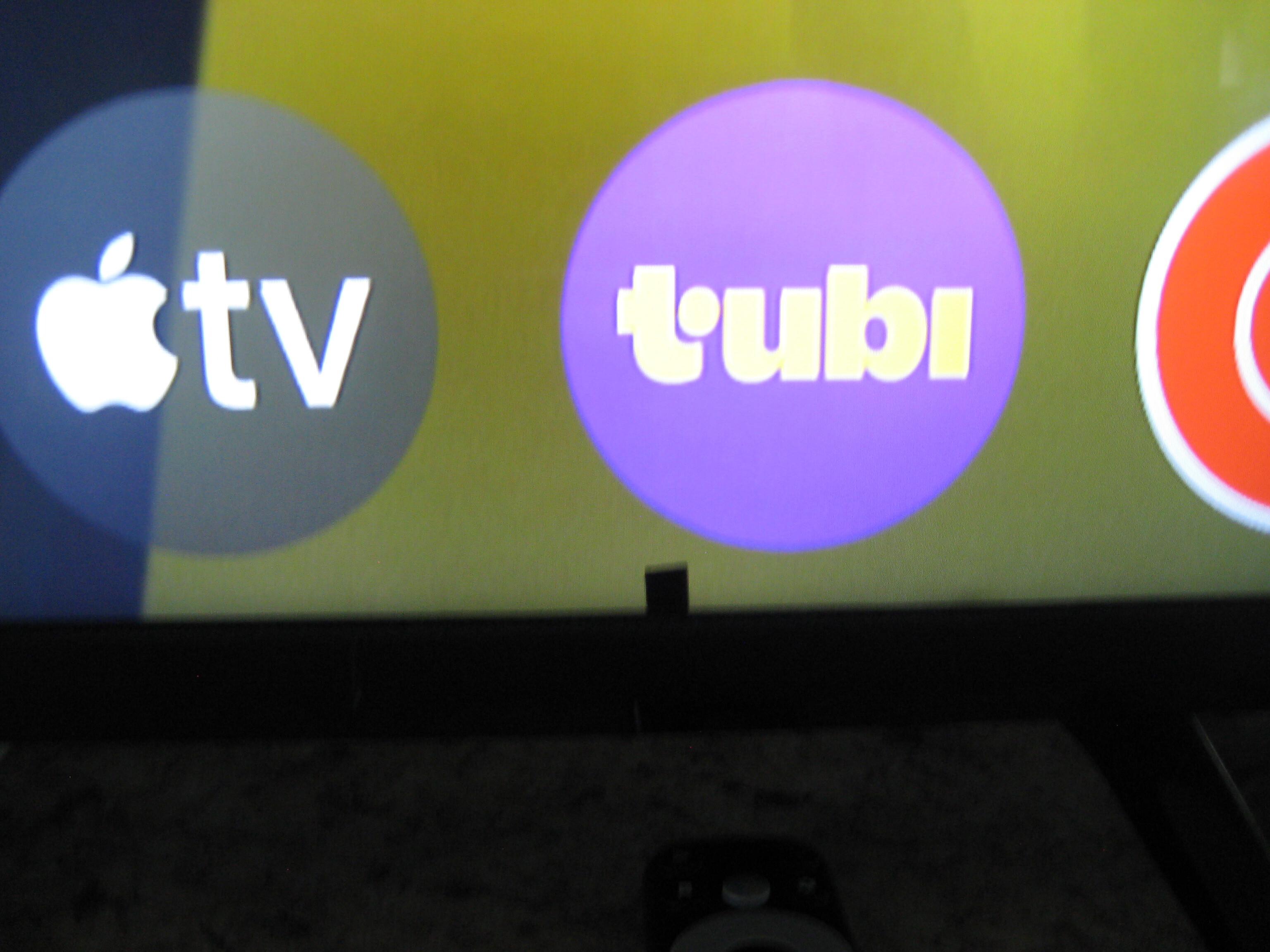

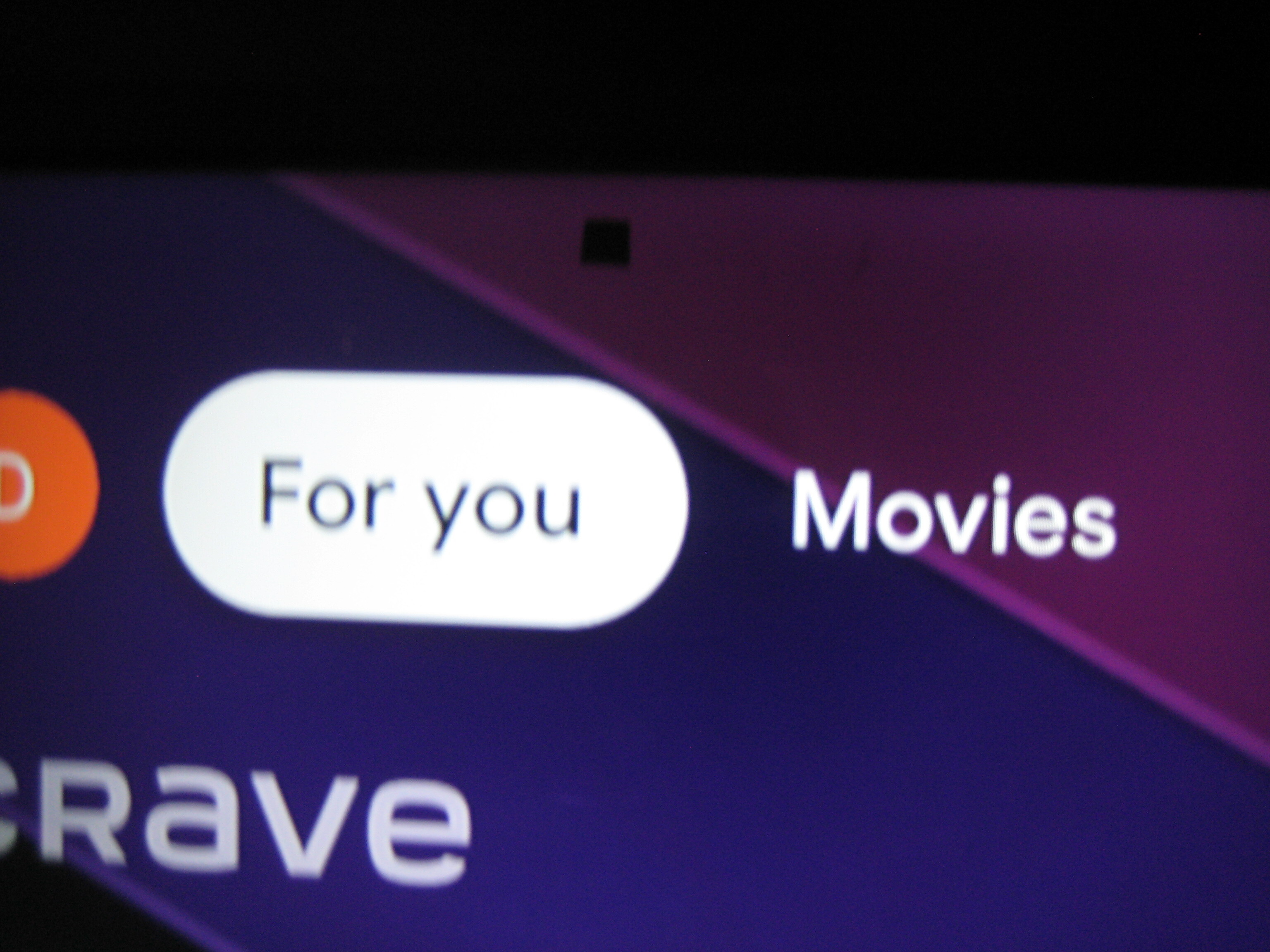

                              So I finally got around to 3 of these TCL 43S446-CA tv's I had picked up for free over the past year. People were dumping them. Seems these models all have cheap power supply problems with diodes. After wasting 20 bucks on a Power Supply: 08-L12CLJ1-PW200AA that was sent to me and was garbage I saw a video on youtube that was similar ... showing the bad diodes beside the backlight plug that were likely the problem. Like handsworth said all it is is the power supplies. I bought 20 SB540 diodes for 4.00 and replaced 1 SB540 diode on all 3 power supplies and now all 3 tv's work lol
                              One of the tv screens has an issue though ... does not look like burnt pixels but more like bad integrated t-con on mainboard or maybe bad screen? Anyone have any thoughts before I tinker with it? You can see near top left a square black block, and near bottom right same thing a black block. The rest of the screen is ok. I've tried to add the best pics I could of the screen on. Any tips appreciated Thanks all

                                Looks to me like it's some garbage under screen

                                  Agree, looks like a piece of paper or tape for in-between the screen and the light diffuser.

                                    Ya thanks tiki, eazy ..is weird why someone watched this tv with 2 black squares on the screen lol ... It seems there is some tape or something behind the screen .. even though I can tell the tv has never been taken apart. A lot of these 2020 to 2023 tv's are all COVID tv's so probly built as garbage and some sucker bought it from Costco, Best Scam Buy, WalFart, Amazon Prime Crap deal etc on sale. So guess my next step is to pop the screen off and see what is actually behind it. I will report back soon with the results.

                                      So 3 months later I finally got around to pulling the screen of the TCL 43 inch with the 2 black spots. Turns out was my fault lol. I have never touched these small cheap brittle plastic models before and when I had the bezel off and the screen lifted out to check the led strip ... two tiny plastic square clips from the bezel had fallen in behind the screen onto the diffuser. There was enough of a static charge in the plastic that they just hung on to the plastic diffuser sheeting. I took them out and now is perfect picture and thank god was not dead pixels in the panel. Gee my dumb arse is learning the hard way lol
