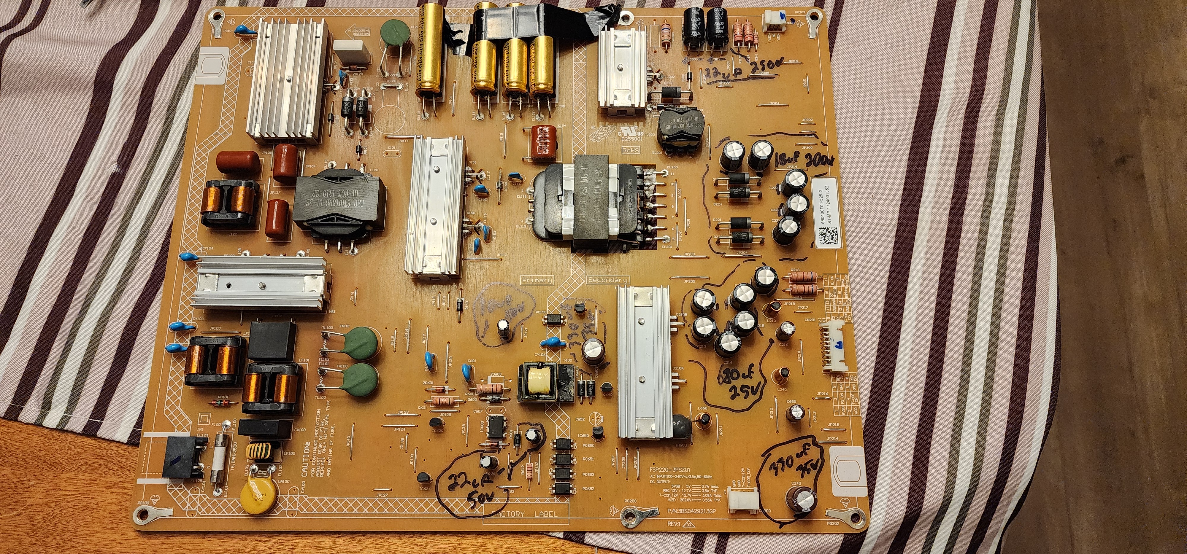

    First of all, thank you everyone who helps others in here! You guys are treasures! Please bear with me, this may be long. I have tried a LOT.
    First, my wife said the TV was turning off and on. When cold it would be fine for several minutes, then it would start resetting.
    I opened it up and noted there are two main lines coming out of the supply besides the backlight., The T-Con 12V line and the main 12V line.
    TRIED 1 - I scoped power coming from Power Supply while it was all still connected. I noted that just before it reset, the 12V line going to the T-Con was going unstable and oscillating badly.
    TRIED 2 - This resetting stuff happened to me before on a Sammy, and recapping the power supply fixed it. So I recapped whole power supply, aside from the 4 long gold ones laying down on the top of the board. I did test them out of circuit, and they came out great. Unfortunately, so did all the old ones I took out.. Problem remained, however the oscillation I saw on the scope seemed to go away. (Now I am second guessing whether I tried AC coupling it at this point and zooming in enough to see it...)
    TRIED 3 - I unplugged the T-Con power cable, no change. I unplugged the backlight connector, no change.
    TRIED 4 - I'm proud of this one... I intercepted the T-Com power lines from the power supply, and fed 12V into it from my bench supply. I interrupted all the T-Con lines on both connectors and connected them all to my supply. (They all had continuity on the power supply board anyhow.) Things got no better! Things got no worse either. All the other conductors were connected still.
    TRIED 5 - I remelted all the solder points on the power supply board with flux and a touch of leaded solder on the bigger ones. No change.
    Note: After I reproduced the problem lots of times while doing all this, I noticed that it would run less and less time when started cold.
    TRIED 6 - Freeze spray! Long story short, I hit all three boards HARD in the end, and.. nothing changed!
    TRIED 7 - I checked the current on the T-Con board, and the backlight. The T-Con was pulling 600 mA, and the backlight was at 400 mA. I don't know if these numbers are right.
    So... I'm kind of at a loss right now. So if there are any geniuses in here, willing to help, Thank you in advance!

    No genius at all but I'll try to help, are the expected voltages coming from powerboard, should be a label/legend nearby. Can you post some good clear pictures of each board and one of the whole back as to see how everything is connected. When you say recapped all, do you mean ALL or just the electrolytics?

      You probably already checked all the resistors, diodes and transistors on top of the board.

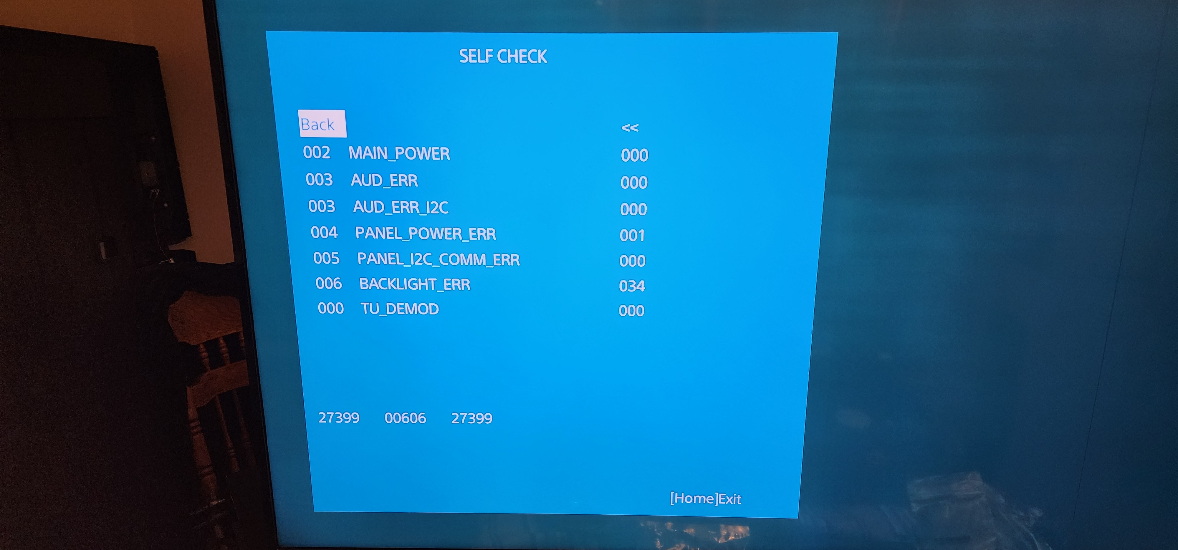

          It will turn on for a few minutes when sitting correct? If this is the case.. Open the service menu and look and see what error is potentially tripping in the service menu. Get your camera ready to take a picture of it right when you get to it so that it doesn't shut off on you. This may give a clue.
          And I agree Sony's are tough.. I would guess the back lights or the main board. If you have an LED tester not a bench supply then I would test them out of circuit with the power supply.

            Easybone.. I attached the diagnostics screen. Is the backlight power derived from the T-Con 12V line? That might give me a connection between the wonky T-Con voltage I saw on the scope and this backlight error... I need to re-scope that voltage line to make sure maybe.
            Note also - I have tried unplugging the T-Con AND Backlight connectors. Nothing changed, but unplugging those might cause the same error!! (Hmmm... It would happen immediately though. I haven't tried when it was cold...!) That might have caused some more errors on the service screen, but I know there was only one before, and it will certainly be the highest number of occurrence's!

                        Before we get too far into the weeds with this TV, Does the TV reboot completely? or does the TV continue to operate WITH SOUND but a black screen?
                        And please be clear: When your TV stops working properly, is the screen black and completely without backlights? or is the screen black with no image but backlights are actually on? Your original post does not say.
                        The fact that you posted a screenshot of the self-check screen indicates your problem may not be a backlight. This may be a mainboard problem where TV mainboard works until it craps out.
                        If TV still plays sound from a video input or an app like Netflix while watching it, then I suspect a backlight LED or backlight power issue. Otherwise, if you have black screen and sound, can you verify with bright flashlight or lamp if you still have an image on screen just no backlight?

                          Hi, by the first post i trend for a bad bga on main.board, but after the test of the panel, if nothing happens and no WBRGB test shows, i don't know, not the 100% of the panels supports this type of test, the more noise is probably a light loaded psb due to panel off, tcon half on, so not clear.. but if when it shuts off it doesn't blinks a 5 code error then 100% bad bga on MB
