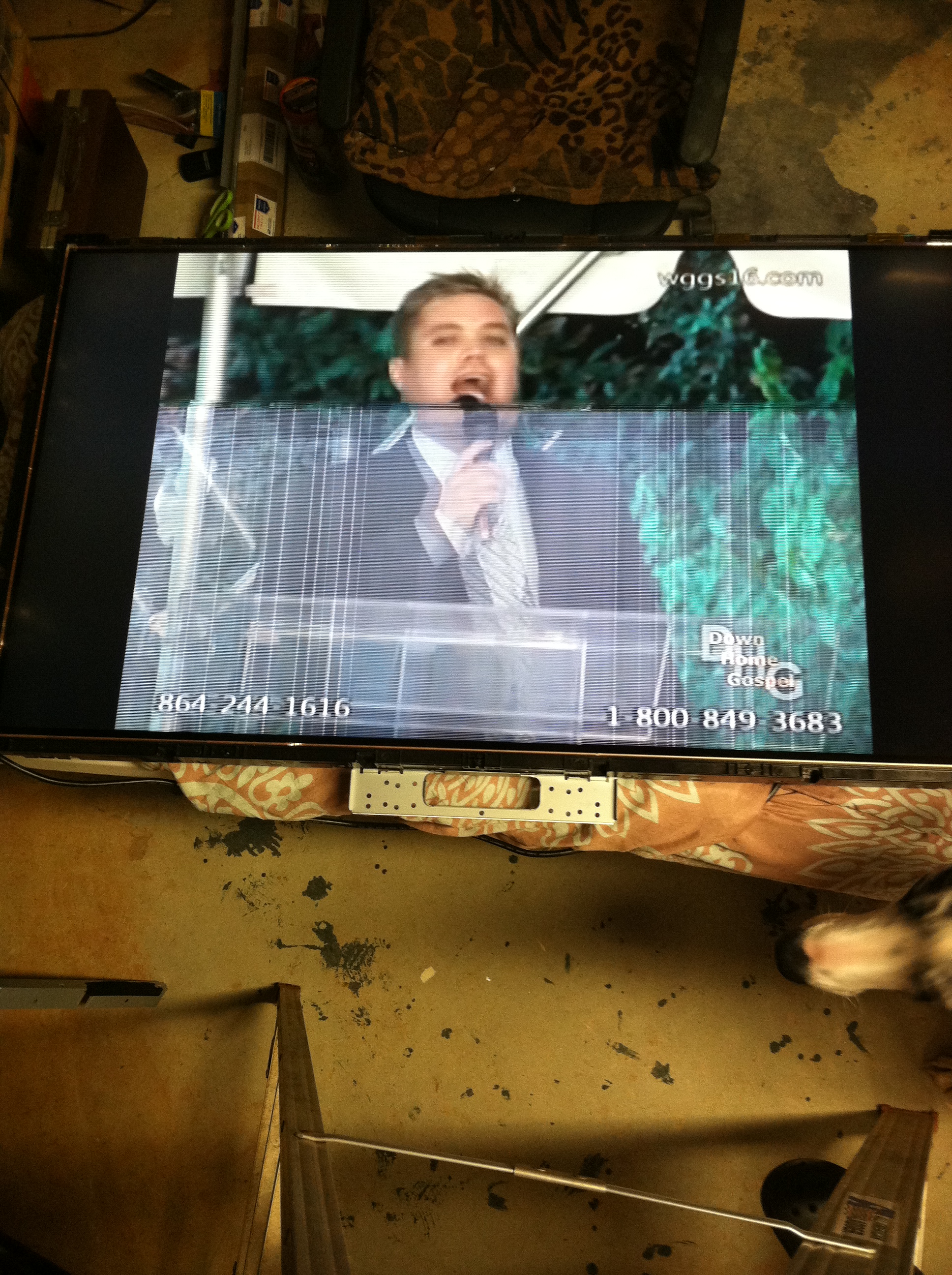

                Finally got the backlight working by replacing one of the bad backlight lamps. Now it does not shut down but I have a new problem. In the attached photo you will see all these lines in the screen that was not their before.. Any ideas what would cause this???
                • Agent24
                  I see dead caps
                  • Oct 2007
                  • 4951
                  • New Zealand
                  Re: Vizio E470VL backlight circuit sensitivity
                  Check the signal cables to the panel are connected properly.
                  It's also possible you damaged the panel or drivers when replacing the backlights. Unfortunately if this has happened it is not fixable.
                    Unfortunately when I was moving the LCD Panel as I was setting it down I chipped a very small nick in the corner . Will have to put this one aside until I can find a new panel.
