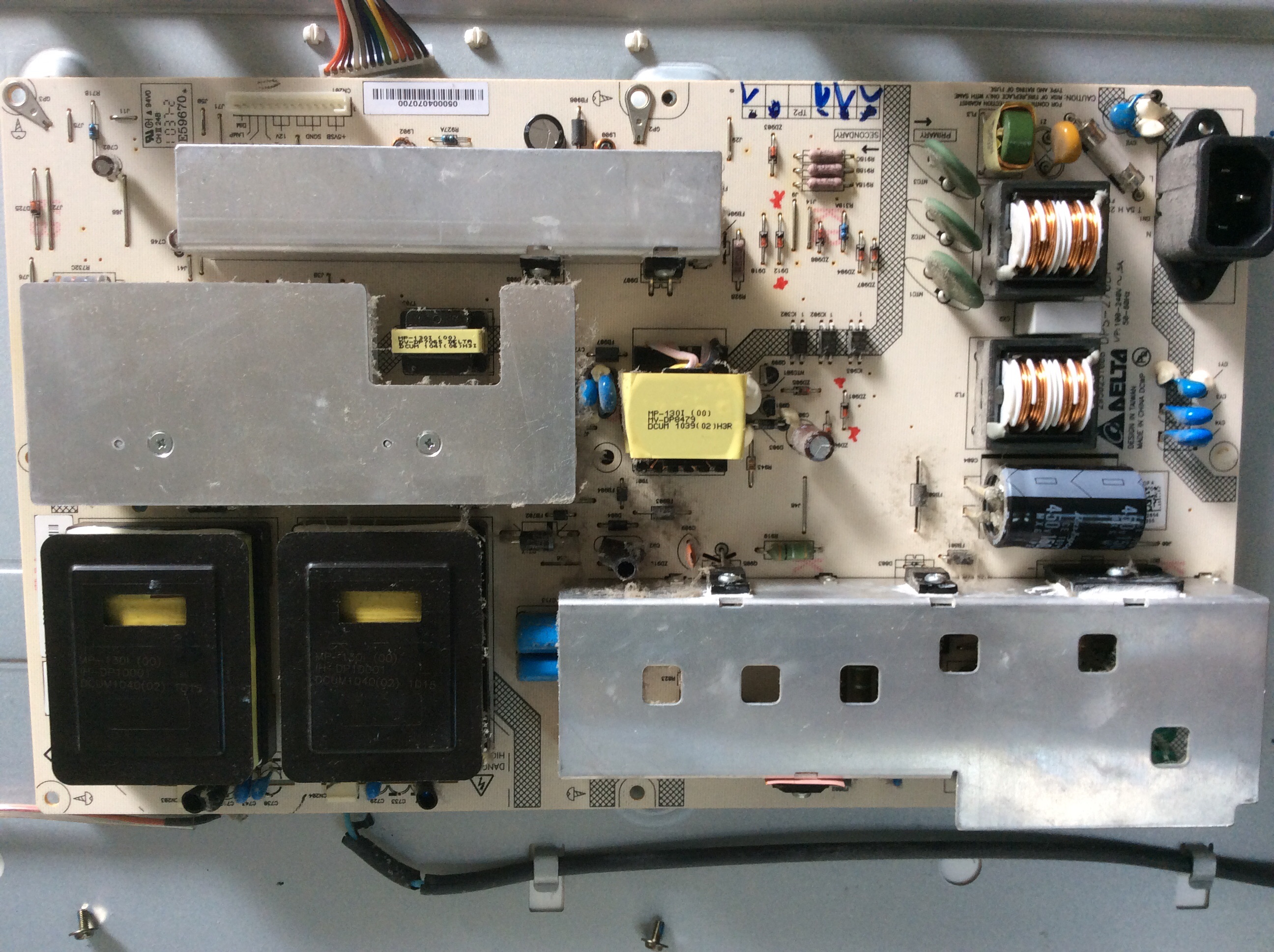

    EDITED: I thought my Vizio E470VL has +5VSB and no 12v on the PS board, but after plugging the cable back in and testing the pins on the Main board I realized that I do have 12V. I assume the 12V is turned on when the ON/OFF switch is pressed. The Vizio light in front does go from Standby Orange to White when ON. But, I still have no picture or sound. Test values of PS board are below.
    +5VSB= +5.09
    12V= +12.18
    PS_ON= +2.25
    I_ON/OFF= +3.27
    LAMP= +3.18
    DIM= +2.97
    Any more testing I can do on Main board or is it just a replacement?

              • neilc6
                • Nov 2015
                • 1550
                Re: Vizio E470VL got +5VSB, but no 12V
                You should include a picture of the entire back of the TV. Your model is an old LCD with CCFL backlighting and likely has a tcon hidden under a shield. A quick Google of your model shows a YouTube video from a guy that repaired his TV by cleaning the dust off his boards. I would also check the electrolytic caps on the power supply for bulging since they are common failures in LCD TVs.

                  • Bugman1400
                    • Sep 2022
                    • 10
                    • US
                    Followed Neil’s advice and decided to clean the board. I also decided to check the TV with the room lights dimmed and discovered that the CCFL backlight and menu screen come on when the ON/OFF is initially pressed ON. Sometimes it will last up to 15 seconds before it shuts off, but it seems to come alive every time. So, I think the CCFL is good and I think the Main board is good, but now my LAMP signal is at or near 0V. Before, it was reading +3.18V.
                    I wonder if I can disconnect the cable between the PS board and the Main board and just apply 3.2V to the LAMP pin of the PS board to see if the CCFL stays on. Which board supplies this signal?
                    What role does the DIM pin play on a CCFL TV? Which board supplies this signal?

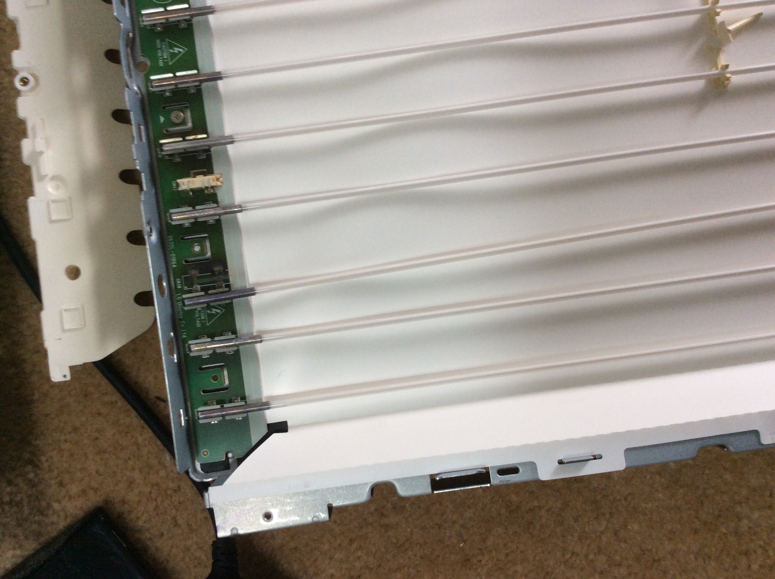

                      UPDATE: I bought a new PS board and replaced the old one only to find that the TV still had the same issue. After trying the flashlight test again, I discovered that I do see a menu screen in the background. So, assuming that both the PS board and the Main board are good, that leaves a defective CCFL. Anyway to fix a bad CCFL?

                        • R_J
                          • Jun 2012
                          • 9535
                          You likely either have a bad ccfl or there is a problem on the connections on the distribution board inside the panel.
                            Bingo!
                            It took a bit of coaxing to separate the LCD from the backlights, but the damage is obvious. Not sure if I can just re-solder or need to replace the boards. Haven’t tested the CCFL tubes yet. Can the CCFLs be replaced? I checked out CCFLWarehouse.com, but all their CCFL replacements seem to have ends that require soldering.

                            • Bugman1400
                              • Sep 2022
                              • 10
                              • US
                              Looks like all the clips that hold the ccfls are too brittle and trash. Any place that sells these things?

                                • Bugman1400
                                  • Sep 2022
                                  • 10
                                  • US
                                  Originally posted by ajshoe
                                  best bet would be a tv recycler or Craigslist - might get lucky and find vizio ccfl set there. Id scrapped that set and go for a led or plasma 1080P set to repair.
                                  Too late for that now. More interested is completing the challenge. Think I got everything I need to complete the repair except the standoffs to hold the diffuser up.
