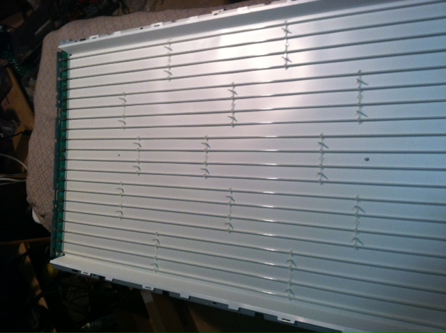

    I have been working on an Vizio E470VL for months and it is driving me crazy that I can't fix it. I plays for just a few minutes (5 at the most) then the back light shuts down. Every time I loose the lamp voltage going to the PS board. I have replace the power supply board and also have replaced the main board THREE times and still having the same problem. Last night I went as far as to tear the whole thing down and remove the LCD screen and examined the Backlight lamps and associated wiring looking for arc spots. I did find one small spot next to the connector on the circuit board that holds the lamps. I cleaned that spot and insulated it thinking it would cure the problem. The spot was very very small about the size of a pin head. I reassembled everything and still have the problem. I found a new set of cables on e-bay that I ordered. This is about the only thing left that has not been replaced. I ohmed out the lamps to gound using a VOM on megohm range and could find no shorts to ground. Is their anyway to make the Lamp feedback circuit less sensitive? Or do you think it could possible be a bad cable? I should get the cables in a couple of days and that will eliminate that problem. I have also just installed a new eprom on the new main board I received just to double eliminate that problem. Anyone else had this problem???

    Is the inverter on the power supply? Can we see some pictures? It sounds like you may have one or more cfls that are taking more amperage than the inverter likes then it shuts them off. Shopjimmy shows about 4 different power boards used in this model. Which does your tv have? If it will turn on with the screen removed you can check for dim bulbs, or ones with black stripes around the end.

              Re: Vizio E470VL backlight circuit sensitivity
              Here is a photo of the backlights...

                  10 tubes - damn that's gotta generate some heat!

                    There are 20 tubes and my VO420E has 18 tubes.

                            i know it looks like 20,
                            i assumed it was using "U" shaped tubes or it would need twice as many invertor outputs.

                                    I took off the LCD screen and the White plastic cover where I could observe all of the lamps real close. I found the problem one of the lamps was starting to flicker just slightly and could only be noticed with the white plastic screen removed. I removed the lamp and that solved the problem of the backlight shutting down. Now to find a replacement lamp. Does anyone know a source where I can buy a single lamp? I would replace all of them but have already spent a ton on this set. I am planning on just replacing the single lamp for now and keep the TV and watch it a while to make sure everything is ok.
