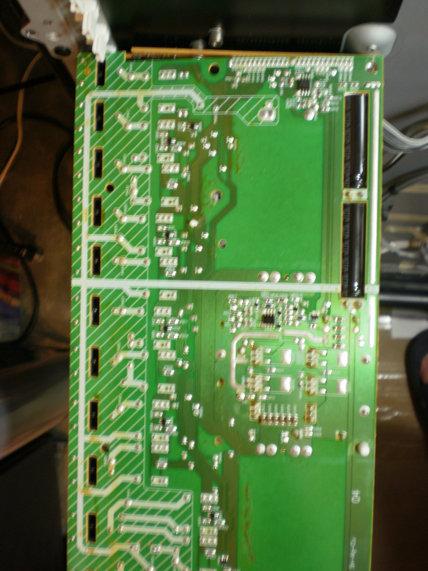

    It doesn't turn on, it just blinks the green LED as I plug it in.
    If I hold Vol+ and Channel- and the I plug it in, after a few seconds, the Input shows up on the screen, just for a second and then the LED stays on.
    I have measured the 12V(-12V) and 60V(-60V) and they are there.

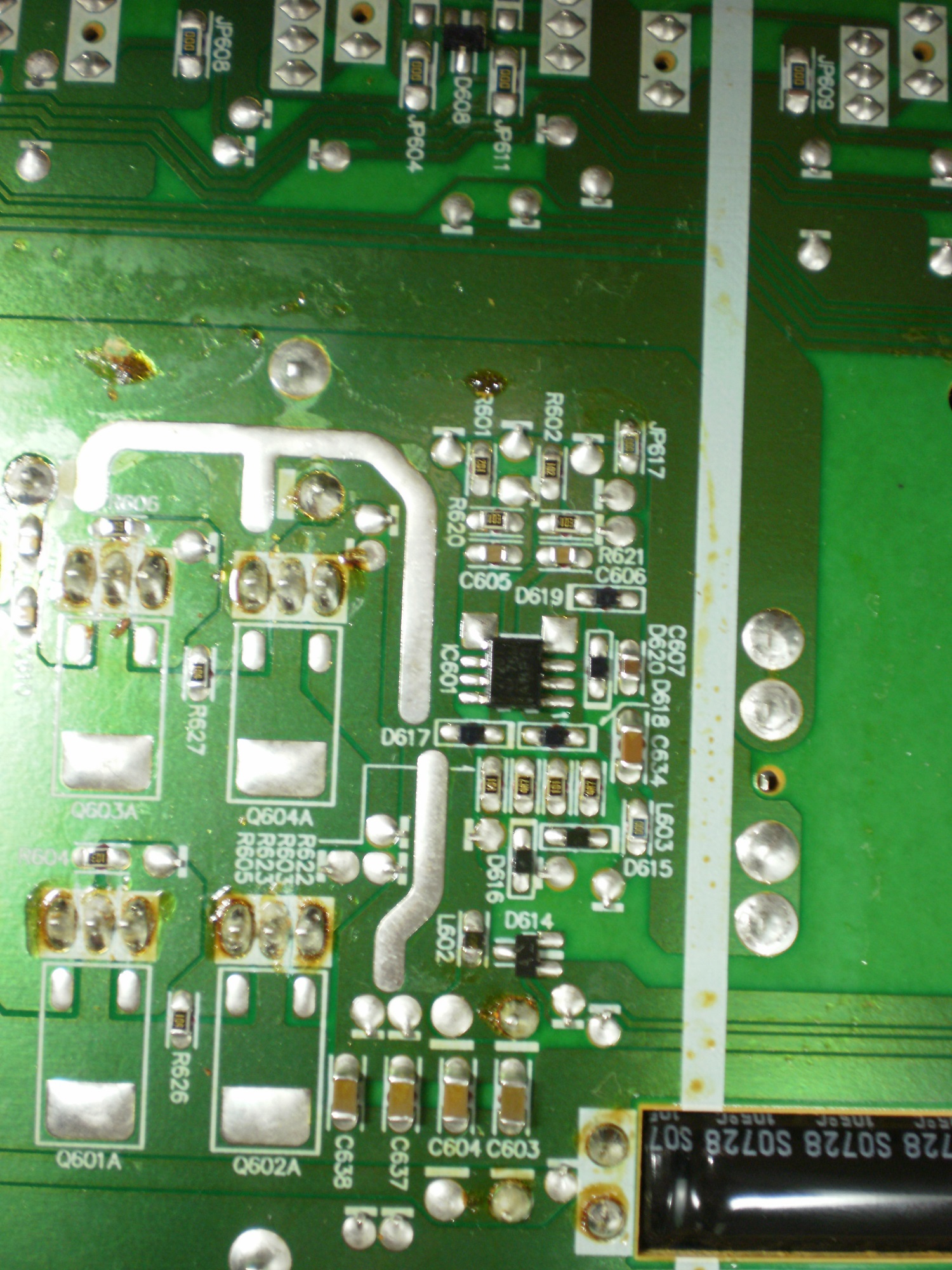

    I have measured four FET at the top inverter and four on the bottom inverter, on both sides of the TV. There are, six inverters in total, three on one side and two on the other.
    There are two more FET looking components, next to the four FETs, but there are no markings on the PCB, so I'm not sure what kind of components are they.
    Two pins seem shorted on all four inverters. So basically at each corner of the TV there are six FET looking components. Four of them are marked with Q which are transistors, but the two next to them are not marked. The case of these transistors are horizontal to the PCB and there is a heatsink on top of them soldered to the board, so the transistor markings are not visible and in the SM, there is no schematic for the inverters.

                            I have tested all the transformers, at the output side and they are also good, 111-116 Ohm.
                            Bud, you know anything about the Transistors under the heatsink?
                            Four out of six seem shorted, but those two may not be transistors, they don't have any markings on the PCB. All six are under the heatsink.
                            Tomorrow, I will take pictures with these.
                              Re: Sharp LC-65D64U blinking green LED
                              I cannot say much until I see the pictures. There are so many inverter boards on this TV, one can be bad that will cause it to get error code, or bad lamps, never work on one like this so I cannot tell.

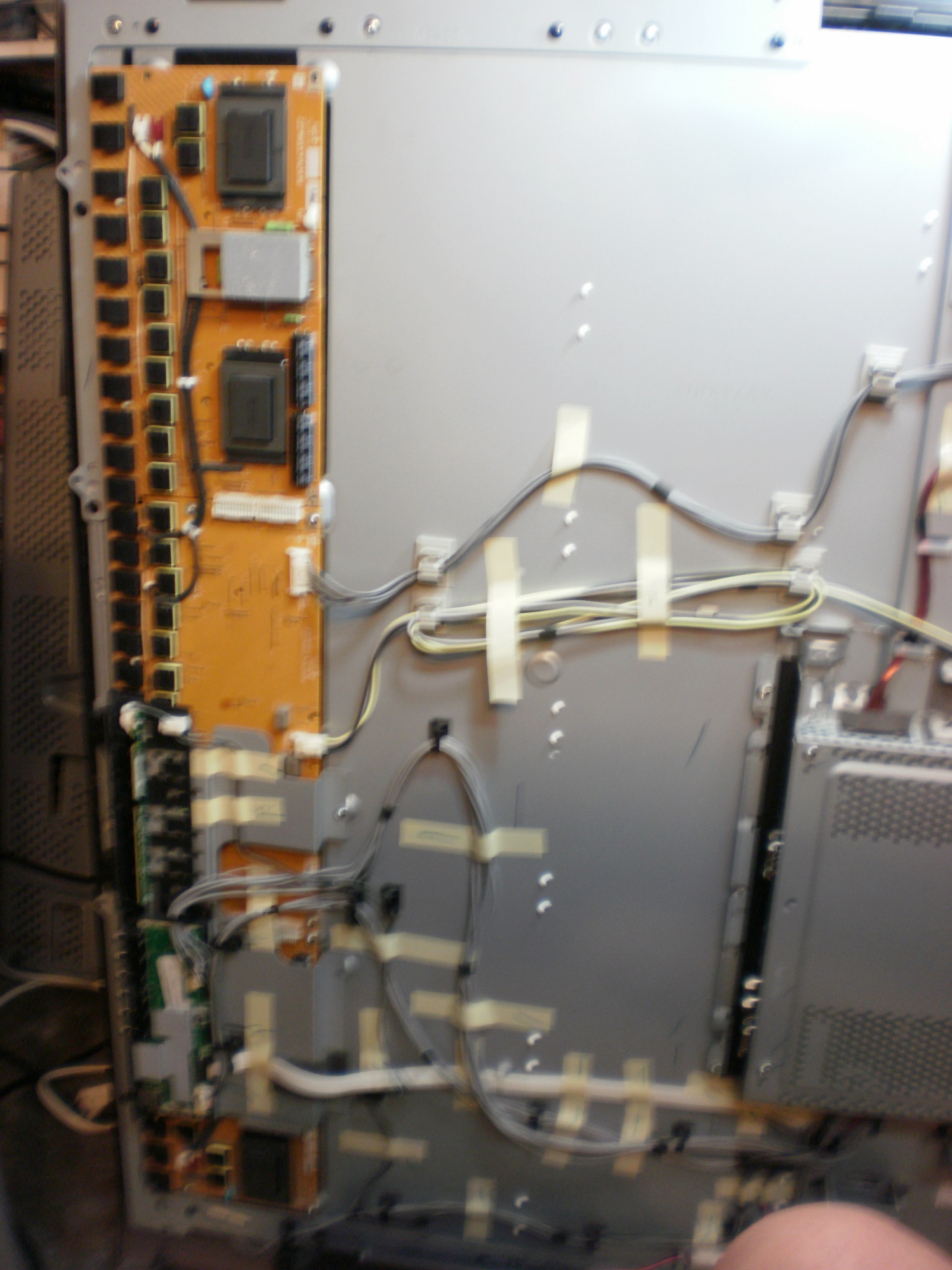

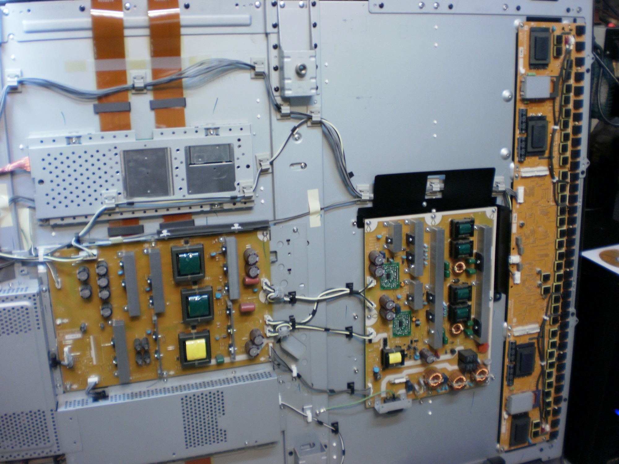

                                Finally I had some time to take the screen apart. It was actually very simple. Screen came off with the metal frame bolted to it, pretty cool.
                                I have managed to take a picture of the CCFL tubes.
                                It's only a blink, so it's hard or almost impossible to see what is going on with the naked eye.
                                In Microsoft Movie Maker I have slowed down the video and at the right time I took a snapshot.
                                I was surprised on what I have seen. I can't explain it what is going on, I have never had this issue before.
                                Any ideas?
                                Far, is left of the screen, near is right, with the switches/ side inputs and LED/sensor board.
                                  It can be misleading to use a single frame like that, the camera can pick up the refresh rate.
                                  However, to me, it looks like only half the bulbs turn on and of them, only half is lit.
                                  This means the slave is probably not working and the master may not be working properly either, however, it's important to note that the master might strobe the bulbs one after another, or only light the other bulbs when the first set have lit.
                                  One common trick is to temporarily disable the error detect on the master so the bulbs will stay on. Then you can power up the set quickly (no more than 10 seconds at a time, watching carefully for parts overheating.) To disable the inverter error detect locate the TIMER pin on the controller chip and bridge the capacitor attached to it.

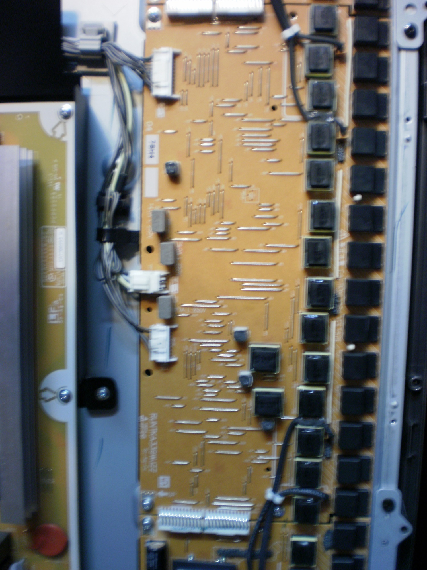

                                      Tom, I can't even tell which one is the master and which one is the slave.
                                      I have made some pictures(most likely not the best), I will upload them a bit later.
                                      It seems, like there is an 8 pin IC 27201.
                                      It could be this one?
                                      http://www.ti.com/product/ucc27201
                                      The side that did not lit up, the inverters are numbered 1, 2, 3. The other side are #4, 5, 6.
                                      #1 & 3 and #4 & 6 have the ICs and transistors on them.

                                        OK, here are some pictures, they are not really for diagnostic purposes, just to have an idea how does the TV look like.
