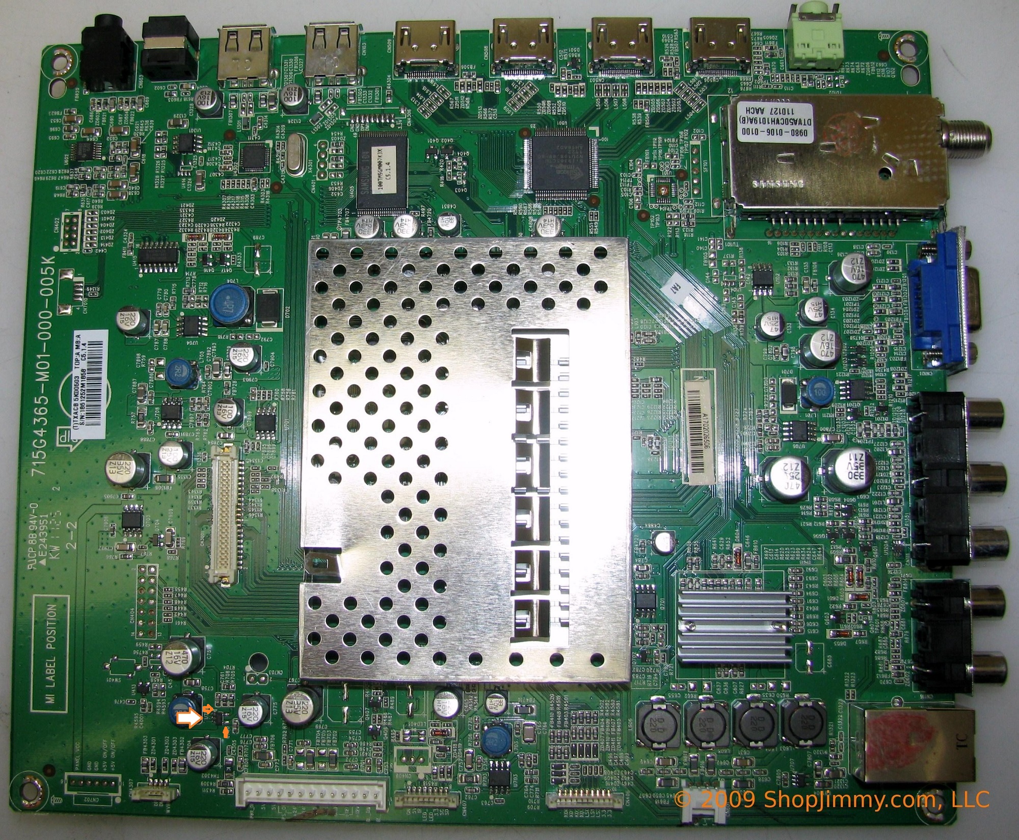

    The previous owner said that they had a storm and right after the storm the TV would not turn on anymore. Most likely a surge.
    I have manged to force the PS on and it's all good there, backlight turns on, all the voltages are there.
    If I lug in the mainboard connector, the standby voltage is pulled down to 2.59V.
    Can I find the problem component on the mainboard, or I should just get a another one?
    A thermal fuse how should show on the meter, mine shows 0.5 ohm.
    Any ideas would be appreciated.
    This would be the mainboard(picture from shopjimmy):
    http://www.shopjimmy.com/media/catal...acb5k00503.jpg

    Re: Vizio E422VA not turning on
    fix it.
    trace the standby voltage and see what it connects to.
    it's probably not much.
      I have found a voltage regulator type of component(three pins on one side and two on the other) and the markings are EKAON.
      I can't find anything about it, on the net.
      Pin #3 and #4 have short, I don't know if it's OK or not though.
          The two pins marked with small orange arrows show 2.59V(short with Ohm meter). They also seem like, input and output pins to me.
          I have replaced a couple days ago a very similar component on a Sony TV which it was a voltage regulator that had a control ON/OFF function as well. It was regulating 5v to 3.3V. Maybe it's the same part?
          Here it is:
            • 31284
            could be a regulator.
            can you remove it cleanly?
              Yes, I can. What should I do after that?
                • 31284
                see if the short is on the part, or the pcb.
                  I have removed it and the voltages did not change, so there is something else then, but there are not to many components around there to go bad.
                  The main processor is warming up also. What if it's damaged already?
                      I haven't measured the part, but after removing the part, there it was still 2.6V at both pads.
                      Most likely something else is pulling down the voltage.
                      Could be one of the capacitors?
                        • 31284
                        could be anything,
                        but you still need to check the part & pads on the board.
