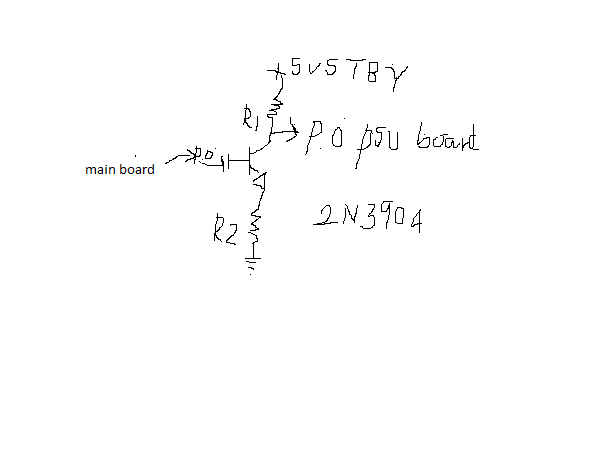

                    #29
                    Re: Vizio E422VA not turning on
                    I will make a modified circuit to make it works. must figure R1 R2 to make output
                    about 4v (on) 0v(off)
                      That will invert the Active HI signal from the main board, the PS_ON signal must be >2V = ON, <1V = OFF. The output at the Collector is inverted from the Input at the Base.
                      I am not sure how the circuit is related to this thread. Also the signal is DC so you cannot put cap on the Base pin.
                        Ok Budm. May be I am wrong here. It is an inverter a hi on p.o will make a low
                        out.I just want to make a higher voltage for his p.o from main board.As I think
                        his psu board is good.

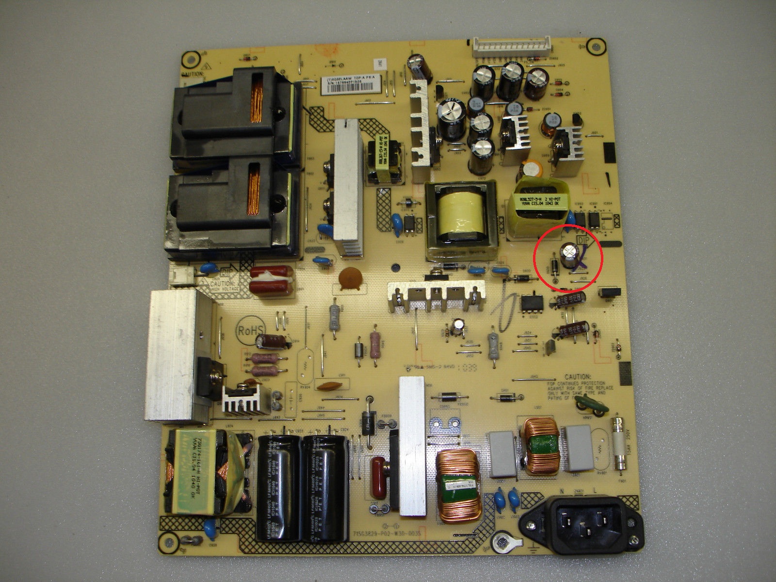

                          The board in the picture is not my TVs board, I'm trying to point out the place, that seemed the most affected by the heat.
                            #33
                            I believe that cap in red circle and the other 2 close to it are part of start-up/running caps, just replace them will be faster to find out if they are bad or not, they should be replaced sooner or later any way as part of the caps kit.
                            What is the P/N of that 8-pin IC close to it?

                              Unfortunately, I don't have a 100uf/50V capacitor, only 25V. Need to place an order.
                              They use Elite capacitors in the PS, I have never heard about this brand.
                              Should I replace all of them?
                                Probably a good idea, Elite aren't that great

                                  Can I see the bottom side of the board? Also take the DC Voltage readings right at the two legs of those 3 caps, and also the P/N of that 8-pin SMPS IC next to the cap in red circle.
                                      TV it's running, yeah!!
                                      I have replaced the circled capacitor(100uf/50V) and the orange one(330uf) after the transformer(in secondary part of the PS).
                                      I'm not sure now which fixed the problem, because the capacitor meter is not showing a constant value, but I'm suspecting the orange capacitor.
                                      At the bottom of the power supply where the capacitor is and the diode on a heating it's yellow, it runs to hot and dried out this capacitor. Capacitor meter shows a value around 157 out of circuitry and it should be 330uf.
                                      Easy fix.
