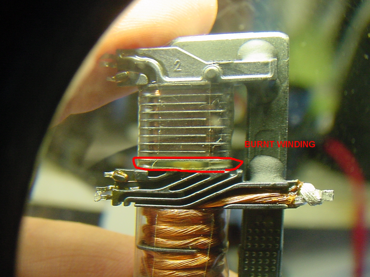

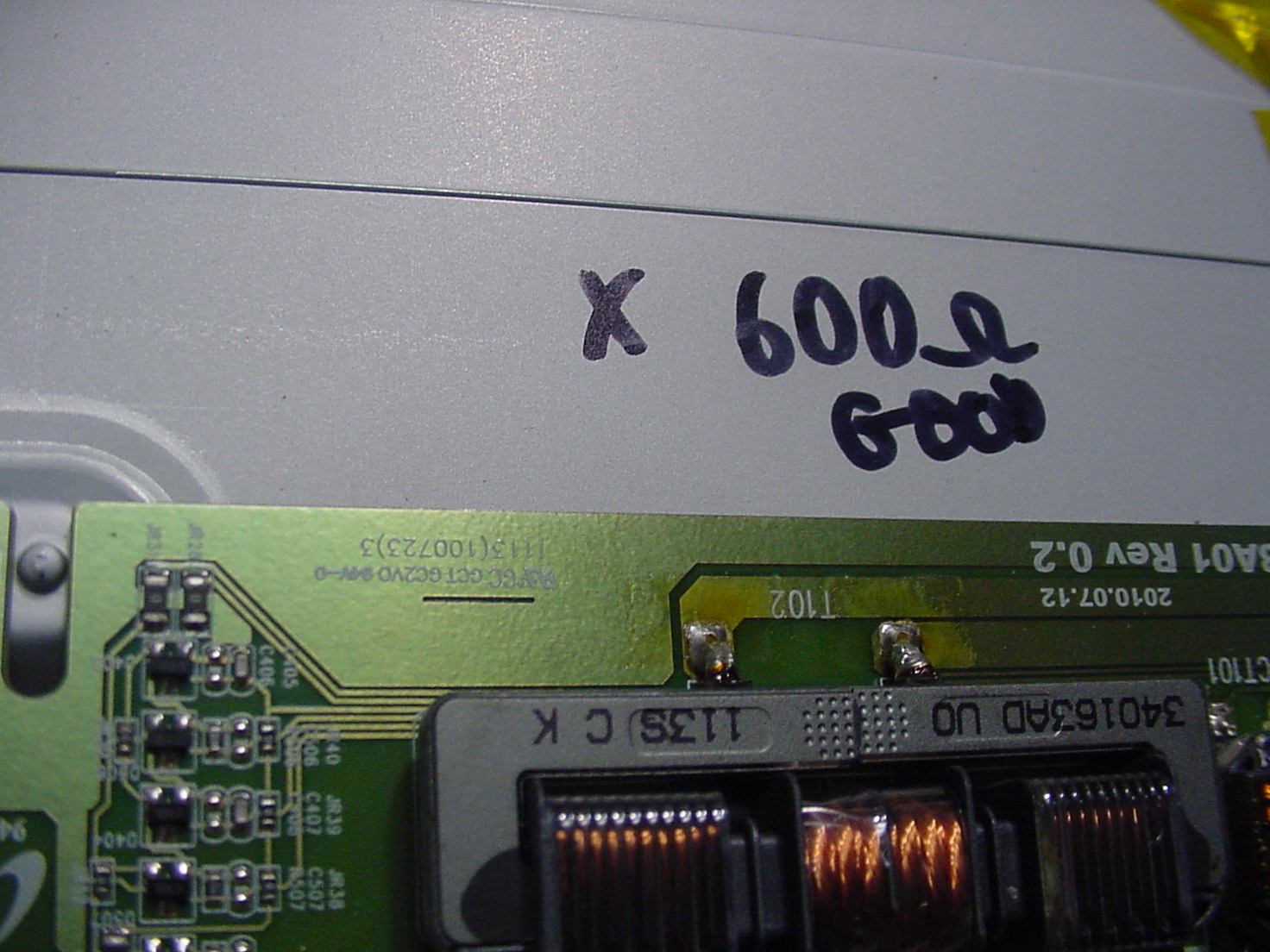

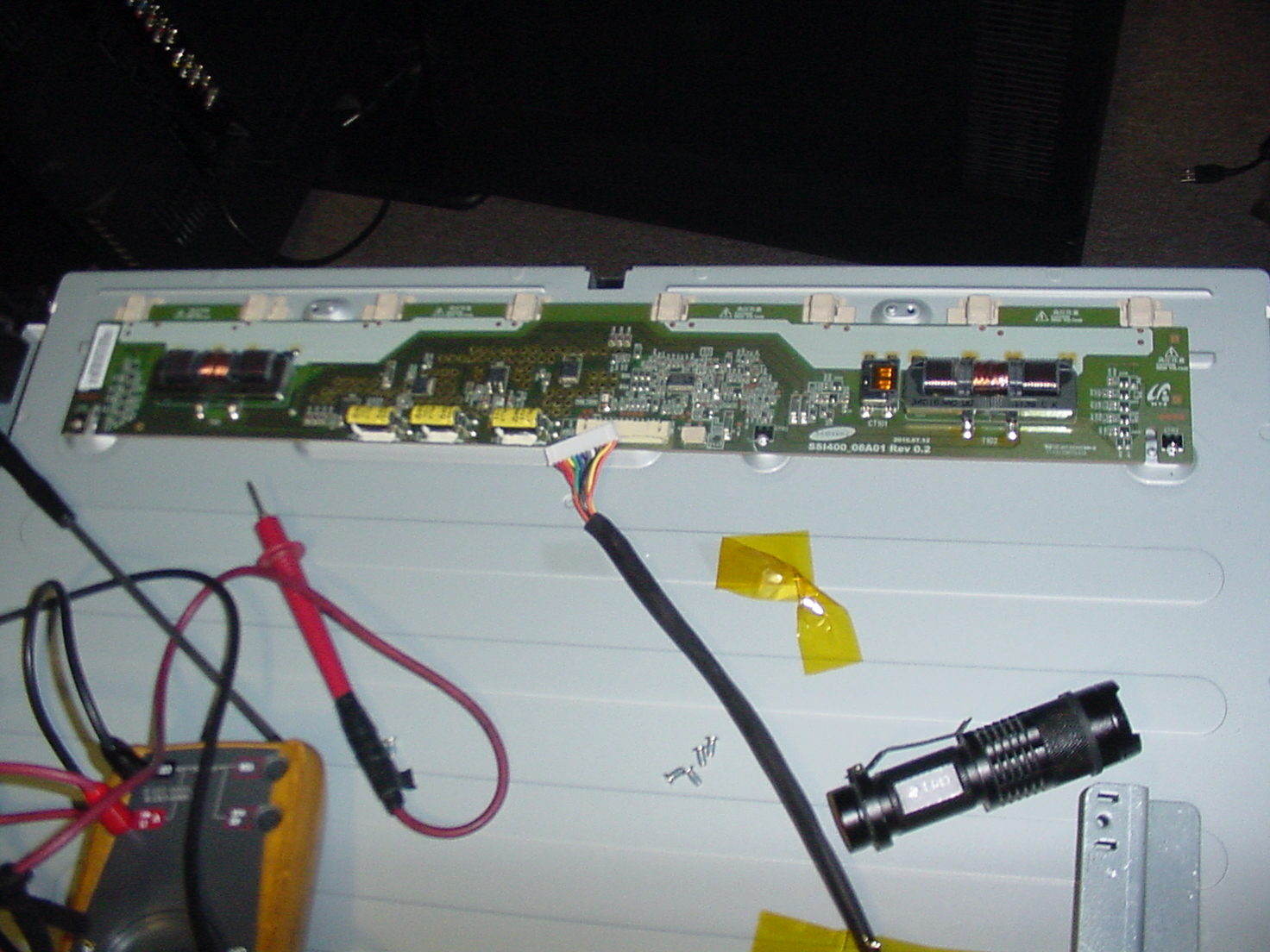

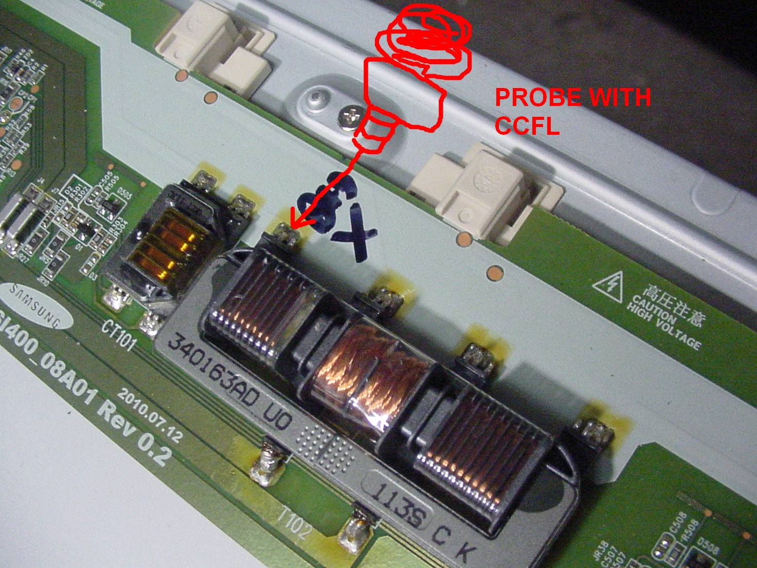

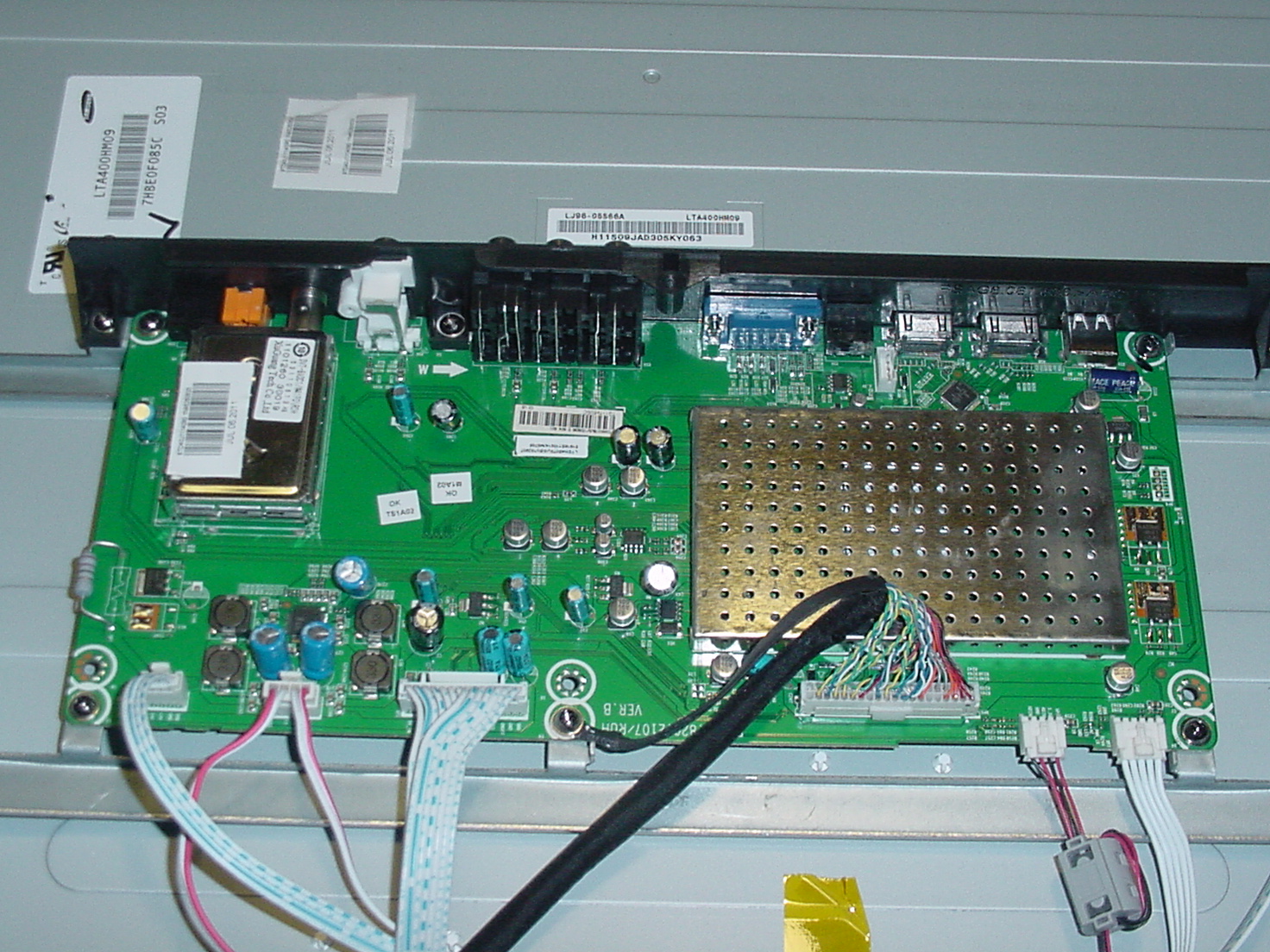

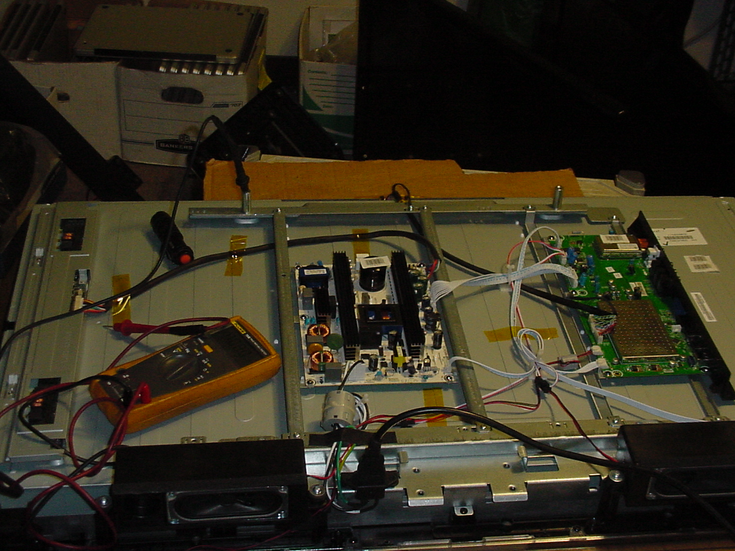

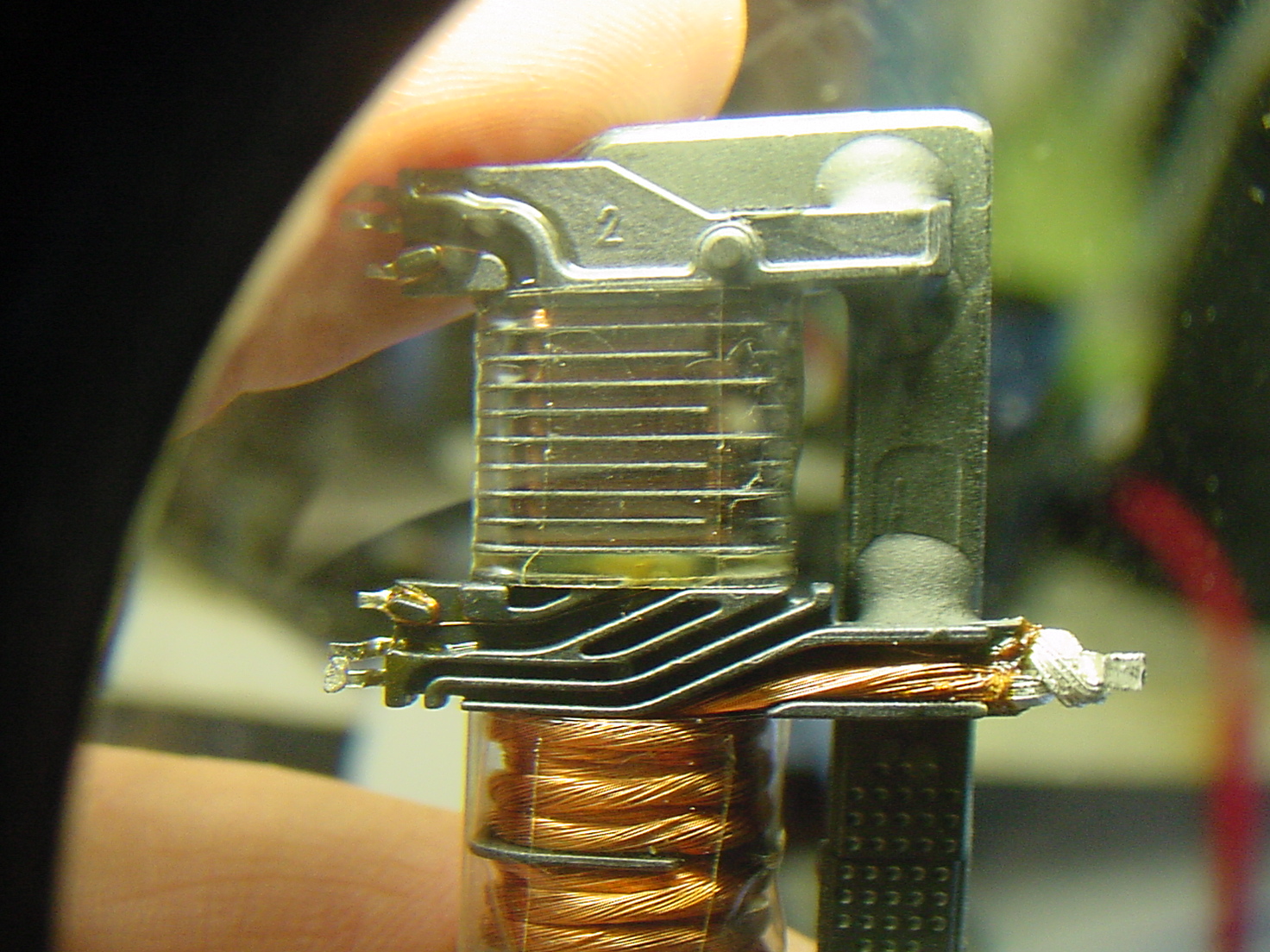

    I got this one in today, the backlights come on for second (it shows 'PLEASE WAIT'), the go black. Check the 24V, BL_ENA are OK.

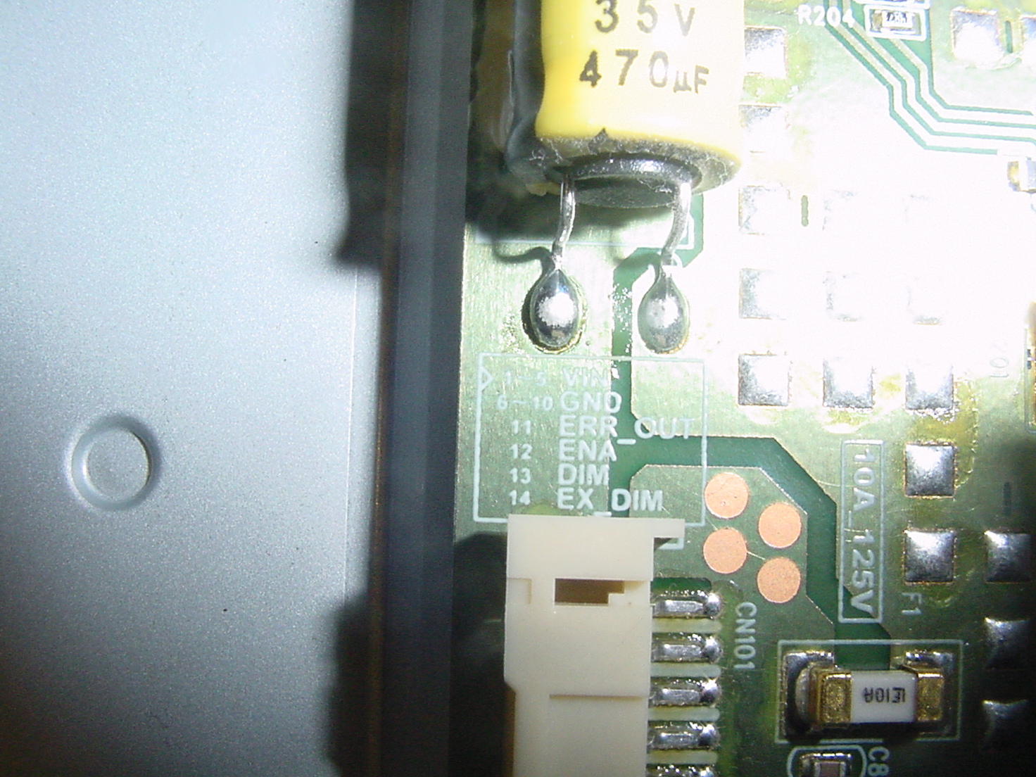

    Check the fuse on the inverter, ESR of the caps on the inverter are OK.

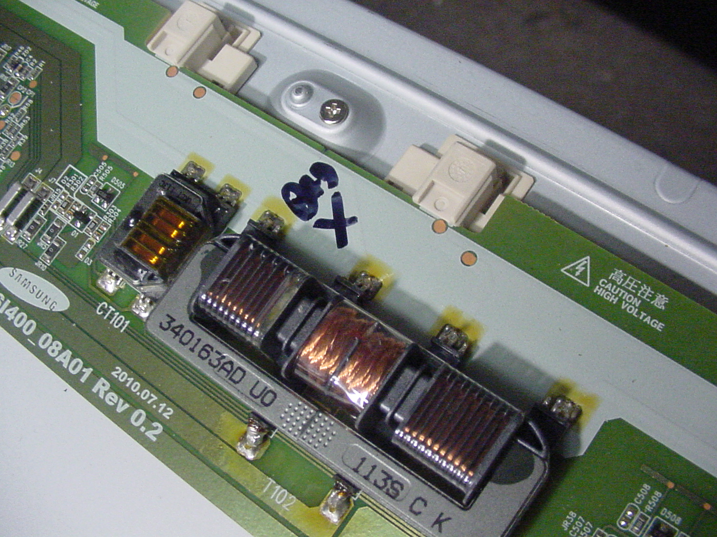

    Check the DCR of the inverter transformer high voltage windings side, all around 600 Ohms (they are within 1% from each other).
    So thought I may have bad lamp.

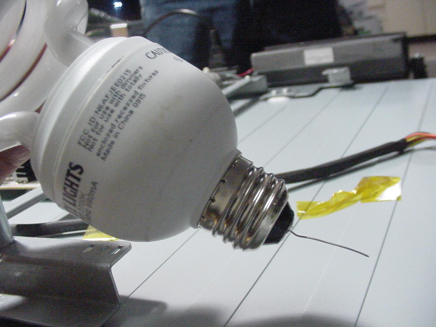

    I grab CCFL and solder a small solid wire to the center of the lamp base.
    I touch one pin of the four pin (the inverter high voltage transformer has 4 pins on the high voltage winding side) at a time then turn on the TV to see how my CCFL will light up. I see that the CCFL is lit up partly on one of the winding. The good winding will light the lamp brightly. I remove the transformer, and sure enough, it has burnt winding.
    So this is a new trick for finding bad inverter transformer.

    That's a awesome method for testing. so u just hooked up a wire to the point u circled and touched it to the bottom of the light bulb to test it. How did you get the transformer off. Are they just soldered in?
      Re: Dynex DX-40L261A12 using CCFL for locating bad inverter xformer
      It is just SMD, so I just add more solder to all the pins and just tilt it up.
      I solder the solid wire to to the bottom of the CCFL base to use it as the probe.
      BTW, I meant to type CFL, not CCFL.

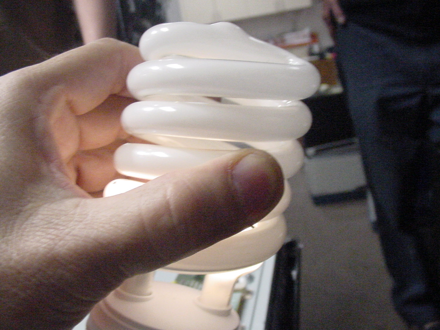

          that's a 110v cfl lamp,
          and i dont understand how it's running.
          you could use the tube, or a philips PL tube,
          but i dont understand how the cfl runs with an internal rectifier, smoothing cap and invertor in the base!
            Budm is bypassing that and just using the CFL tube.

                  The lamp is one of those broken lamp that I solder a solid wire to the base of the lamp and no need to take the lamp apart, it can be 120 0r 230V CFL, the high voltage will just goes through the lamp circuit (due to stray capacitance) and through the lamp glass due to stray capacitance of your body while you are holding it with you hand, Just remember that we are dealing with high frequency AC, any stray capacitance inside the lamp will have low reactance.
                  Ever try holding the fluorescent lamp close to high frequency generator?
                  This is an old trick I used to find out if AC High frequency generator is working or not (I used to repair lots of PLASMA Etcher for semiconductor industries), on the high power the lamp does not even have to make contact with the source, just put the glass body close to the source and it will light up.
