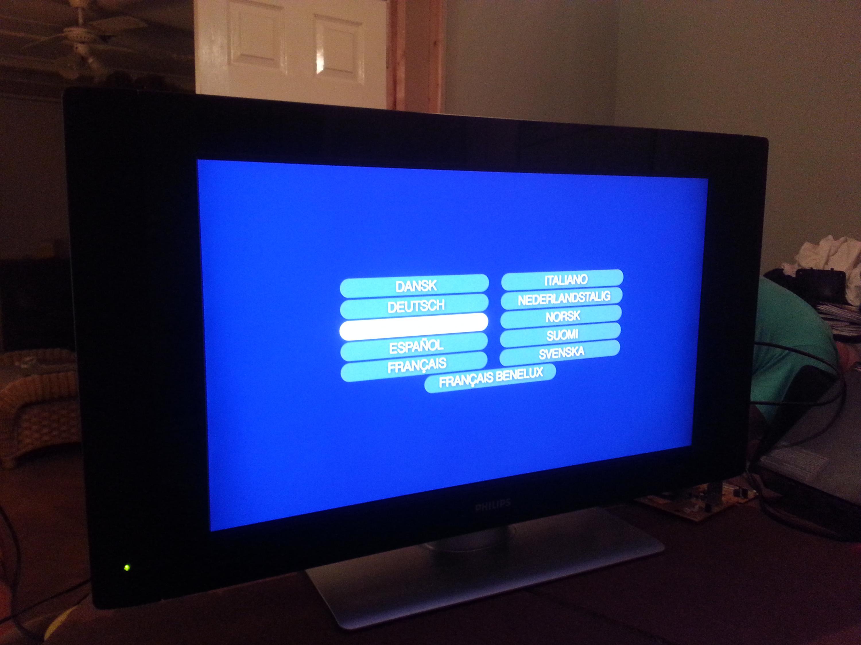

              Re: philips 32 lcd keeps going on and off even when all caps have been changed
              Everything goes off on it then resets

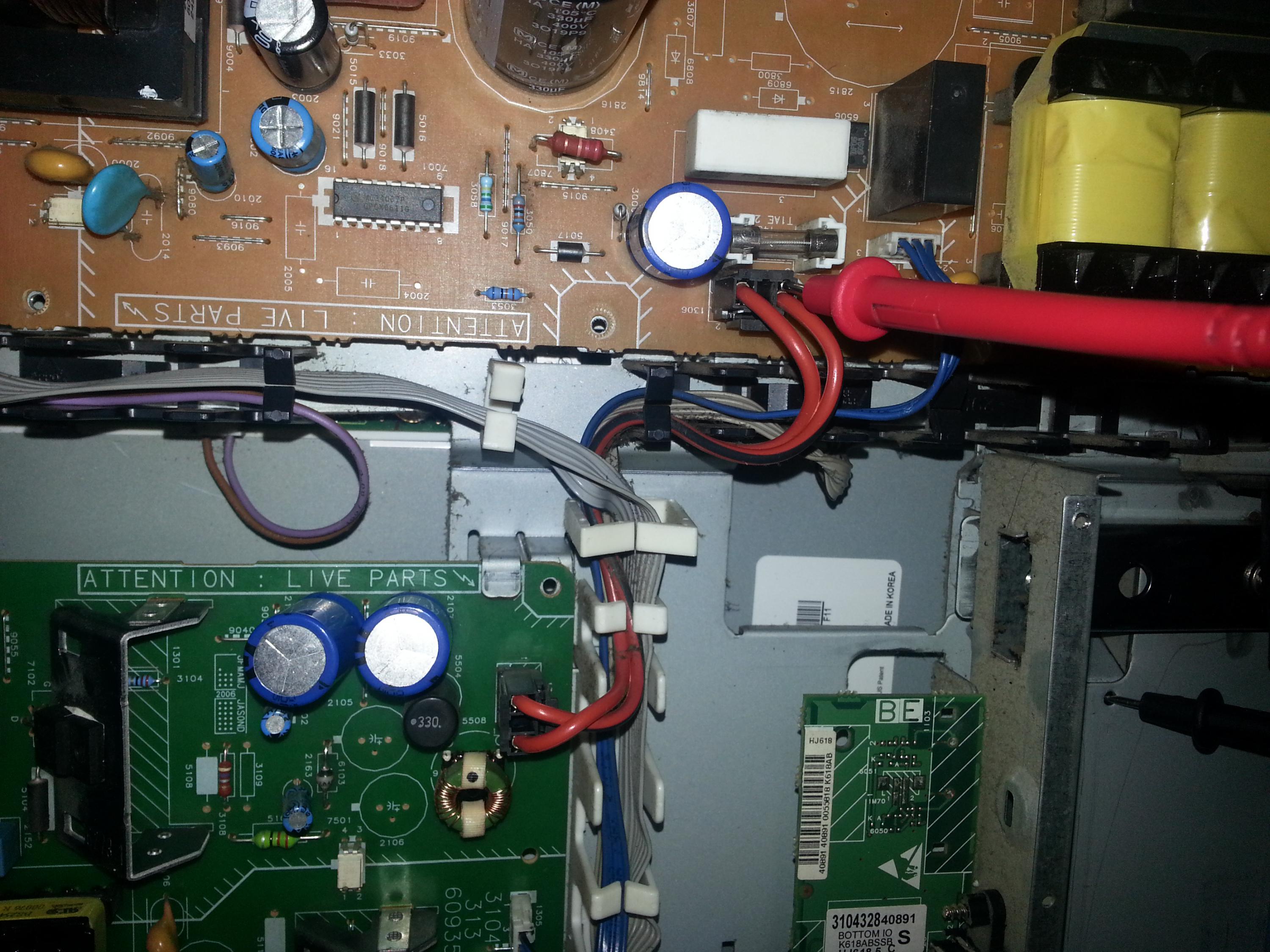

                        its labelled 1306 on the power board and goes to the audio standby
                          I don't know every TV chassis off by heart so if you would be as kind to highlight this component on a photo I might be able to make a guess. What about the answers to my other questions?
                            I'll get a pic in a mo for you I put a video up to show what it's doing it turns back on its self
                            • adamp91gvm
                              • Jan 2014
                              • 699
                              • uk
                              Just there to the audio board
                                No idea if that's OK, but if that part is only for audio I would exclude it for now. The way it turns off almost looks like panel 12V fails and it might be resetting because of this, try locating t-con board and check fuse voltages.
                                      12v now sorted voltage on t con but still goes off as soon as I plug and play my blue ray through hdmi
