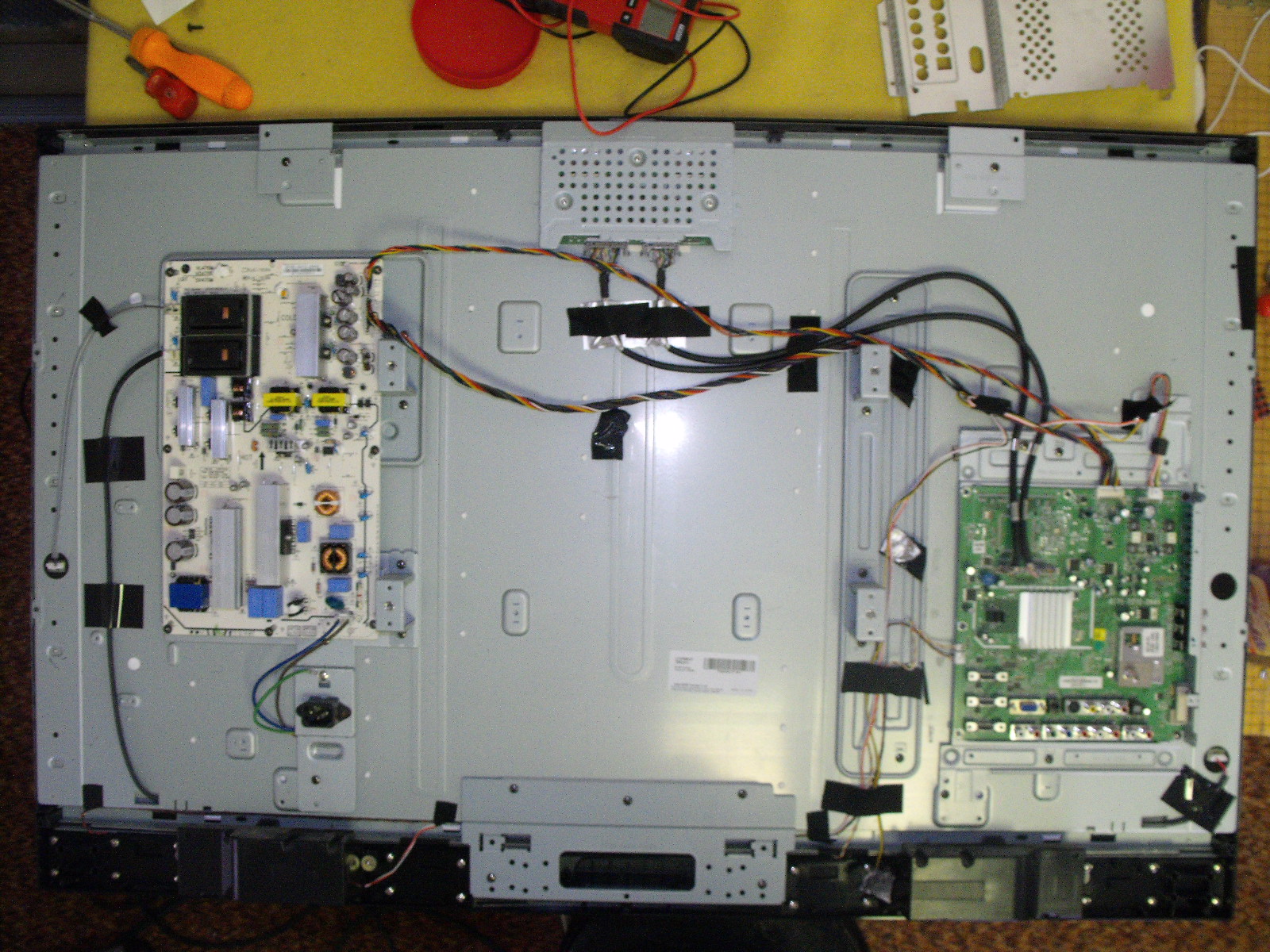

    VIZIO SV470M orange to white logo

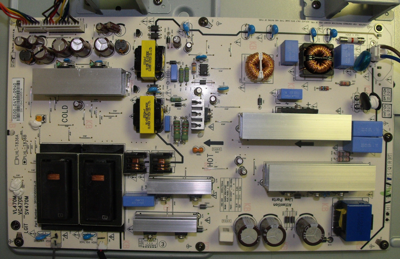

    VIZIO SV470M push power and logo goes from orange to white and no picture or backlight flash. 2 plugs on the power board. First plug DIM=2.71V INV_ON=0V Status=0V ACDET=0V second plug ON_OFF=3.1V next 3are marked 12V=12.17V next 5 are GND and last 3 are marked ST/+5V=5.16
    Checked all electrolytic caps with ESR70 and all good. Also looked at solder joints under lighted magnification and good. No signs of anything getting hot either.

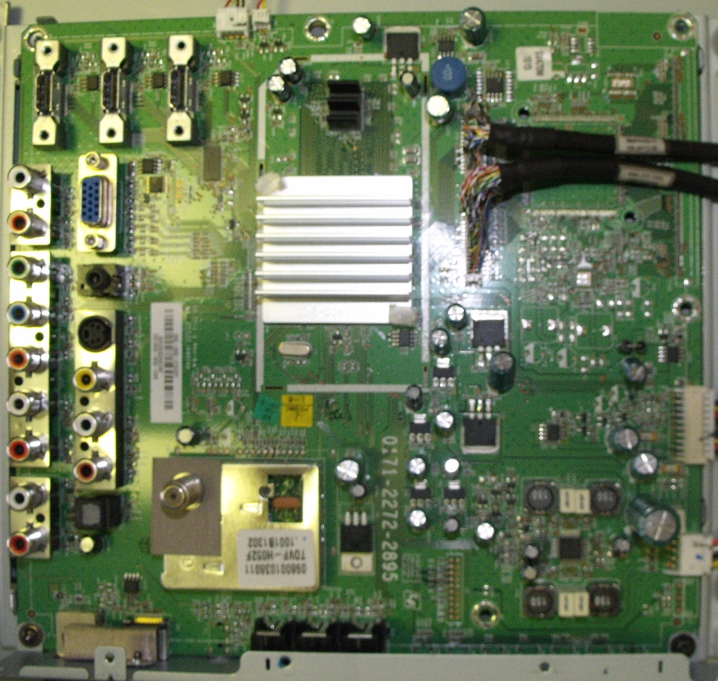

    I had a Vizio that did the same but was a different model. Check all the LDO voltage regulators on the main board. The voltage was just a little low but enough to prevent the set from turning on.
    I could not read the parts or silkscreen from the picture. Could you post a clear picture?
    • Ltank
      • Jun 2013
      • 776
      Re: VIZIO SV470M orange to white logo
      l looked at ShopJimmy and they are out of main boards (3642-0692-0150) for you set. But i did get a clearer pic of the silkscreen for the voltage regulators.
      You tube (norcal15)has good videos but he doed get to checking the voltage regulators.
      https://www.youtube.com/watch?v=cNFzBJELFoU
      Check U2, U3, U4, U5, U6, U7, U8 and U9. They shoul be within 10%
      The one leg will be the voltage in, another will be voltage out and one will be at gnd or close to it. I could not see what the actual part numbers are on my smart phone.

        I just measured what I could see. it goes from left to right.
        U9
        556mV
        1.8V
        3.29V
        U5
        2.04V
        3.2V
        5.07V
        U3
        2.04V
        3.29V
        5.03V
        U7
        2.03V
        3.28V
        5.07V
        U6
        6.96V
        8.21V
        12.13V
        U2
        2.05V
        3.29V
        5.10V
        U4
        1.46mV
        1.25V
        3.29V
        • CraigR
          • Dec 2013
          • 965
          Yep, seen all his videos and Tampatech's also.
            They are within spec.

              Your first entry states " INV_ON=0V Status=0V ACDET=0V ". Unplug the set. Can you disconnect all cables to PS except AC in. Then use a 100 to 500 ohm resistor to jumper the INV_ON to the 5vdc standby voltage. Will the PS turn on? If so turn it off, unplug set then connect the inverter cable and retest. Do you get 24vdc? Did backlights turn on?
              • CraigR
                • Dec 2013
                • 965
                Ok, INV_ON jumped to 5V all cables off except power cord. I did not hear any click or anything when plugging the power cord in. I connected the back lights and tried again and nothing. 133 ohm resistor.
                  To force on the Backlights, you also need to force on the PS_ON pin (to turn on the PFC and the main power supply) beside the Inv_on PIN, some time you will also need to feed the DIM pin.
                  • CraigR
                    • Dec 2013
                    • 965
                    Ok then, what should I try next?
                      So you also jump the PS_ON pin with 1K resistor to the 5VSTBY too?
                      • CraigR
                        • Dec 2013
                        • 965
                        That made a difference. The board came on and then the backlights also.
