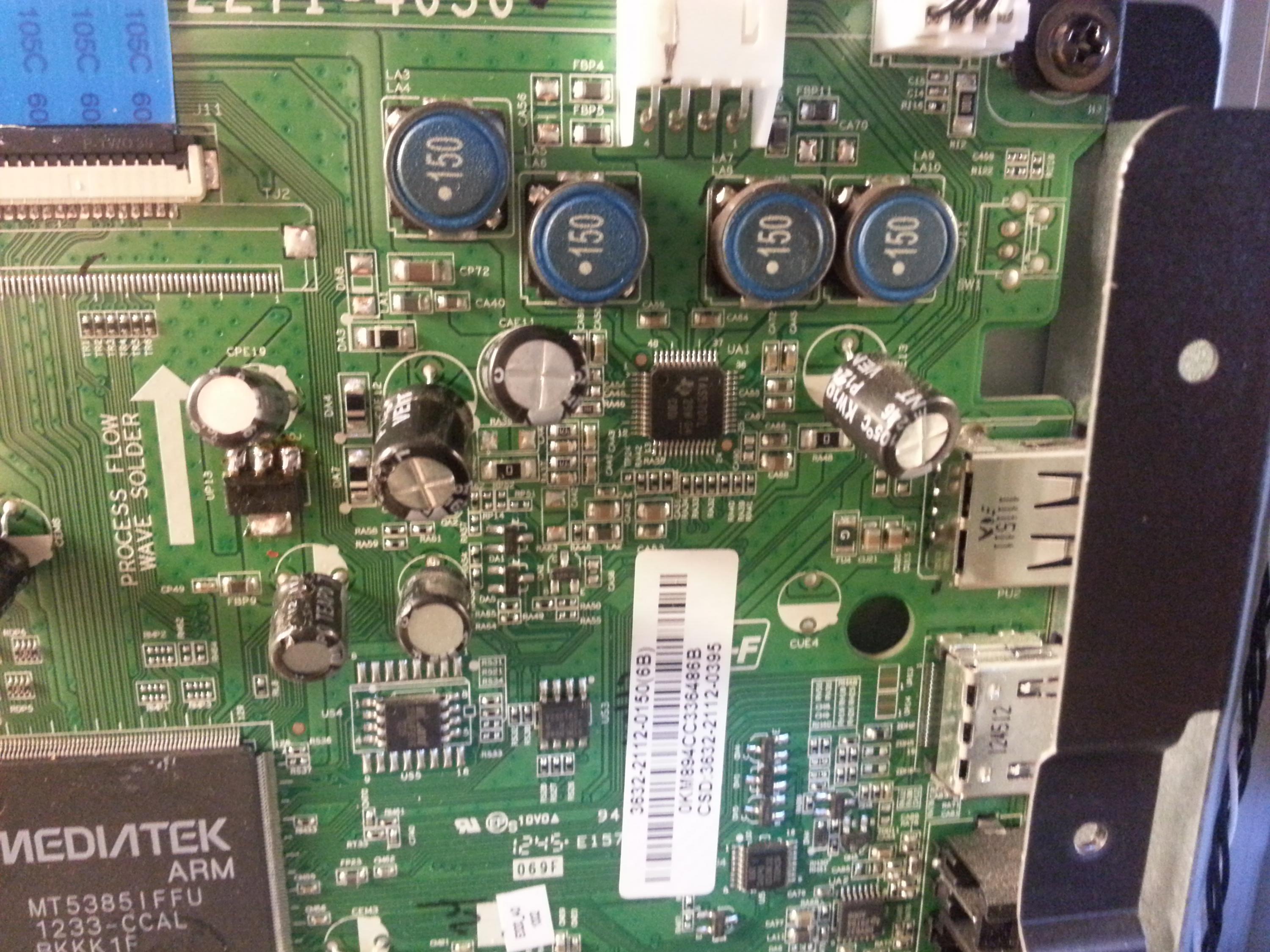

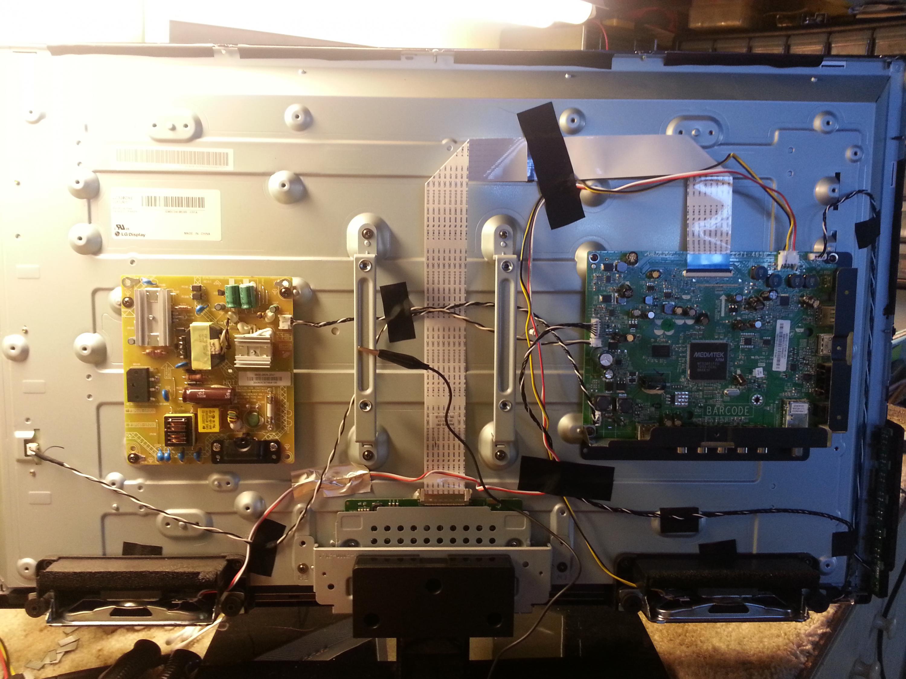

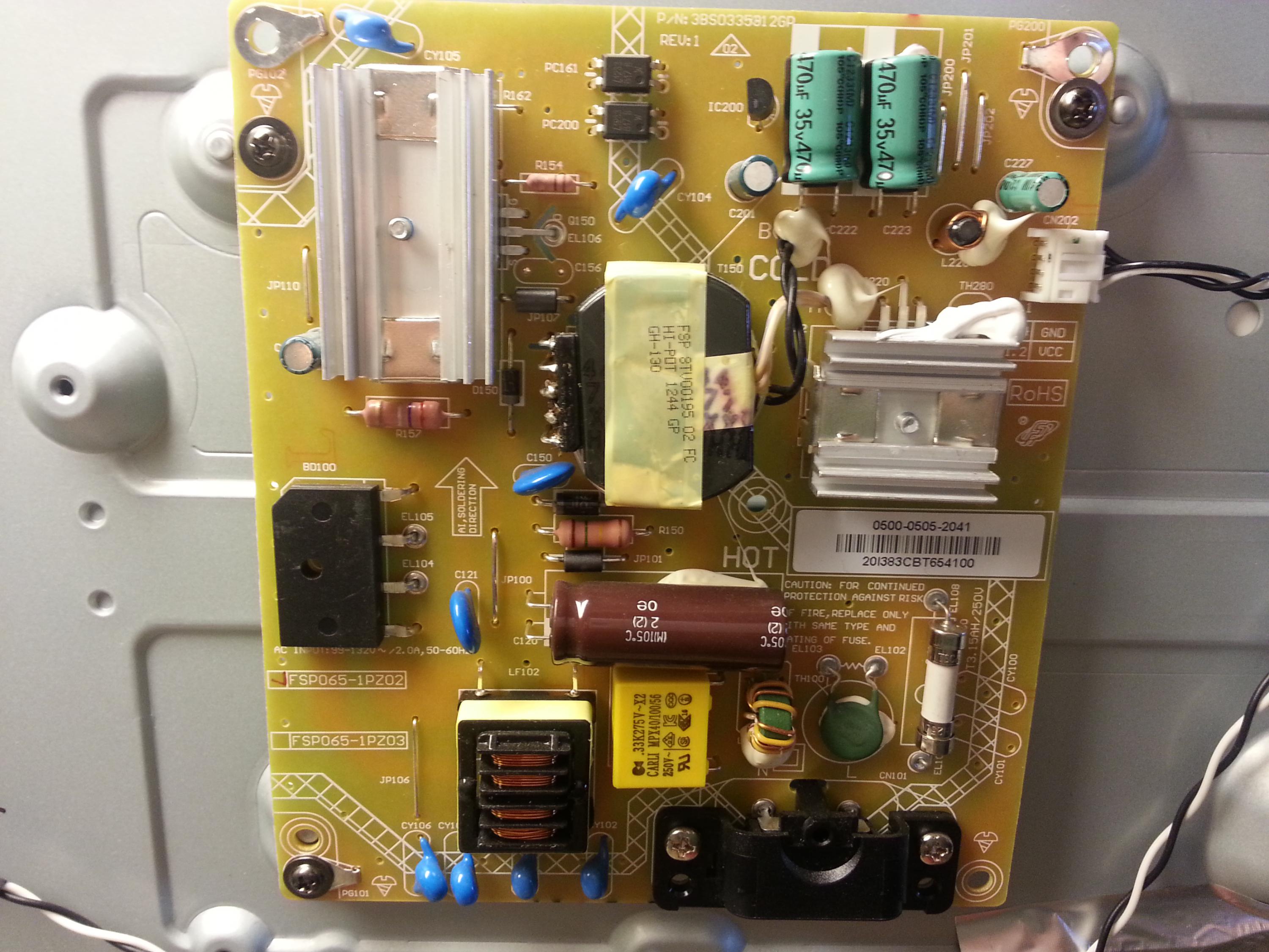

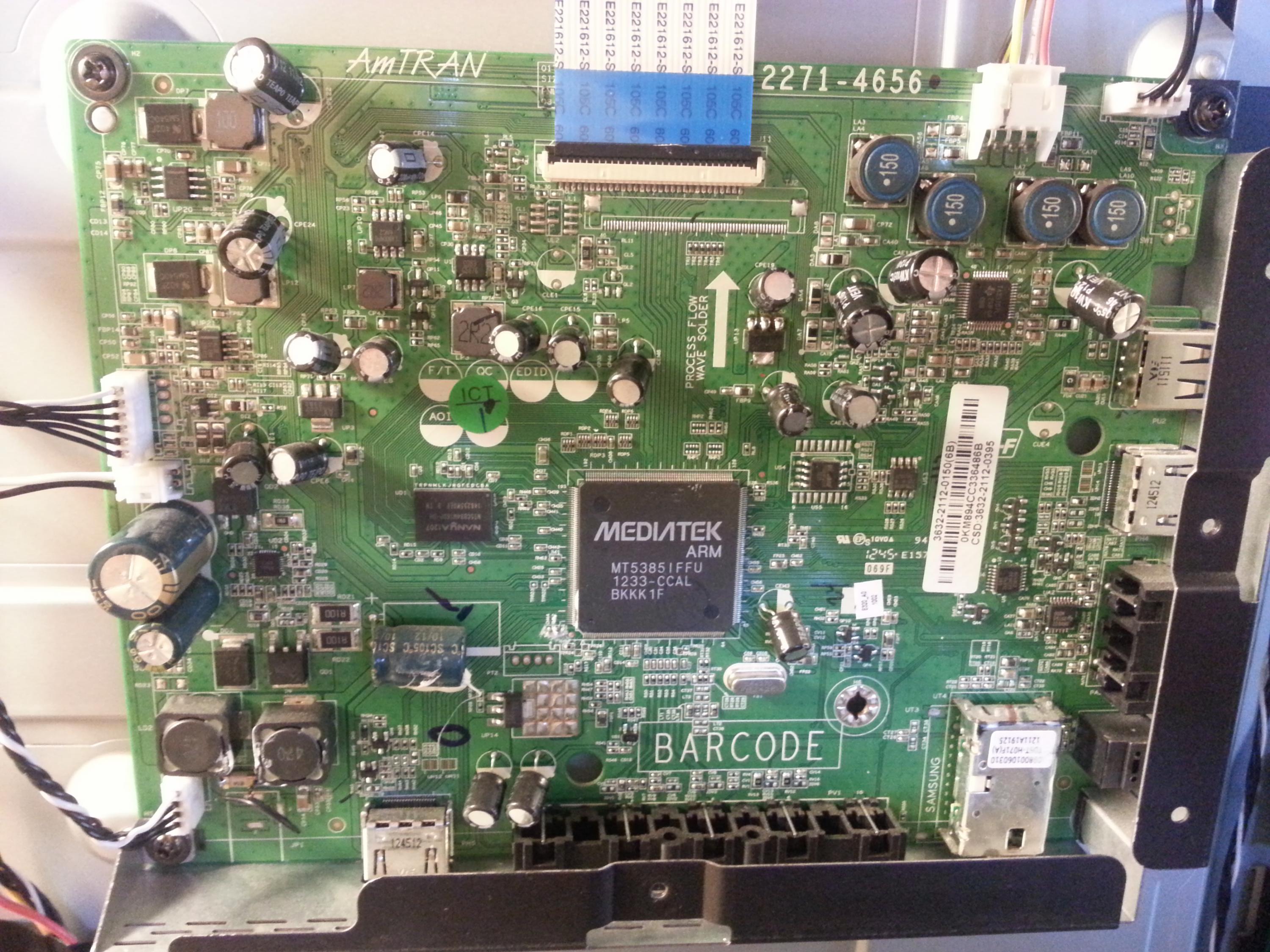

            Here are some pics of the P/S and the Main board. The caps in the pic of the small section with the part# sticker are not getting any voltage. The only one that is is the one closest to the regulator and that is 1.2V

              This is LED Backlights TV, the LED drivers are on the main board for this TV. So you are indicating you are getting 24V the 2-pn connector with Black and White wires to the socket on the LCD panel?
              There are more than one version of the boards in this TV.
              http://www.shopjimmy.com/catalogsear...=Vizio+E320-A0
              I will need to look further at the boards to see how it all works together.

                      There are two mosfets that I assume are the led drivers. One has 24v at the drain but nothing on either of the other pins and the other has no volage at all. On or off.
                        Re: Help with Vizio E320-A0
                        This is not going to be easy, the problem is in the main board, I wonder if it has EEPROM problem.

                                Thanks for all your help! Since the mainboard was very cheap I decided to just buy a new one rather than figure out the many things that can be wrong with this one without having a service manual.
                                Hopefully this fixes the problem and I have a working TV soon.

                                  Looking at the Main board, it looks odd that all the bigger caps are raised up and crooked. Did the previous owner change the caps? I have had sets that the owners attemped repairs and the results usually are not pretty then they sell them. I hope the main board fixes it. Good Luck

                                    The caps are fine and have never been replaced. I received the new main board today and popped it in and everything is well. TV works great. Not sure what went wrong with the original but I couldn't find an eeprom for this TV so replacing it was just easier and cheaper for this TV. $28.00 for a mainboard is the way to go .
