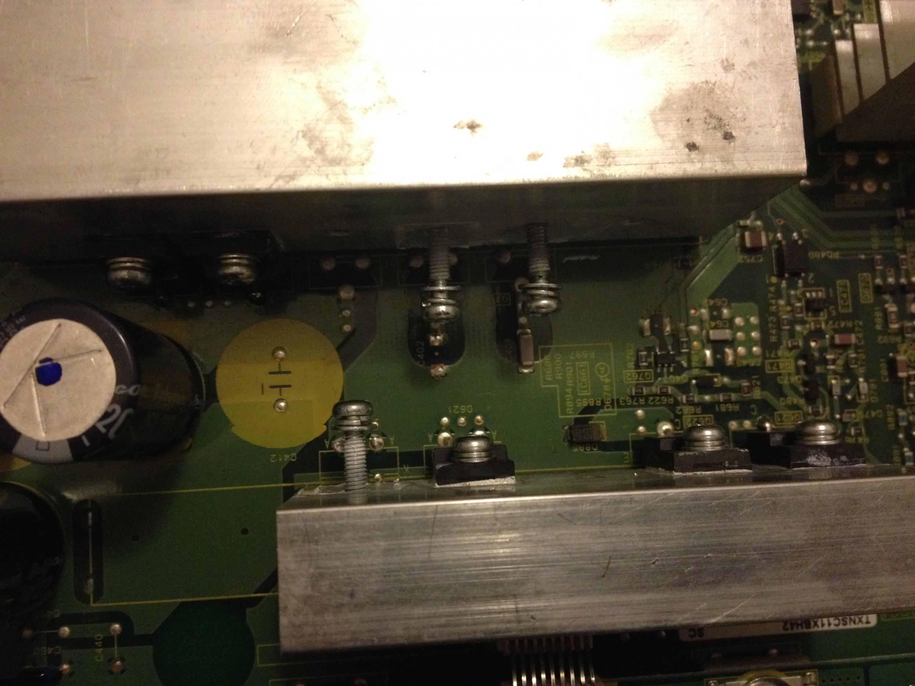

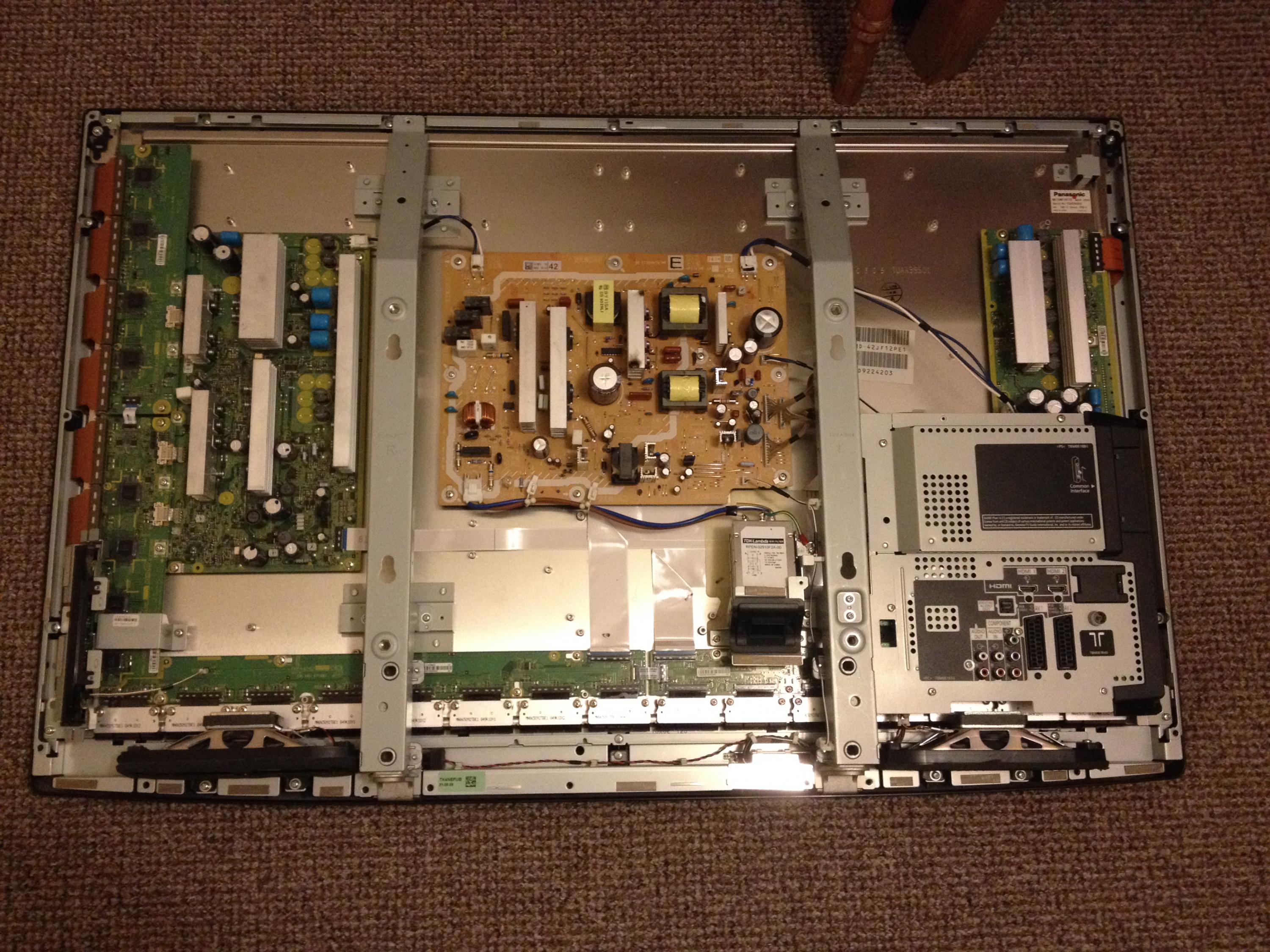

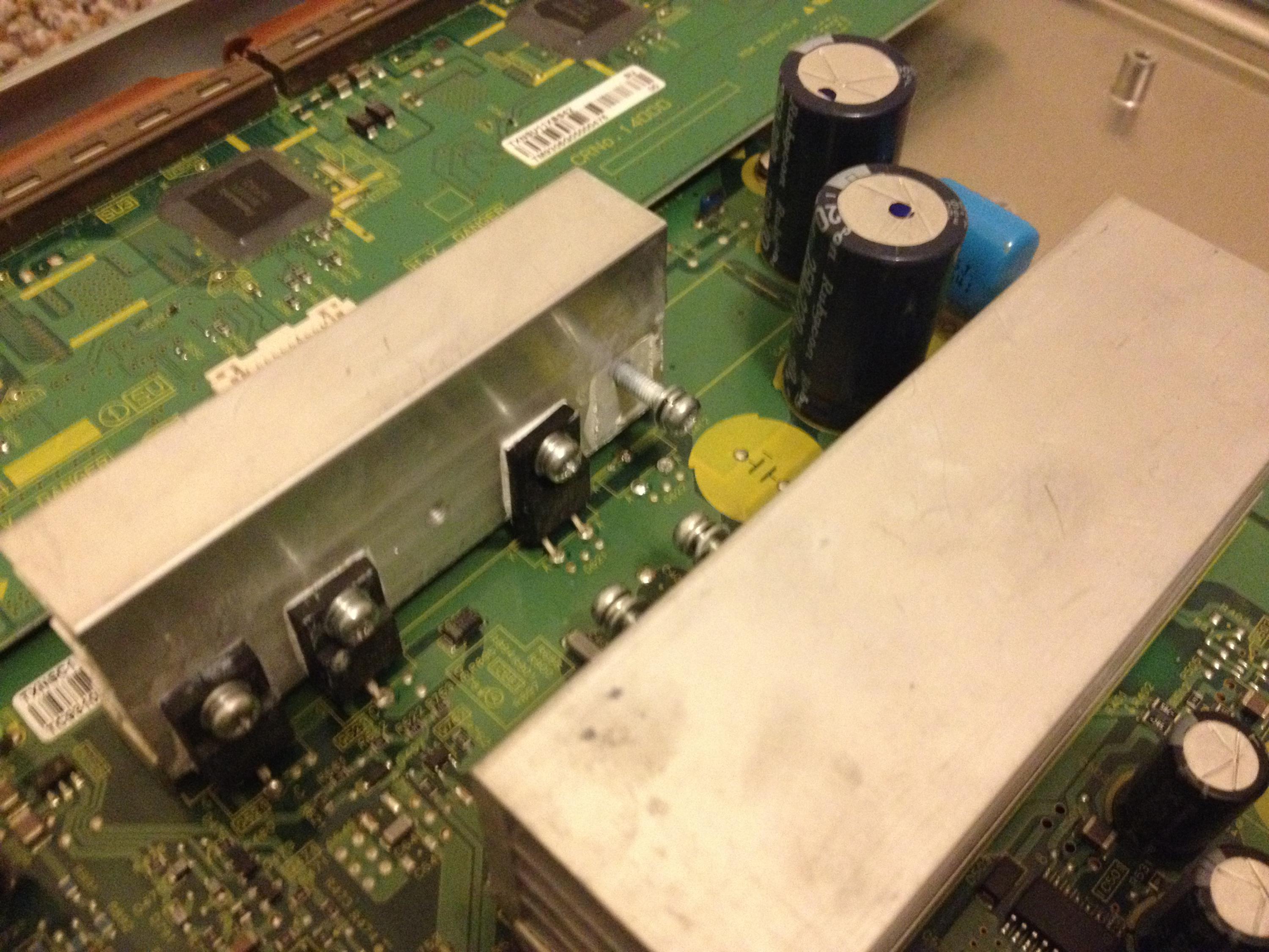

    Hi All been away a while waiting for parts and getting side tracked, found this Panasonic nearby and never having one for repair wanted to give it a go
    7 Blinks wont power on
    The seller was using daily until sometimes is was hard to turn on sometimes
    he told me this went on for a while all he did was unplug it then try again
    until recently it wont come on at all
    so i checked it and looked untouched and clean and screen good. He had bought a new one and just wanted rid
    I paid more than i would have liked then took it home
    the pics say it all for my first panasonic -- WTF

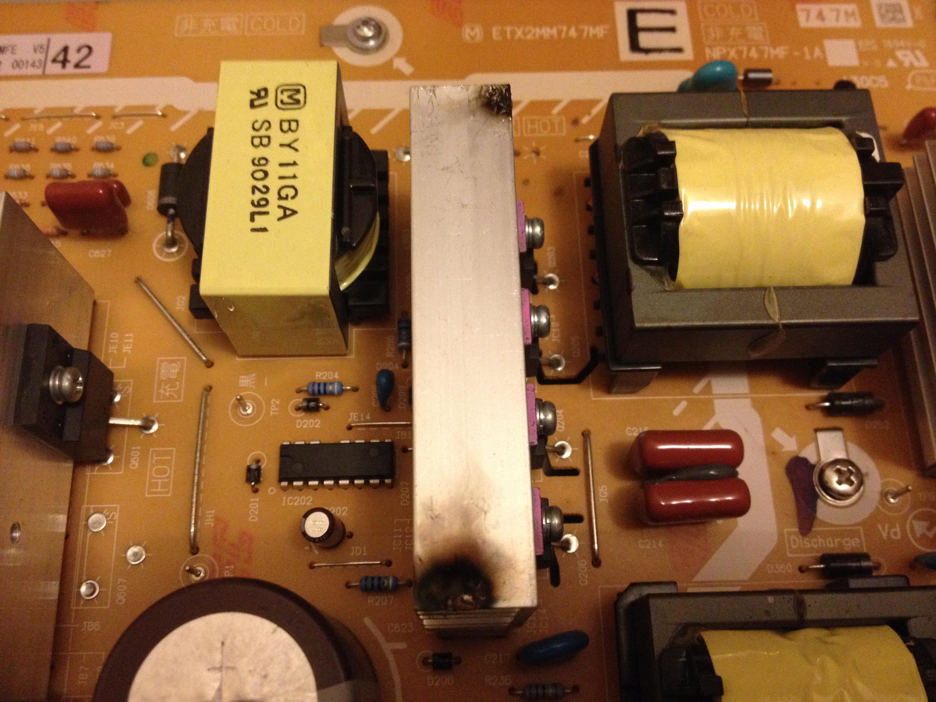

    Often a power-on problem that gets slowly worse is bad capacitors.
    But what interests me are the burn marks on the heatsink!

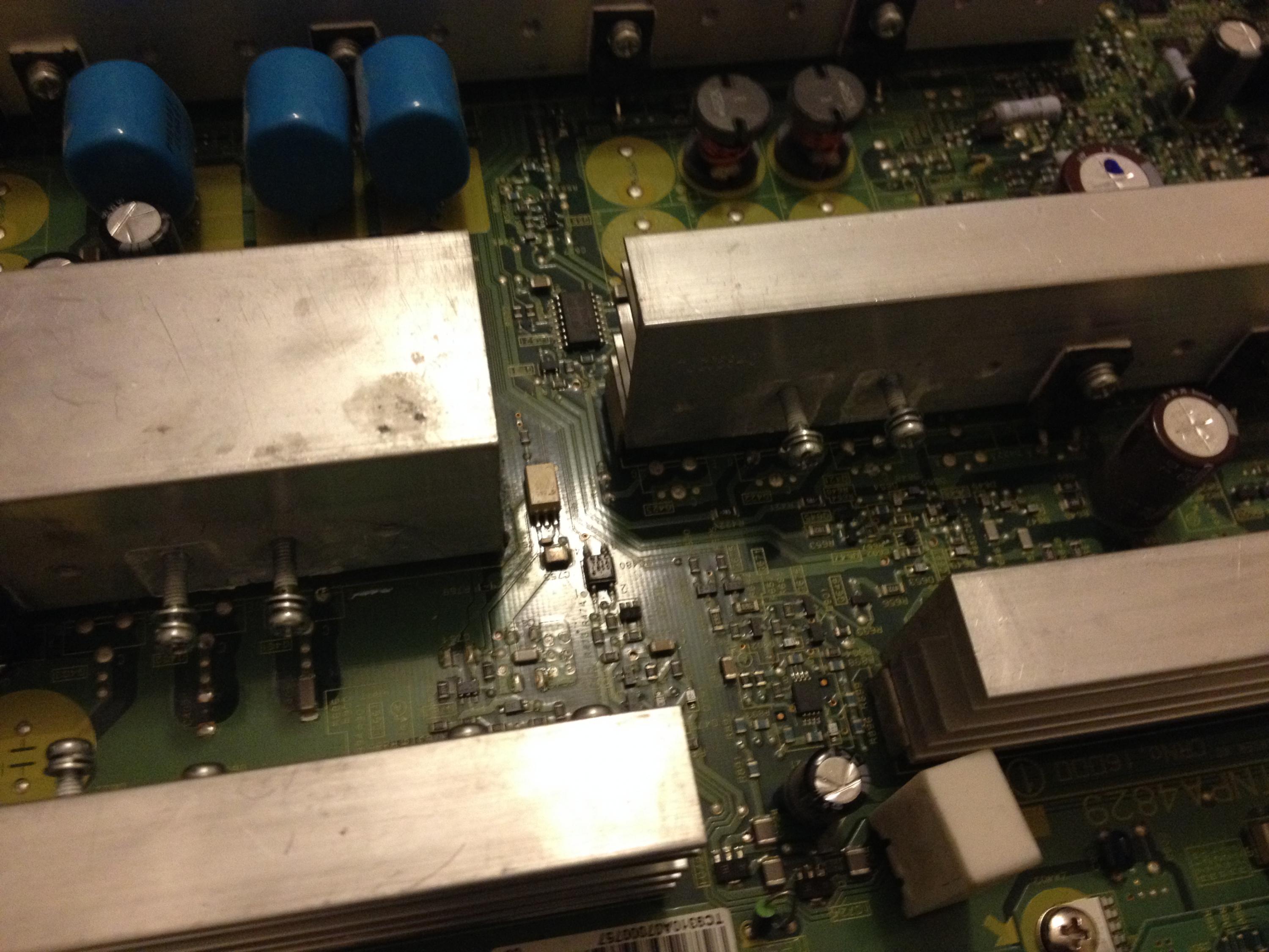

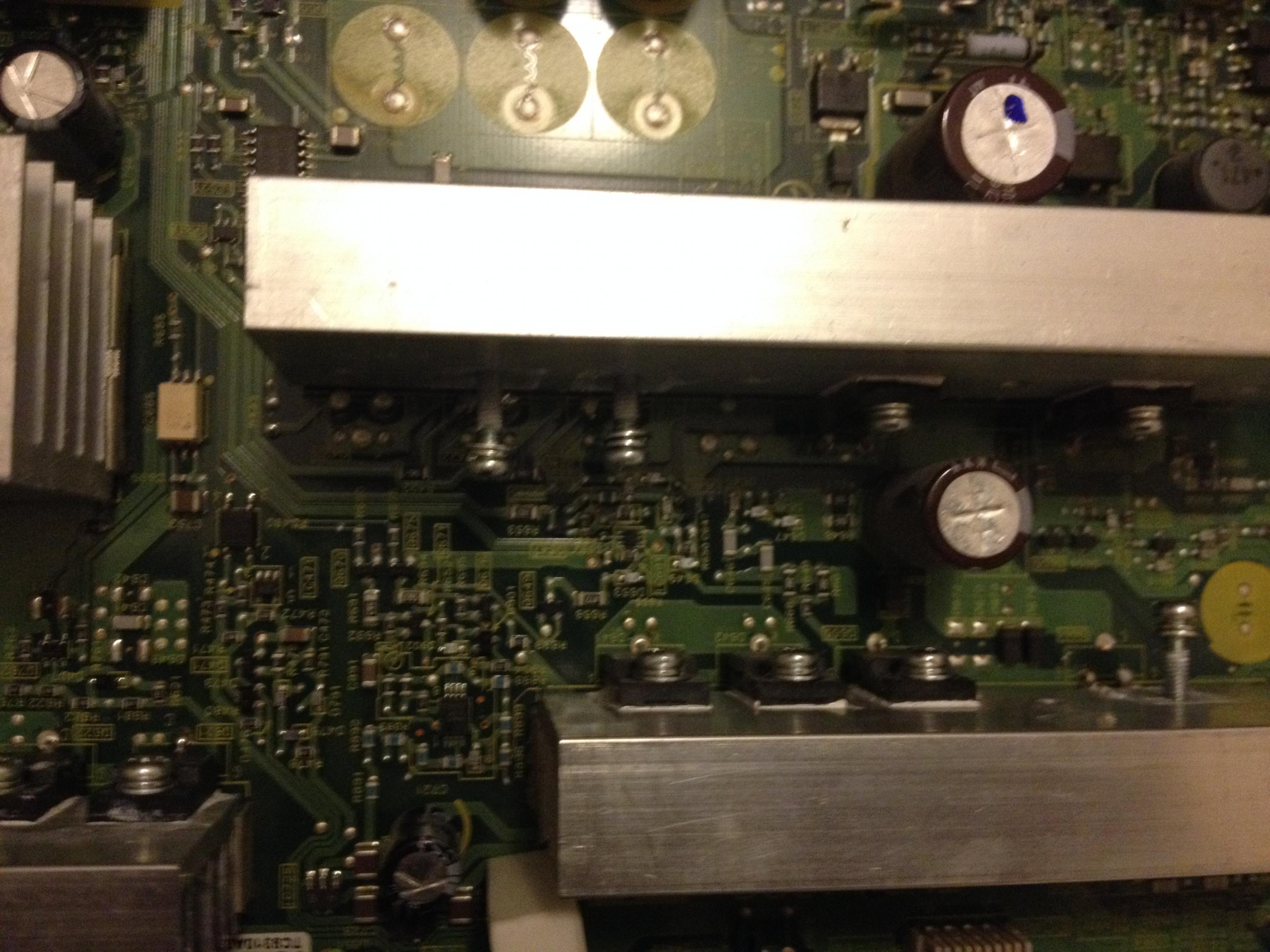

      Re: Panasonic TX-P42S10B
      im more worried about the missings FETs missing from the y-main lol

        i think the person i bought it off forgot to say "hes tried repairing it but couldn't so then sold it"
          Only looked at thumbnails, didn't notice those missing FETs! Hopefully those were the bad ones (That he probably blew out from whatever mistake caused the heatsink to get burnt)

            I think SC failure is fairly common in these. there are a couple of Ebay repairers of the board and some here have done that since these are pretty much impossible to find.
            not sure how you'll go now with the SC messed with as most repairers will not attempt a repair. i'd try and find out what exactly the previous person had done.
            It may just be that the shorted IGBts have been removed but if they've tried replacing them and powered it up, other damage may have occurred.
            they probably bailed out on cost. I think fro memory a Sc repair is about $130 plus you should resistance check the SD/SU as well just in case.

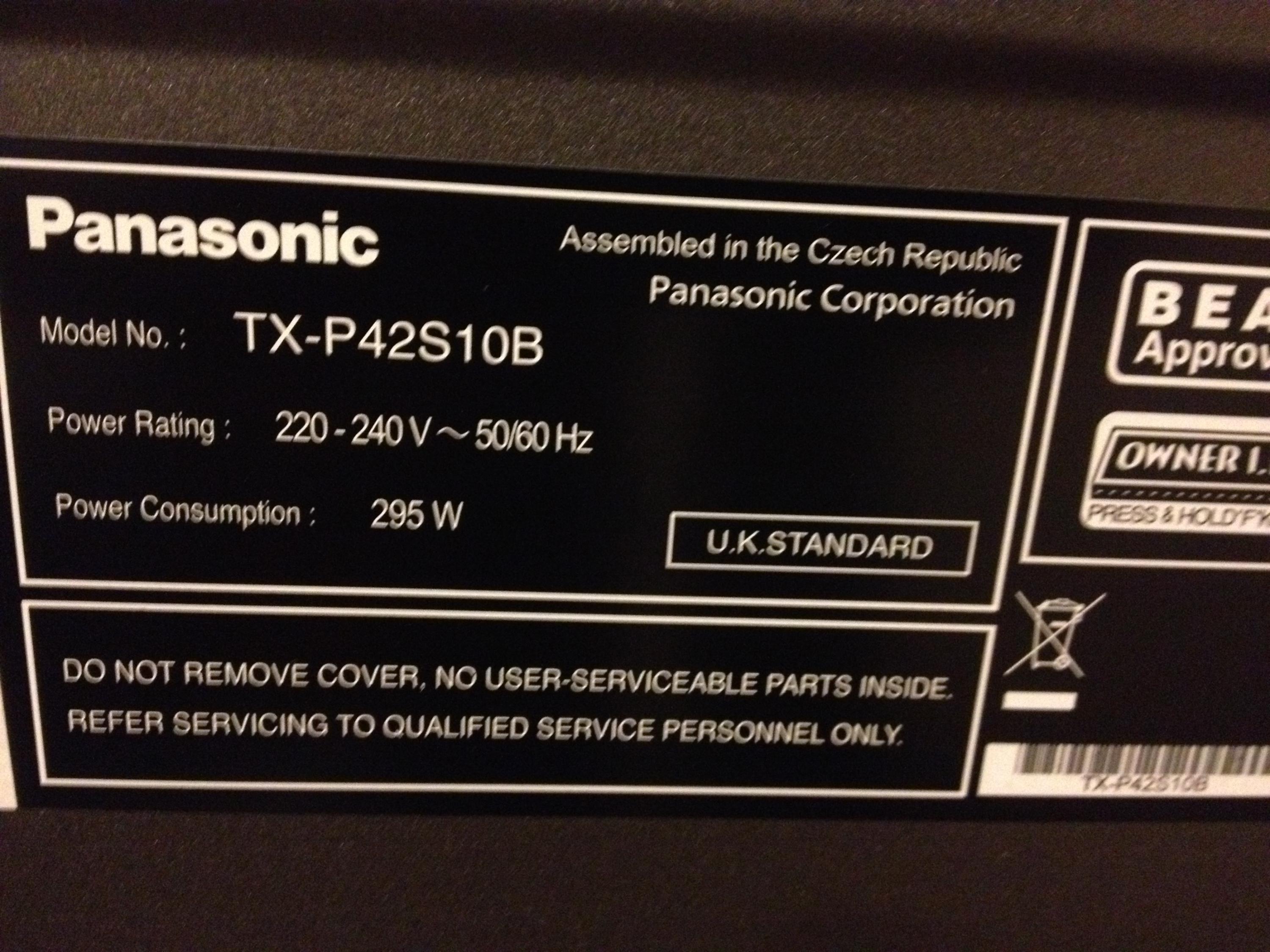

                So you need TNPA4829AD or TXNSC1EKUU.
                Inside the rear cover are there corresponding burn marks for what we see on the PSU?
                You may want to check fuses and FETs on that PSU and see if he's blown it.
                It may be possible to power this set up to confirm PSU and A board but will require isolating all the other boards.

                    It is a TNPA4829AD

                          If you think the PSU is ok, disconnect 3 white ribbons at the A board , P35, SC2, SS11 and power up and confirm if it starts ok and stays on. This will confirm PSu and A.
                          then I'd resistance check the SD/SU boards.

                                This post may be of interest. MSAUDIO replaced just the blown IGBTs and a diode (Q402, Q421, Q422, Q661 & D865 ) and got one going which is pretty lucky and cool.
                                https://www.badcaps.net/forum/showth...ght=TX-P42S10B
                                Are these all that are missing? D622,Q401,Q402,Q421,Q422,Q661. Be interesting to check D865 next to Q622 and see if short cct.
                                Any chance you can check to see if the guy has the pulled parts, some may not have been bad, like D622 or Q401 /402. Could be handy in case D622 is hard to find and you want to have a gamble fixing this.
                                Actually TN245 got his going, reported replacing same and fixed his too.

                                  Yes all the missing ones are D622,Q401,Q402,Q421,Q422,Q661.
                                  Just as you suggested, im about to test the ps and i will check for that short aswell
