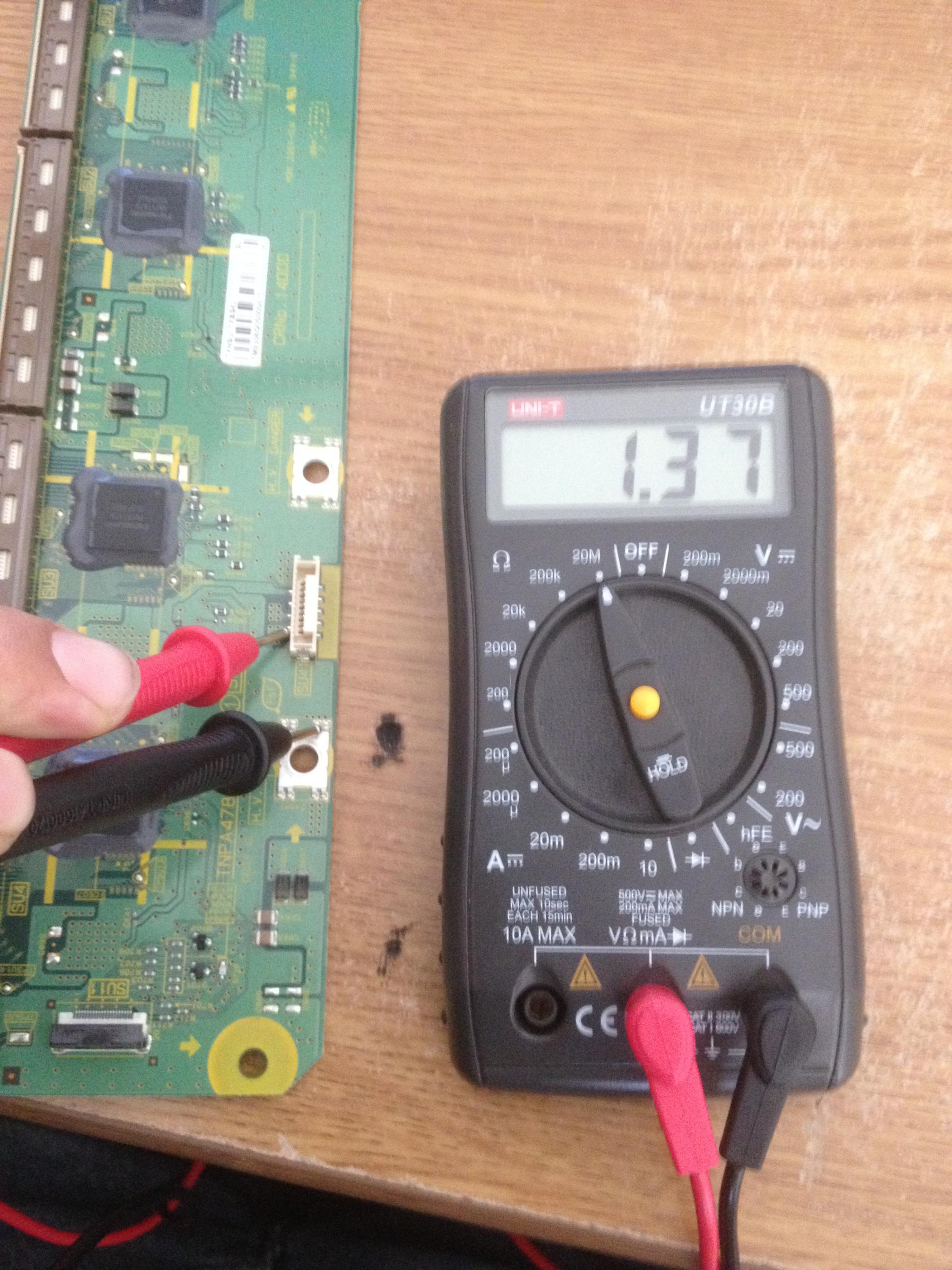

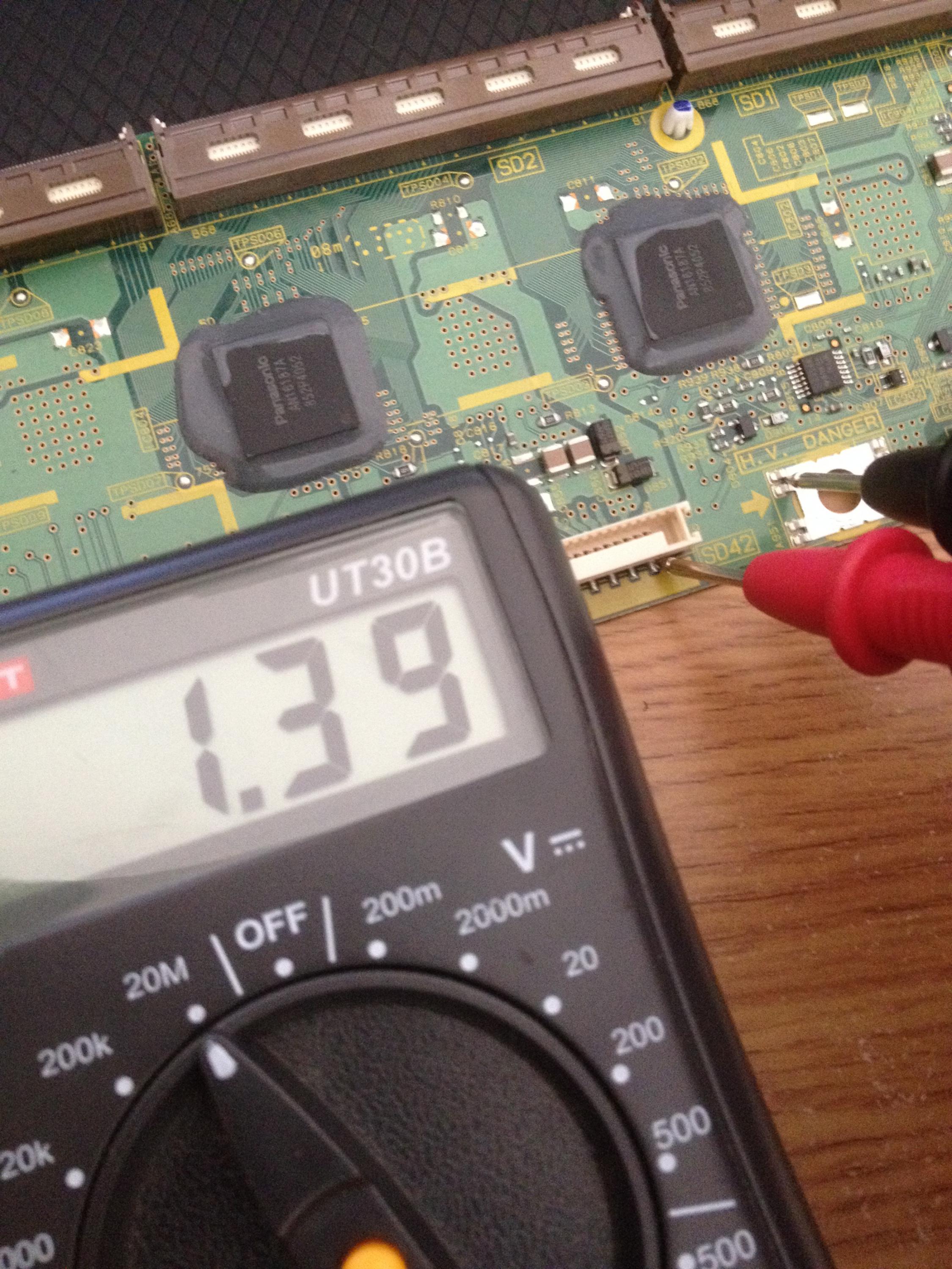

                      Re: Panasonic TX-P42S10B
                      hi all
                      Ok measured resistance this was before i tried it and again now removed
                      DMM set to 20M
                      PIN 2 SU 41 i get 1.37 ohms
                      Pin 9 SD 42 i get 1.39 ohms
                      so with that alone it says bad buffers correct ?
                      The seller has asked me if i checked the buffer for shorts before i fitted but as i said i only checked the above
                      He wants to know if the boards now match shorts as it might indicate a screen problem
                      Can any one point out any other checks i can do ?

                        #51
                        oh images of readings in case im getting that wrong

                          #52
                          In diode mode does this meter beep continuous if the probes are shorted?
                          • noledud
                            • Dec 2013
                            • 413
                            • united kingdom
                            #53
                            no just displays 000
                            • tw2005
                              • Oct 2011
                              • 6458
                              #54
                              try diode at the same point and in both polarities.
                              • noledud
                                • Dec 2013
                                • 413
                                • united kingdom
                                #55
                                ok
                                SU41 pin 2 Red - GND black i get - nothing
                                SU41 pin 2 black - GND red i get 1554
                                SD42 pin 9 red - GND black i get 023
                                SD42 pin 9 black - gnd red i get 023
                                These are on his boards mine differ slightly
                                • tw2005
                                  • Oct 2011
                                  • 6458
                                  #56
                                  give me yours
                                  • noledud
                                    • Dec 2013
                                    • 413
                                    • united kingdom
                                    #57
                                    SU41 pin 2 Red - GND black i get - resistance 1.37 ohms - diode nothing
                                    SU41 pin 2 black - GND red i get diode 1496
                                    SD42 pin 9 red - GND black i get diode nothing 1.38 ohms
                                    SD42 pin 9 black - gnd red i get 1529
                                      #58
                                      Have you tried checking from the VFG to the output nodes? IMHO that is the best way of finding a shorted buffer. I had an LG buffer pulling down -Vy/Vsc and I couldn't find any shorts on the board, but once I pulled it out I found a short between the floating GND node and the topmost output pin of the top IC.

                                        • tw2005
                                          • Oct 2011
                                          • 6458
                                          #60
                                          If Tom's sugestion comes up clear I'd be tempted to try your buffers. I think the EMOS SD is looking bad, SU could be ok.
