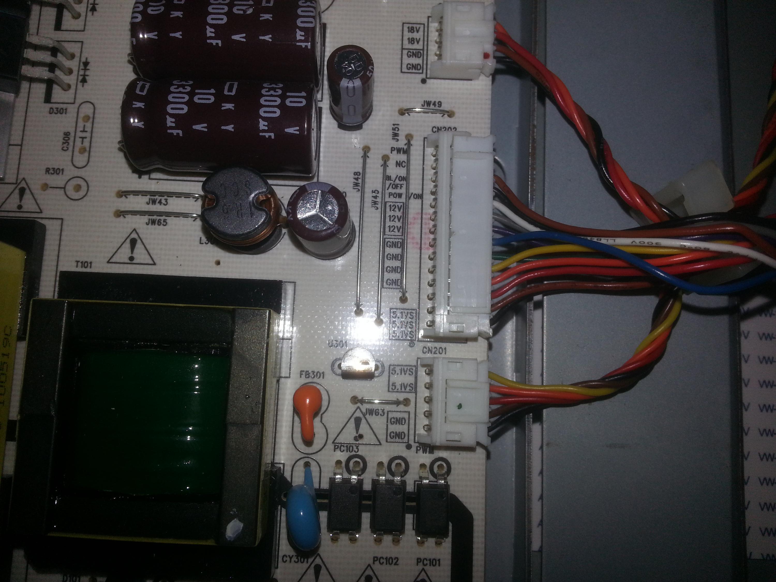

    I have a Vizio XVT473 LCD TV that alternates between amber/white on front LED logo when you plug it in. The pattern will stop after a couple of minutes and then go to solid amber. At this point, you can hit power and the Vizio logo turns white. However, there is no sound or picture and the only way to turn off the TV is to unplug it.

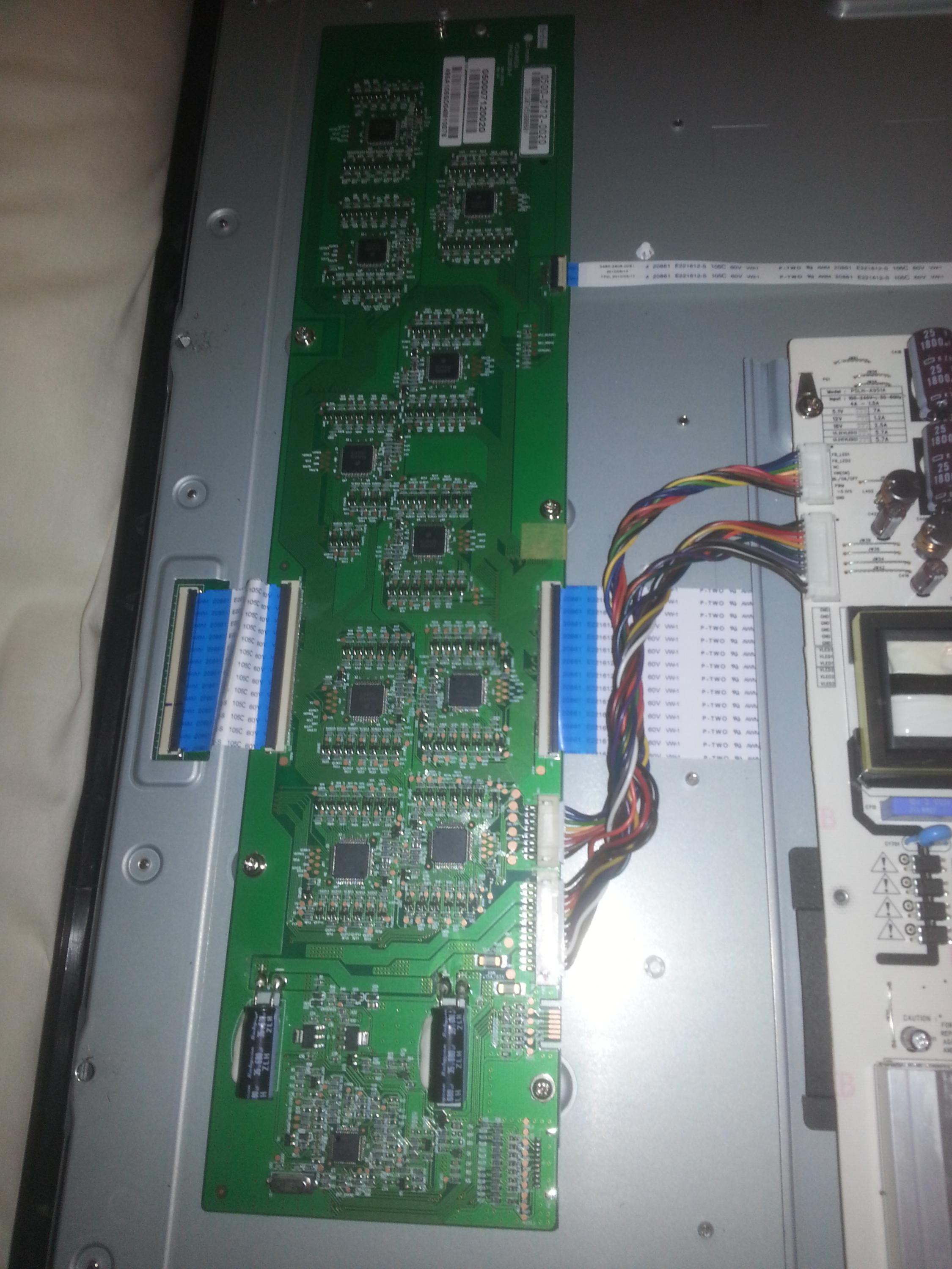

    I've checked for bad caps (visually), fuses (continuity test), and looked for any obviously burned out ICs. There is a blue LED on the inverter board that briefly flashes one time when you do turn on the TV (white logo state).

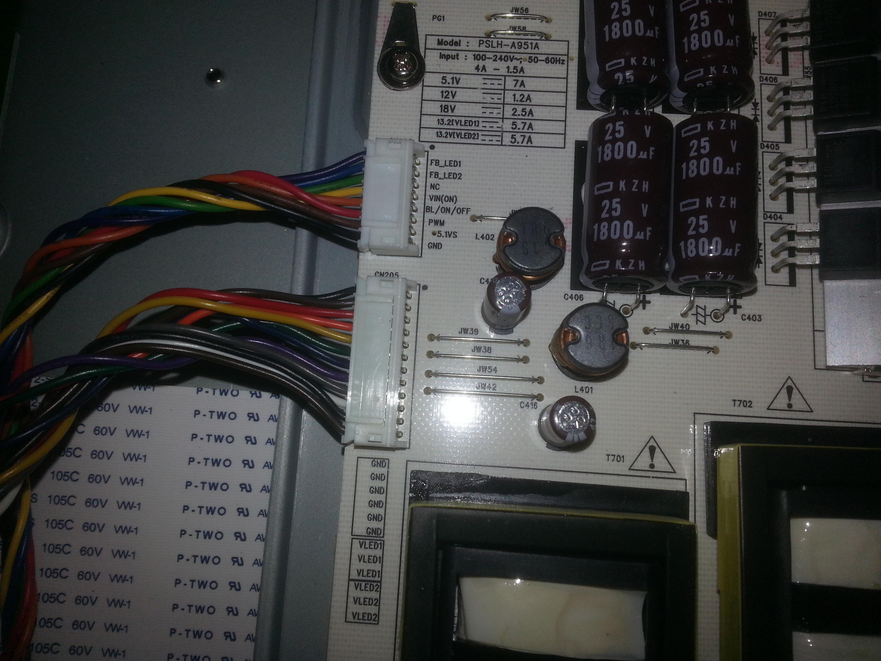

    Here are the readouts from the power supply with the power on:
    Connections on upper right:
    18V = 18.18V
    PWM = 2.55V
    BL ON/OFF = 3.32V
    POW ON =3.32V
    12V = 11.69V
    5.1VS = 5.07V
    Connections on upper left:
    FBLED1 = 9.5mV
    FBLED2 = 9.4mV
    VIN (ON) = started around 130mV then went towards 0mV
    BL ON/OFF = 3.3V
    PWM = 2.54V
    5.1VS = 4.87V
    VLED1 = 7.0mV
    VLED2 = 7.2mV
    I can see that there is a problem with the power getting to the inverter board, but I'm not sure if it's the main board causing this or the power board itself. It seems like it's the power board to me since the BL ON/OFF is getting the correct voltage.(?) I'm not sure what VIN (ON) is though. I'm still pretty new at this. Please let me know which one is the likely culprit and why. Thanks.

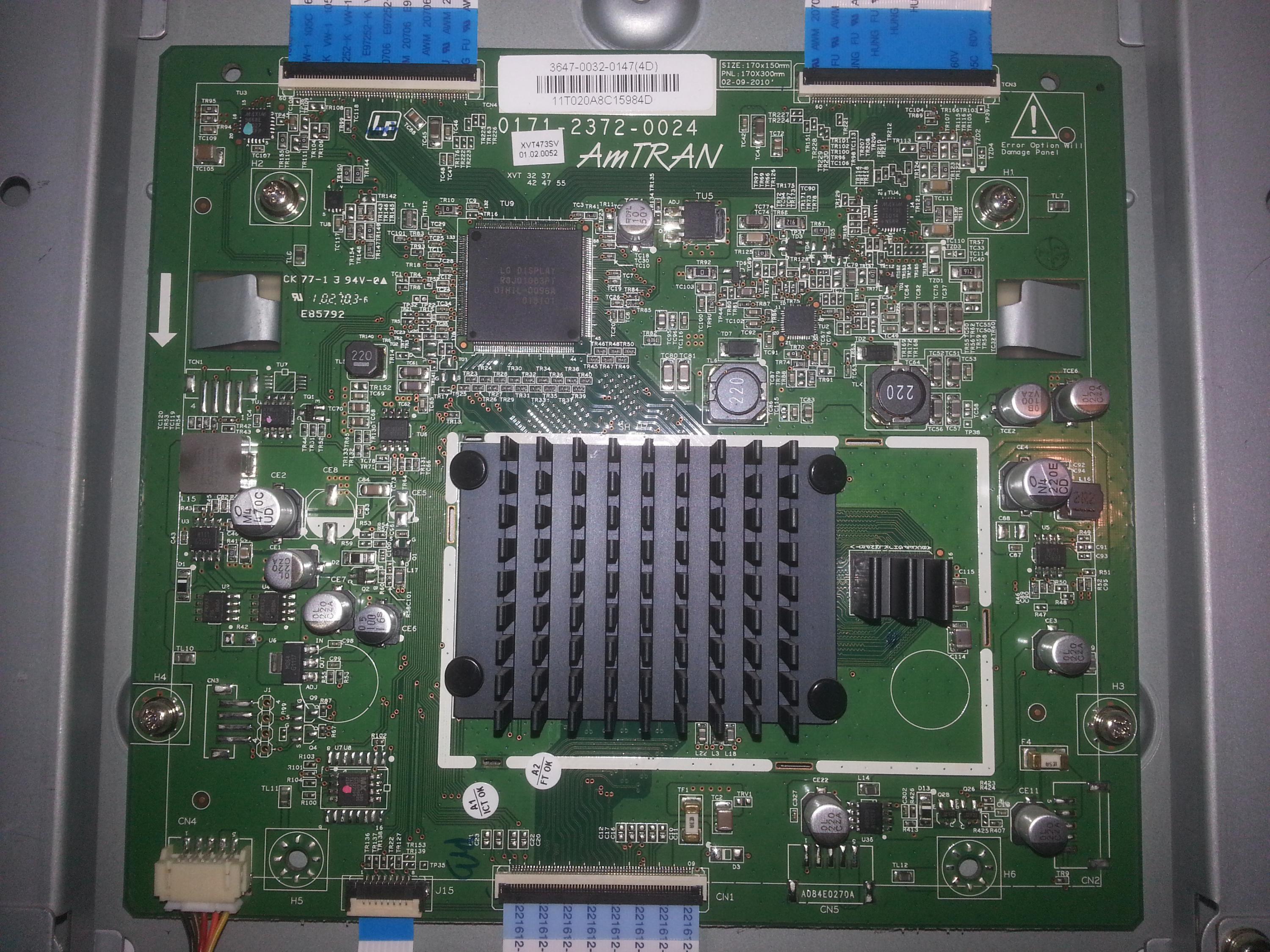

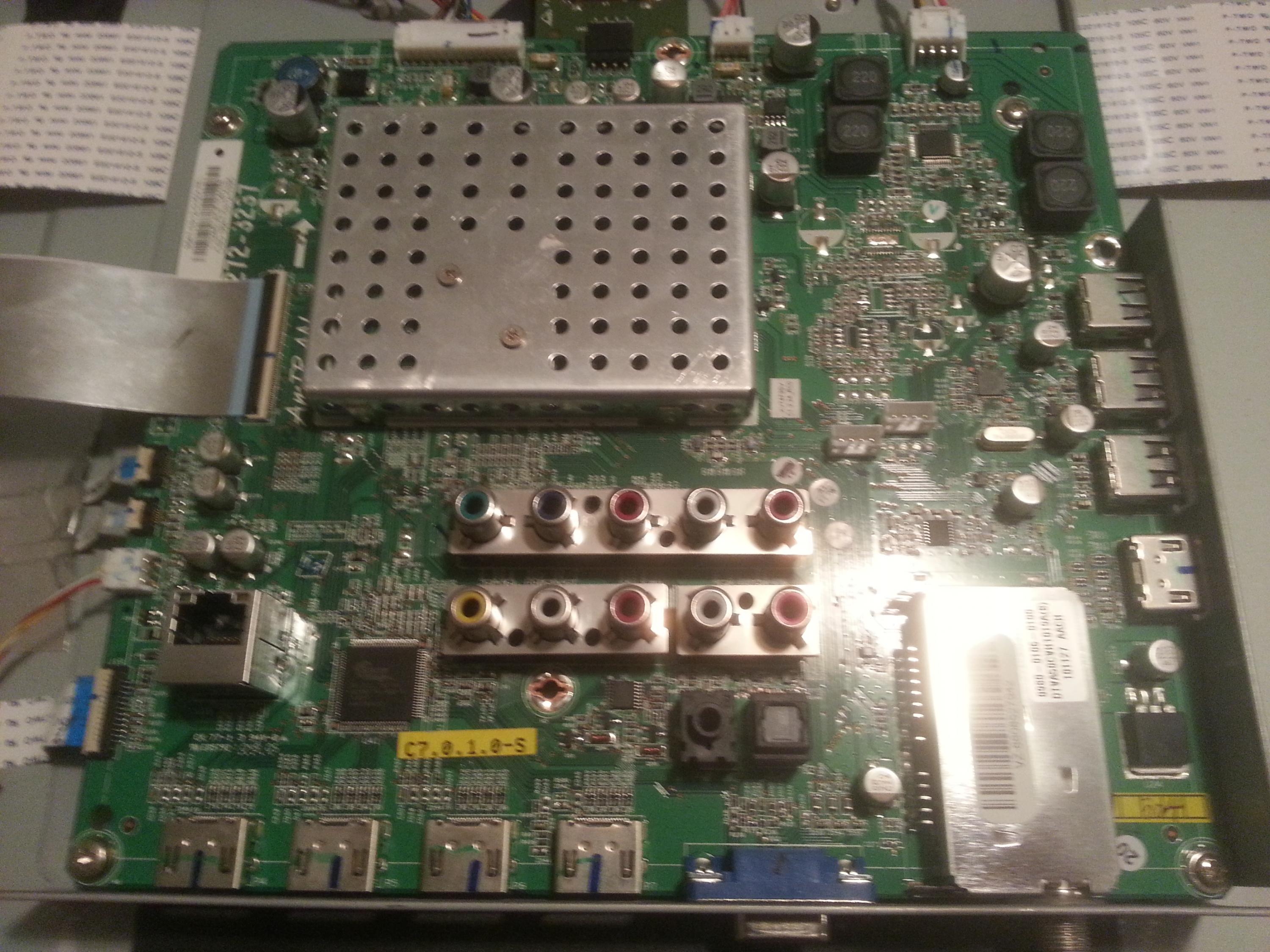

    After reading more in another post, it also sounds like it could be a bad tcon (not syncing)? Any help would be appreciated.
    • ecking767
      • Oct 2009
      • 492
      Re: Vizio XVT473SV Troubleshooting
      could be a bad T-CON ,have you measure the voltage on the fuse(both ends) on the T-CON board, and are you getting any backlight?

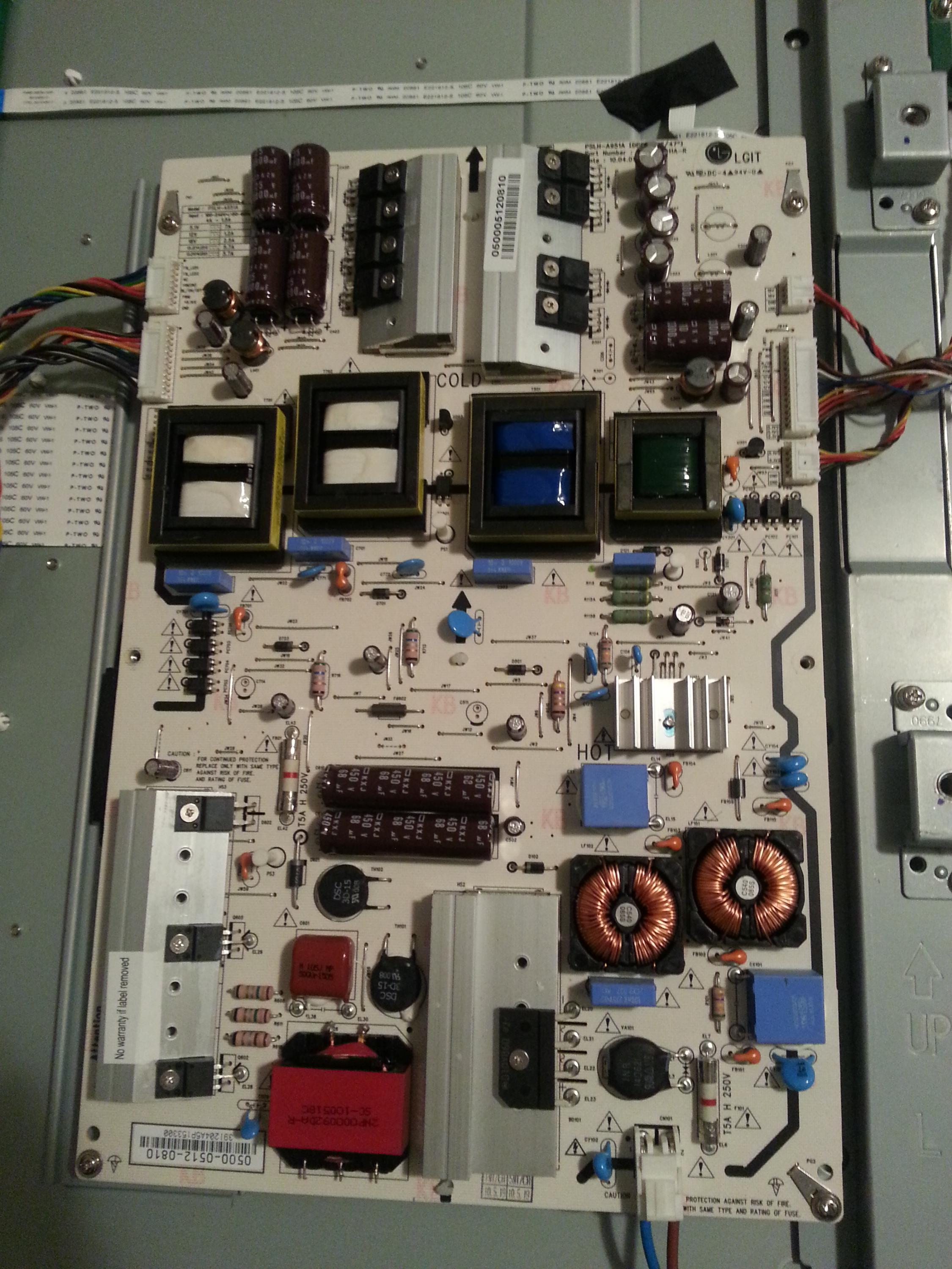

                Was this problem ever resolved? I have no backlight, see virtually identical voltages as posted above and also the blue LED on the inverter board flashes just one time every time I turn the TV on (white logo state).
                Sound is ok and I can see video on screen when I shine a light on it.

                  Did you ever get a resolution to your issue? I have the same issue.
                  XVT 473SV with dead backlight. Screen has video with a flashlight. Sound OK
                  I took of the back, my blue LED on the inverter stayed on.
                  I did not check voltages as that is not my area of knowledge.
                  Was going to replace the PSU and inverter but curious if you had a fix?
                  • n3ix
                    • Jul 2014
                    • 2
                    Mine was fixed by replacing the power supply board. Took 2 tries, the first one I got was bad. It was from River Valley Electronics and they never returned phone calls or email regarding the bad board. I wouldn't use them as a source. Got the second from an individual seller on Ebay.
