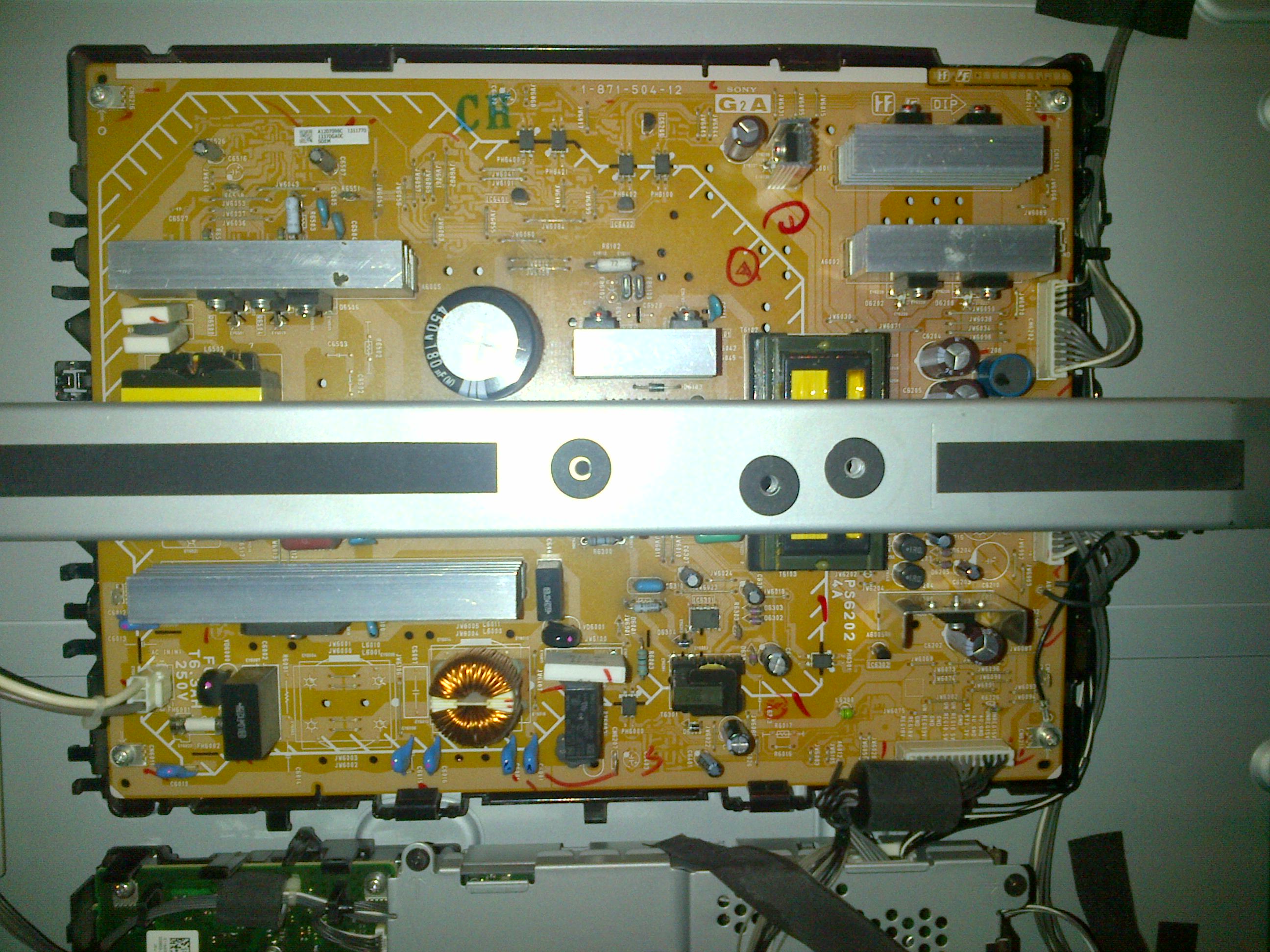

    hi there guys got a Sony KDL-46S2530 which has sound and no picture. i have tested the power board and the volatges going to the main board and inverter and they are as follows if anyone knows what the problem could be ?

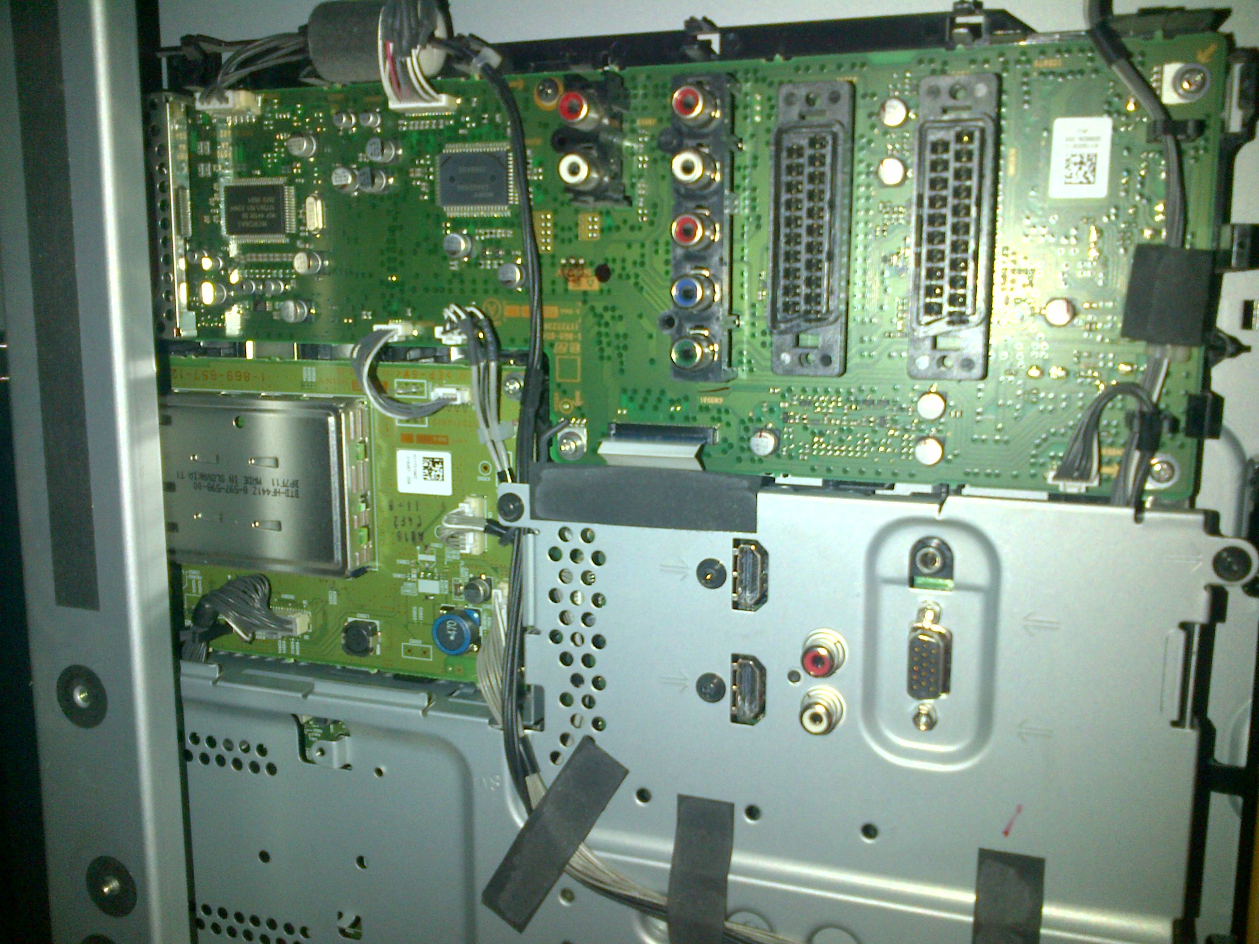

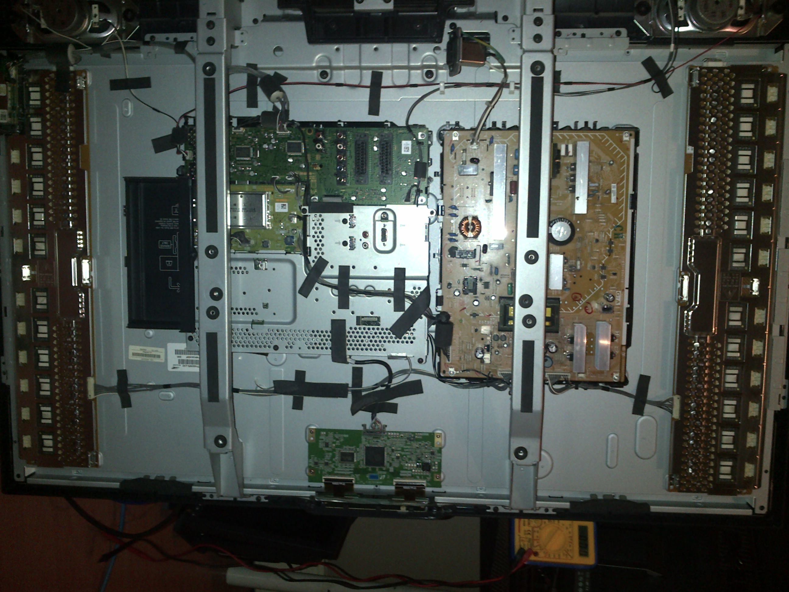

    allways helps if you can post up some pics of the boards

      if you need any info off the boards just let me know cheers.
        Re: Sony KDL-46S2530 Sound & No Picture.
        Any LED blinking code?
        Pictures of the inverter boards with covers removed and pictures of the labels on the inverter board connectors.

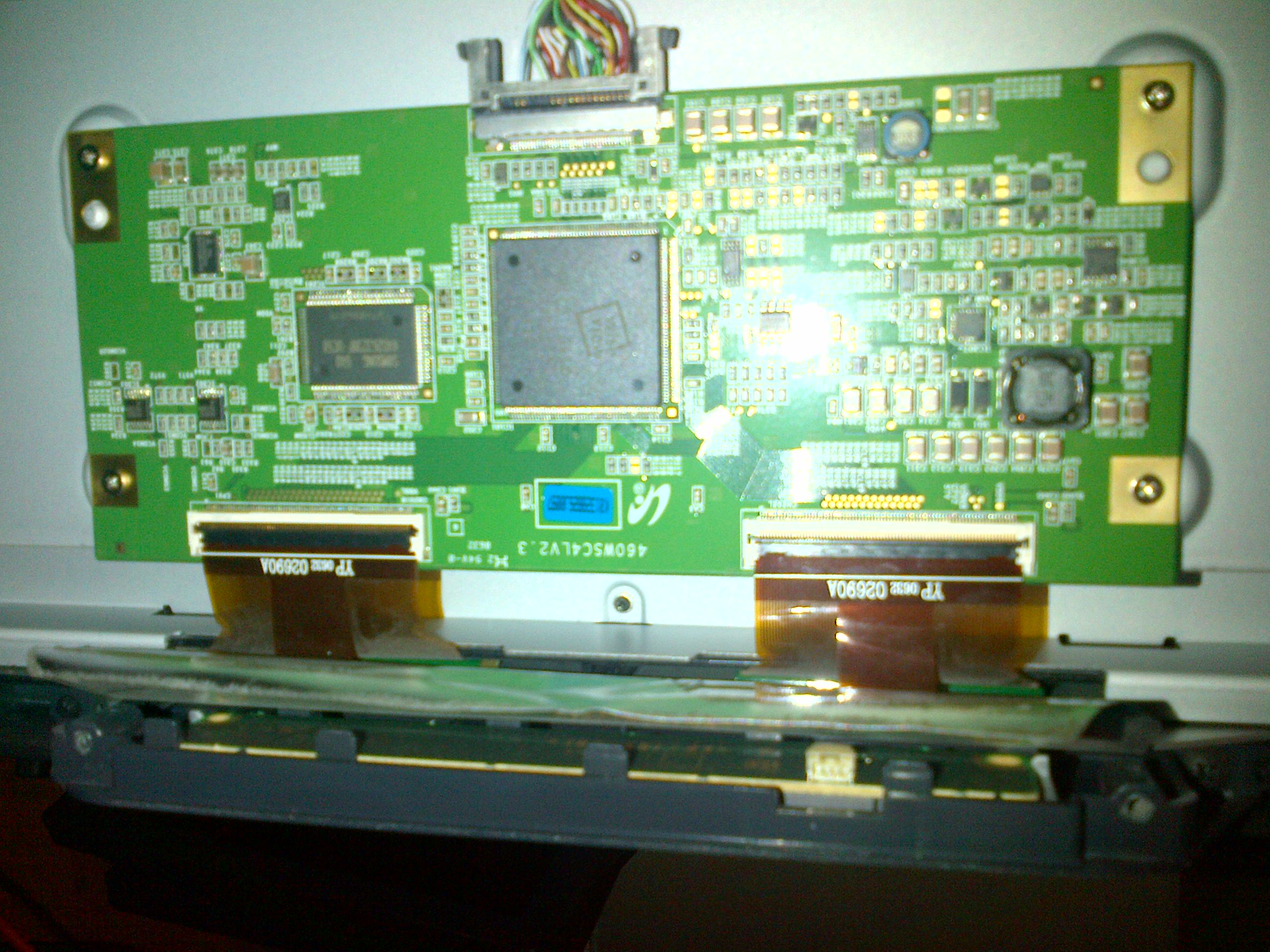

            Since the backlights are on, it's probably a TCON issue. Check the fuse on the TCON. Also check that there is voltage at the fuse.

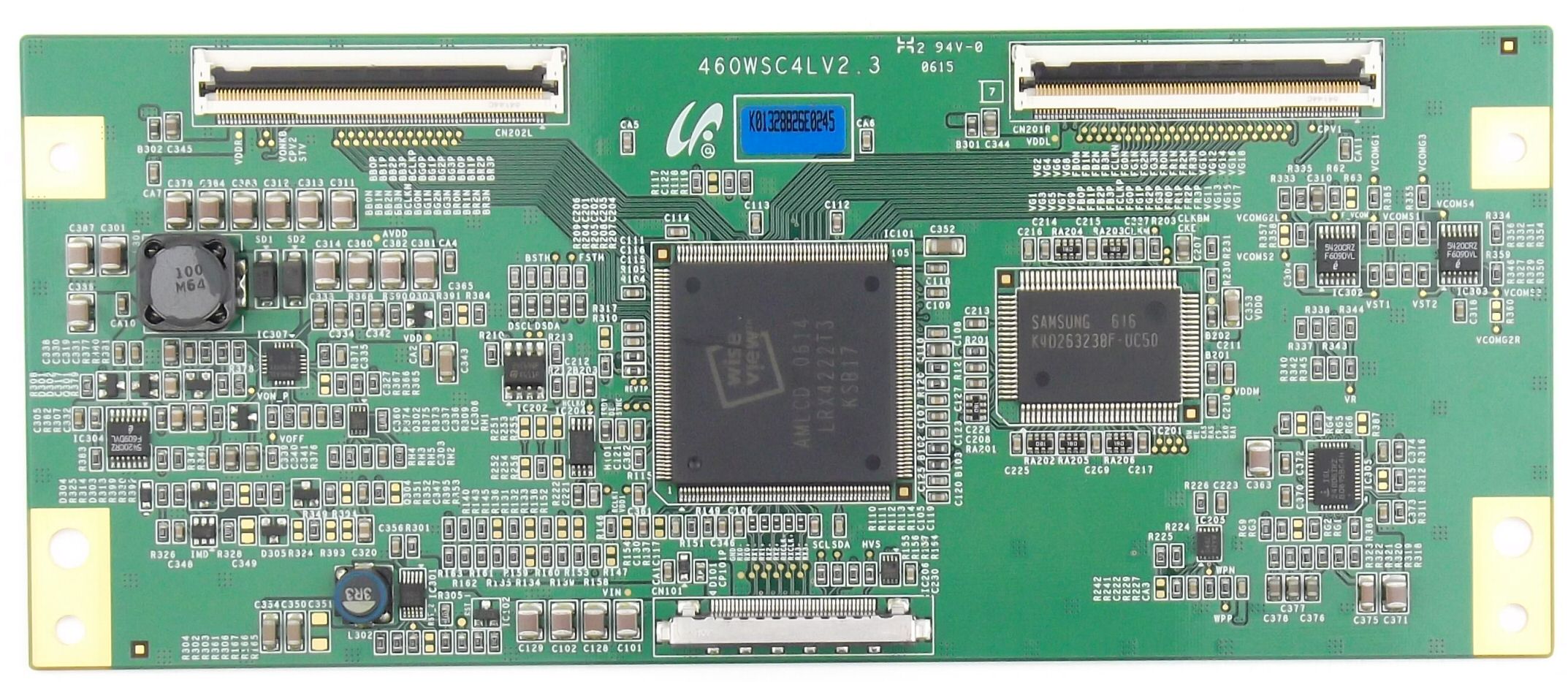

                Take good clear pictures of the T-CON board, right now it is not clear enough to see the fuse.
                BTW "i get backlights come on" that was another missing clue.

                  sorry Budm your right, should mentioned that from the start, camera is poor quality so got exact same board image from Google images.

                      check the fuse - little green device marked "P".

                        Tom checked that and it read -660

                          when the sets switched on what voltage do you get to each side of the fuse.

                              20V DC, red probe one end, black probe on chassis, note reading down, then switch red probe to other end and note reading down again.

                                jumping between 0.44v - 0.48v on one side and other side is solid at 4.99v
                                  Replace the fuse. It is blown and probably causing your fault.

                                        yes try it if you have a spare one of the correct rating thats what i would do at worst i guess it will blow again or work perfectly ok.
