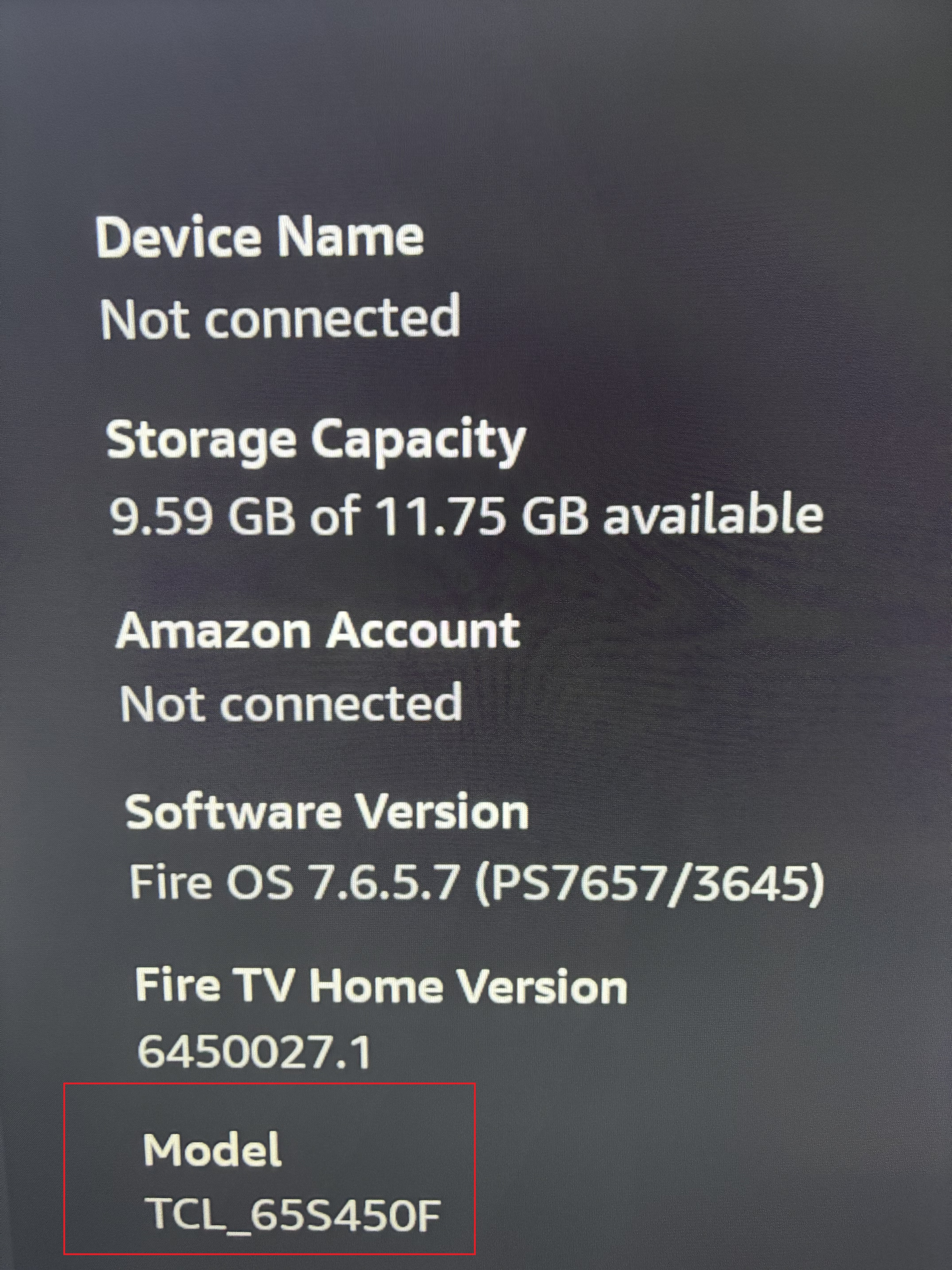

    Yep, the 55" and the 65" use the same main board. They have the exact same part number and works perfectly fine. Didn't have to do anything much besides relearning the remote..
    you didnt catch what i mean... info photo of the Firmware listed the model are 65 not 55...LOL... this info are plain txt at system firmware in file build.prop under "ro.build.description=" so from there was for 65 not 55
      I don’t get it. The TCL TV is a 65” screen and I got a 55” TCL main board and has identical part numbers compared to my old one.

        I don't get it. The TCL TV is a 65” screen and I got a 55” TCL main board and has identical part numbers compared to my old one.
        yours replacement MB are already 65 my friend not 55 the seller did mistake.... no way the model name and size changed from alone... as i said this info written in plain txt file under system.

          If there is a spi flash with a panel identifier on the buffer board, then it could be re-registered when turned on and change the parameters in the settings.
            no way on android..
            all this info saved on root firmware in system under build.prop
                no way on android..
                Well, I have no more options, whereas the number has changed from 55 to 65.
                  no way on android..
                  This was the description on ebay:
                  For Sale is a AV Main Board for a TCL 65S450F Series TV.
                  Part Numbers:
                  30800-001002
                  Identifying numbers appearing on this specific part
                  30800-001002 / 30801-000994
                  Known compatible models:
                  TCL 65S450F / 55S450F Series TV​
                    if there any external parts can write and change on Android firmware.. then this firmware easily to have SU root on it and user can do what he wish..
                    and also on 75 LOL... don't bother it come fit with yours set... this is the important things.​
