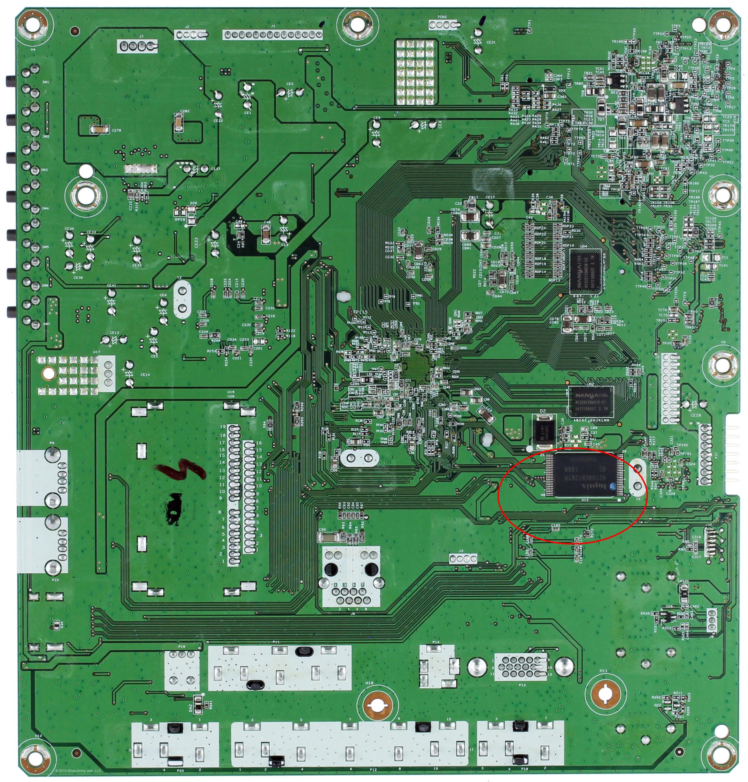

    This is a 1080 smart 3d tv I bought off of someone for cheap and was hoping to get it up an running. When you turn it on, it displays the Vizio "V" logo and that's it. Must unplug to turn it off. Tried the 30s reset with no luck.
    I have read a few fixes that suggested that the firmware was corrupted/badflashed and thats keeping the set from booting. I have a GQ-4X programmer with SOIC8 adapter.
    As far as the firmware, I cannot find any downloads/dumps for this model, although I have read that there was at least one new fw release for this tv. I was curious if other similar models might use the same firmware that I could download instead?
    Has anyone ever played with something like this or have a schematic of this or a similar model? This is the first Vizio I've worked on.
    Thanks!

    you have to replace your main board, the firmware isn't on a SOIC8. Its U52 on your main board. you will need an very expensive programmer to copy and write to that type of IC chip.

      Looked for about an hour and could not find U52. Do you have schematics of the tv and/or board I could take a look at? The mainboard pn is 3632-1532-0150. I have been unable to find one.
      Depending on what type ic chip the firmware is stored on I may be willing to invest in a programmer that would handle it as the cost of the board is +/- $75.

        OKAY its U12 on the back side of your main board
        check ebay for a replacement board, I found 2 and 1 repair service
        to program U12 you will need to spend about $1,000 for a programmer

          Great, thanks for the info! I did find this that does program nands, including the Hyrix H27U's for $278:
          http://www.ebay.com/itm/TNM-2000-USB...-/321207236799
          I'm thinking about it. In the meantime, I don't have access to a good copy of the firmware so I guess I'll be buying a board

              its look OK to buy and I see HYNIX on the device list. I will check it out the device list for other EEPROM that Vizio smart TV's use. The price have came down for a Wellon programmer its about $650.
              But also keep in mind soldering a TSOP48 can be a challenge.

                Just to update: I ended up buying a used mainboard for this set and it has worked flawlessly in the bedroom for almost a year.
                Still haven't pulled the trigger on buying that programmer though
